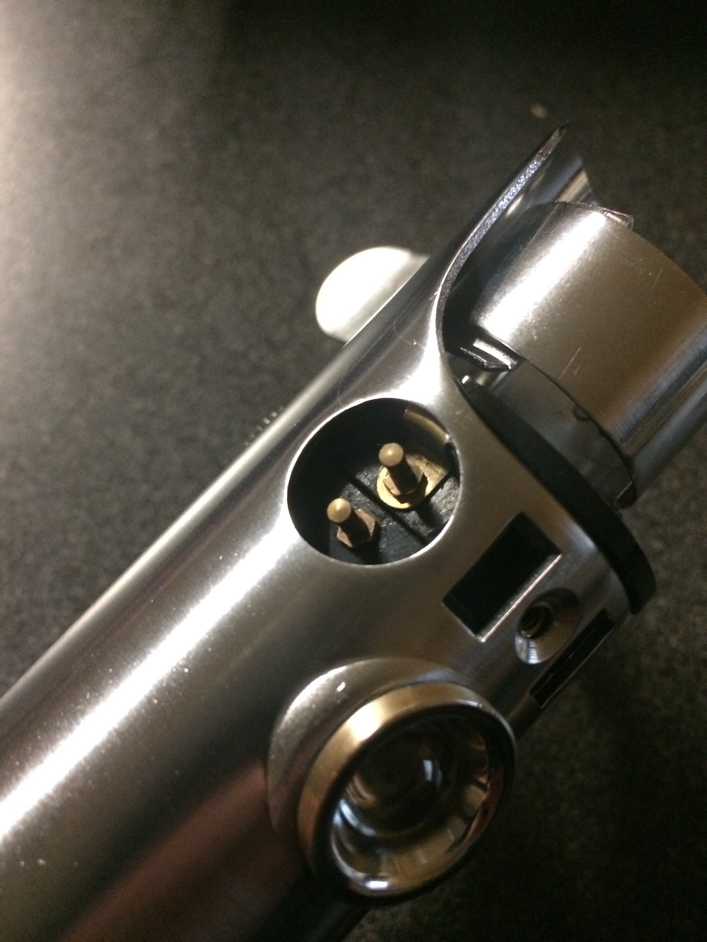

A warning to anyone who plans to do an ammonia fumes treatment to darken your brass pins. I let mine sit in a Tupperware tub above the liquid overnight and yes, it darkened the pins. But it also ate away at the THIN brass contact piece that the pins are connected to., so much so that one contact crumbed and broke off in one side, and the layer underneath the lip in the center actually broke apart into several pieces. Anyone got an extra of that part?:wacko

brass ager on amazon works great, and you dont have to worry about it turning green or damaging the pieces. it seems kinda expensive but well worth it and easy to use

And now Ive stripped the slotted screw in the front trying to get the emitter out to fix the brass contacts. What else could go wrong?

Wont do me any good if I cant get the screw out! But yes, Ive already ordered replacements.

I'm a bit of a noob on the subject, but I believe that there are little extractor bits that can get out stripped screws. Anyone have experience with these?

Crisis averted. I managed to CAREFULLY use my dremel cutting wheel to cut a new slot perpendicular to the stripped slot and unscrew it. I also rebrowned the pins and new replacement brass contacts.

Bit late on the ball with this but I do! Picked up a set of four bits at the hardware store to fix my grub screw mishap on my V2. Amazingly simple stuff.
