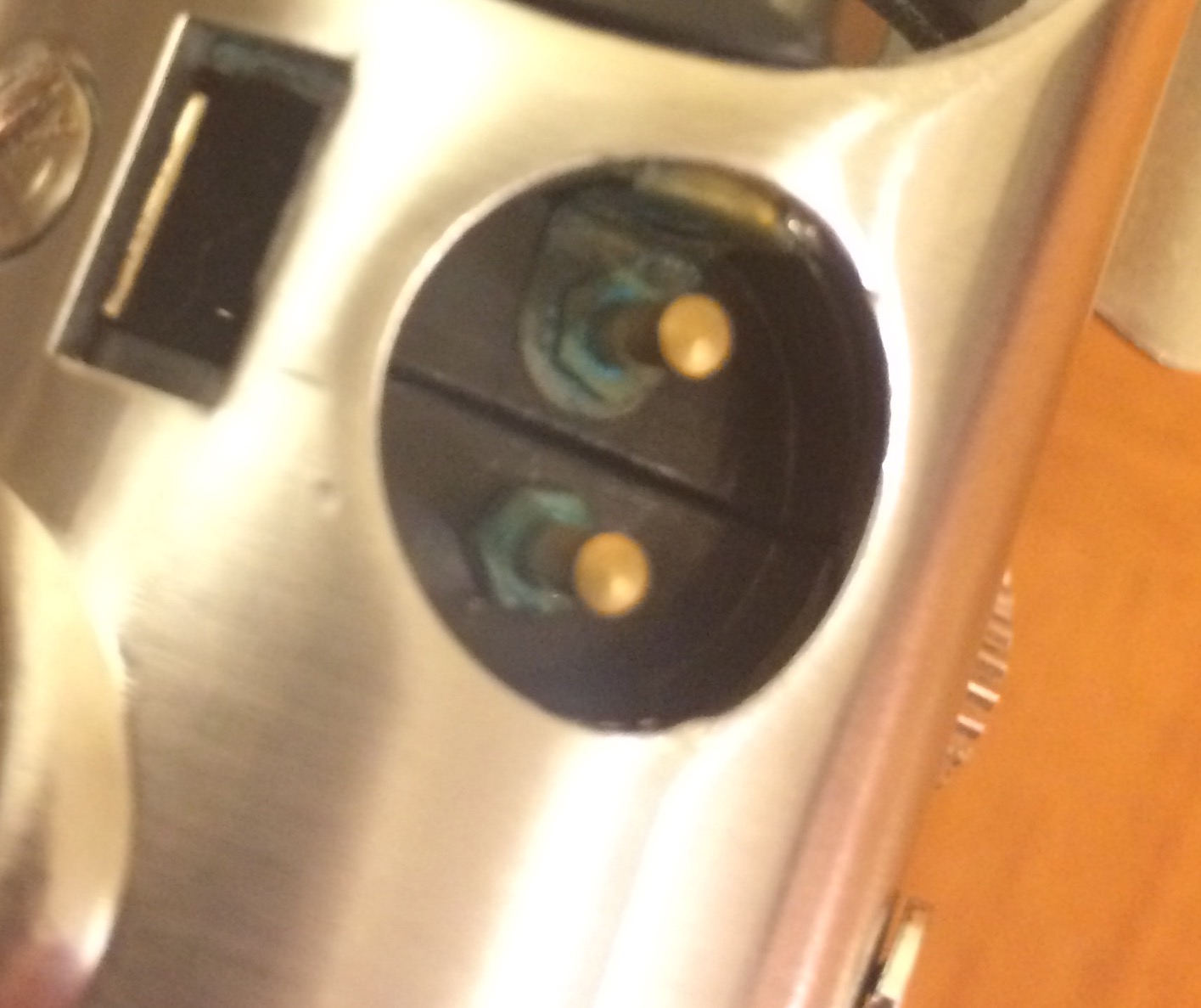

A warning to anyone who plans to do an ammonia fumes treatment to darken your brass pins. I let mine sit in a Tupperware tub above the liquid overnight and yes, it darkened the pins. But it also ate away at the THIN brass contact piece that the pins are connected to., so much so that one contact crumbed and broke off in one side, and the layer underneath the lip in the center actually broke apart into several pieces. Anyone got an extra of that part?:wacko

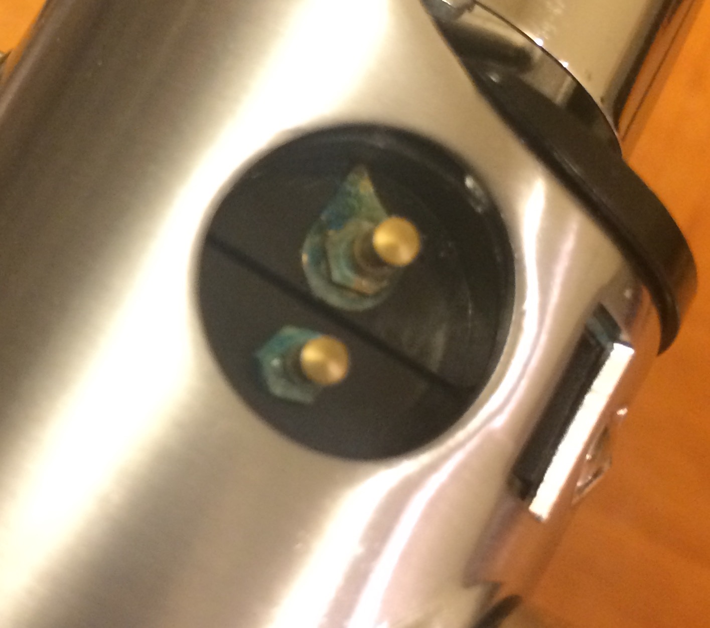

A arming to anyone who plans to do an ammonia fumes treatment to darken your brass pins. I let mine sit in a Tupperware tub above the liquid overnight and yes, it darkened the pins. But it also ate away at the THIN brass contact piece that the pins are connected to., so much so that one contact crumbed and broke off in one side, and the layer underneath the lip in the center actually broke apart into several pieces. Anyone got an extra of that part?:wacko
View attachment 708510View attachment 708509
Oh man! Next time maybe remove the pins (carefully with needle nose pliers). Thankfully, there are plenty of sellers on Etsy that sell replacement brass contact strips. I installed some in my Graflex 2.0 a while back. A bit tedious but totally doable.
