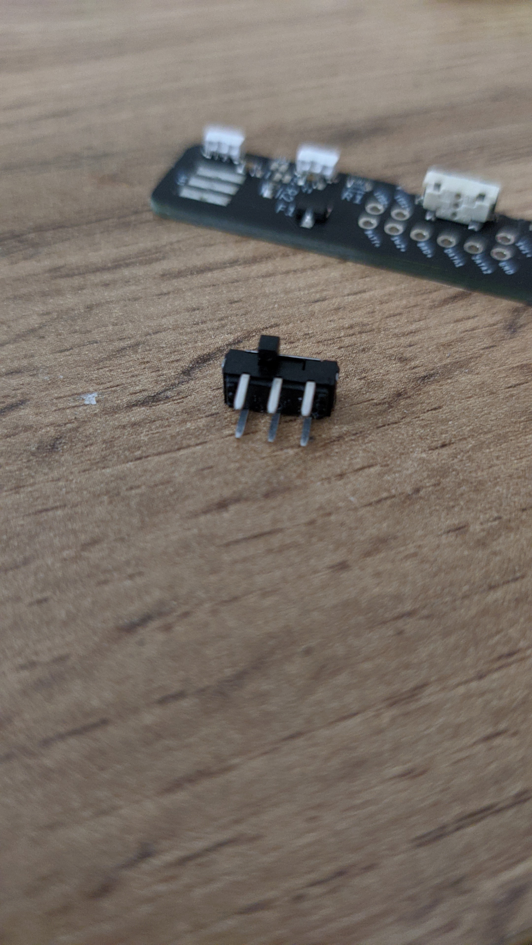

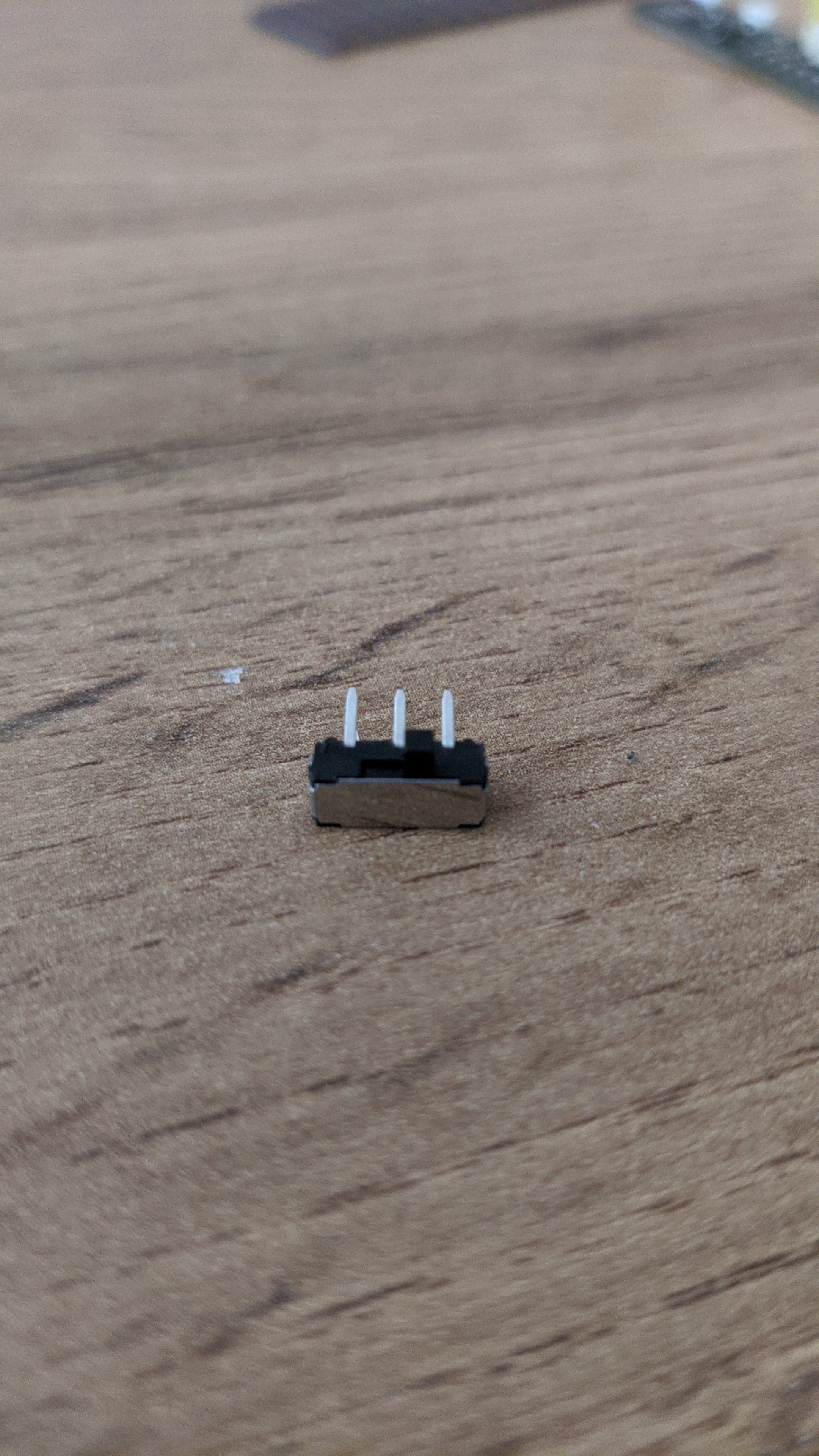

Seems like the lastest batch comes with a different switch? This one has 6 pins.
Edit: So I contacted Lewis. Just clip off the 3 pins on top.

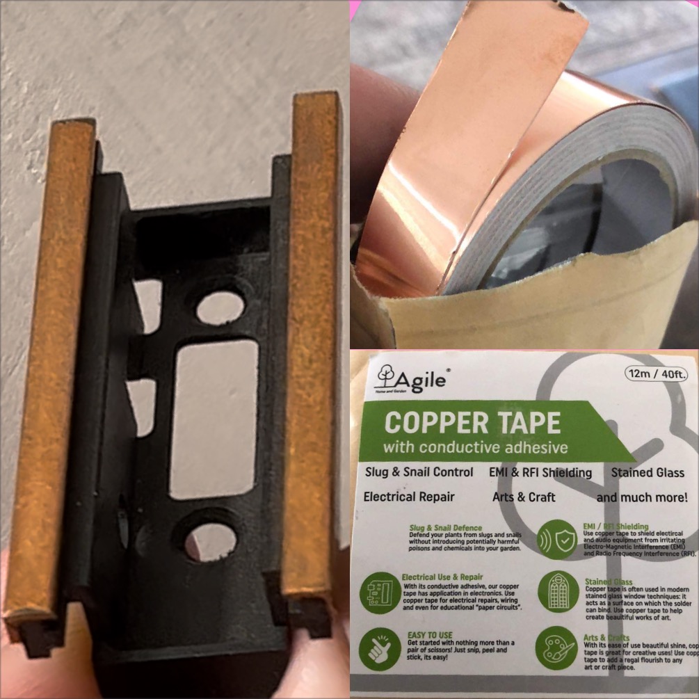

Adding tape to your rails:
This can be done with just the canoe, or after the hilt as been assembled… the process IS the same but it is easier to handle just the canoe.
You will need-
-Wide copper snail/ stain glass/ electronic repair foil tape.
- clean and prepped MoM rails
- sharp exacto with replacements.
Step one-
Make sure you have clean rails and have already added whatever your selected method of color for the rest of the box.
Step two-
Brighten the ends of the L rail if desired.
Step three-
Uncoil a comfortable length of copper tape.
- release the paper from the end.
- attach it to a work surface
- put tension on the copper length
- pull the paper away with enough room to examine the tape.
Step four-
- Holding the rail section, and maintaining pull on the copper tape; apply the edge of the L rail bottom edge in line with the copper foil tape.
-Use your hand to press it down and burnish the side flat.
- Continue softly burnishing while rolling the edge over to the top corner and burnish flat.
Step five-
- release the tape by cutting excess length
Step six-
- use a fresh, sharp exacto blade to carefully remove excess copper material from the ends.
Step seven-
- Roll the tape into the middle and burnish the inside of the rail.
DO NOT burnish tape *up inside* the track where the card slides.
Step eight-
- make sure your exacto is still sharp. Cut the excess tape off.
Step nine-
- Mirror and repeat for the other side.

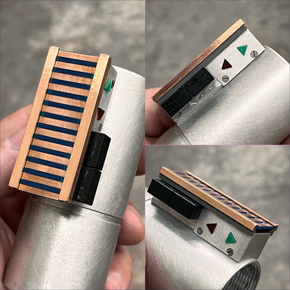

Here is the process in three different views.
