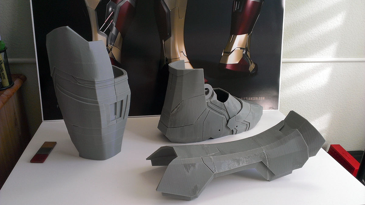

Fully 3D Printed Functional MK 42 !! :0

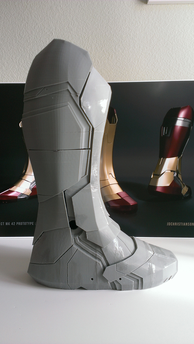

Quick pics update as I run to work!

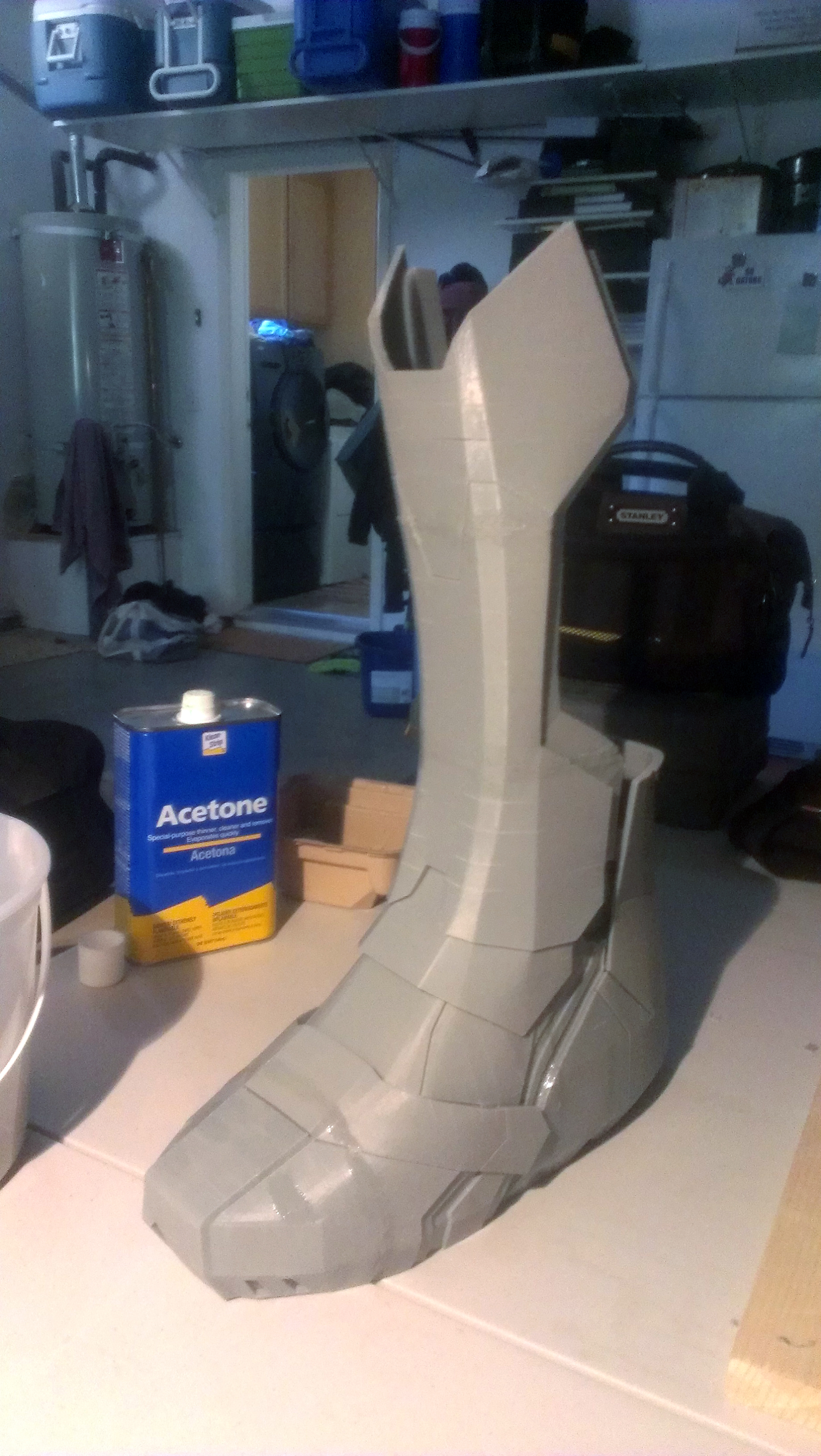

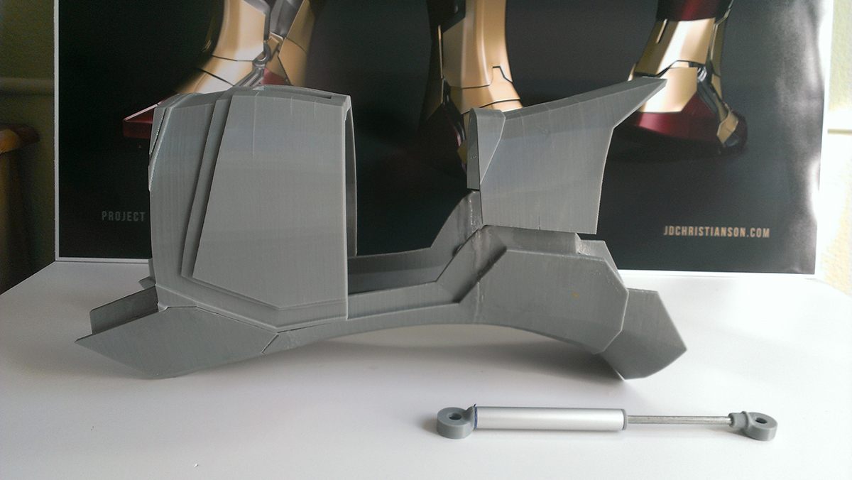

Welded most of the pieces I have so far on the boot just this aft after a long morning of meetings.

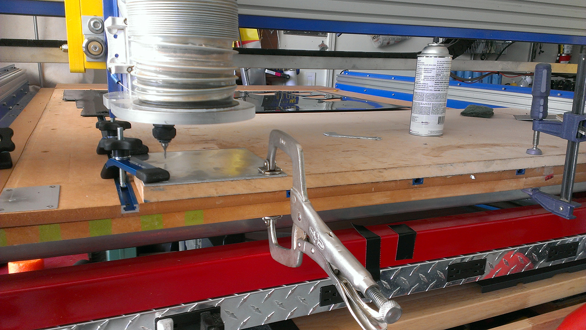

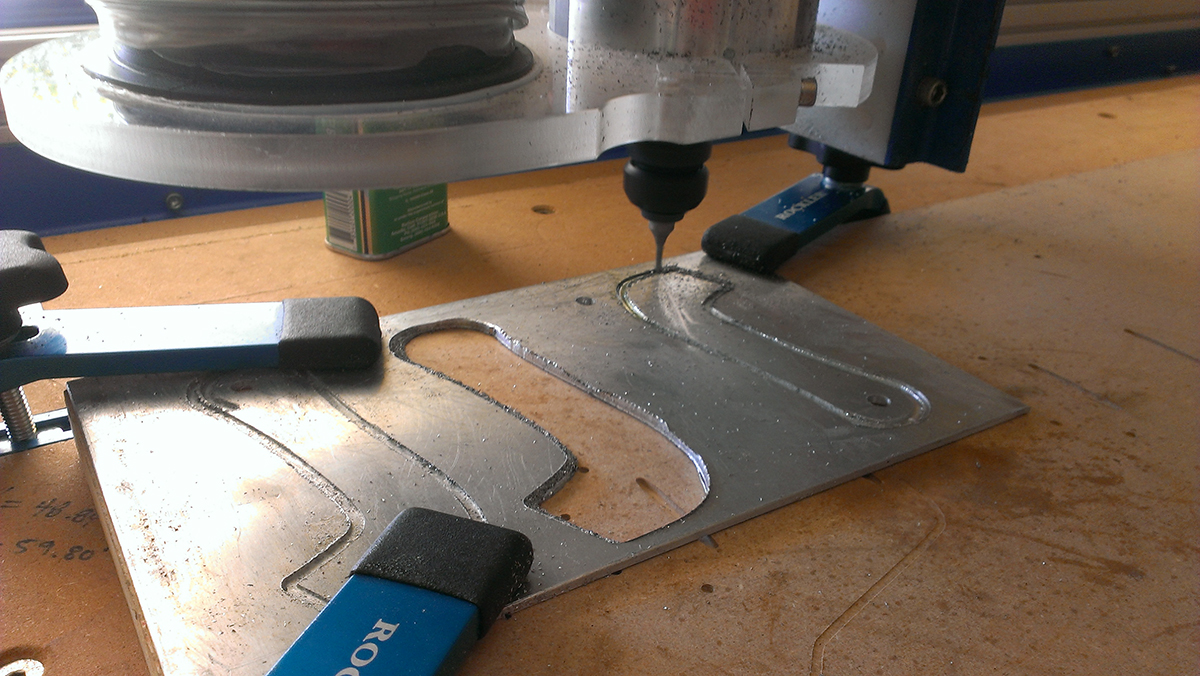

Getting the workflow down on the CNC machine and will cut out these pieces in aluminum next time I'm over there! :)

Got up this morning with the goal of getting those arms CNC'd out and was able to get lots done today. The machine kept slipping because of the pull from the bit and possibly my bumping the head plate here and there, but after several attempts and clamping down the plate with some large vice grips I was able to cut out some aluminum arms!

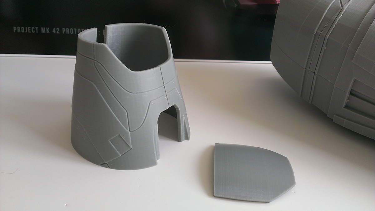

Here are some update pics as the printing on the calf commences! Yesterday I printed out the two mid calf pieces and right now printing the large lower mid section. Notice how flawlessly the calf is lining up with the shin! :)
The top of the calf has two more pieces, which are just as large. Does anyone know what the best pre primer filler is for ABS? I am still searching and am not sure about Bondo. Someone told me Marine Filler, which may work for small peices, but I also want to find something that is not sold $220 dollars a gallon.

I'm on the final print right now for the boot V2!

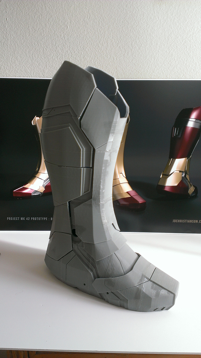

BOOT V2 PRINT COMPLETE!!!
As you can see there is warping on both parts of the mid-calf which will I will sand down on. It looks so friggin cool, I can't wait to sand and weld the calf tomorrow and then install the mechanisms by this weekend!!
