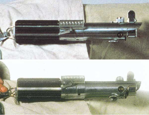

My theory on the story of the Graflex
In ANH we have the hero graflex, a complete with all its parts 3-cell unit. 7 plastic t-track grips, exactra 20 bubbles, and a d-ring and clasp assembly from a graflex camera case have been added. Now when it comes to the specific model of graflex 3-cell used we need to look at the small details. The plating on the body of the flash is very shiny and reflective, polished looking. The bottom of the flash has a thin raised lip rather than a thicker more rounded flatter lip. The lever on the clamp is shiny polished looking plating rather than a matte finish and the pin attaching the lever to the threaded rod is dark in color, is not machined, and has no head to it. The glass lens bezel is matte and not shiny/polished, and appears to have a deep recessed lens. There is a fully knurled red button with beer tab and post intact. Finally the pins are hard to tell whether or not they are straight or trs style.
Now what kind of graflex model fits all of these criteria?
This FOLMER/NEW YORK model I found about a year ago is right on the money. It hits every reference point I've seen of shots of the anh hero.
Now the bladed stunt. As far as I can tell this is an aluminum tube fitted with a graflex clamp, glass eye, and red button, making up the only graflex parts on this saber. The clamp lever appears to be matte, the red button is a thin knurled version, and the glass eye has a shiny reflective plating.
torsluke_skywalkerlukesaberanh-vi.jpgstar-wars-anh-luke-lightsaber-promo-1-x600.jpganhsabers-vi.jpg

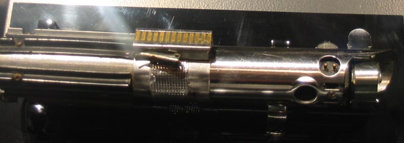

Following the small details about the Luke Hero we can see that the Ranch Saber has the same shiny plated style clamp lever the hero had, however the lever has broken off of the threaded rod and is now fastened to the clamp sidebar with a countersunk flathead brass screw and the clamp has been secured with a domed flathead brass screw. There is 1" textured mylar on the clamp different than anything seen on screen, and it is positioned just low enough on the lever side of the clamp to see the dark mark located top middle of the clamp screw slot. There is a red button in the lens socket in the earliest photos of this saber but has since been moved to the original red button location. The pins in the top are straight, but the brass strip and metal leads going from the top pins and residing in the rectangular slots are missing. The bottom tube has a thick lip, is marked folmer-graflex with a patent number, has a kobold bracket mounted correctly with a d-ring, and 6 t-track grips notched at the bottom with black phillips screws and smaller cheesehead flathead screws at the top of each grip. Finally the circuit card, although facing the opposite direction, has the gold trace right up to the edge of the card with the opposite side having a little board, unevenly cut in the same way as the ESB shots, before the gold trace.
I believe that the Ranch Saber, which is presented by lucasfilm as the ESB hero, is mostly the Luke Hero from both films. I think it's the Hero clamp and clamp lever, the Hero circuit card, and most likely the hero top and bulb socket with the straight pins from the Hero. The bottom tube, grips, and the kobold and d-ring are all different/new to the Hero prop, the bottom screws and maybe the top ones came from the Hero.
Ranch_002-vi.jpgRare-LFL-Lucasfilm-Archives-Movie-Prop-Lost-Photos-Star-Wars-Indiana-Jones-Historic-Visit-Origin.jpgRare-LFL-Lucasfilm-Archives-Movie-Prop-Lost-Photos-Star-Wars-Indiana-Jones-Historic-Visit-Origin.jpg
Where then if the Ranch Saber is made up of the top, clamp and card of the hero did the hero's bottom and kobold end up? The Vader ROTJ Graflex.

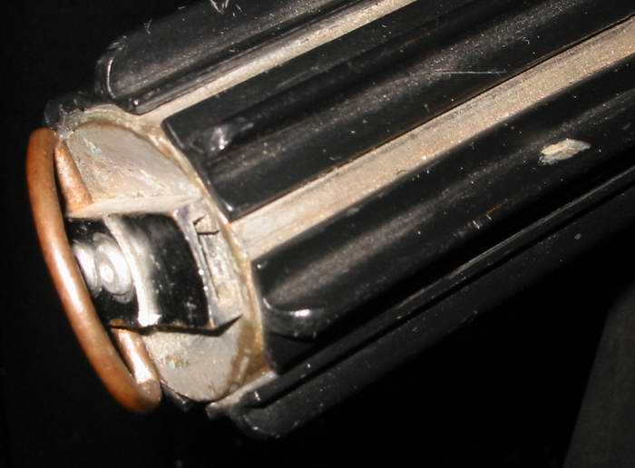

As has been pointed out in other threads the bottom tube of the Vader ROTJ has holes drilled in the bottom that would match up with the ESB hero, there are those other holes near the top of the tube which seem to line up with where some of the top screw locations are like on the Ranch Saber, perhaps a first attempt before scrapping it in favor of a freshy? and the kobold and d-ring are definitely from the ESB Hero. Same Dents from the d-ring on the bracket, same d-ring. The rivets are new and smaller, but you can see the rings from when it had the larger rivets on the Hero prop. There is a painted brass disk covering the bottom, but from the profile of the disk it matches up with the thin lipped folmer style. The top tube may be from the Luke Hero as it has a good shine to it, not very matte, has a straight pin, but I'm pretty sure its just another top they had lying around, possibly from the flying Vader in ROTJ or from a saber seen in a bts shot attached to the top of a kobold flash which have some black paint on the top of the emitter like the Vader ROTJ.
gripcloseup1b.jpgRare-LFL-Lucasfilm-Archives-Movie-Prop-Lost-Photos-Star-Wars-Indiana-Jones-Historic-Visit-Origin.jpgVaderSaberGrip.jpgVaderSaberRear2.jpg

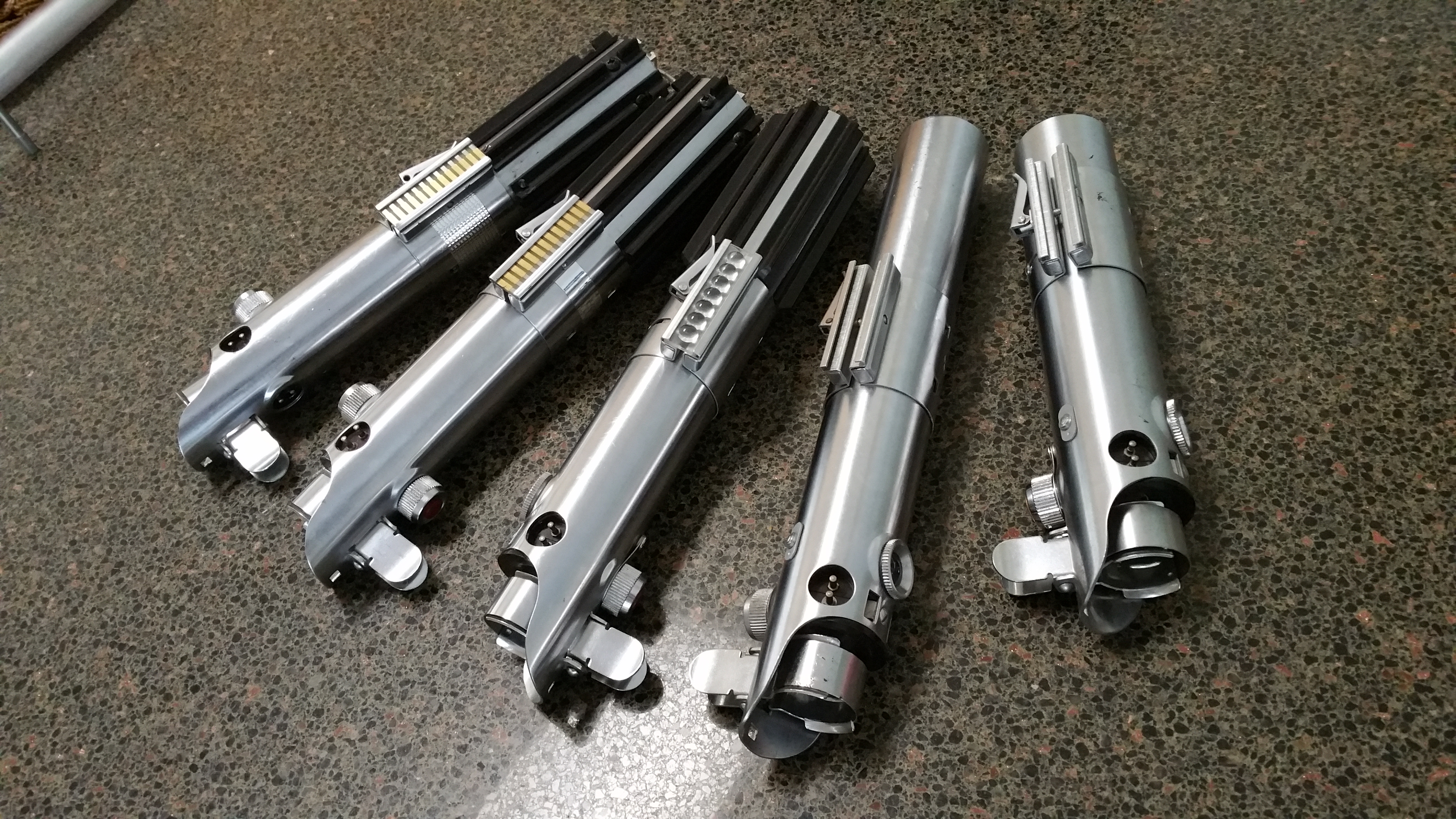

couple more of a bunch of builds I had all together at one point. All Manufactured by Graflex except for the Folmer NEW YORK which is waiting until I find another one and the rest of the vintage parts i need to do proper all vintage parts, save the t-track, ANH and ESB Hero's at the same time

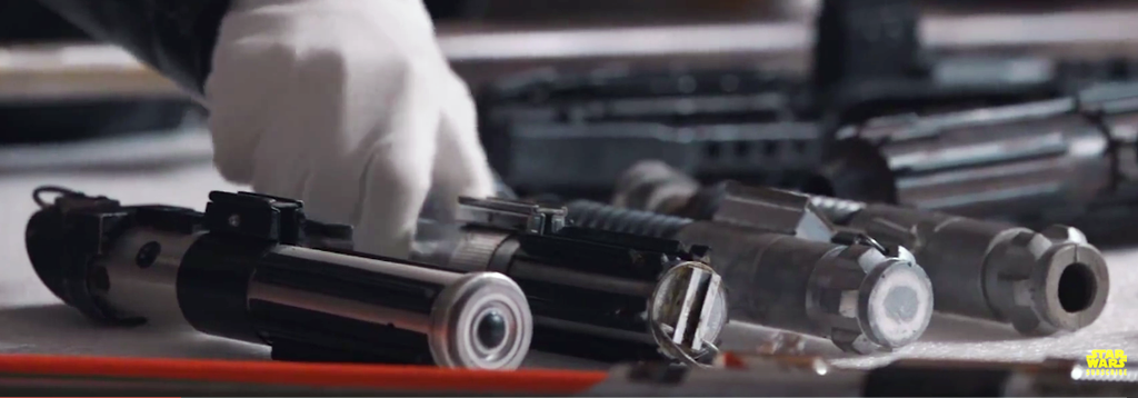

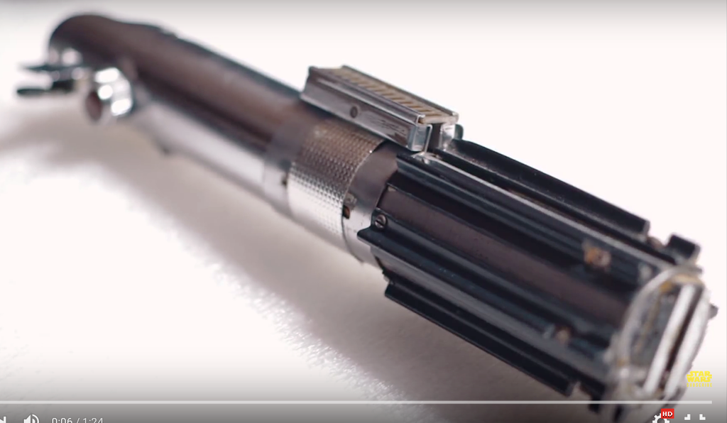

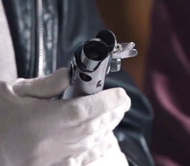

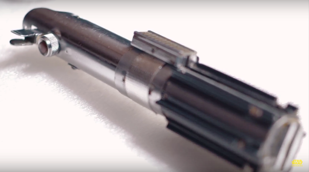

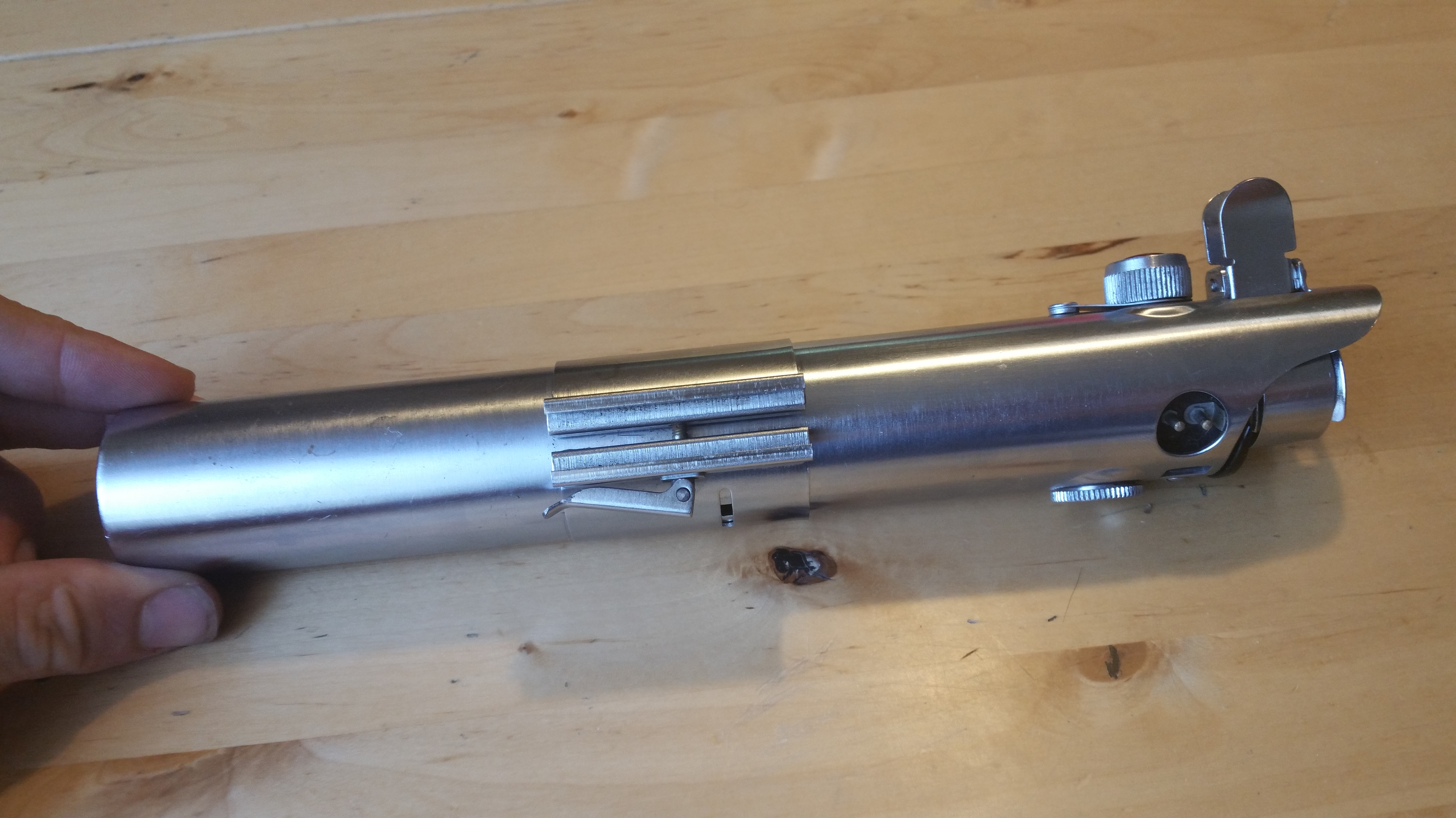

Here are some pictures of the Ranch Saber. It looks like the bunny-ear rivet was removed.
Clamp detail
[url]http://i256.photobucket.com/albums/hh187/raul_winchester/Dibujo2_1.png[/URL]
Red Button detail
[url]http://i256.photobucket.com/albums/hh187/raul_winchester/Dibujo_1.png[/URL]
Sabers
[url]http://i256.photobucket.com/albums/hh187/raul_winchester/Dibujo4_1.png[/URL]
Bunny Ear
[url]http://i256.photobucket.com/albums/hh187/raul_winchester/Dibujo3_1.png[/URL]
Resource
https://youtu.be/JWAniYowdeA

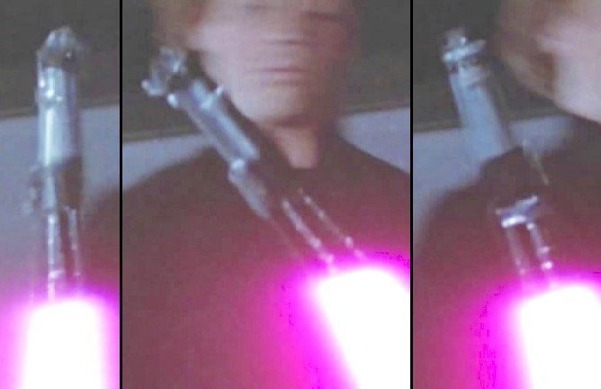

Hold on, could this be the barge climbing saber? It is a casting of a ROTJ saber with a graflex clamp lever, which would make it a hollow cast of the V2 or the Shared Stunt, a cast of an ANH era prop! (check above the pommel cubes/ring on the ROTJ hero casting.)
