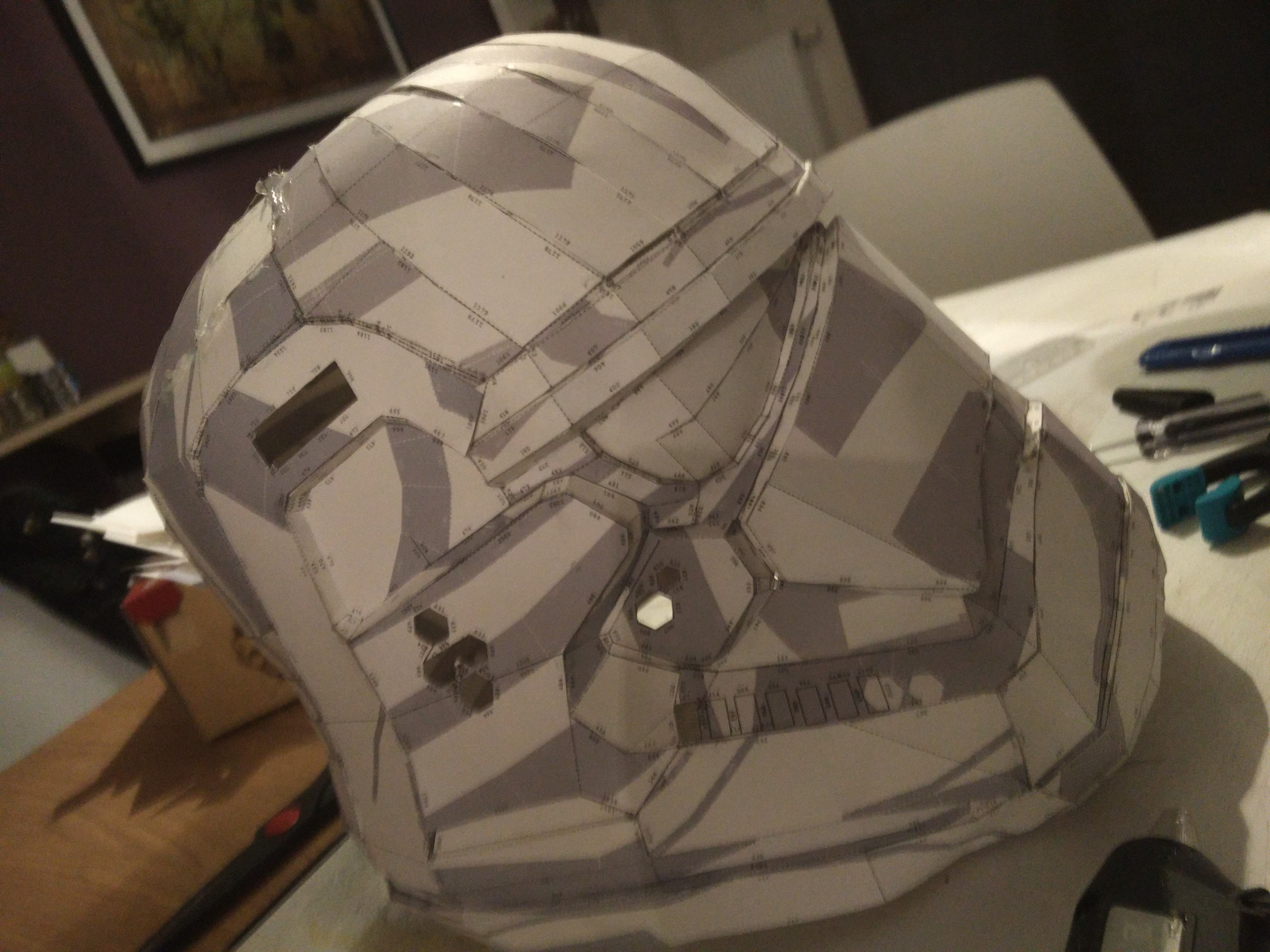

Re: Free starwars the force awakens pepakura files
Pepped troopie bucket
Sent from my ONE A2003 using Tapatalk

Fu ing crazy man that looks good maybe I will try kylo's bucket after I finished my troopie
