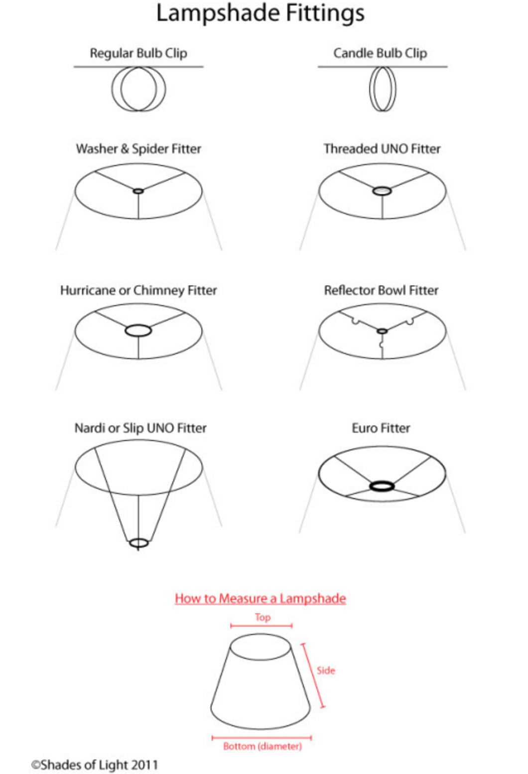

Hey guys - just an fyi. I think CCarson had mentioned to have the artwork printed upside down for the lamp shade because zazzle places the fitter upside down. Actually, the fitter is placed on correctly by Zazzle. ONLY follow the posters above directions to printing the art upside down if follow his exact lamp build. If you do NOT follow his exact lamp build, then DO NOT print it upside down. They use a fitter that is supposed to fit around the base of the bulb assembly, hence this is why the fitter is located at the bottom. The fitter is NOT designed to accommodate a standard shade harp and a finial. So please do NOT print your artwork upside down. Just be sure that you lamp bulb assembly can accommodate a 'Slip Uno Fitter'. That is the actual name for this type of shade fitter. The name of the fitter that mounts at the top of a lamp shade and requires a screw-in finial is called a 'washer spider fitter', and is the most common type of fitter. Unfortunately, Zazzle does not make shades that use the spider fitter....and that's really unfortunate. Anyway, just sending out a word of caution to NOT print your artwork upside down if making a lamp under normal circumstances. -Dave
***Should you have already made an order with the artwork upside down and has been delivered to you, simply call Zazzle and explain what happened. They will give you a refund in store credit to re-purchase the shades. Yay!

They use a fitter that is supposed to fit around the base of the bulb assembly, hence this is why the fitter is located at the bottom. The fitter is NOT designed to accommodate a standard shade harp and a finial. So please do NOT print your artwork upside down. Just be sure that your lamp bulb assembly can accommodate a 'Slip Uno Fitter'. That is the actual name for this type of shade fitter. The name of the fitter that mounts at the top of a lamp shade and requires a screw-in finial is called a 'washer spider fitter', and is the most common type of fitter. Unfortunately, Zazzle does not make shades that use the spider fitter....and that's really unfortunate. Anyway, just sending out a word of caution to NOT print your artwork upside down if making a lamp under normal circumstances. -Dave
I believe he's saying the Joe-lamp is a "washer & spider fitter" (in picture where the RING is at the TOP) and Zazzle uses the "slip Uno Fitter"...(where the ring is closer to the bottom.)
Printing upside down would make the ring be closer to the top. (but not AT the top...?) If you're going to make the rest of YOUR lamp, the same as HIS lamp, you can print upside down and make the ring near the top work.
Alternately, you can print not-upside-down and make the "washer & spider fitter" shape and add (or replace) the incorrect type of fitting from Zazzle.
It needs modification either way, or adjustment to your design to handle a ring at the bottom instead of top.
