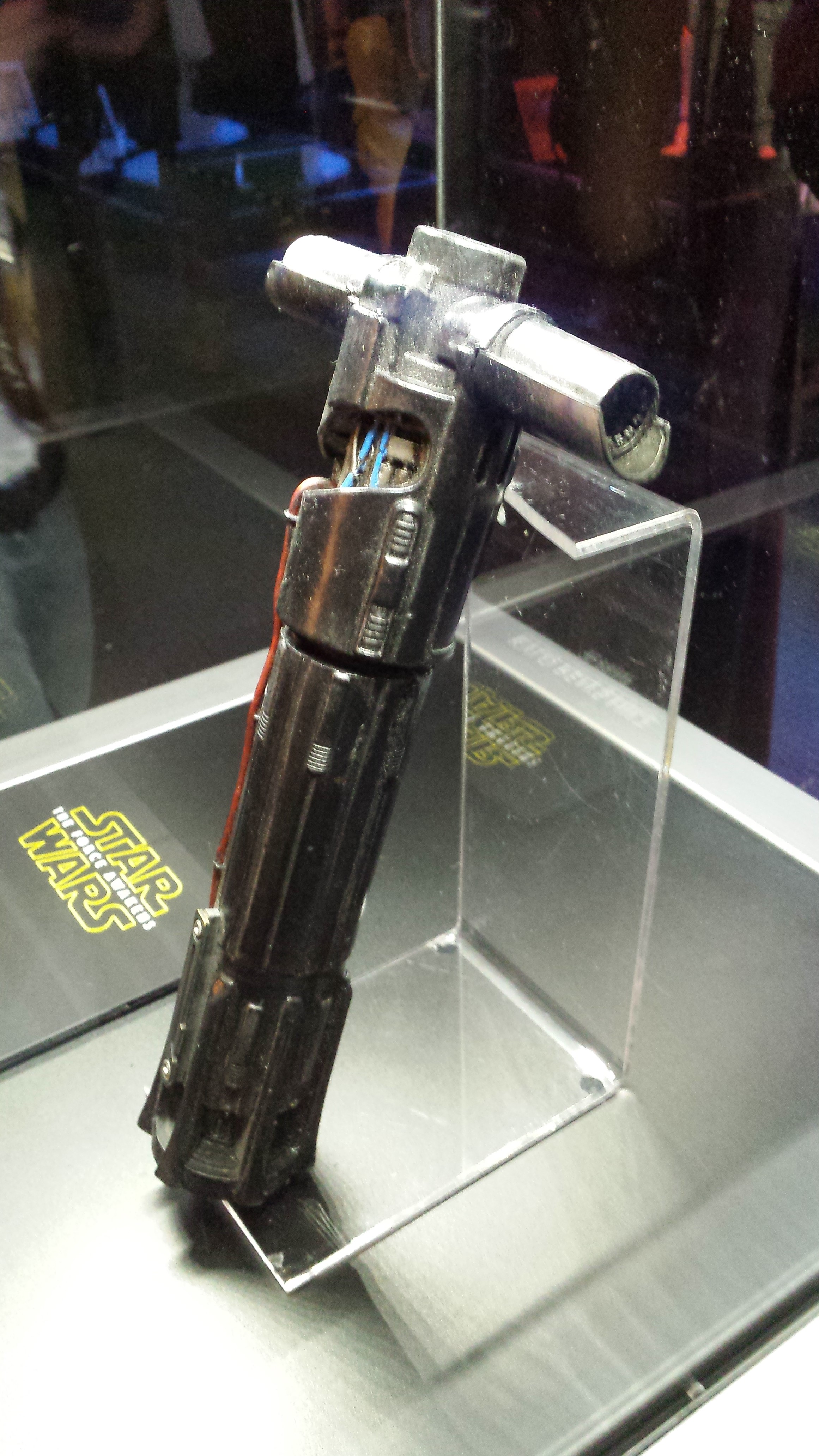

Back in 2015 i went to Star Wars Celebration in Aneheim, less than a month from the release of the Force Awakens. It was my first Celebration and wow what an experience, it all started with the TFA trailer and that last line, Chewie were home. Of course I cried. During my visit i went to an exhibit of the TFA props and costums and I saw this:
I took plenty of pics and I became obseced with this hilt. So I decided to 3d model it and created this thread: Kylo Ren Saber hollow hilt for electronics

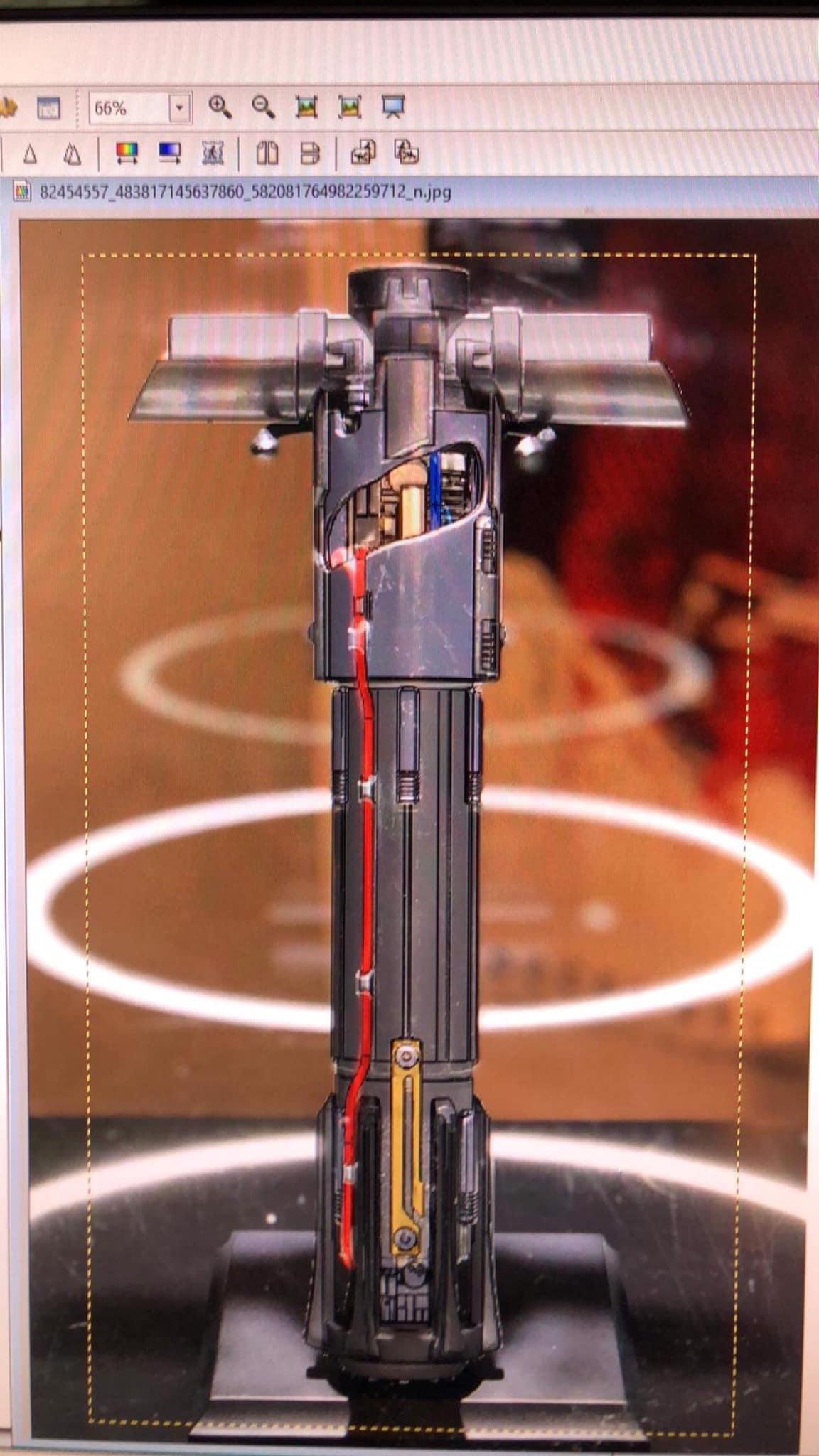

Here’s a great picture that demonstrates this just to give you an idea, photogrammetry was used to meticulously create the most accurate model possible, even tracing the exact obscure shape of the open gash on the shroud that exposes the core. This kind of attention to detail has never been achieved before on a Crossguard!
Also I thought it would be good to post a copy of this promo image here. This is the Hero Prop our model is based on, where our wire clip locations and everything else is derived from.

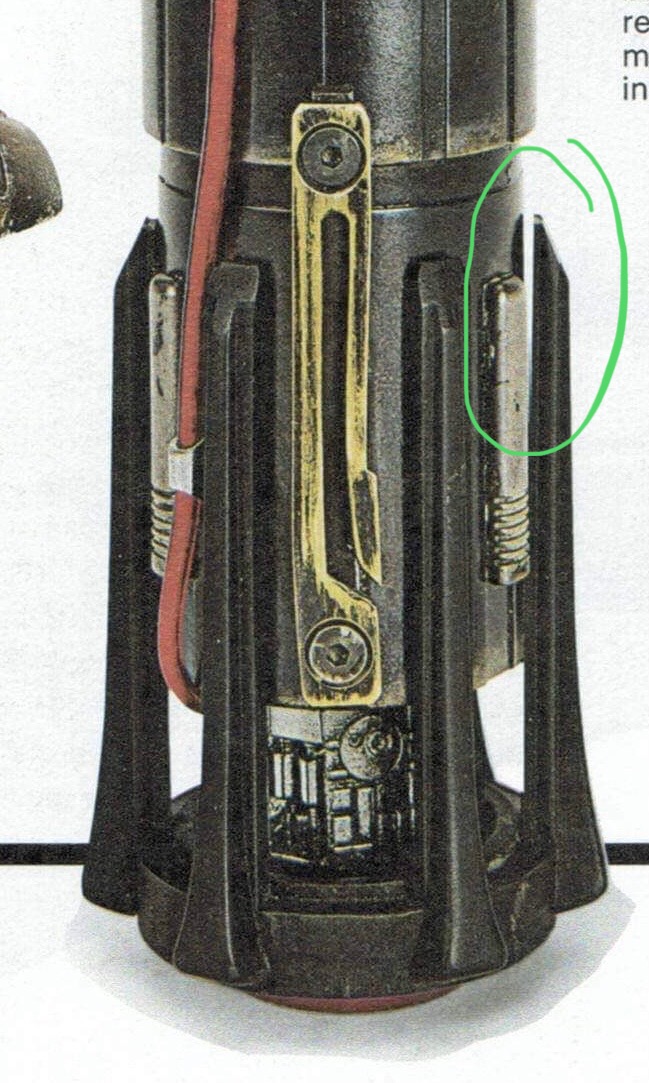

Any plans to have the entire pommel removable, like the construction of the real prop? The “cage” was a separate piece from the saber itself. You can see a gap here:
The Pommel Cage is removable yes, it will likely have a dovetail system like the V3 does. This is how it was on the original prop too, that is correct.
However the dovetail in that “gap” has been photoshopped out mistakenly where you circled it on the right, the supports do not float like that. Notice the dovetail is still visible on the left pommel support. The dovetails were partially exposed.
We made sure to include every single detail!

The Pommel Cage is removable yes, it will likely have a dovetail system like the V3 does. This is how it was on the original prop too.
The dovetail has been photoshopped out mistakenly where you circled it on the right, they do not float like that. Notice the dovetail is still visible on the left pommel support. The dovetails were partially exposed.
