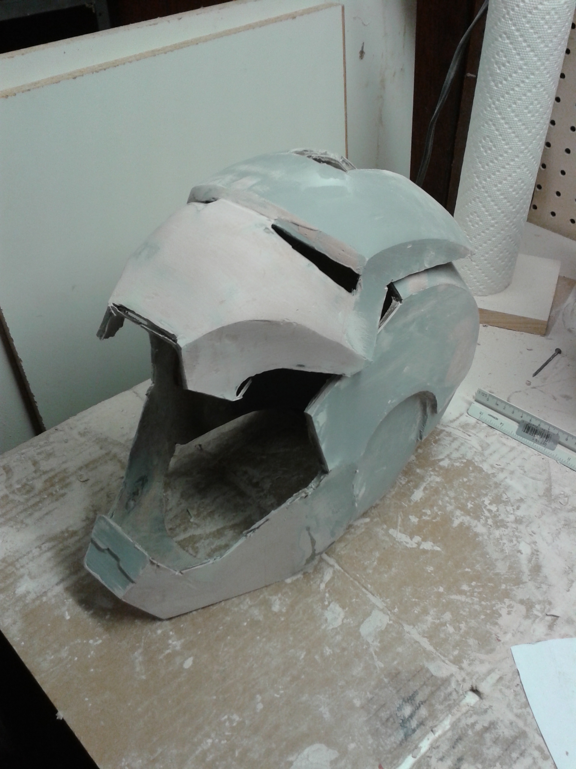

Finally some progress, if not very much. I've finally finished fibreglassing the inside. I am really happy with how strong it is now. Sanded and one final coat of resin, and I finally got to slap some bondo on it. Now that the weather is a little warmer and my workshop is in order (we moved last month) I'm hoping to make some steady progress.

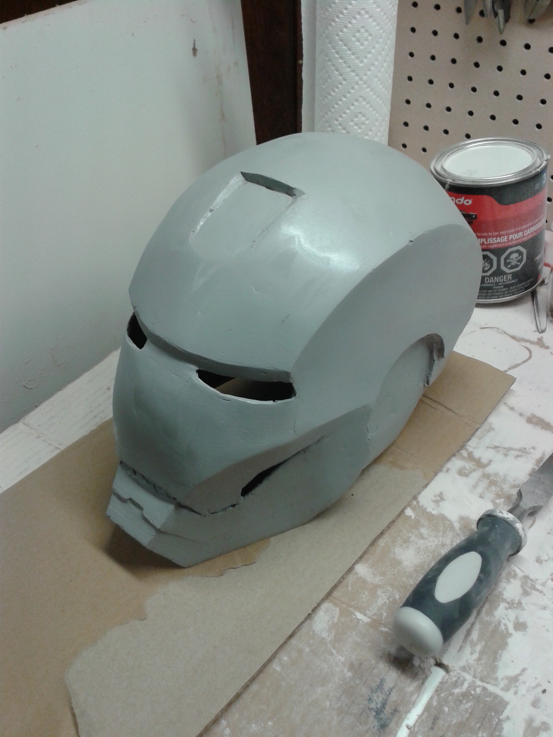

Little further along in bondo. It's going to be a lot of work. Can't wait to paint but I'm really hoping to get it close to the quality of so many amazing helmets I've seen on this site.

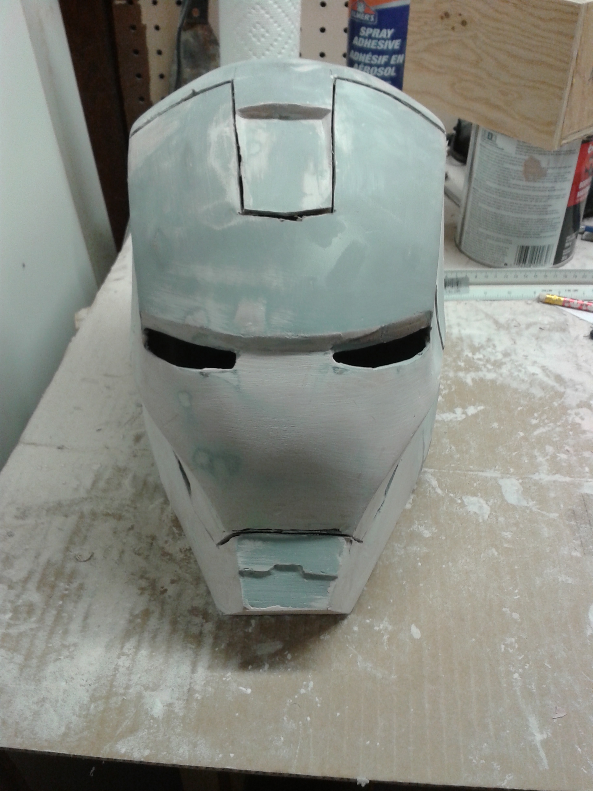

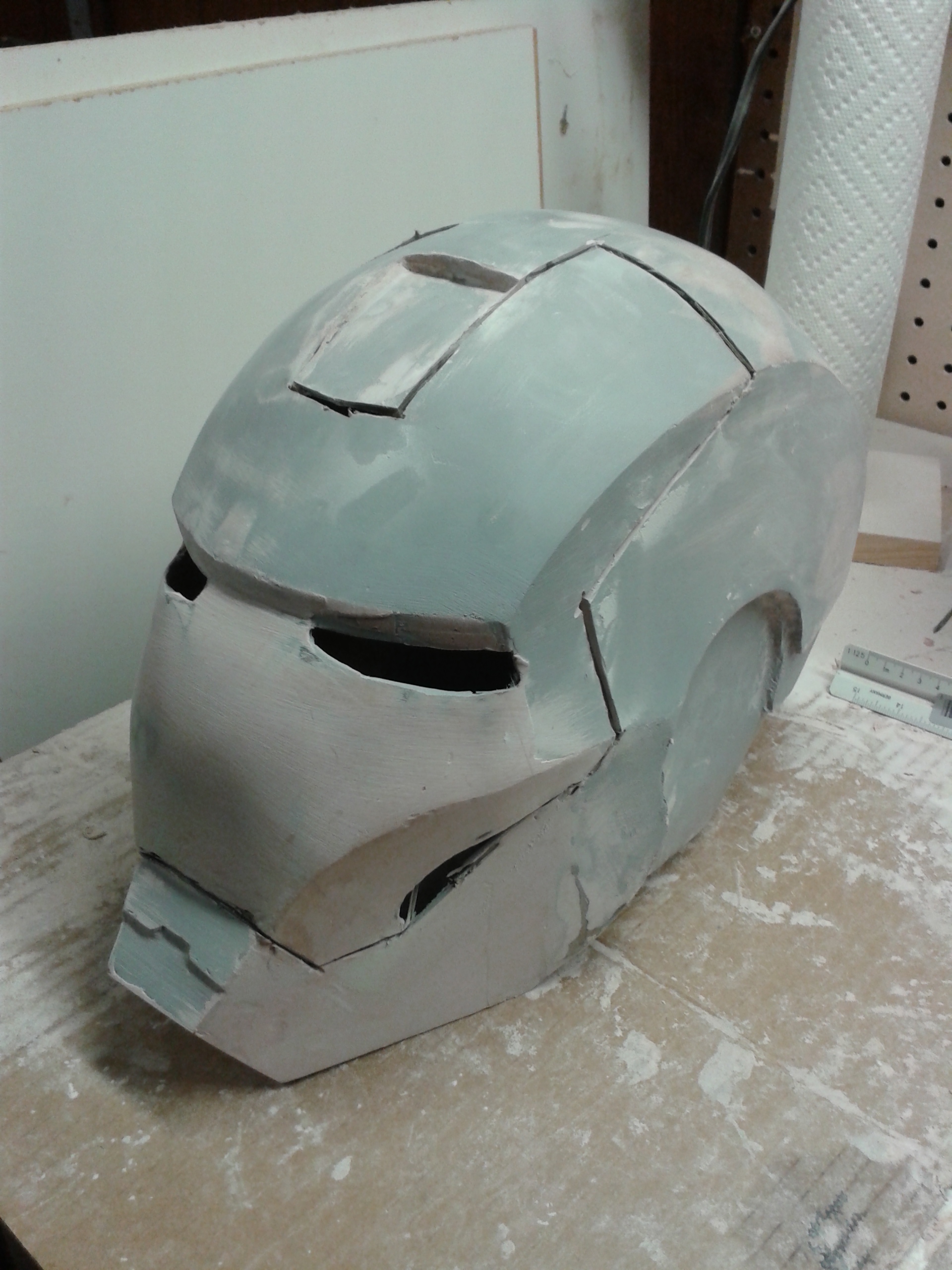

Some more update pics. It's a slow process, but there is no rush. Got the faceplate cut off, so some of the detailing will be a little easier to access.
