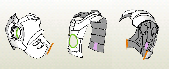

I'm going to start the Brace and Back now. I've searched for this and couldn't find an answer so I'll ask: Does the front chest connect to the back piece and then "float" over the brace, or does everything connect to the Brace? Basically once I have all the pieces made, what connects to what?

I've colorized here where to glue the parts together :
And here, how to connect collar plates to the top of the back/chest :
anyway, it's the way I did... The result is a one-piece torso that you put on just like a T-shirt.
