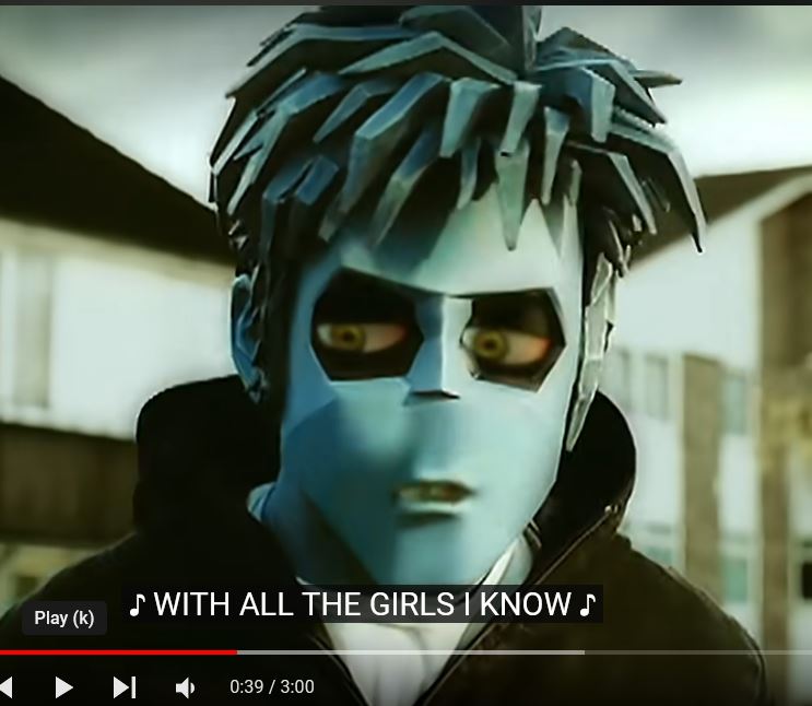

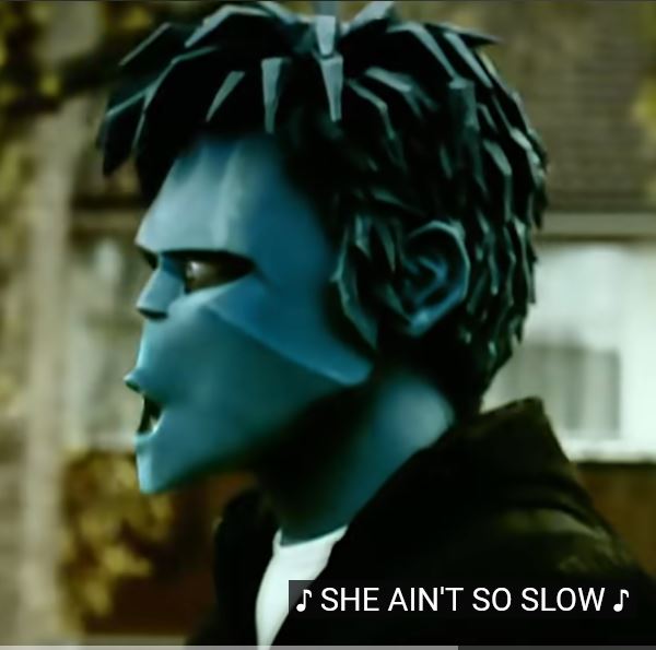

Wow! Maybe I *WILL* make an Offspring Hit That mask. That stuff looks great.
