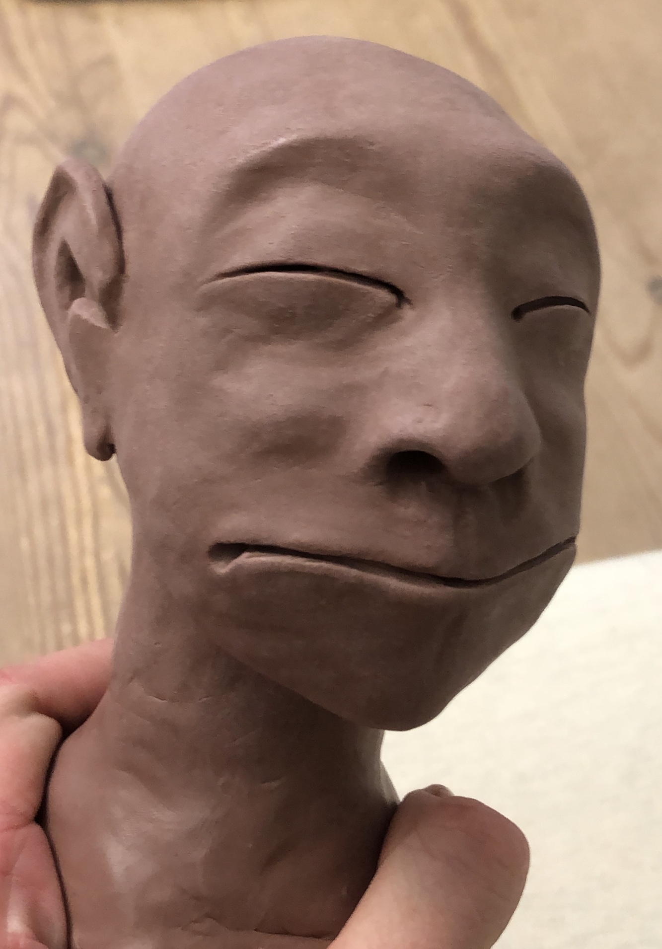

First is the model made from Monster Clay.
So, for being my first ever sculpt it turned out rather well.
Will probably name him Jean Luc. :D

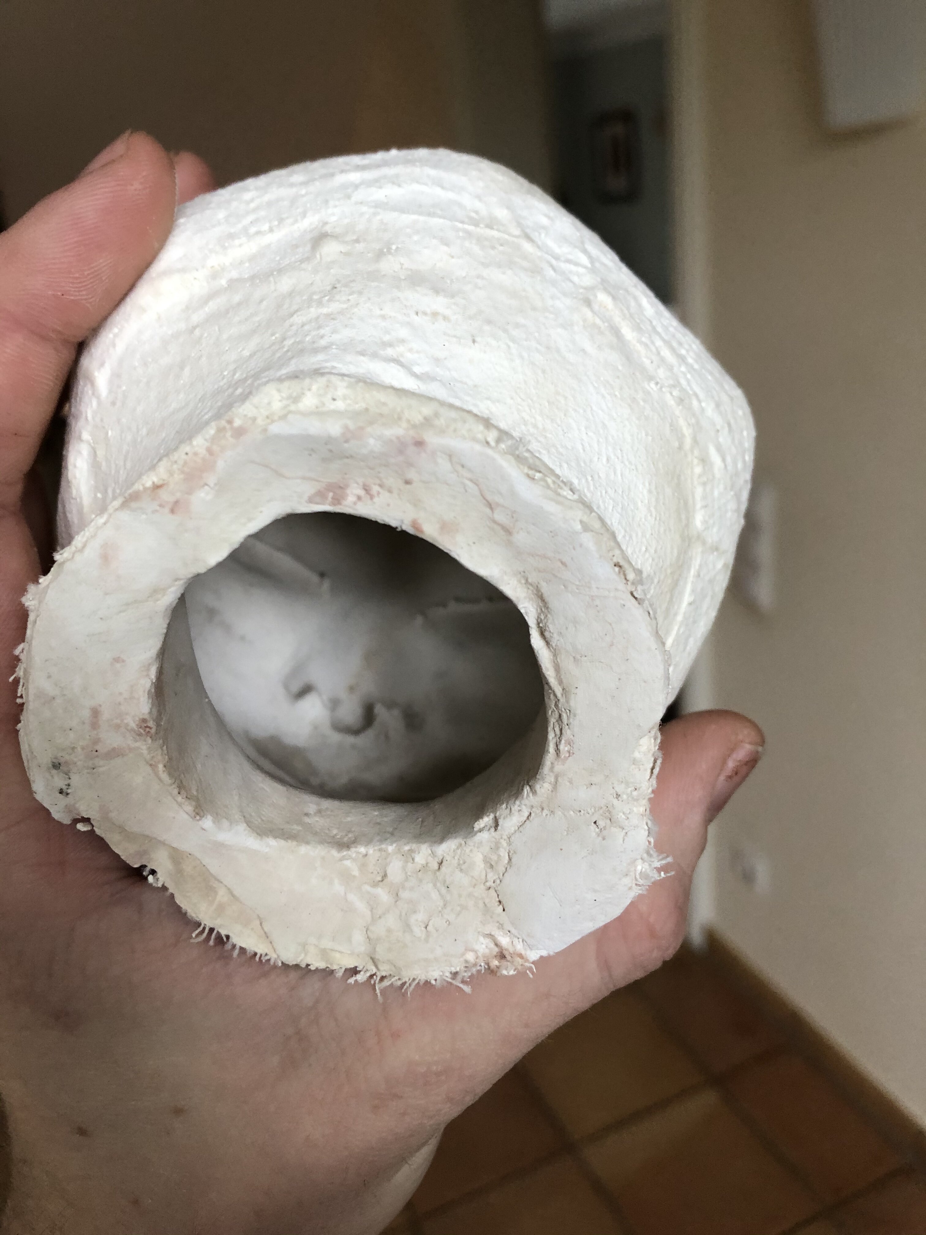

And the mold is done.
Not a lot to say about it. Its a standart latex mask mould.
Turned out well, the monster clay can be mostly removed through melting by heatgun. The rest was dissolved with a solvent.

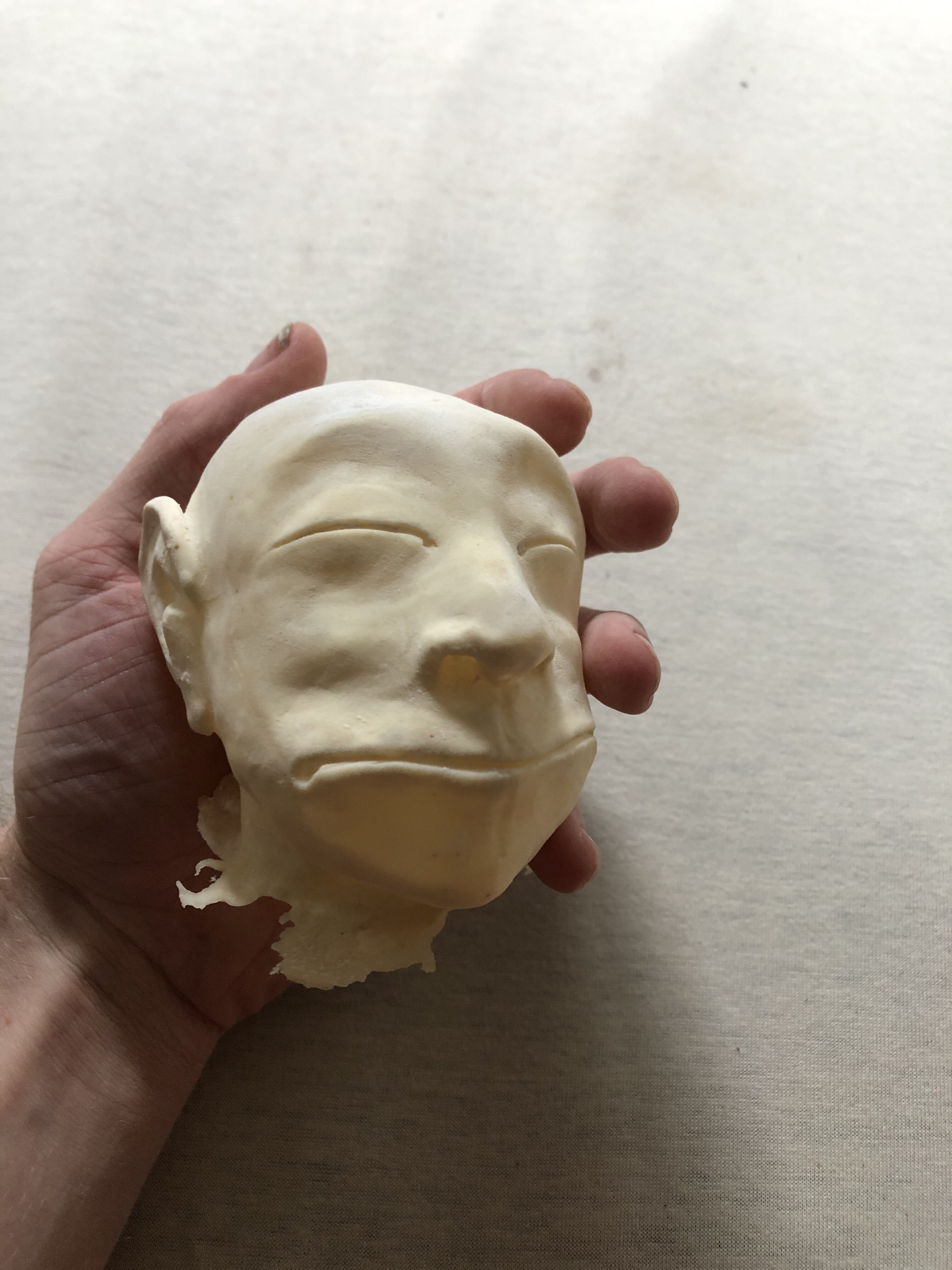

So, did a test pour to see how it works and to clean up the mold a bit.
For a fast and dirty test it turned out surprisingly good.

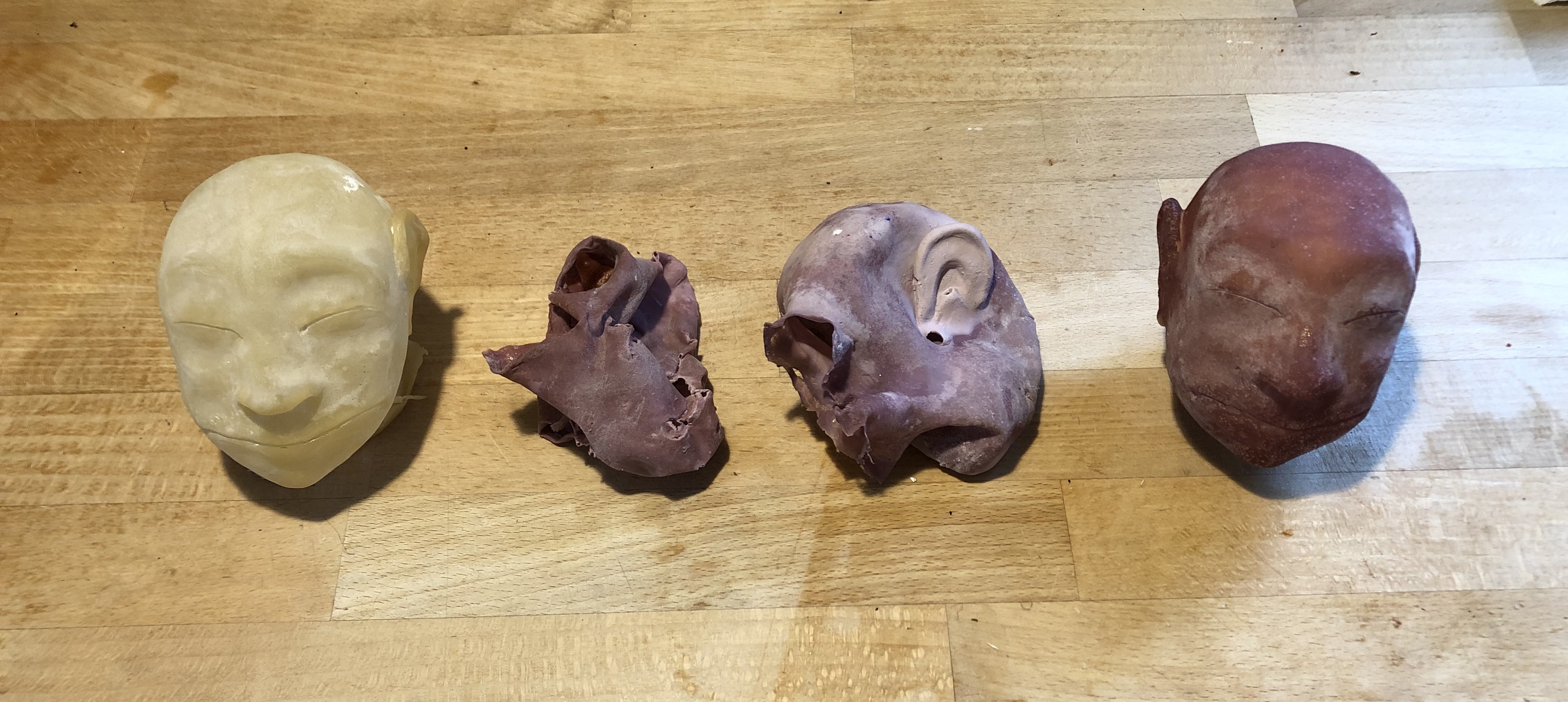

Now its slowly working myself towards the right colour.
I am using specific Latex Pigments so I do not have some reactions in the materials down the line. (Latex can be pretty suceptible to averse reactions that lead to an early destruction of the part)
I am not there yet, but getting closer.

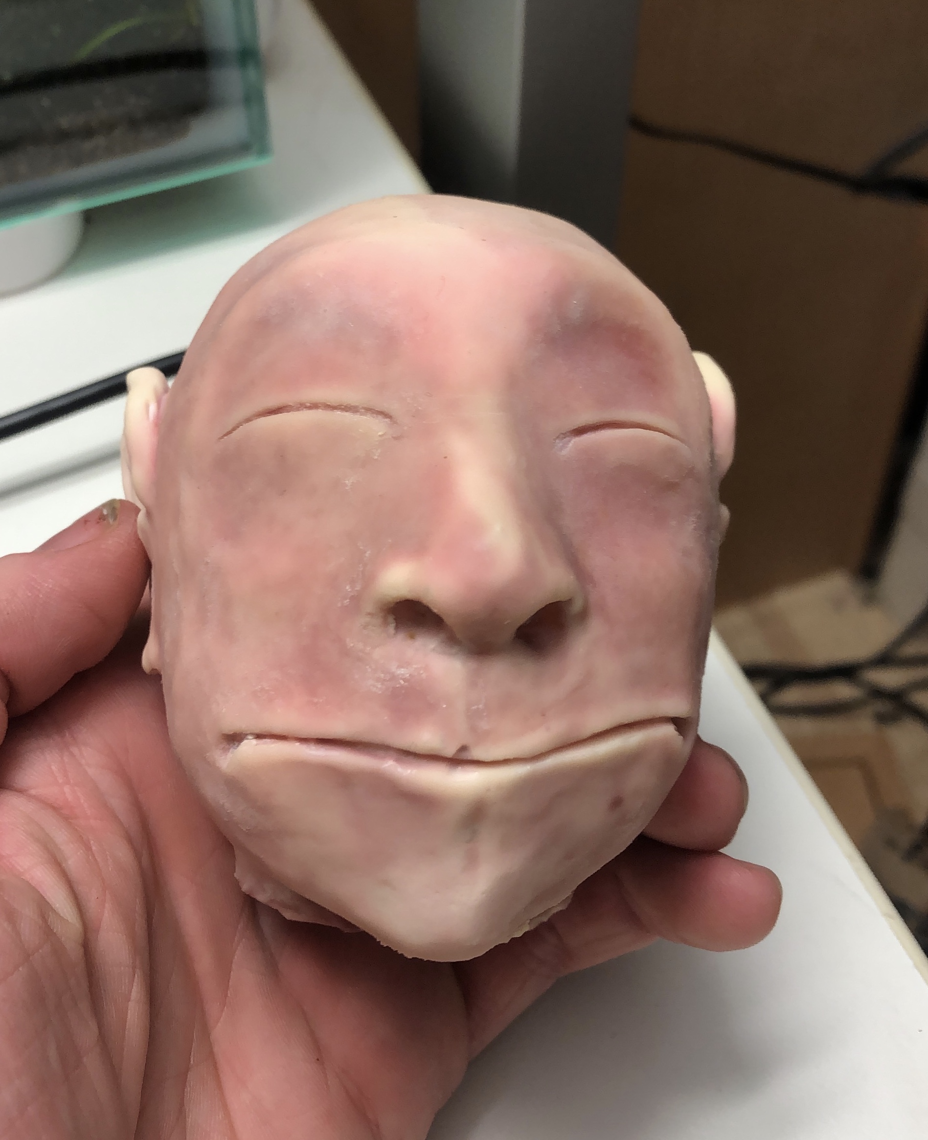

Today I did a bit more playing around with colour. I will definitely need some orange or yellow pogment to get a better skin tone.
But I also did a think while working on my aquarium and came up with an idea for a more realistic colouring.
Real skin is layered and translucent. So just pouring the coloured latex will always create a flat and artificial look.
But uncoloured latex is too, translucent, and has a somewhat similar tone to the upper skin layer. So why not do a pour of thinned latex first, followed by the coloured latex.
The result has a nice look to it. The colour is obviously still off (and the latex is not completely translucent yet) but I like the sickly and more natural look it creates.
