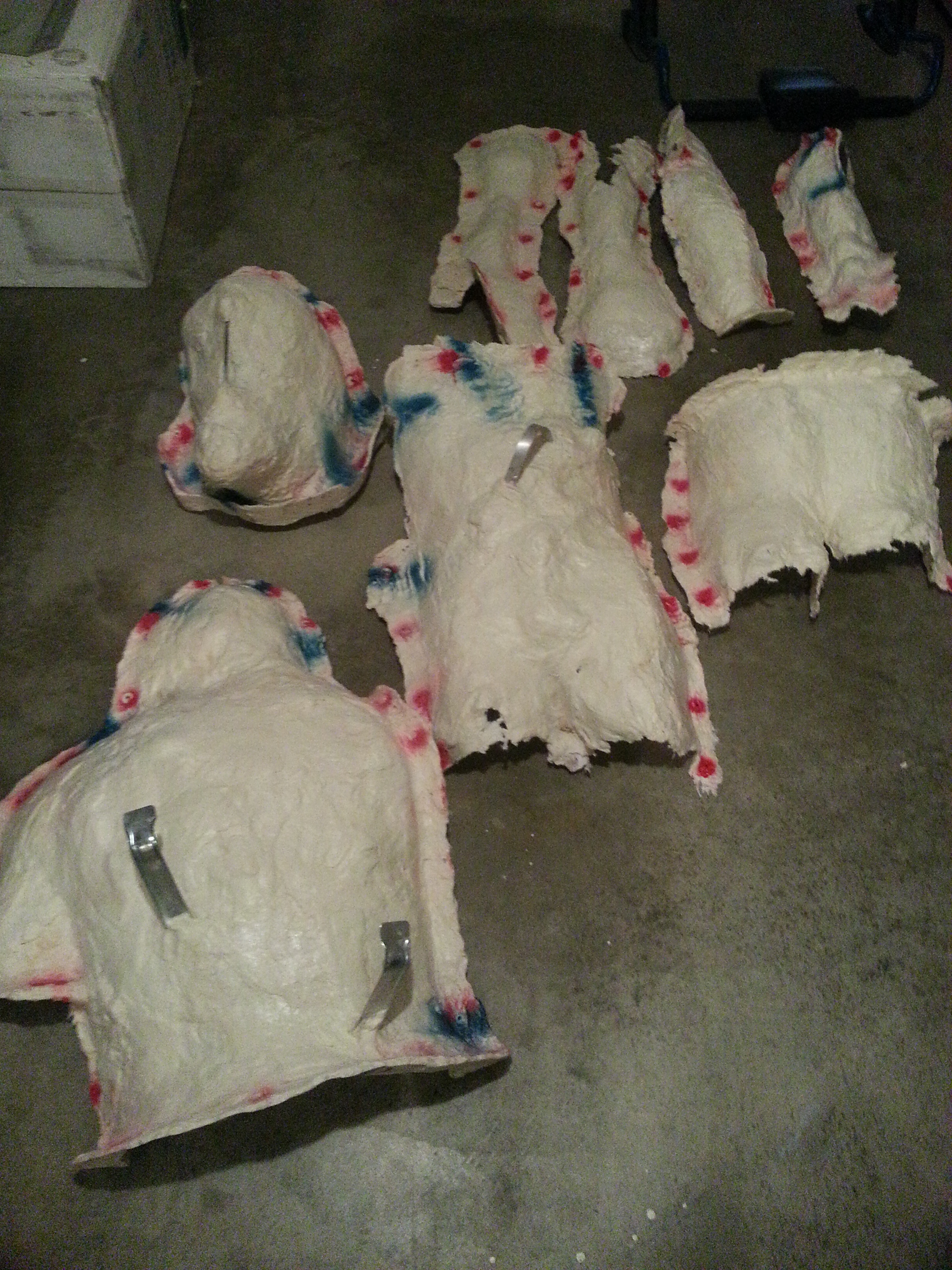

OK demolded today...An eight peace mother mold, put a dab of red spray paint over all of my screw holes to make them essayer to find and a few streaks of blue over some arias of the seams to help match up the sides...... cleaned out the clay and should be able to cast after work tomorrow... A race to the finish.

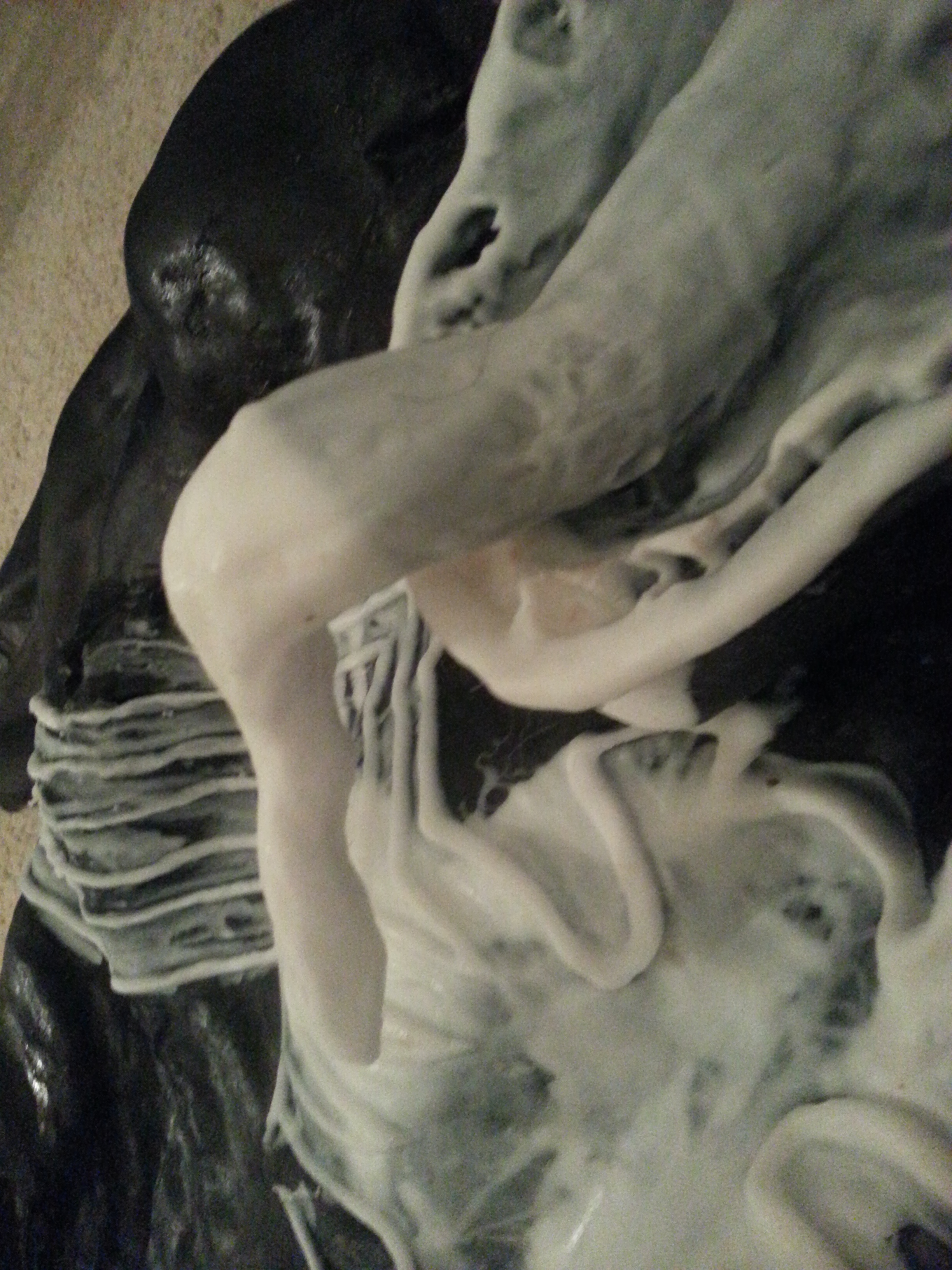

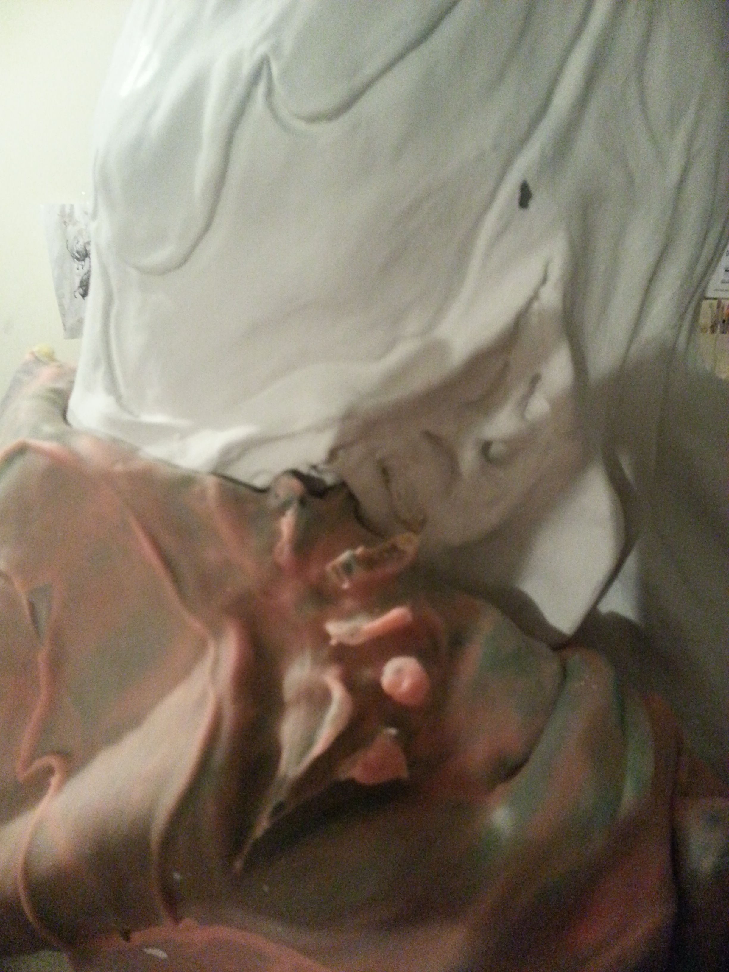

Well boys and girls, Did my first pull tonight. the details around the symbol came out nice and the seams lined up nicely. The white is just to make airbrushing easier later. I figured spraying white on black Might be a bit problematic. The jaw line and face also came out nice (hard to tell from picks) But I did use to much silicone in the left hand and so 3 of the fingers are solid silicone. The tongue suffered the same fate as well. All fixable given the time and effort. So as i am on a time schedule i will be putting aside Venom for the foreseeable future and will pick him up later. I will have to pull out one of my old costumes for the Con in Chicago...
