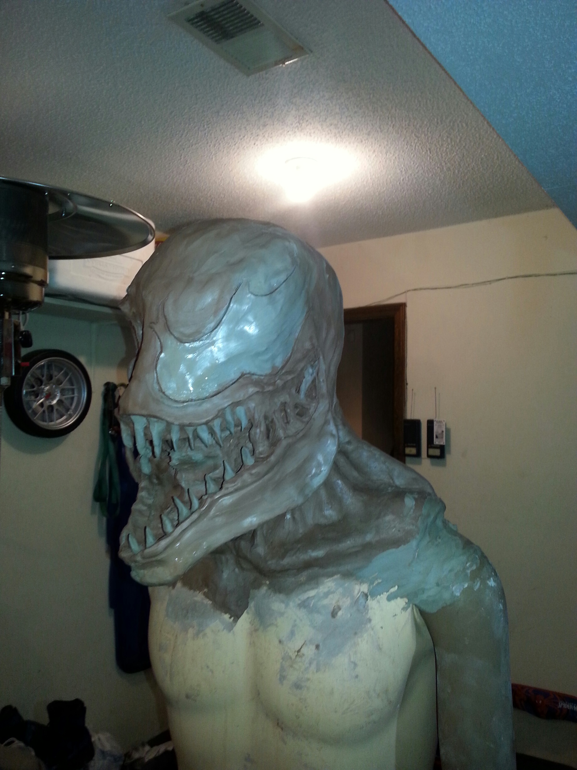

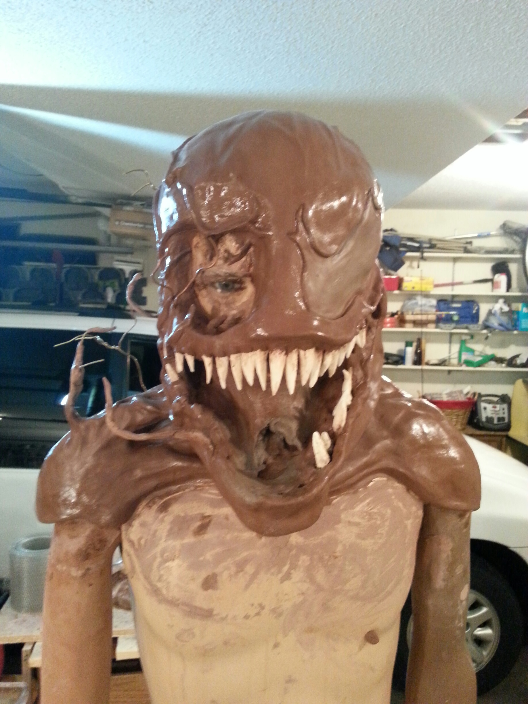

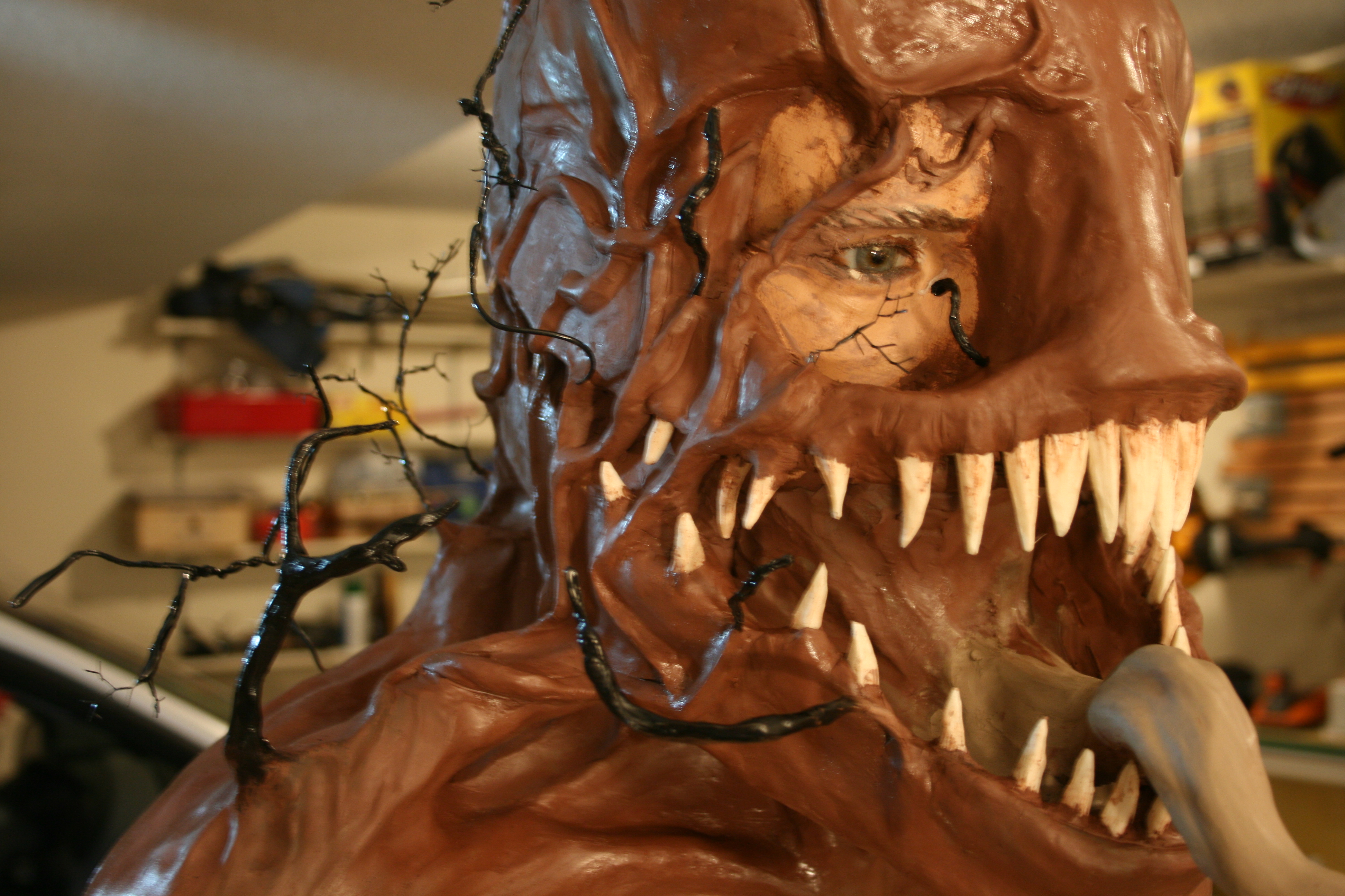

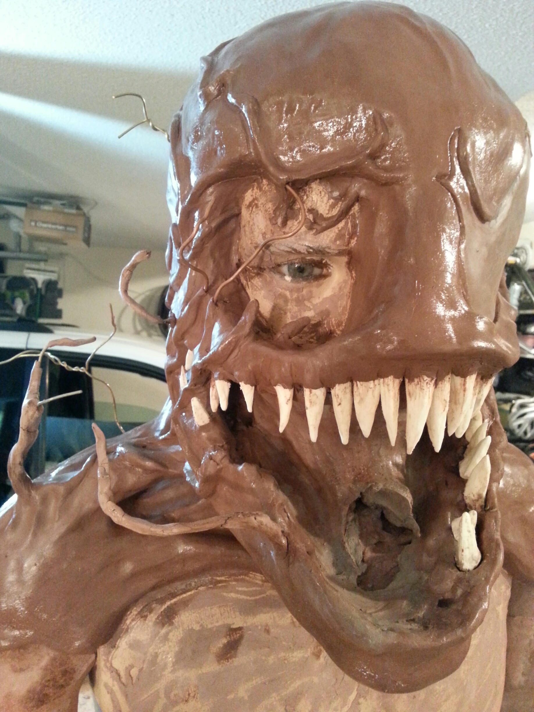

I am planning on sculpting a full venom body suit but have never taken on a project of this magnitude and have some questions as I am trying to decide on how to best build the piece. I know the clay sculpt is ruff right now. I have built it on a fiberglass and aluminum frame so that the jaw will move with grate ease. I first designed a pulley system and quickly abandoned that idea I then looked into solenoids and decided that would not work well for realistic motion. I finally settled on elastic bands with a formed chin rest (keep it simple stupid). The aluminum platform in the jaw will also serve as an anchor point for a motor that will make the tong flop on command. Tubing will be run from a reservoir with a priming pump to the mouth so that I can simulate salivation. I will share my specs for the co2 powered web shooter after working out the kinks. In the mean time my questions to all of you are as follows:
1. Should I make it out of silicone or latex.
(I know silicone would look more realistic but I am worried about seaming such a large suit together as I have not seen any video posts on how to do it )
2. If I want to sculpt the hands how would I use the silicone with a two piece mold. (poring latex would be much cheaper and easier but won’t move as well)

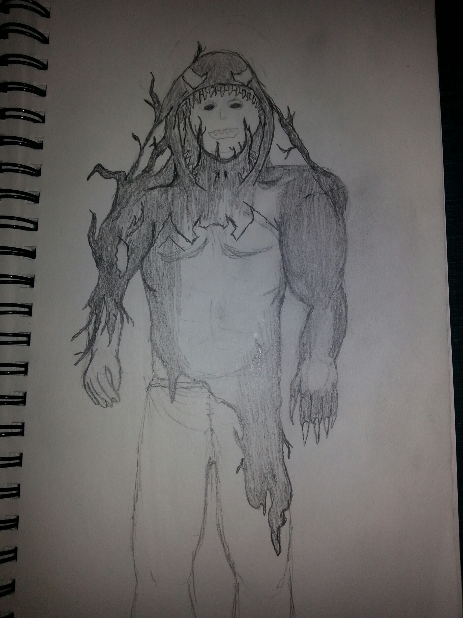

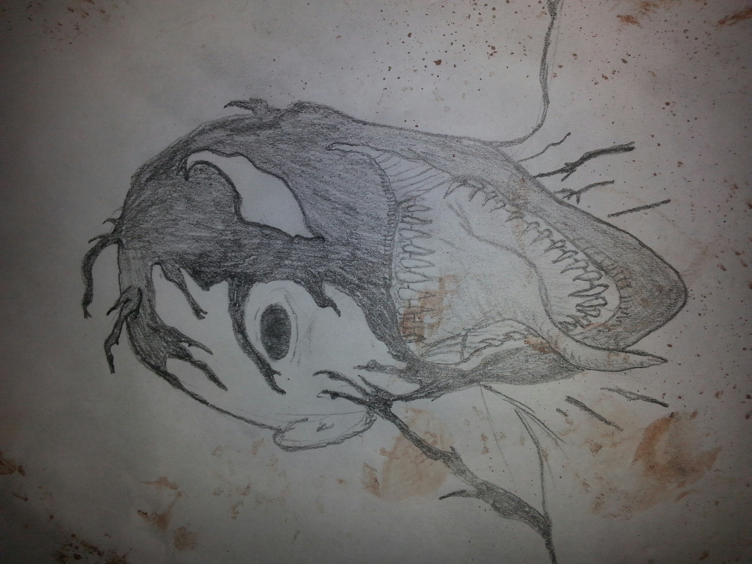

3. Should I keep with the tendril look (the symbiote fusing with Brock or should I scratch that idea and keep with the traditional full suit. Take a look at some of my ruff sketches and let me know what you think.)
I know my first sculpt looked more like the violator than venom. (Hence the change.)
the third pick is the tendrils taking over the left side of the face (still needs a lot of work) (the teeth will be changed out this weekend for molded pieces)

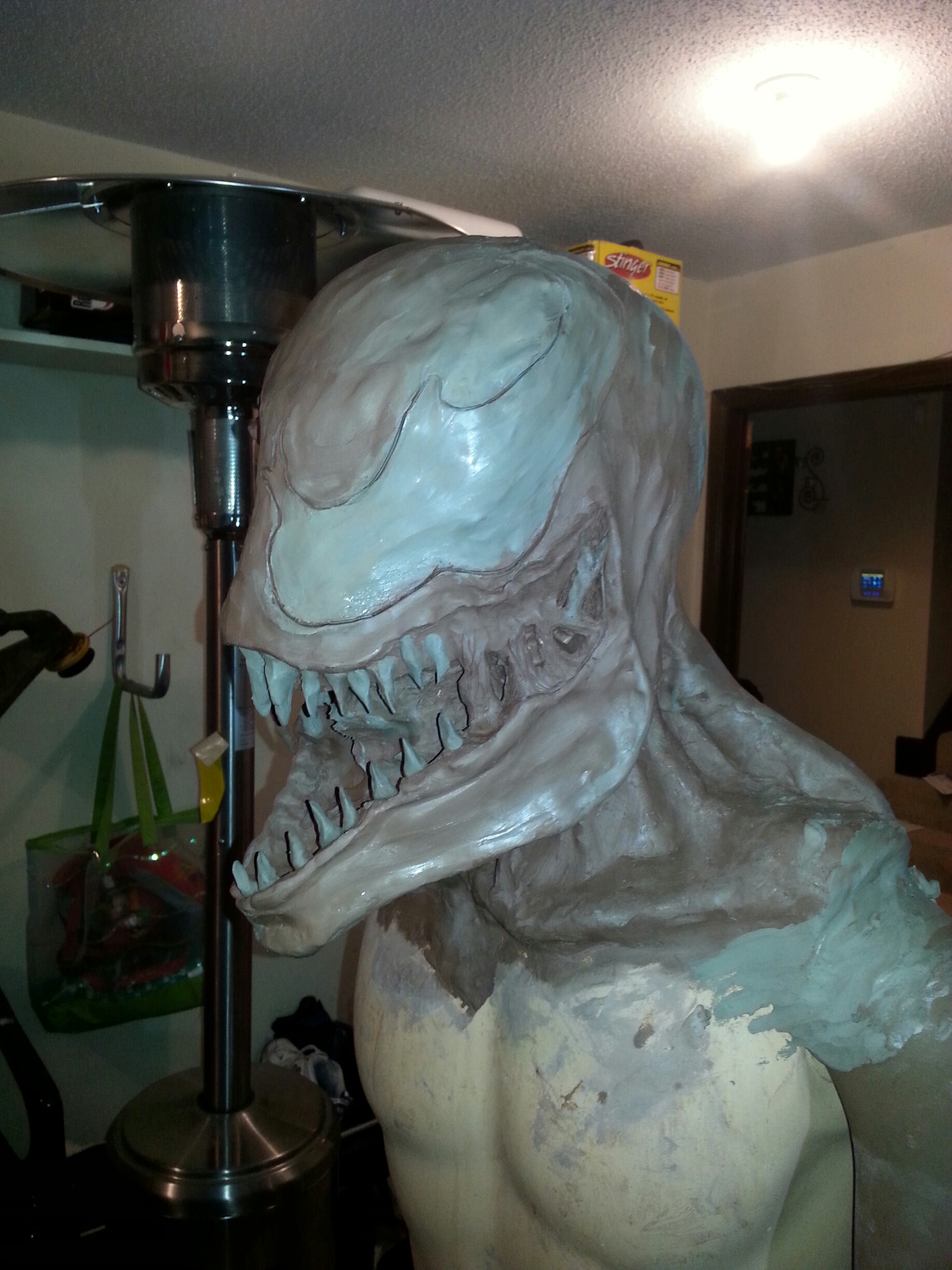

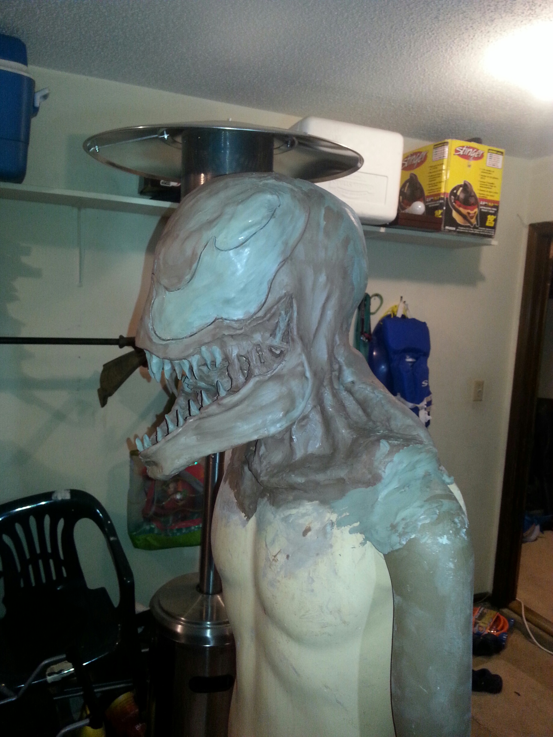

work as of 5/3/14
starting to look like venom but still needs some work

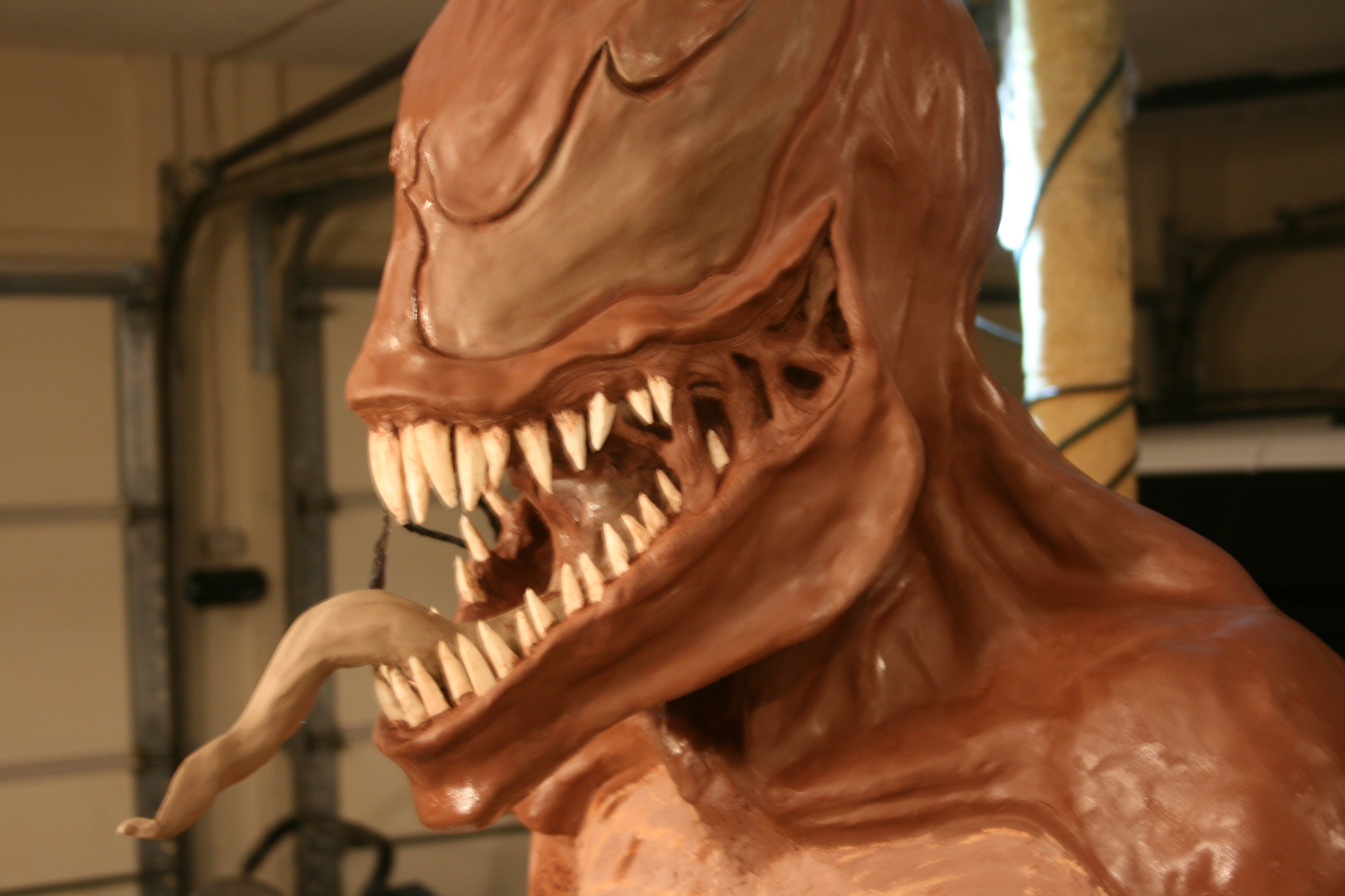

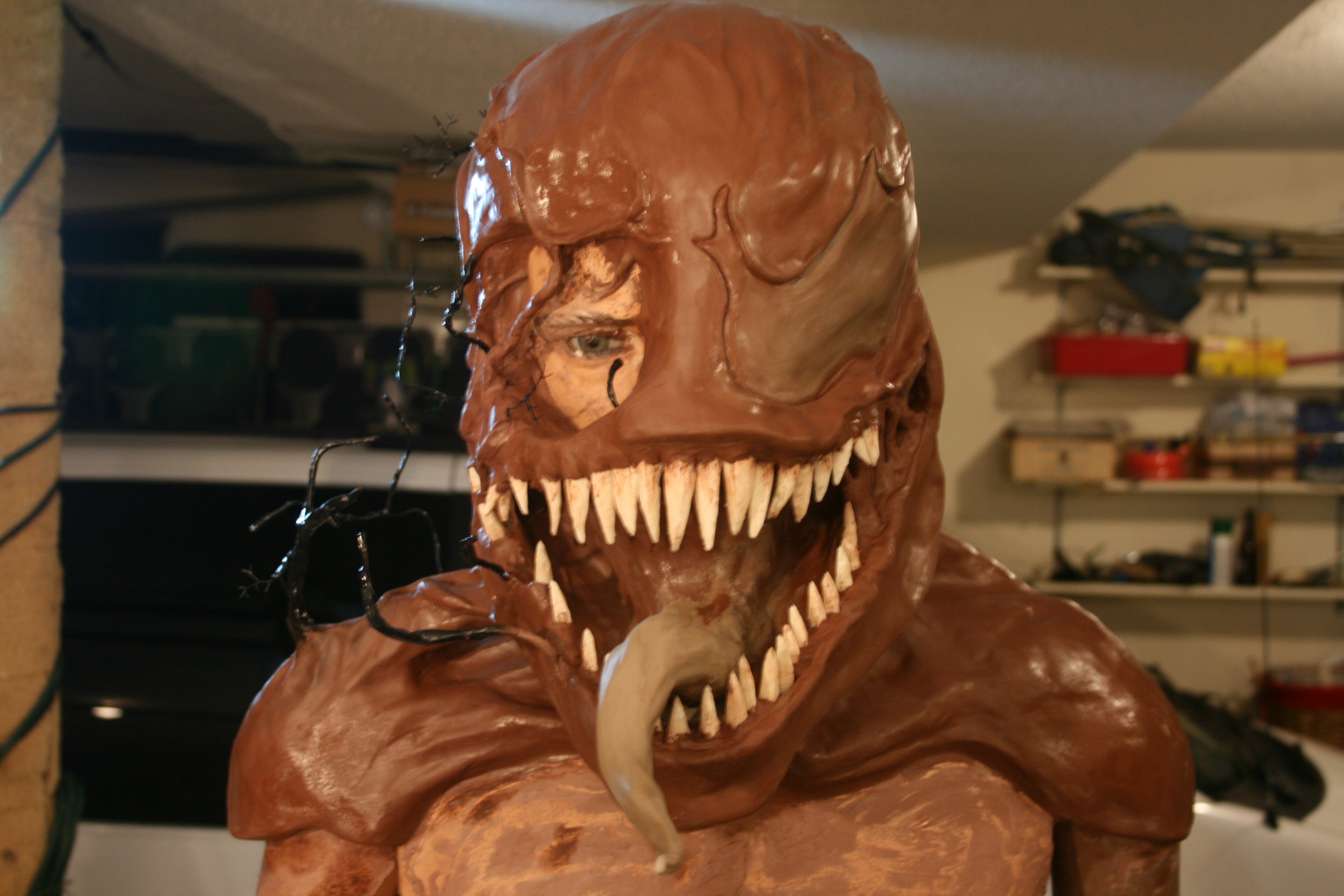

Well another day down. worked on making the teeth today and i think the staggered look is the best. otherwise it looks to uniform. take a look at the picks and video and let me know your thoughts.
20140514_233511_resized (1).jpg20140514_233521_resized.jpg20140514_233529_resized.jpg
Great work so far Chaz, this is a really awesome and ambitious take on Venom. I personally like the upper teeth how they are and the offset look that you've got going for them. Are you planning on only having the one open eye to see out of when you wear the completed suit? Also I noticed in your sketches that the symbiote won't be covering the whole body. Will the completed suit also follow this semi-formed look?
Yes the plan is to only expose the right eye (I will be wearing my black out scleral contact in that eye) it will Jack with my peripheral vision but it is doable I did it one other time years ago with a terminator peace and my other I was covered up with the red LED. I plan to continue with a semi formed look. However I have this all planned so that I can add additional pieces such as the legs and feet if the semi formed suit down to my knees does not turn out as I imagined it. As you can see with my original sketch my face was going to be inside of the mouth but quickly change that so that I could go with a more unique look something a little different then what I was seeing with other peoples work. Ithink I'm getting close to being done with the head sculpt and will be casting it soon here's a full video link take a look and let me know what you think. After I cast the head I will begin working on the body late next week probably. as long as my wife doesn't kill me for spending too much time in the garage haha.
