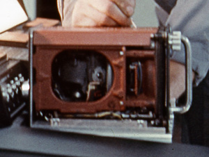

As identified by Dennis the core of the AE-35 is a real Gyroscope, he even provided a picture of the one which he acquired. Unfortunately reverse image searching the photo doesn't come up with anything particularly useful so I had to gather some more information from the film.

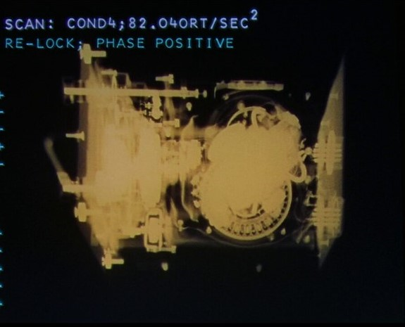

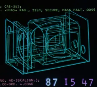

The film uses some suspiciously detailed xrays and 3D representations of the prop. Assuming that both images are genuine Xrays the Gyro has some more distinct features not visible in Dennis's image above.
There are two objects sticking out from each end which could be connectors or control nobs.
It could also possibly have a circular screen/dial on the same face as the two smaller nobs.

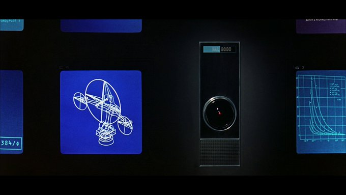

Abitofcredit, be careful with the second "XRay" of the gyro: this is a wire representation that Doug Trumbull made of the prop (animation cells), hence the two circles at the back and front. While the knobs are in their right place (the ones near the handle), the other aluminium greeblies at the other end were added by the prop makers and serve no purpose technically.
Do you have a source for this information joberg?
I have found evidence that Doug created the wire frame for the actual antenna but cannot find any reference to him creating the AE-35 unit diagram in the same fashion. It may be the case so I will keep hunting.
A future quick project might be to recreate the wire antenna model as seen in the images above because it looks awesome!

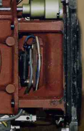

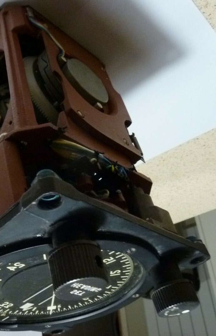

With regards to the aluminium greeblies, I agree. Something was definitely added although looking at the xray/scanned image below it seems fairly clear that the two military connectors on the gyroscope are still attached, it is even possible to see the metal contact pins. The connectors must have an aluminium cap over the top of them to make them more reflective and to give them the rounded shape seen in the close up shots in the film.
The two control nobs by the handle on the AE-35 look incredibly similar to those used on the gyroscope and may just be painted. It does look however like the control nobs on the gyro I have bought are not the same size so I may have to find or manufacture a replacement or attempt to cut/sand it down to the correct thickness. I will be able to confirm this once it arrives.

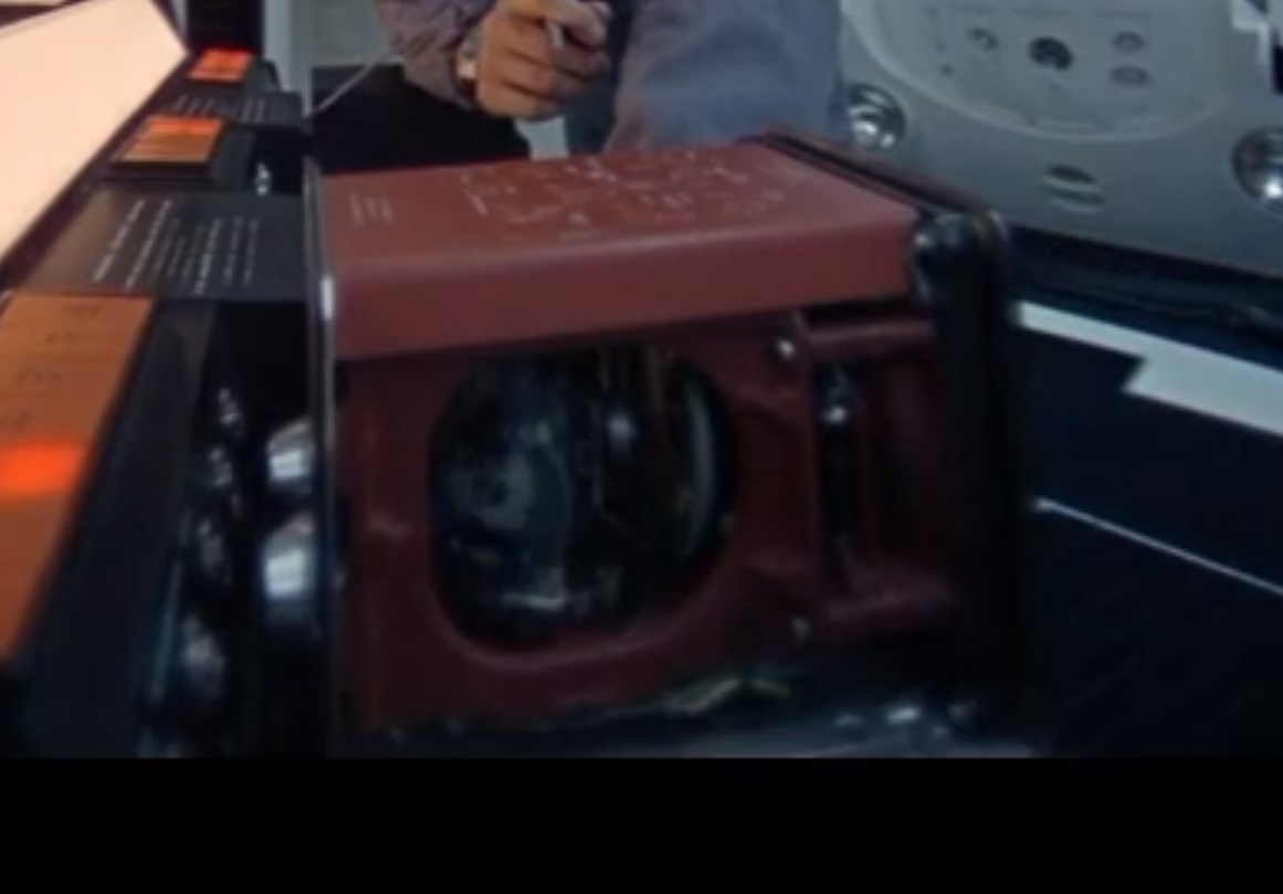

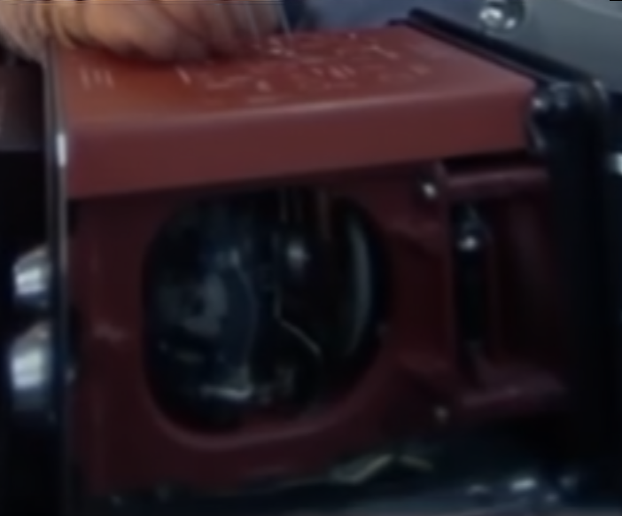

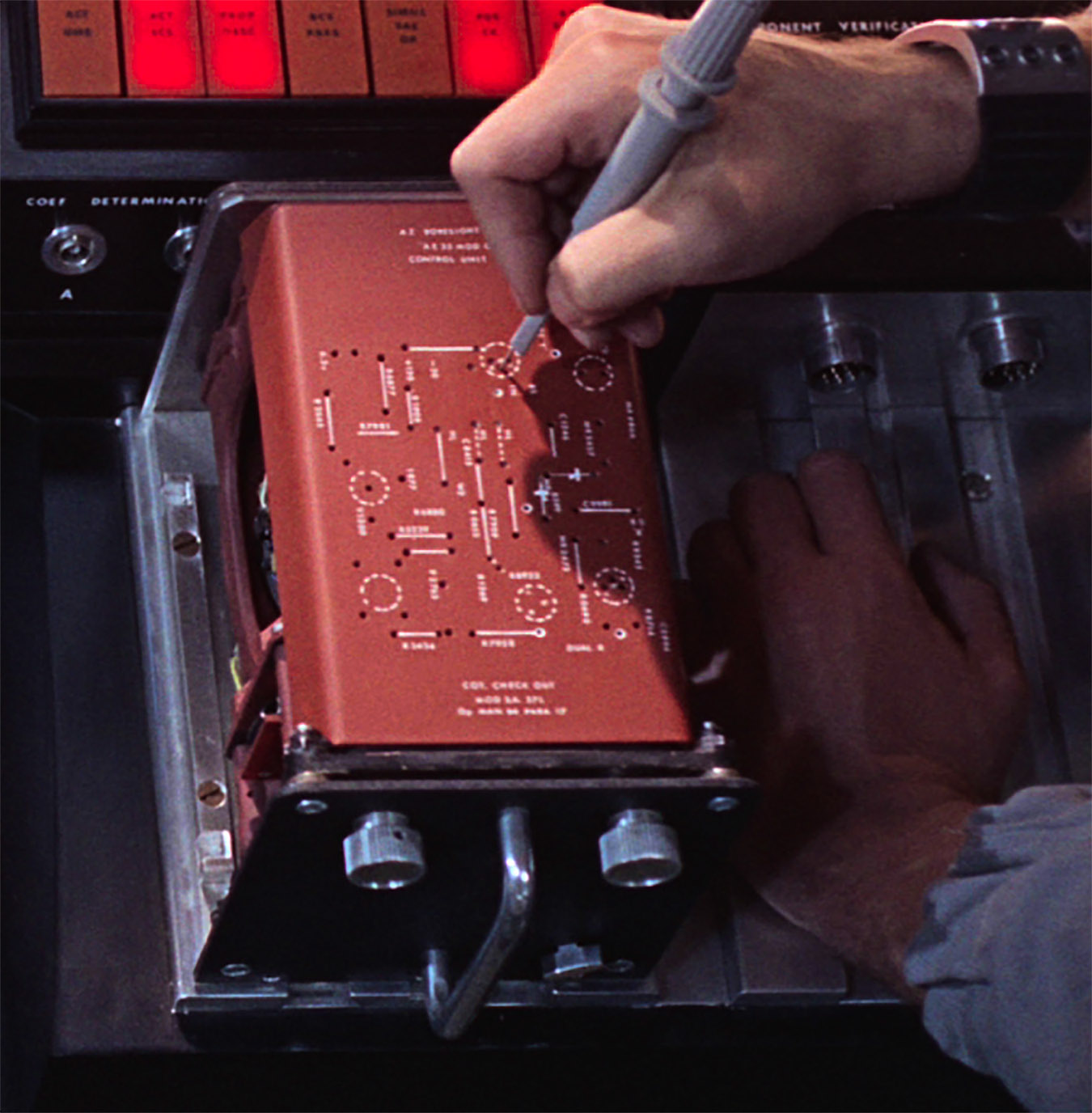

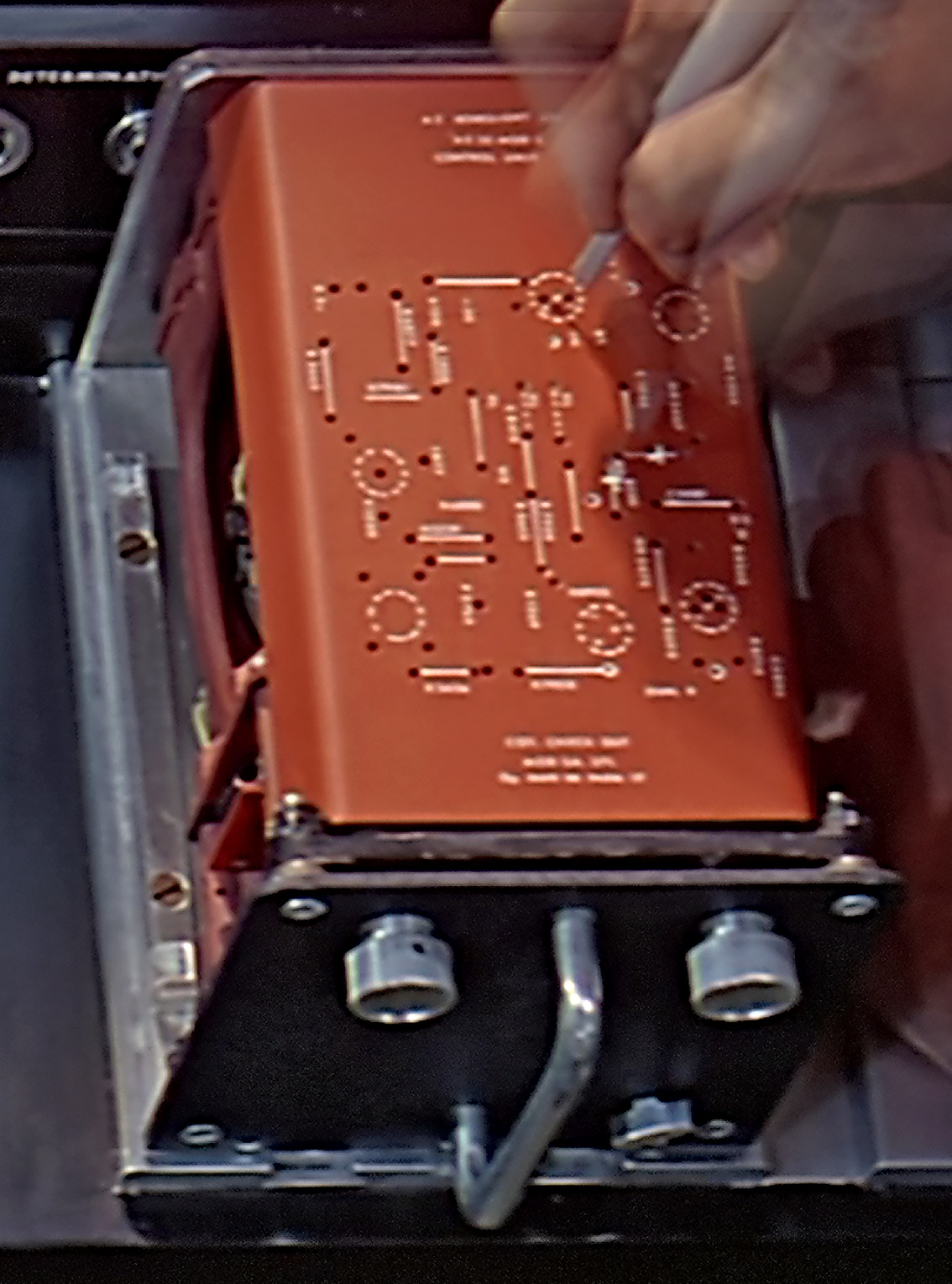

On a different note I have been struggling to identify the text on the top surface of the unit. I cannot find any higher resolution images of this angle and have struggled to get hold of the 4k/UHD anniversary version to see if the details are possible to make out.
Tried a little Photoshop enhancement, can't make out anything. Congrats on ID'ing the compass.

Abitofcredit; so many wire effect were created for different screens of different vehicules/effects that the only way to see if Doug & Co. made that AE-35 wire "X-Ray" is to ask the Stanley Kubrick's archives (in London, or Doug Trumbull on his Facebook page) if they have the Polaroids of all the special effects (I'm sure they do, since Stanley and the team took photos of everything they did). As for the knobs; 1) they're the originals (cleaned up probably), 2) a prop maker had the same kind, but in aluminium and replaced the original ones, matching the other greeblies seen on the other side of the unit (my thoughts).
As you know, all of those wholes and markings on the top parts were added for the movie. I have no idea how they came up with those (maybe Letraset, which was used extensively at the time, by prop/model makers).

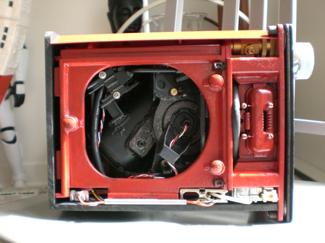

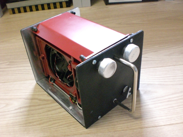

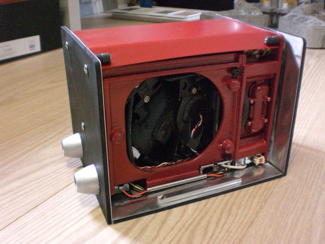

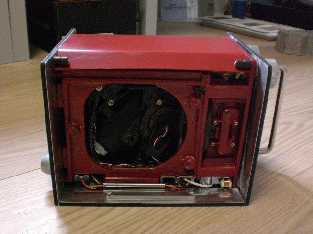

Well, after radio silence of a few months concerning that prop...I placed the handle and the 2 greeblies at the other end of that radar unit.
It's not finished yet. Waiting for a high-res pic of all of the gibberish on top...maybe one day ;)

Well, macropod80, here we are again discussing 2001 props:D Did the entire thing from scratch...not super accurate (I'm missing the rails at the bottom) and now I can see some screws and a plaque?:unsure:

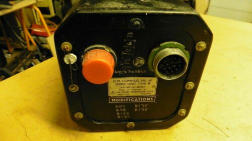

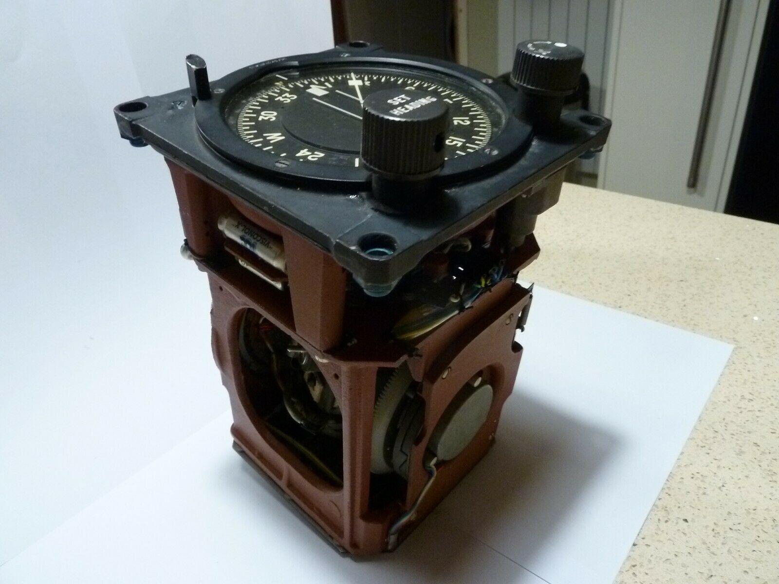

A quick look on evilbay presented a plethora of these gyro units, all subtly different (and none for sale outside UK, damn) such that I'm now not convinced you've nailed the exact one yet. That unit with just one rear socket looks better maybe? My thinking:
The film unit's two front knobs are the same, but on all those I've seen the 'set course' knob is taller. So that knob has been replaced - from a second unit?
The two round sockets on the rear are big, plain and identical. Your Mk4F has different-sized sockets each with four distinct spanner-notches around the flange perimeter. And on the film unit they're remounted on a new rear end plate. So they've also been replaced and so are not identifying features of the original unit used.
I think these two horizontal 'legs' are a giveaway to be looking out for: narrow legs.jpg and this pattern seems quite rare. This region is the major problem with joberg's version and on every unit I've been able to see the interior of, the two 'legs' are wider and more distinctly tapered.
But this one looks good in that area. Do you have a sharper image of the rear ID plate on this one?

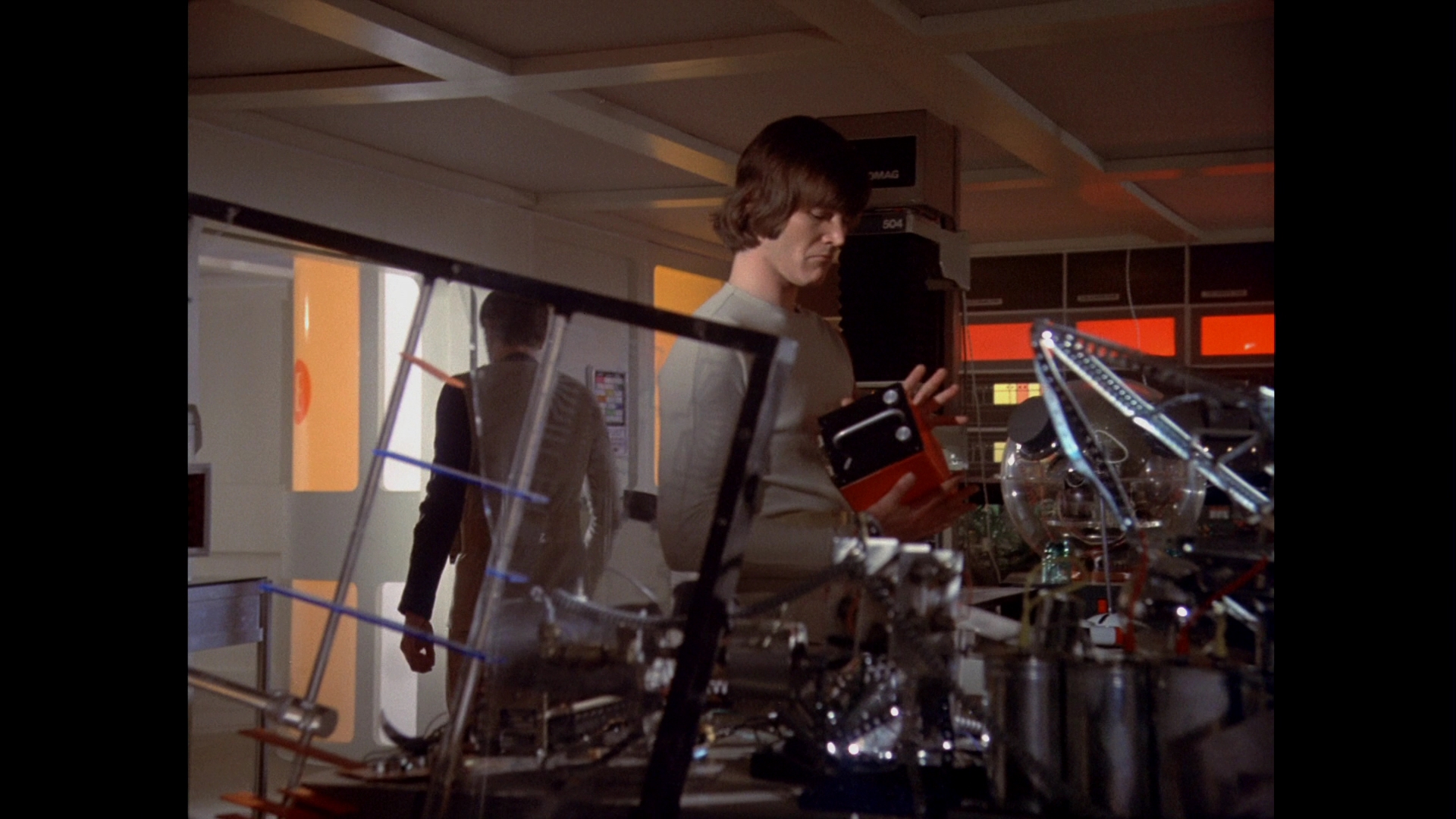

I don't know if this is of any interest beyond trivia, the same or similar, unit appeared in the Space 1999 episodes Voyager's Return and Dragon's Domain.
..still impossible to make-out those fonts/text on the unit:unsure:
Nope. :) It's the best we got, though. The typeface at the bottom definitely looks like Futura Bold, like other sets and props in the film.
Hm. Interesting. The two aluminium details look very similar. But it seems shorter and stubbier than the 2001 prop. Maybe? It's hard to tell.
It's also hilarious how 2001 still looks kinda futuristic today, whereas Space: 1999 looks so dated...
Doesn't help much, but I'll bet that second line starts with 'AE 35' (which makes it 'AE' beginning the first line):
but at least the image is clear enough to drill all the holes accurately and mark the white lines and dot-circles.
View attachment 1379514 but at least the image is clear enough to drill all the holes accurately and mark the white lines and dot-circles.

Yep, AE - 35 is seen on this pic +xxxxxxx unit at the bottom of it. I thought the knob was a regular On-Off switch at the bottom like the one on my unit.:unsure:
