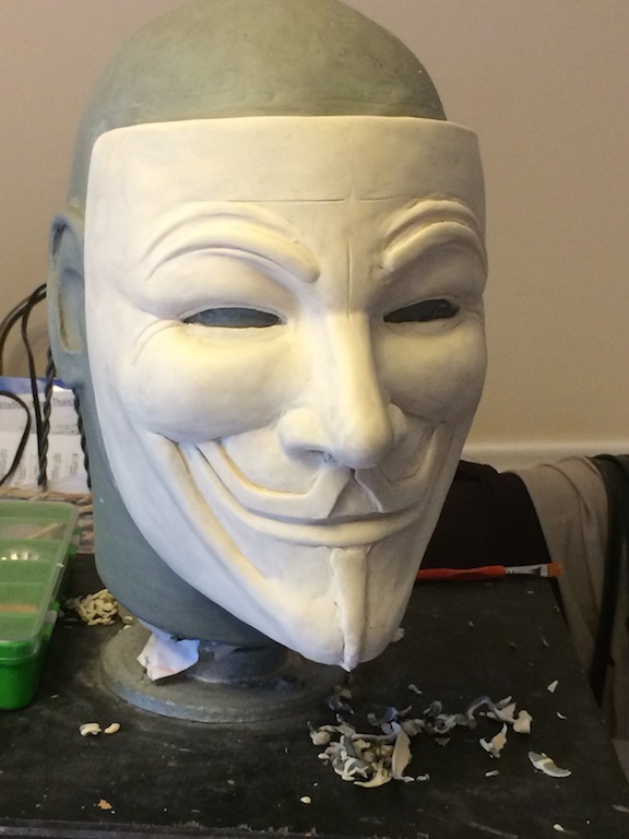

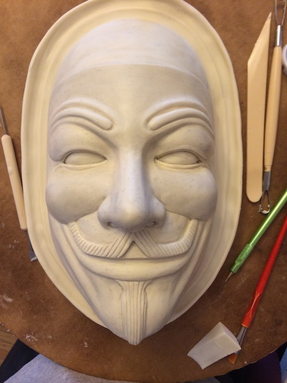

Final sculpt (around 40-50 hours). I built a retaining base to conserve molding materials, and to make slush-casting a bit more efficient.

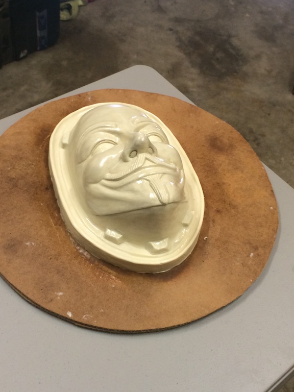

Decided to add some keys to keep the mother mold in place.

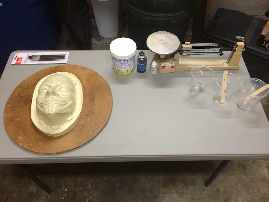

Clear-coated with acrylic. Molding station ready to go.

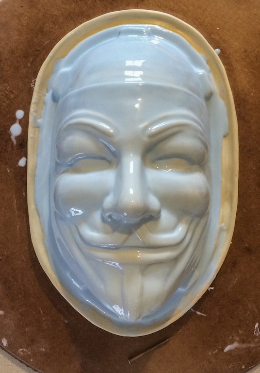

First coat of Smooth-On Mold Max XLSII
Third coat. I added some Thi-Vex to the 2nd and 3rd coats, and 3 seemed sufficient. Next time, I'll add additional keys to the silicone because the clay keys were almost completely lost in the silicone.

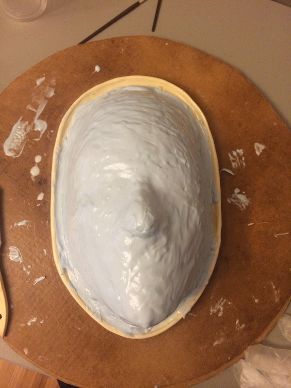

Applying the plaster bandage mother mold. I did three layers, going opposite directions on each layer. Then I added an ovular band around the base for reinforcement.

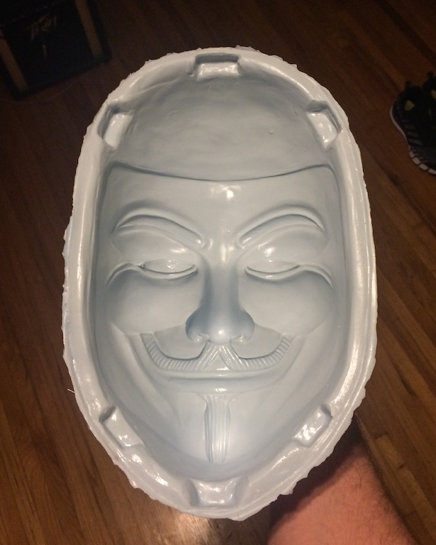

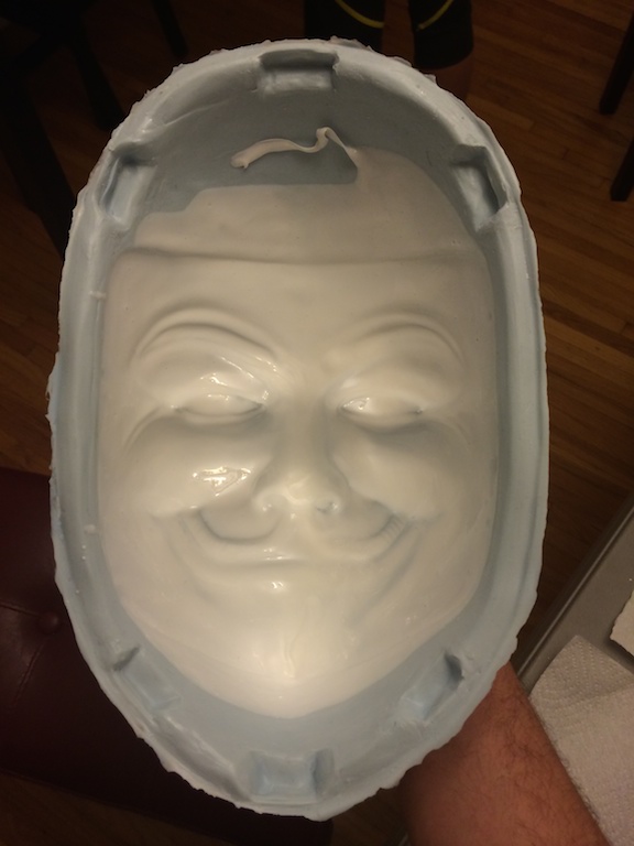

The mold came off clean! For someone who has never done this before, seeing the negative mold was a huge checkpoint. I sprayed some Ease Release 200 before casting.
First coat of Smooth Cast 65d. I did a total of 4, but I used small quantities in thin layers. I learned slush-casting is an art form in itself, and very time-sensitive.

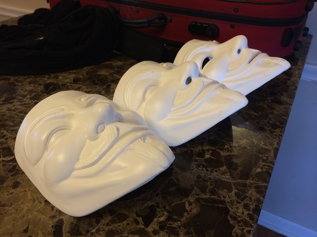

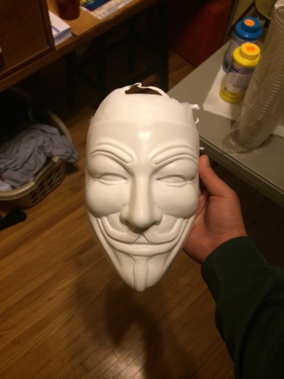

The first pull
2 more, and started trimming the holes and edges. Castings were better each time.

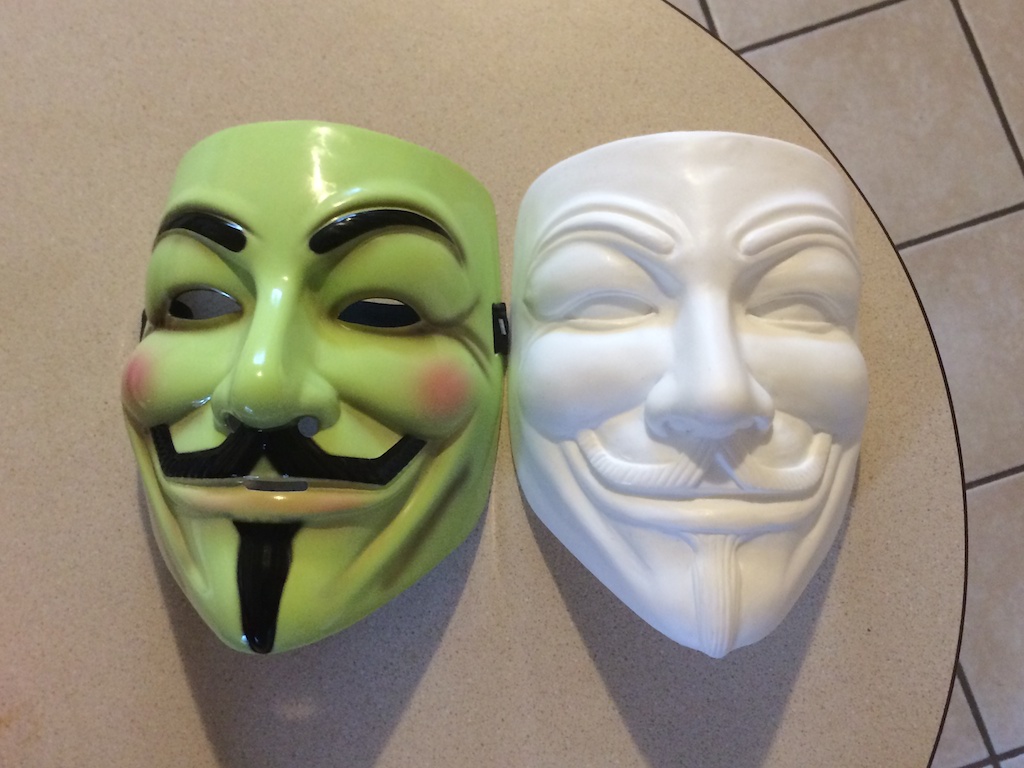

Here's a comparison shot with the "collector's edition" mask.
