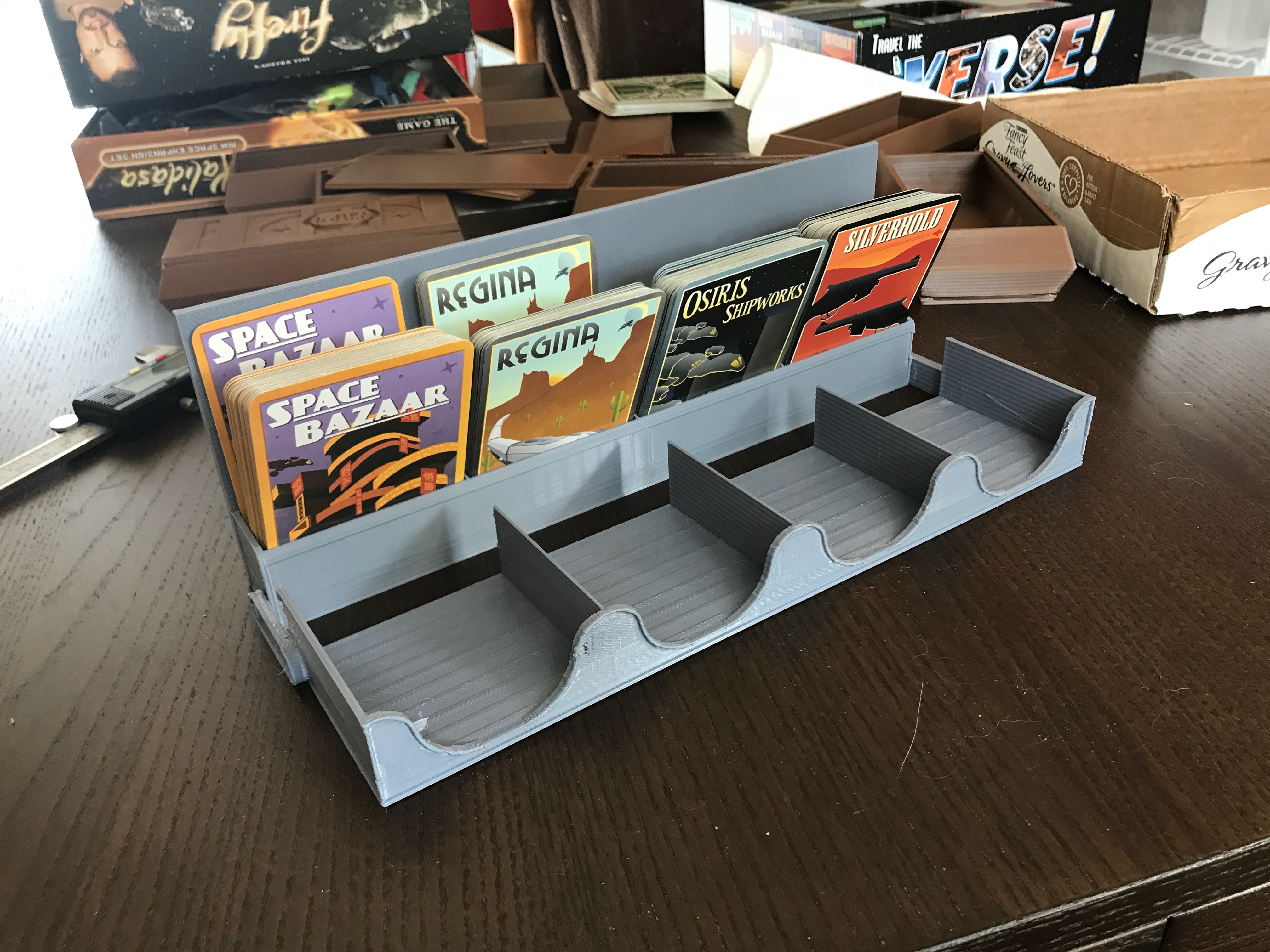

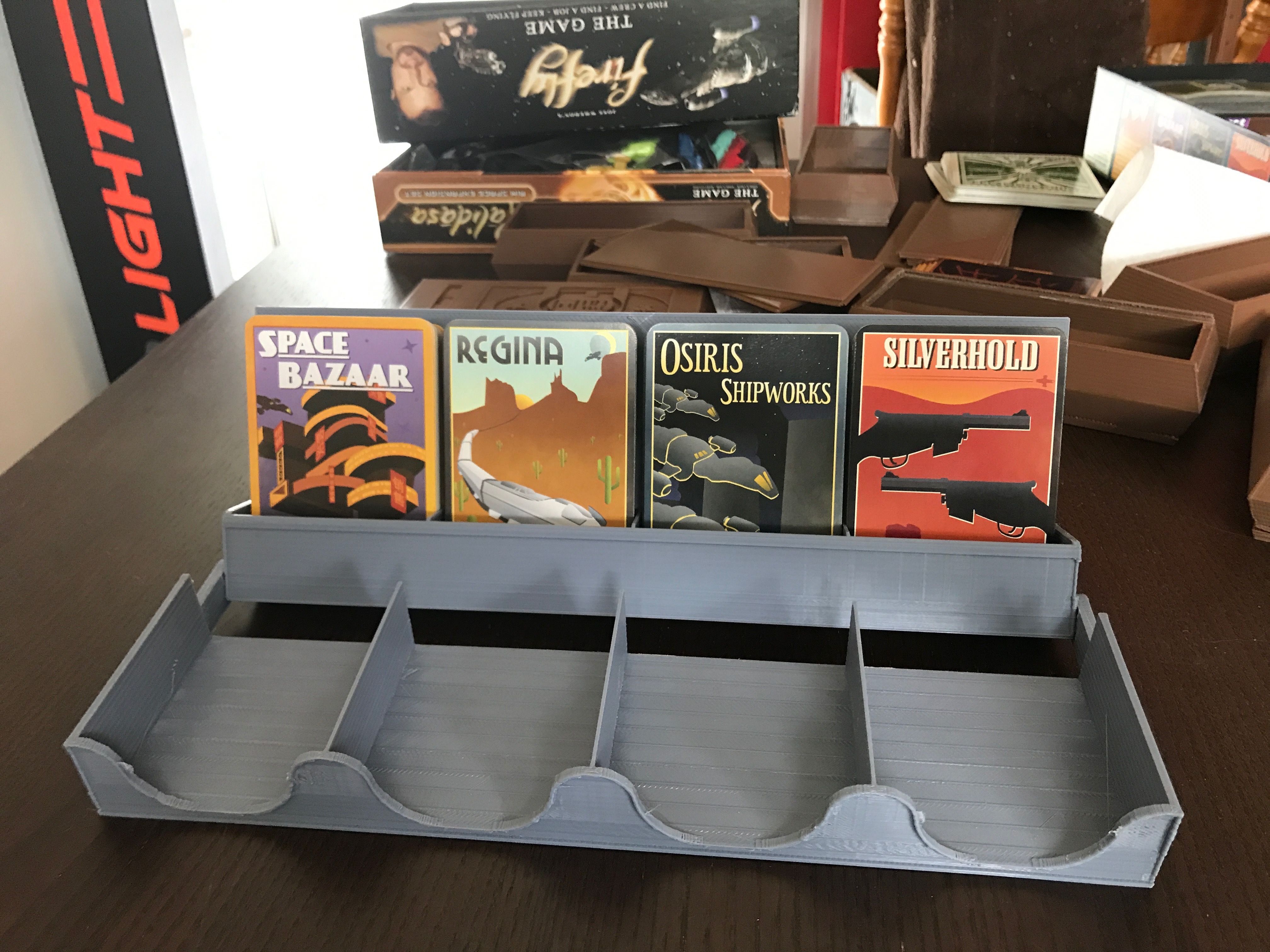

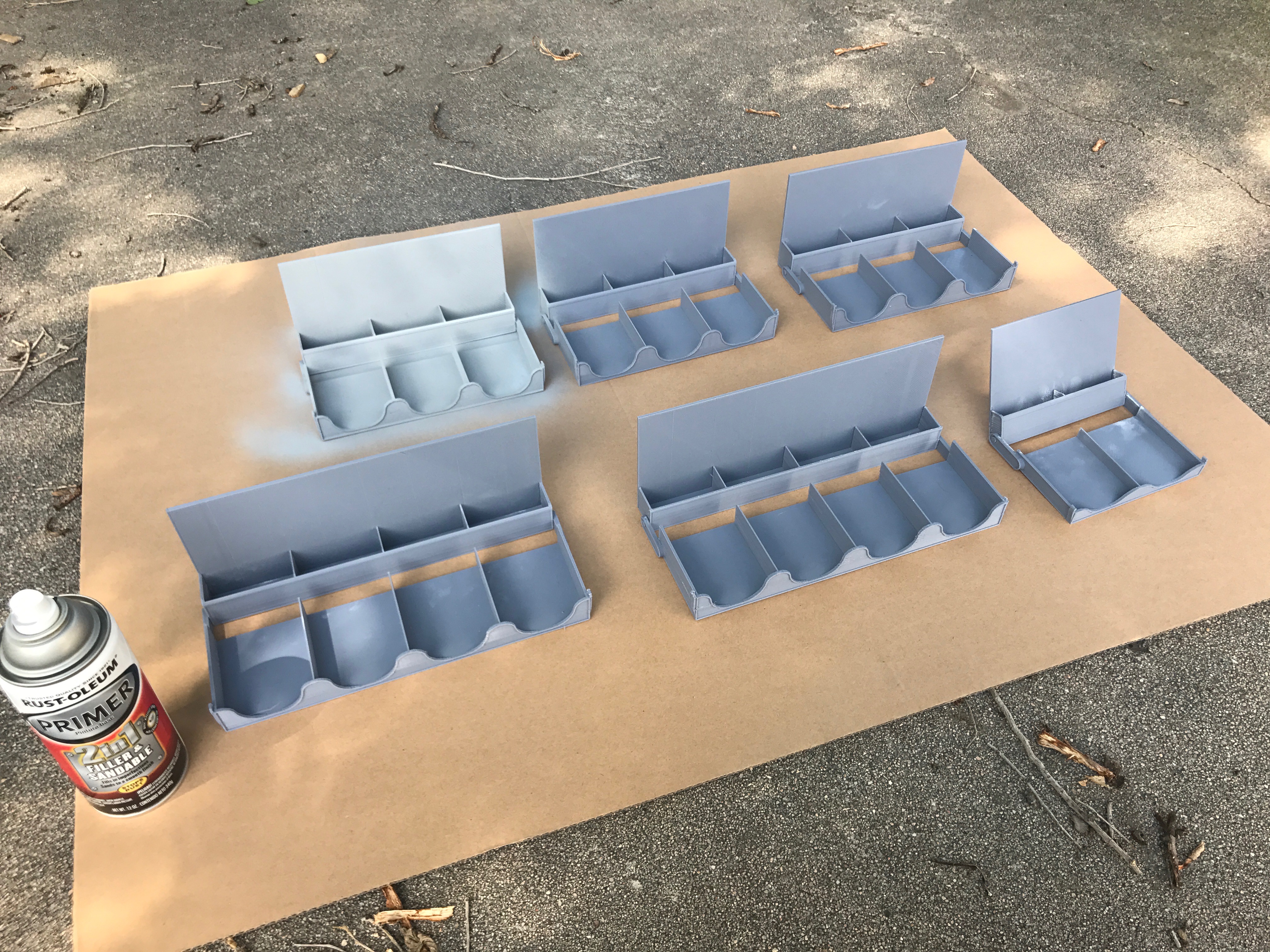

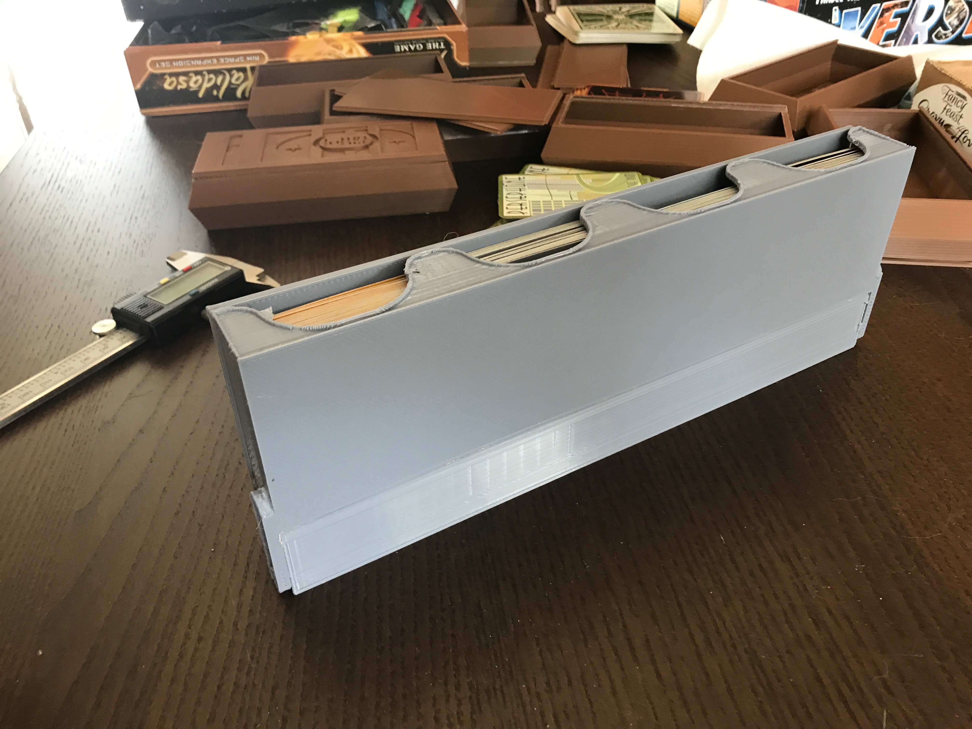

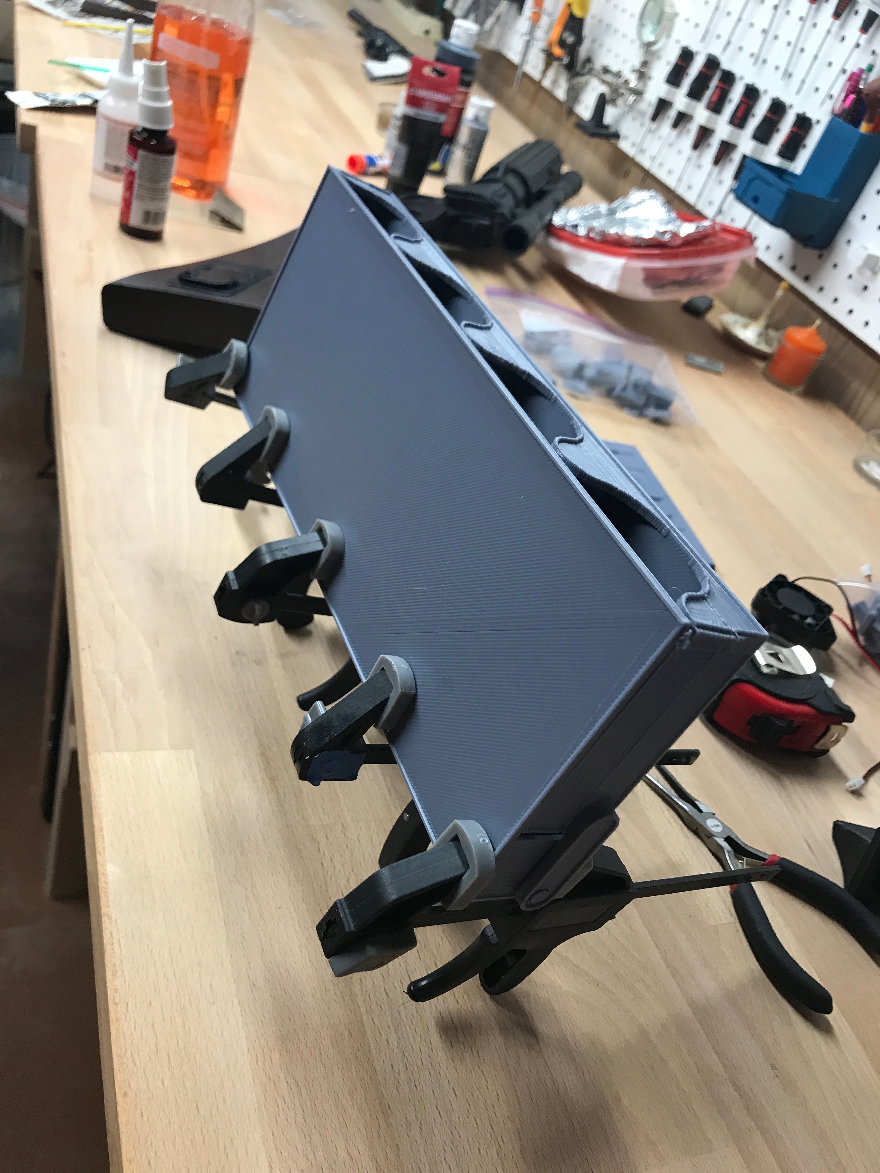

These are the furthest along, so I figure I'd show them off first. Those who have played the game, and especially with all the expansions, know that it gets unmanageable how many decks of cards there are. Not only do you need all the decks of cards easily accessible, but their discards as well. I designed a hinged card deck holder in Sketchup and printed them out on our Taz5 printer in eSun PLA+.
Fun story! Did you know that printer filament is susceptible to humidity? We live in colorado in what's technically a high-desert climate, so rather low relative humidity. Until we had the wettest summer in the time we've had the printer and my poor filament started to soak it all up! 3 successive weird fails on a filament that we don't get weird fails on? Time to buy a pound of dessicant.
3D Printing on the Taz5. It took 3 tries to get my prototype right. :) The back has to be glued into place, as printing-in-place yeilds too fragile of a part.
Testing testing.... successful!

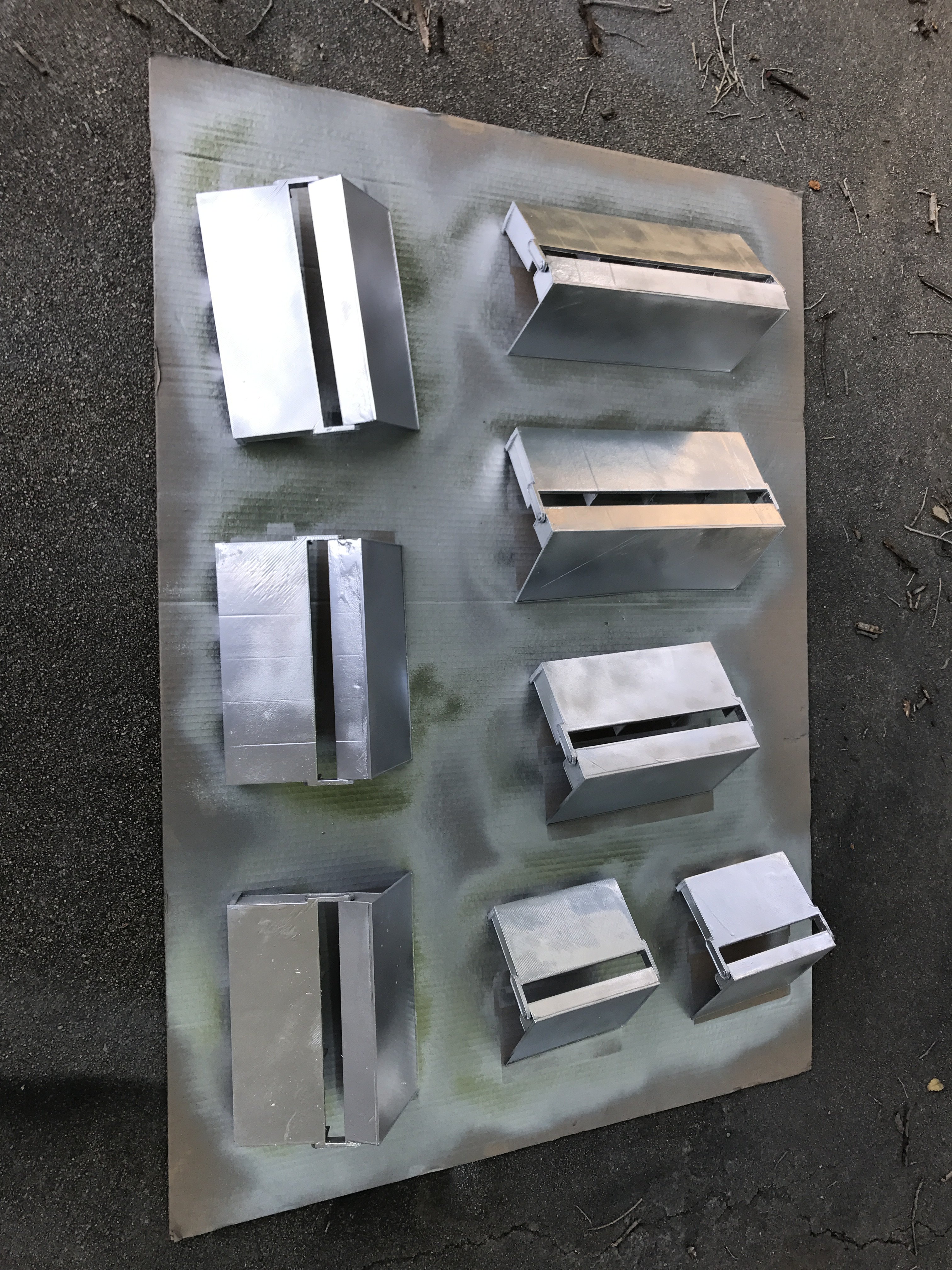

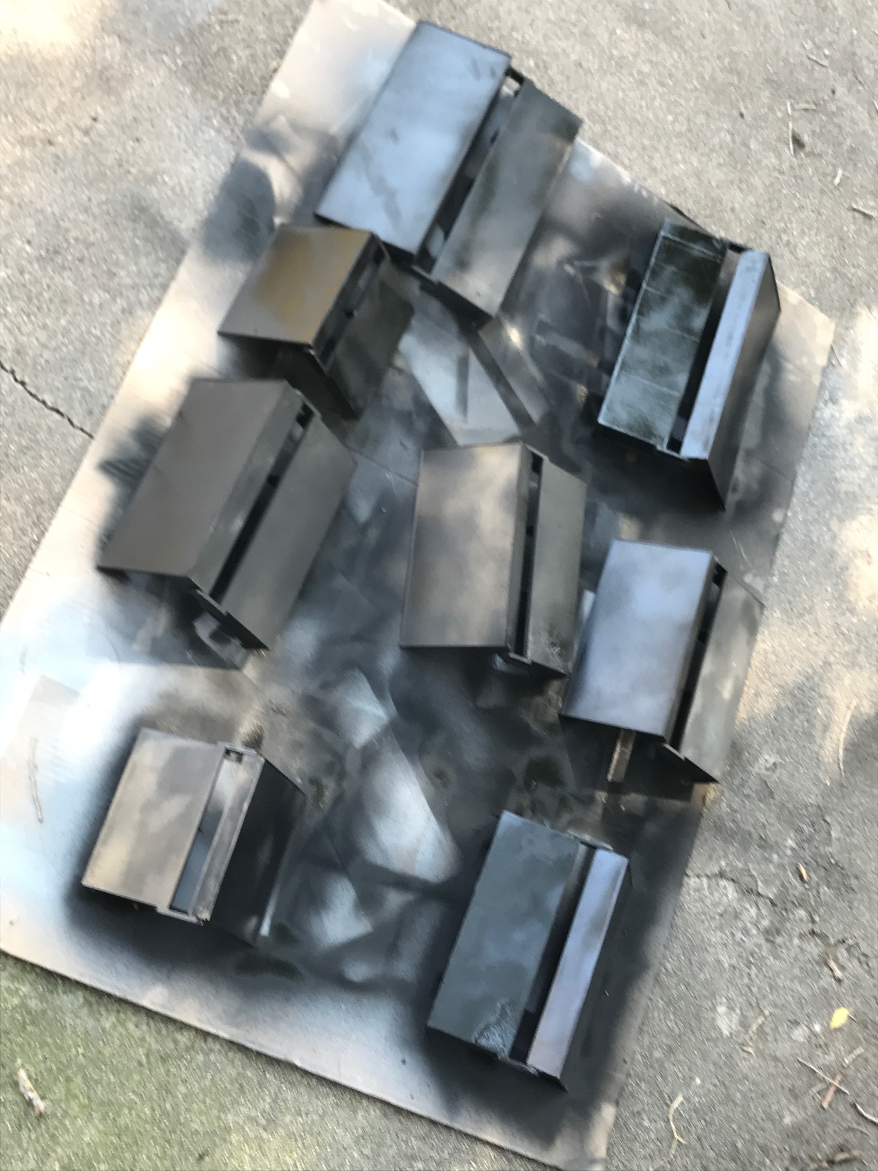

Sandable primer-filler coat (this stuff is best!), filler (drywall putty), use up all the random mostly-empty black spray paints from around the house. Then, Ace-brand "Chrome Aluminum" paint. To be done: Weathering, rivets & adornments, and some sort of indicator as to WHAT is in each box.

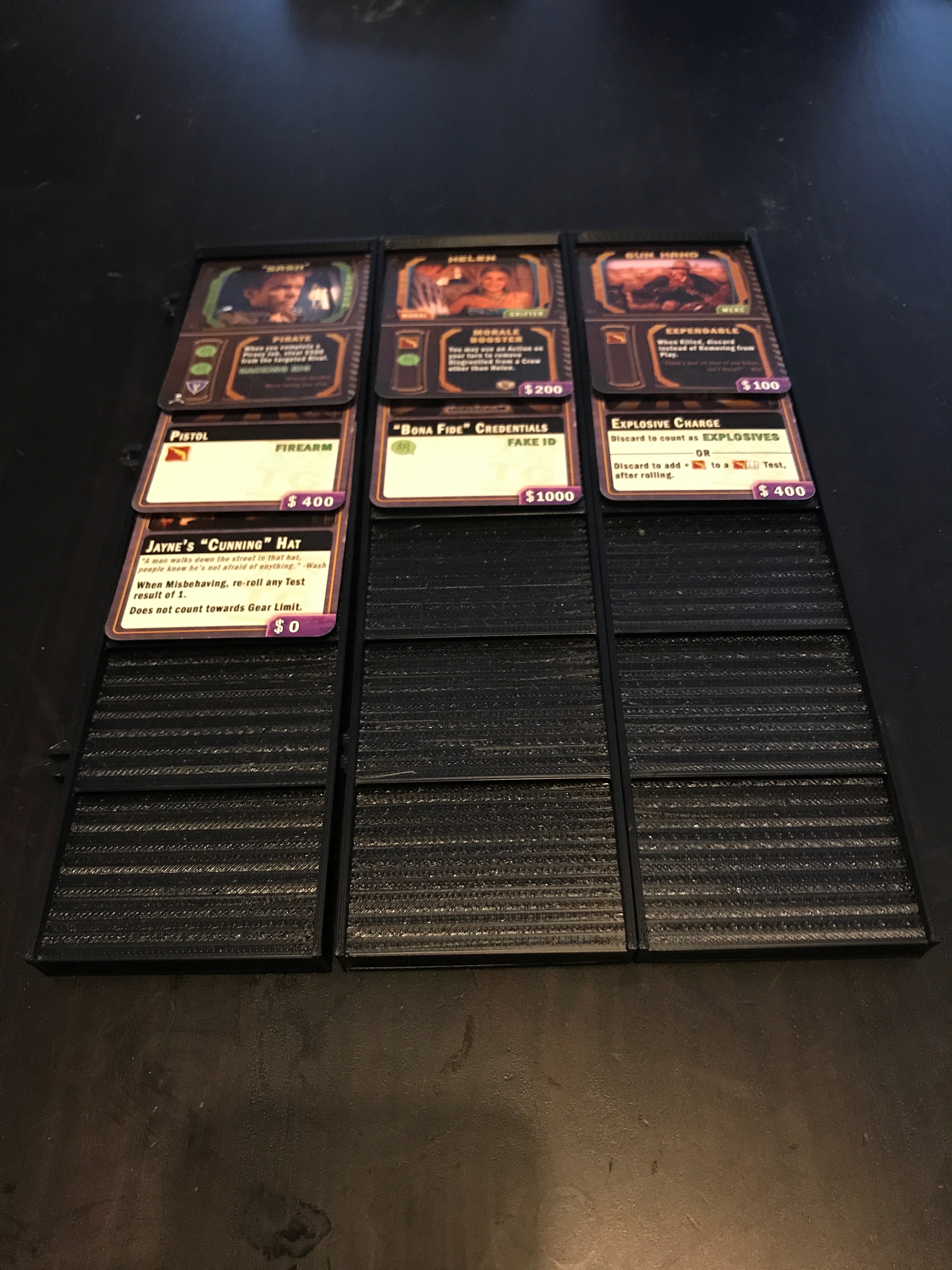

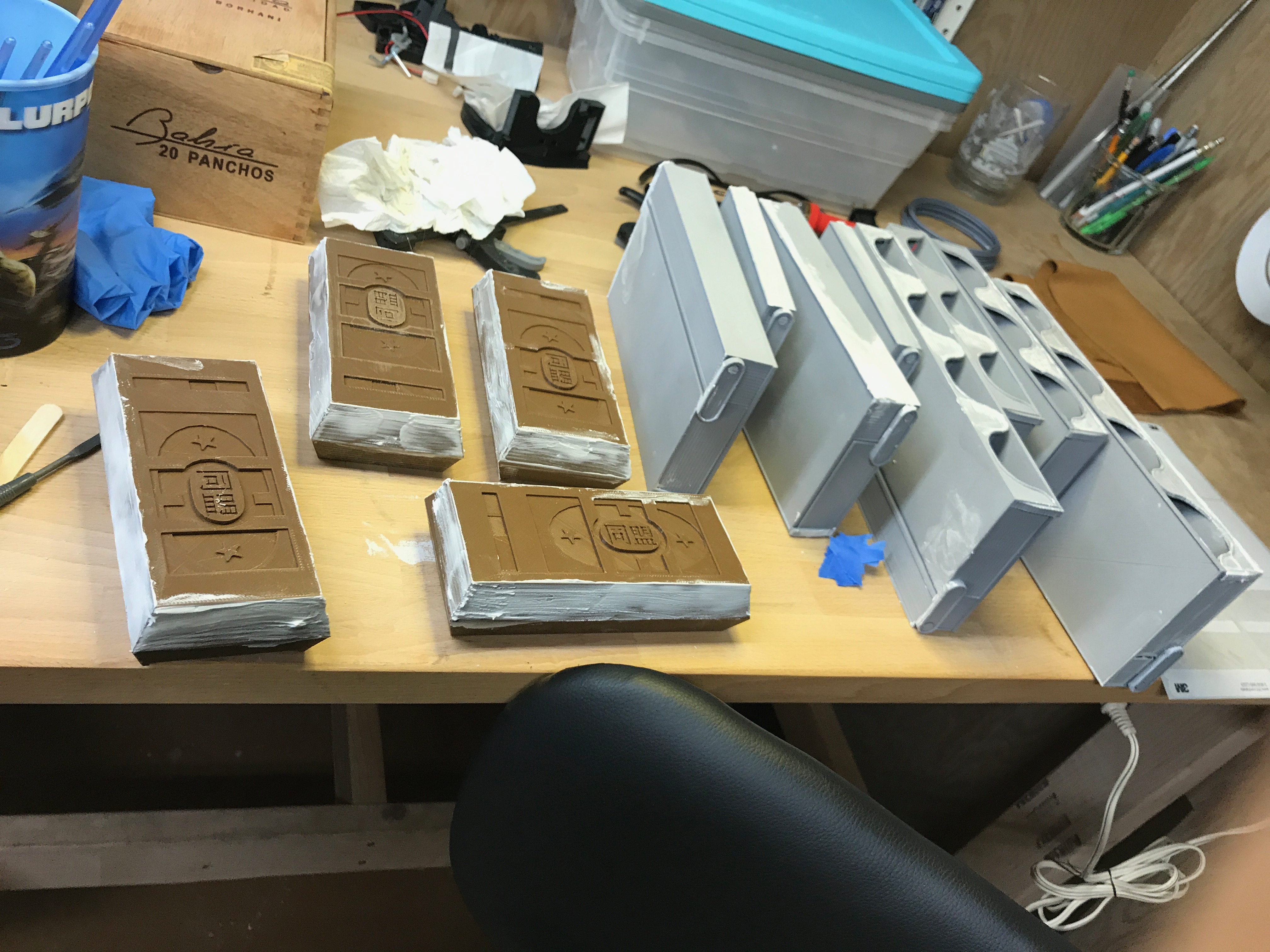

Food Stuffs Boxes - Token Holders

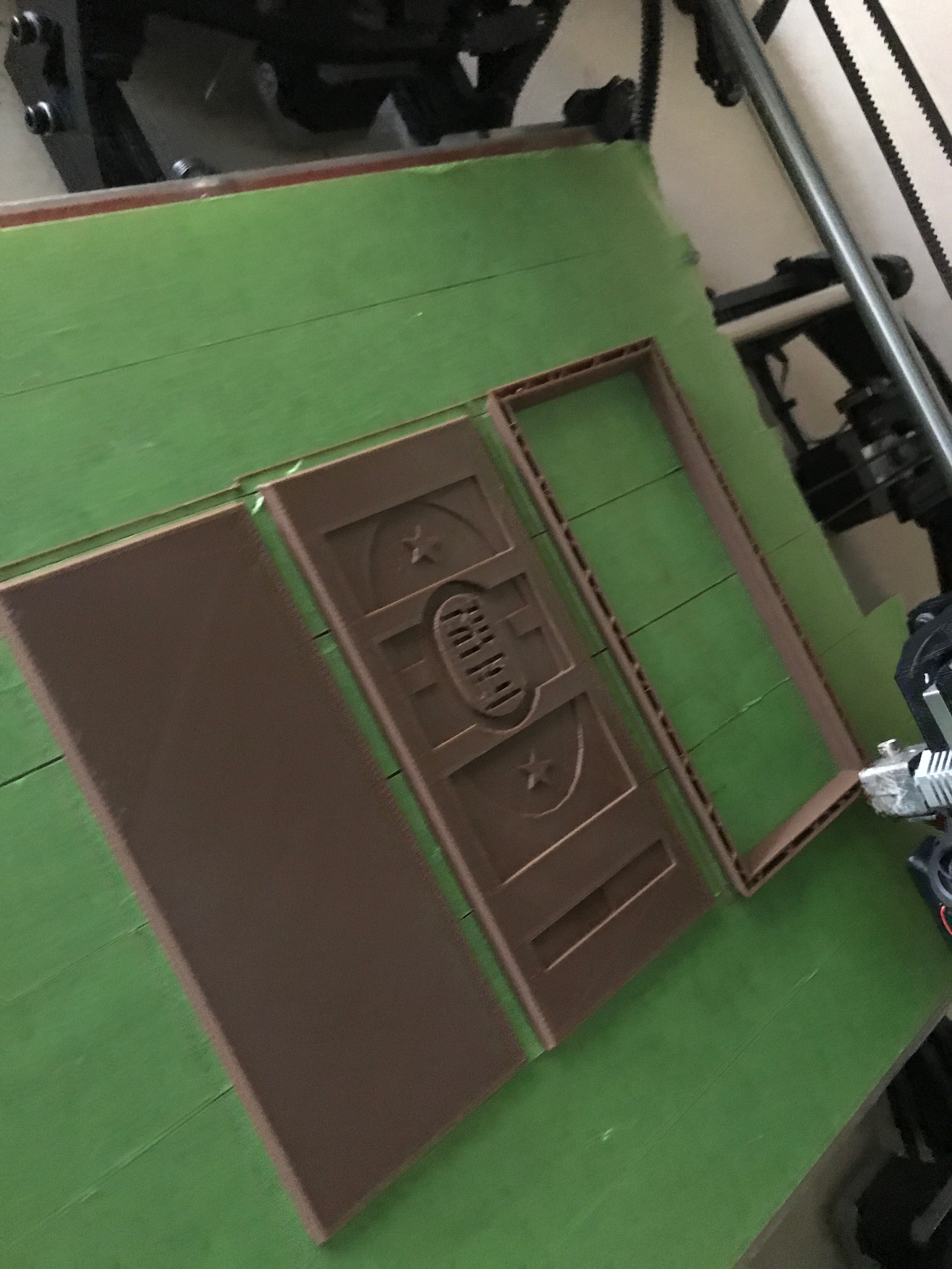

Our token holders are hollowed out food-stuffs boxes! I had found a file on Thingiverse, but I wanted a close-able box, and also, the file on thingiverse has the wrong characters in the alliance stamp. Oops! So, I rebuilt it in Sketchup (yes, that's my go-to modeling program for less-organic items). Couple of trial-and-error setups to get the lid to slide nice, but soon, printing on its way.
Printed in eSun PLA+
Used XTC-3D to fill in striations. Hubby didn't like how it softend up the edges (I was going a bit thick on my application), so we sanded back down on the belt sander, and I moved to the filler primer spray paint and drywall spackle.

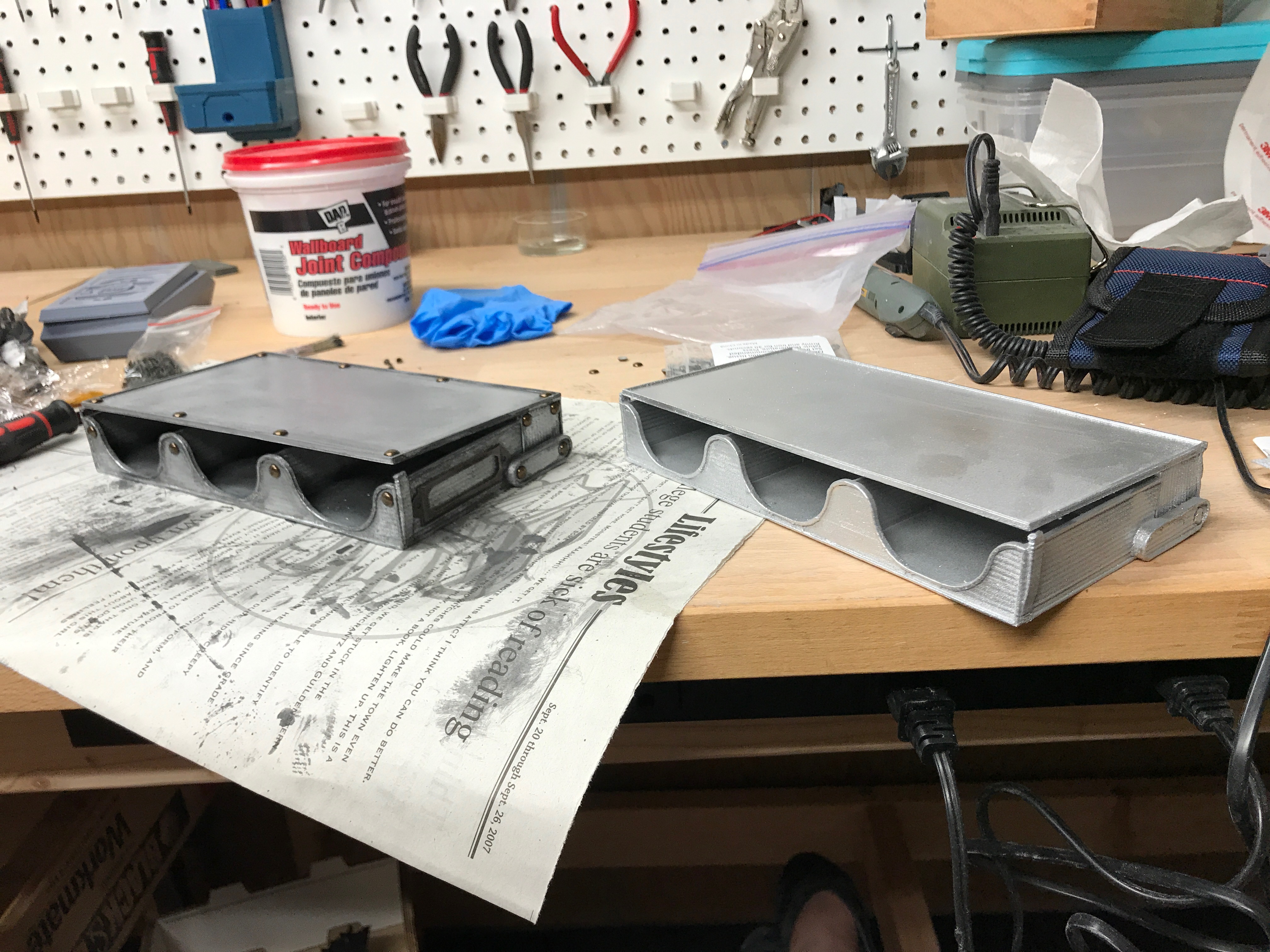

Sanded & spackled to fill in the gaps at the cap glue joint
Filler primer!
Insides have been sprayed with a flat-black enamel. I'll coat the outsides in black too, before going to a bronzed metallic paint, then weathering.

Card Box Update

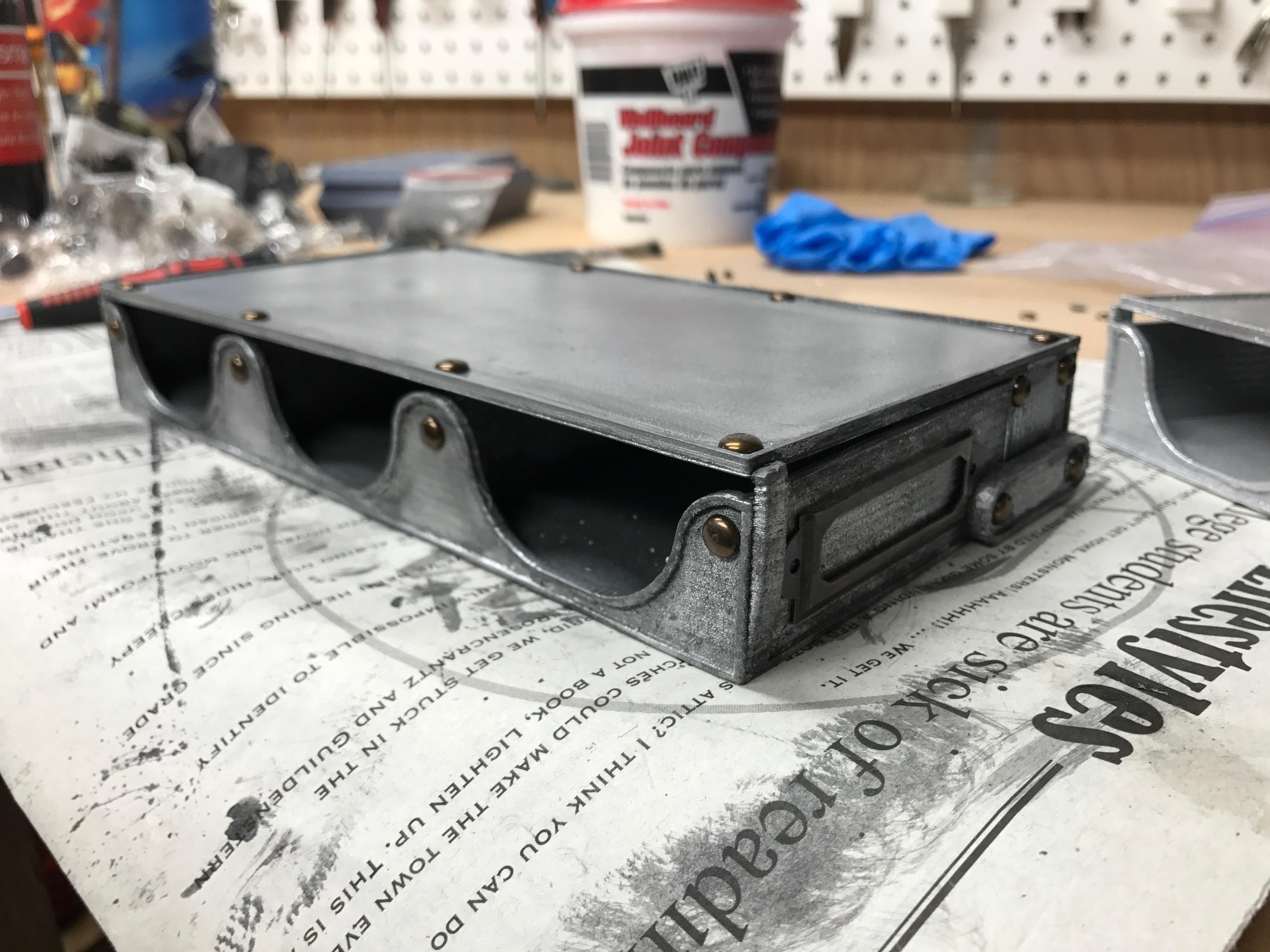

There! Looks like it belongs in a space western now. Something gathered from Whitefall, perhaps. Not sure how to label which cards go in here yet. This is for 3 of the supply planet cards.
A simple acrylic wash to grunge it up and make it look more like steel vs aluminum, then hot-fix-type rivets and a couple of label holders
I think I want to add some rust, though....
Compared to an un-distressed box.

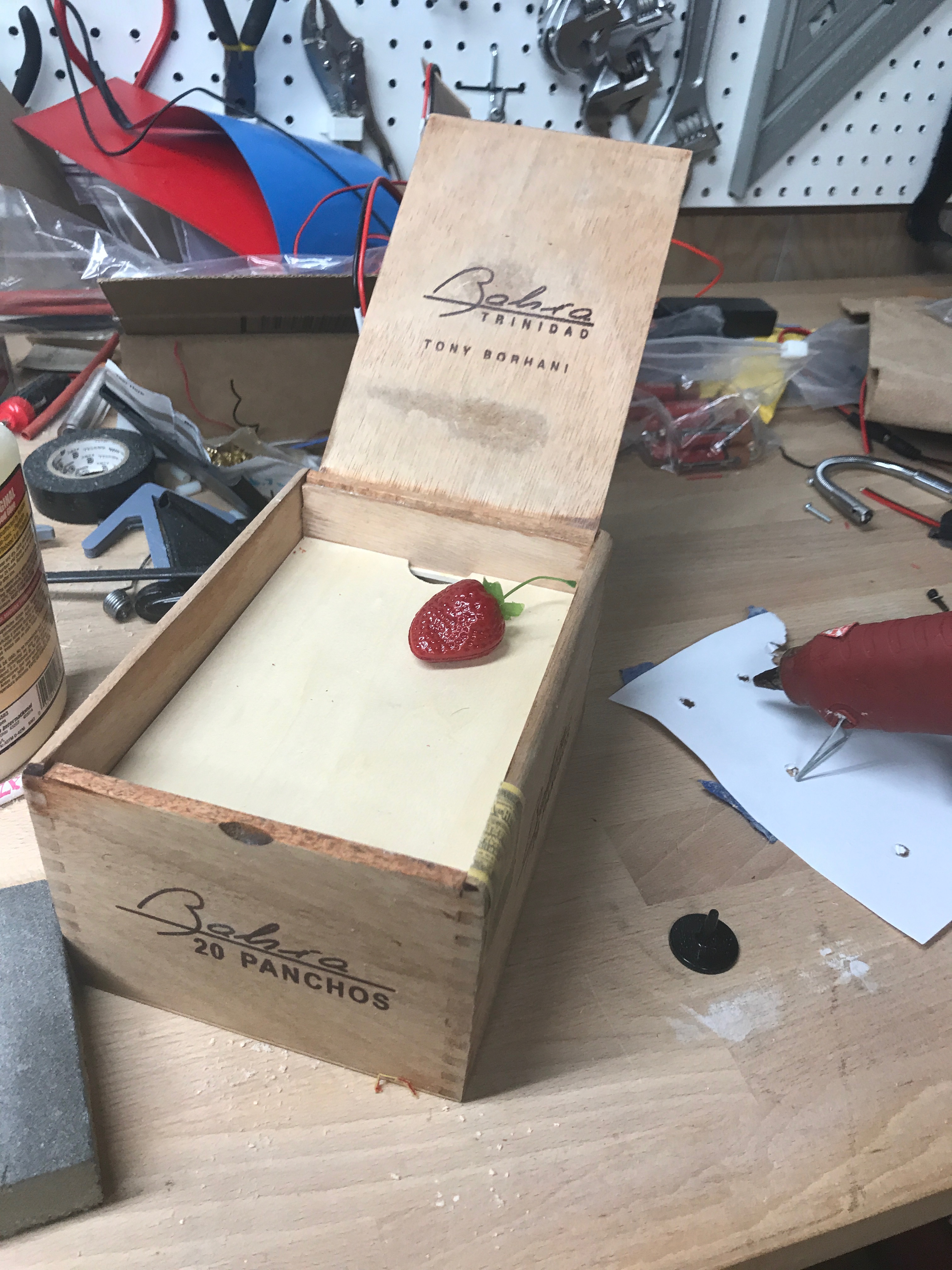

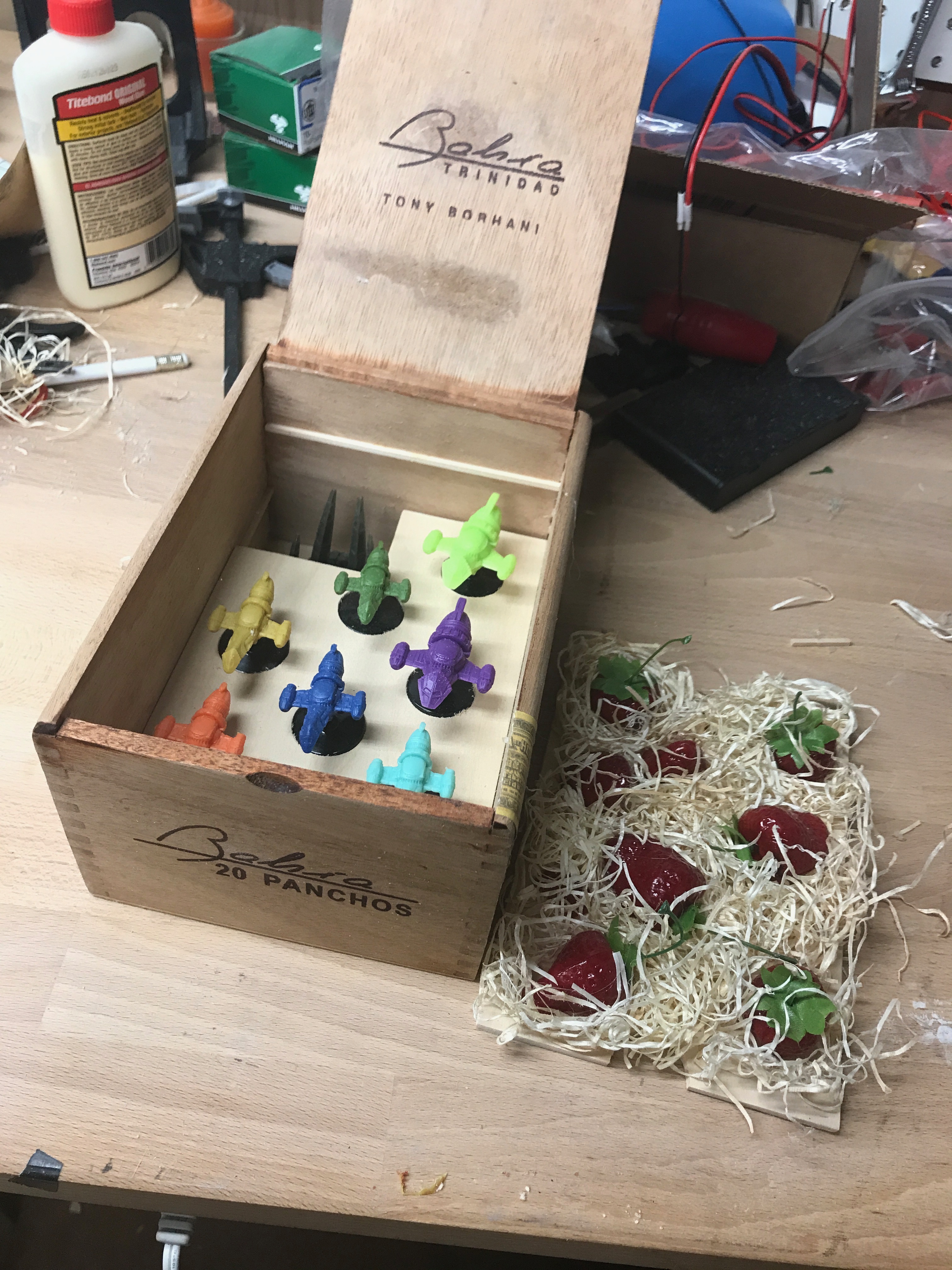

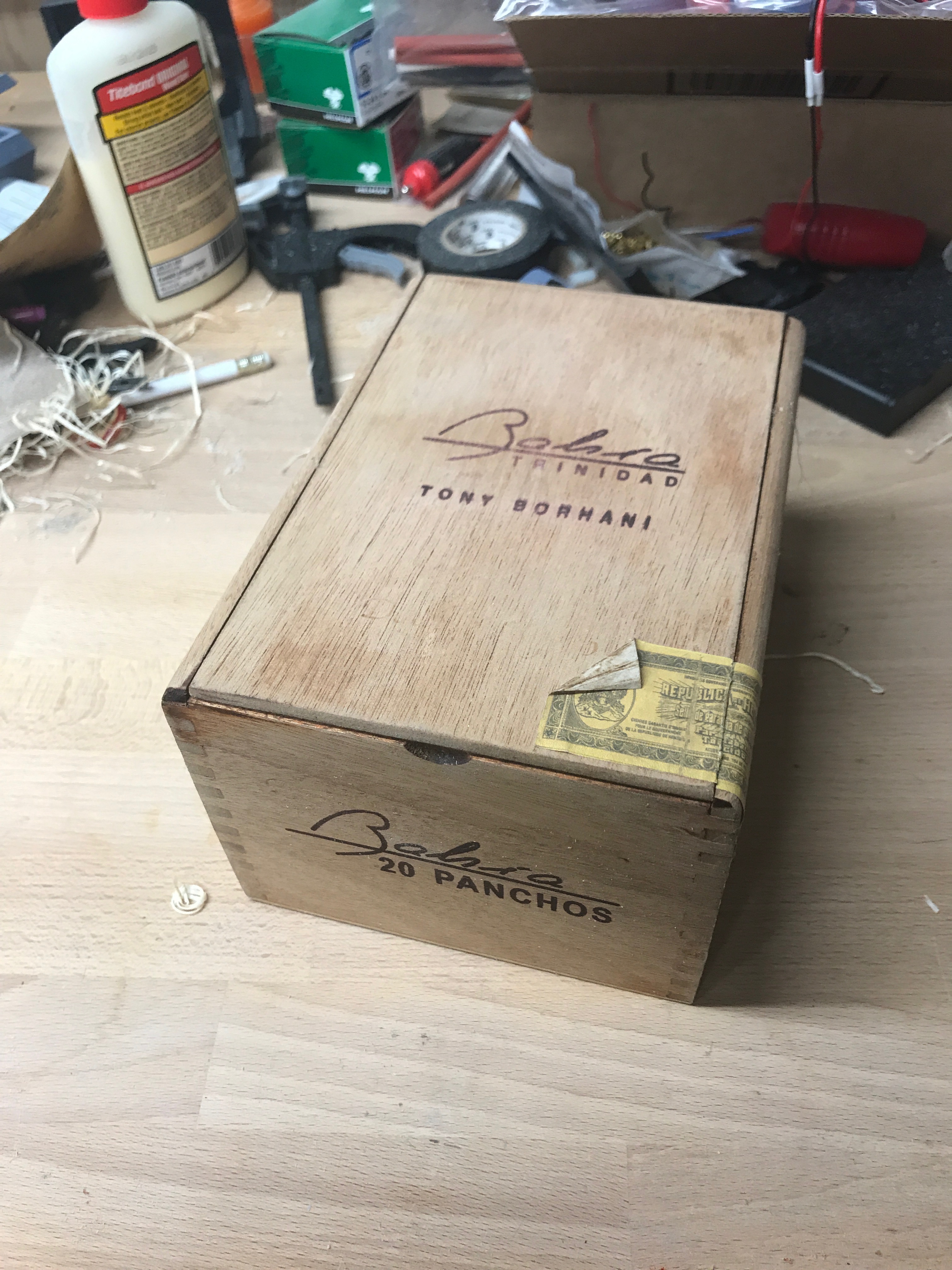

Ship holding box complete! Mostly. May do a little more sanding or add sealer to the basswood.
Replica Cigar box from Washosaurus on Etsy.
Strawberries! These were hacked up and glued to a removeable tray.
Strawberries out, revealing the first layer of ships -- the Firefly class models.
Lower deck holds the remaining ships.

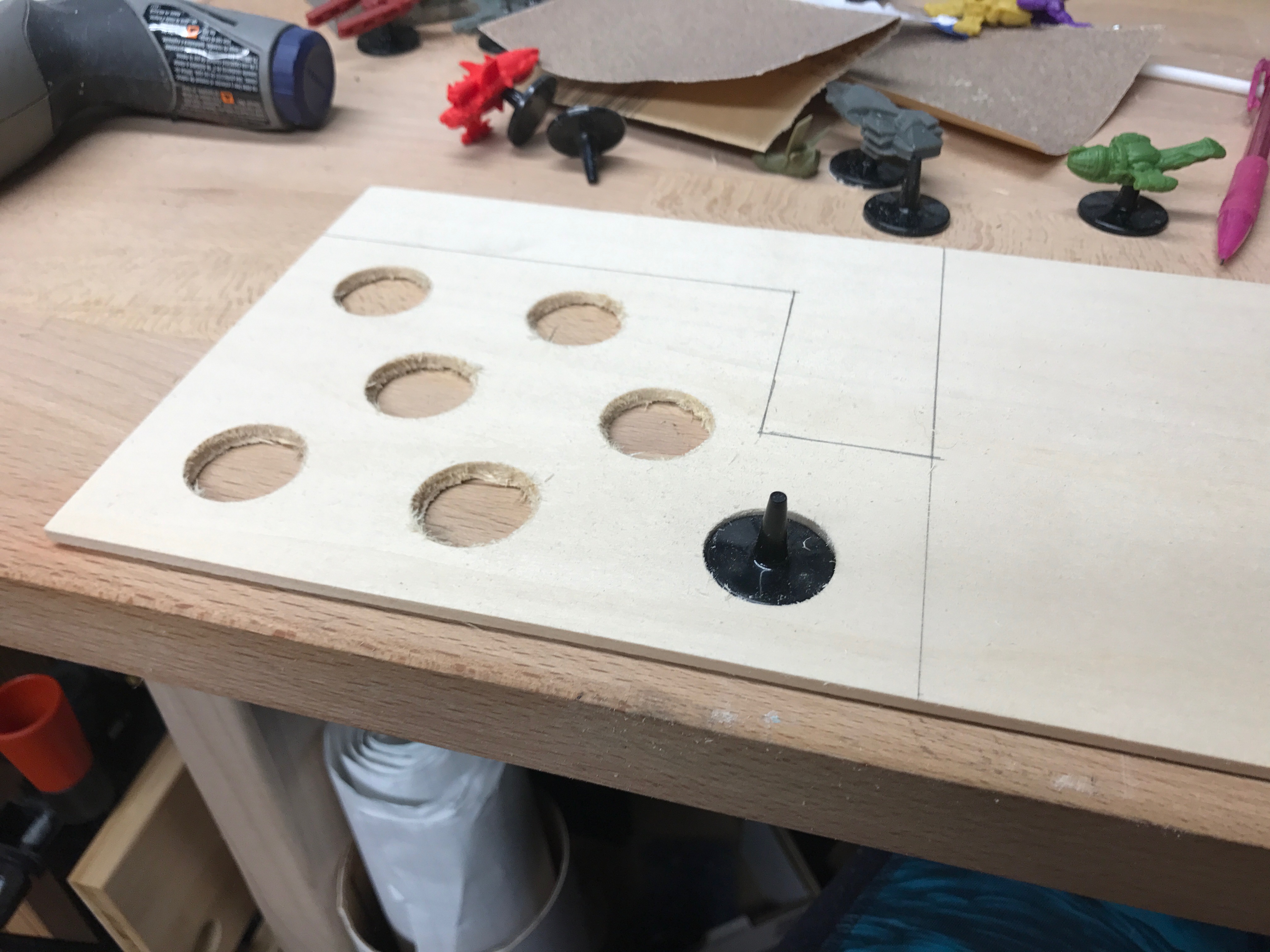

I used a 1" hole saw to make the slots for the ships, and cut the trays to fit. The Tohuku class cruiser is too tall, so it's got a cut out that allows the upper deck to sit at a reasonable height and me still get the strawberry tray in.
