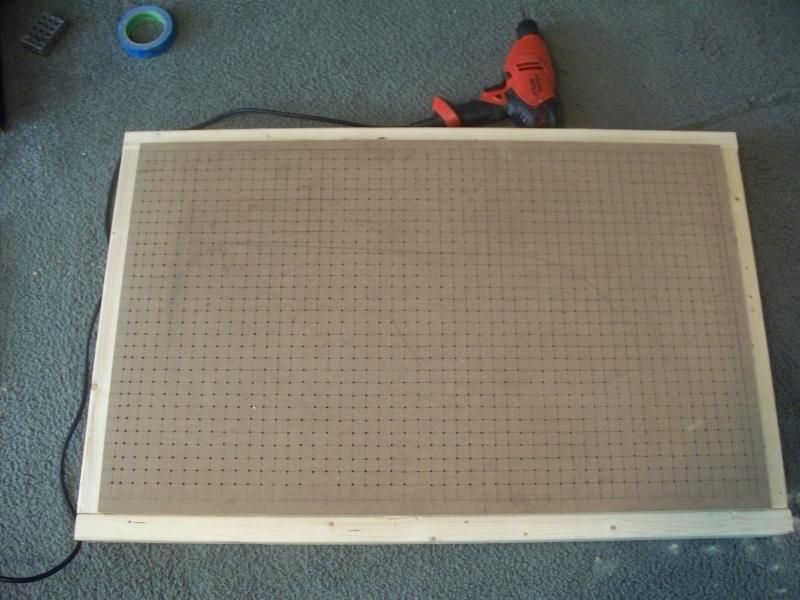

Ok for the platen I used some thick MDF 3/4 inch i think
I plotted out the graph on it and drilled about 1,400 holes.
You can see in this picture the outside frame as well of the
table i built it right around the platen and trimmed it up to
fit.

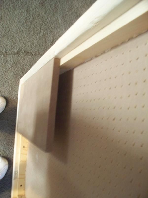

Next is the platen support on the inside of the frame....
Here is the platen support on the inside finished.

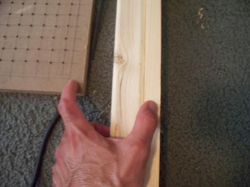

Notice in this picture my index finger on the outside of the platen
marked off with pencil that thickness matches the thickness of the
platen supports you see my thumb on in the picture. This is where
the platen will get screwed to in the end.
Platen test fit just sitting on there.

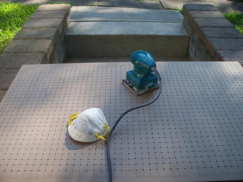

Outside with the palm sander to knock down all the
exit wounds from the drill but on MDF that takes about
2 min....lol
Now time to seal it up with some
wood glue and screws.....
You see the holes i drilled
outside the platen's working dimensions
they are pre-drilled through the MDF and
into the platen supports underneath. I probably
could get one more row of holes in there.

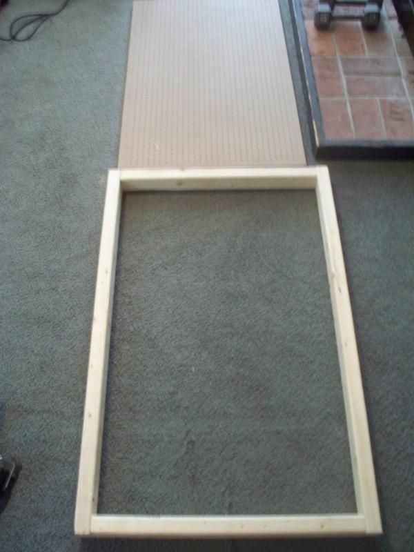

Next the frame work to hold the plastic....
If you were wondering I have....
37 Inches usable platen Left TO Right
22 Inches usable platen Top TO Bottom
42 Inches usable platen on the diagonal

On to the frame work that will hold
the plastic.
I gaped out the frame away from the platen,
if you don't it will be impossible to set it down
clean. You need some space to be able to seat
the frame in order for the plastic to set
down.
I used some heavy duty staples on the top and bottom
and along the sides it came out rock solid....which was
good i didn't have to do any drilling.
Interesting note....The bottom of the frame work
can't be greater in thickness than the palten, they
have to be the same or you won't create vacuum.
My platen was made out of 3/4 MDF and the frame
is 3/4 inch.
Here are both pieces of the frame I counter sunk the holes on
the bottom so they would not raise the frame and plastic off
the platen, added the handles and wing nuts.....finished!
