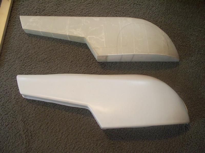

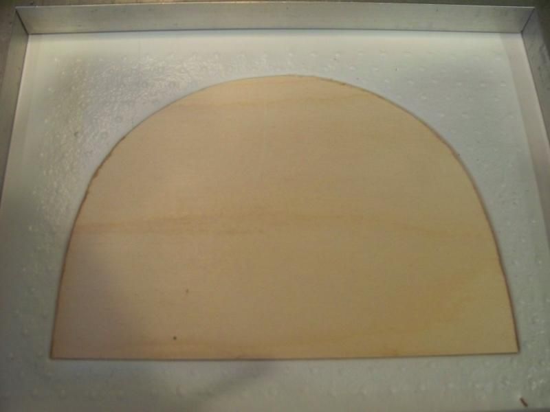

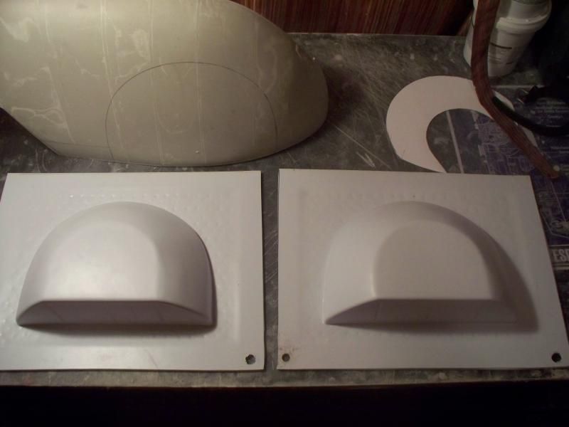

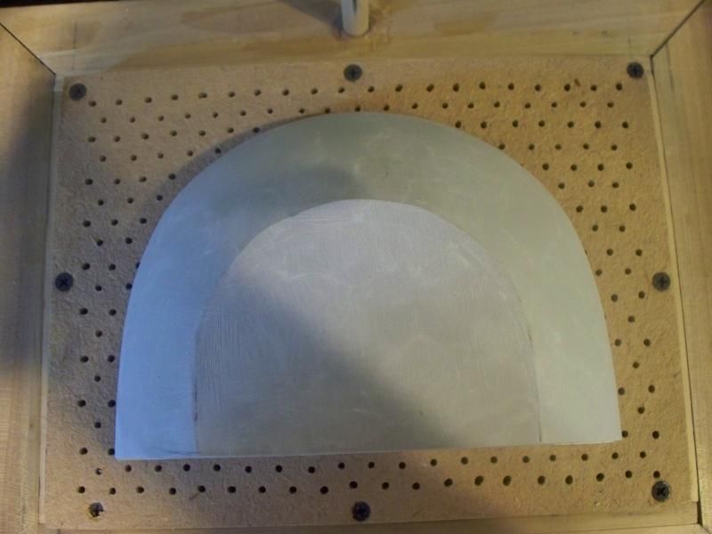

Some work on the fender...... and forming it
in 3mm. I didn't like it in 2mm once the opening
was cut out it was kind of flimsy to me.
Thats' how you want to see the riser then you know your
part is formed tight above it.

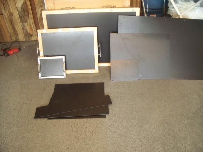

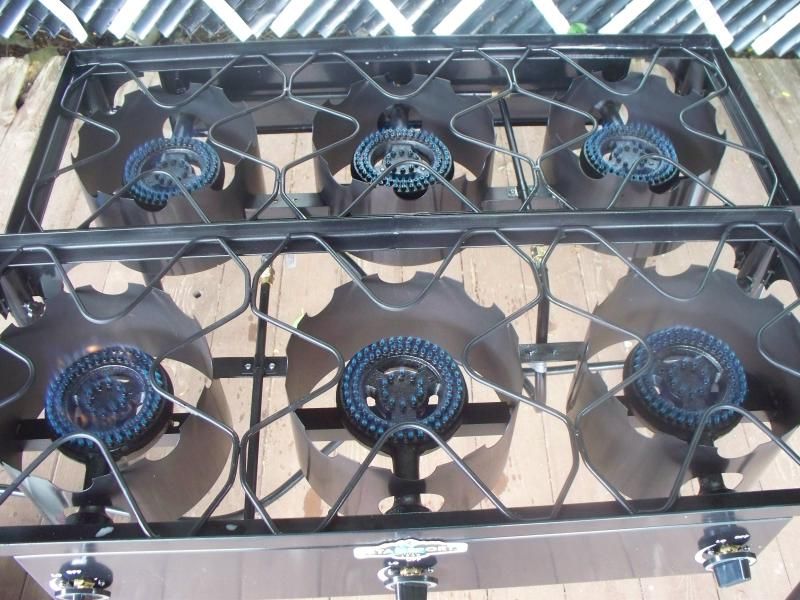

This showed up today they were supposed to be here
on Thursday....of course I don't have the plastic yet. I
went to light it and the propane bottle from the grill
was empty! LOL I have to also pick up another bottle
for the other burner.The frame fits well inside the I
think it's going to heat fine, not sure if I am going to
make a box or not for it .....will see.

I built the box and lined it with aluminum flashing.....
just some pics of the set up.
It only took about 8min for this 4.5mm HIPS
to heat up each one of those burners are
35,000 BTU's on high and there are 6 of
them so around 210,000 BTU's LOL
I probably heated it a little to much it
didn't burn but I got some webbing,
it was away from the part and down on]the riser
so no problem. Not bad it's the 1st time I ever
formed outside .....and 1st time using HIPS over
3mm.

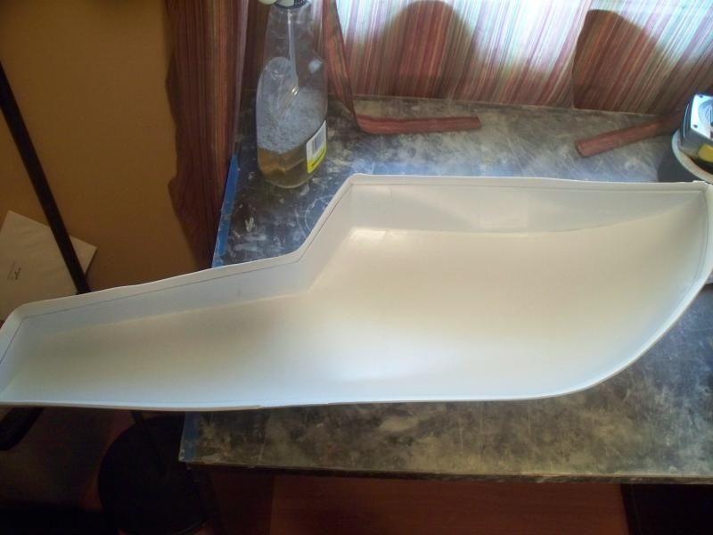

The flash to be cut out is tight and easy to see....
This HIPS may have been around 4.7, as you can see I trimmed
the flash this picture this is at the bottom and I still finished with
4mm!! There is no flex in these things if you hold it by the tail and
shake it it's like a club....LOL Now to do all the trimming measuring
and flat sanding to get the two together clean.

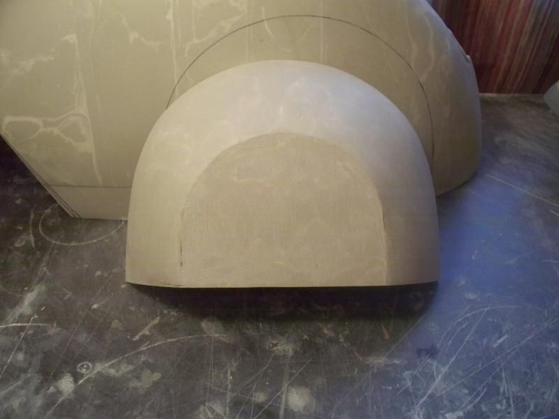

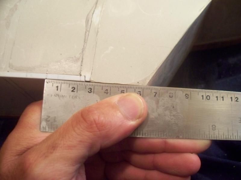

Thanks guys small set back......
I needed 74mm here and i only had around 61mm or 62mm
I had checked this a few times......measuring from the wrong
point every time most likely!:facepalm

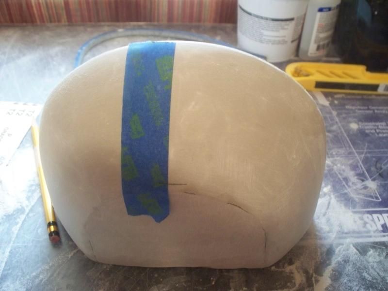

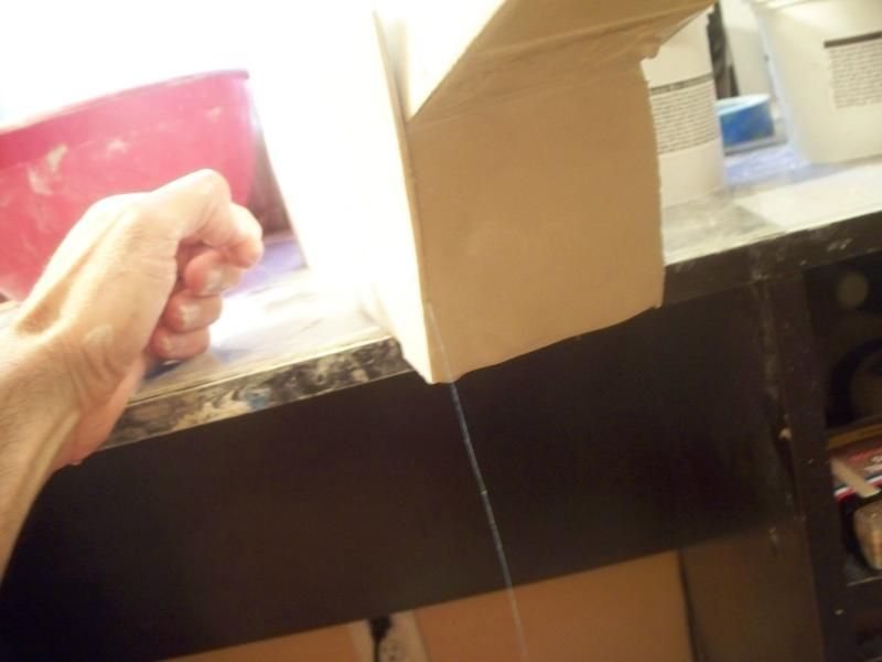

I just formed up what i needed and added some clay...
Using some wet sewing thread to cut the plastic form
away before it set up.
Adding a bit more clay to be able to blend it
in. I also had to add to the end of the tail, as
this was effected also.
I will have to reform them now and i will use some thing
thinner probably 3mm.
