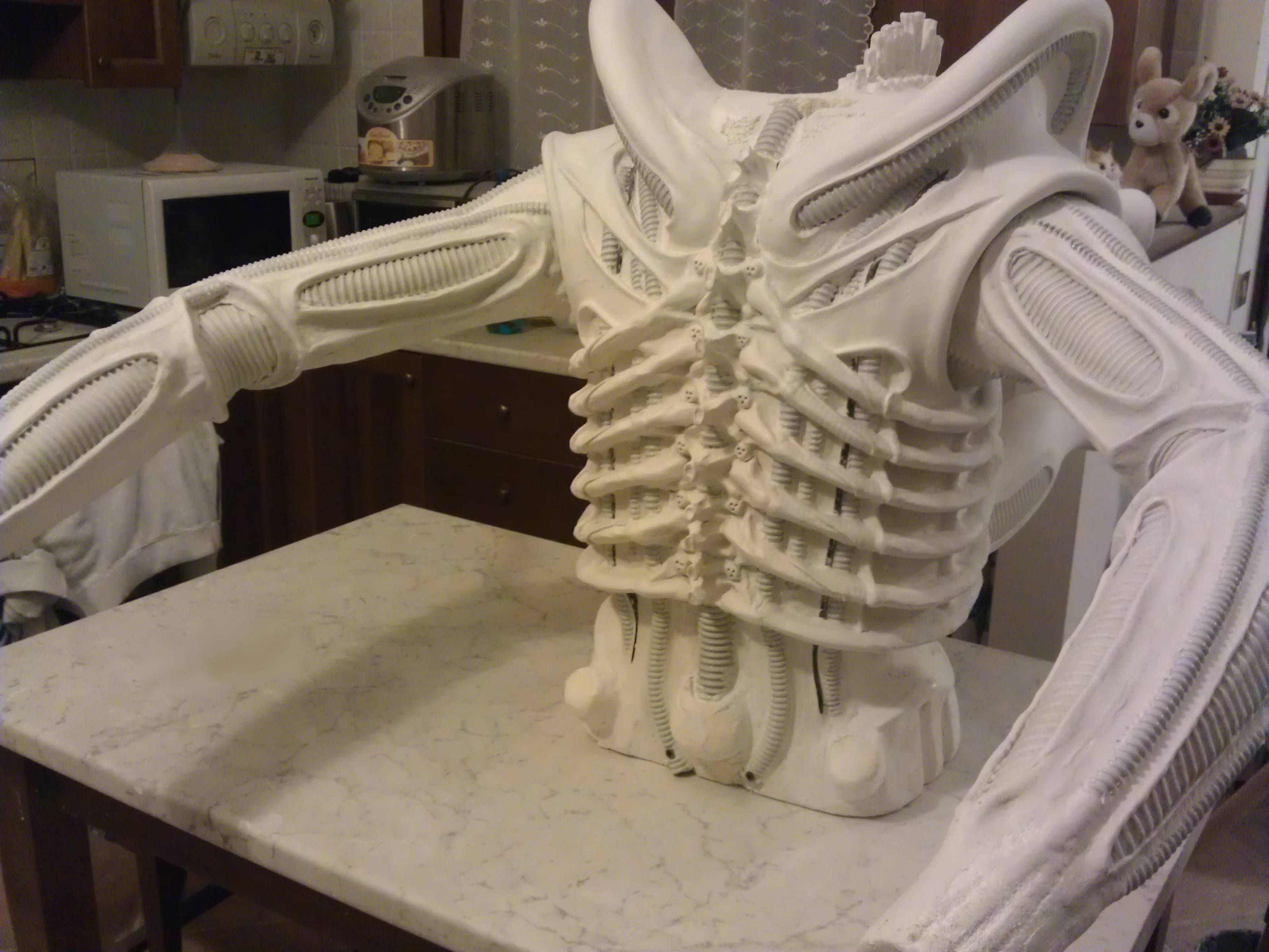

it is only recently that model and I realized only 3 sculptures with clay.
I am a self-taught and I do this only as a hobby , a couple of hours a day.

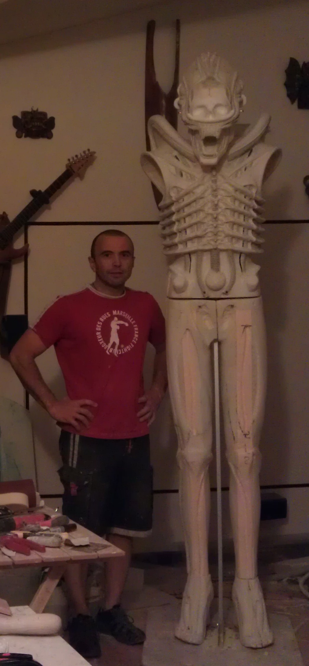

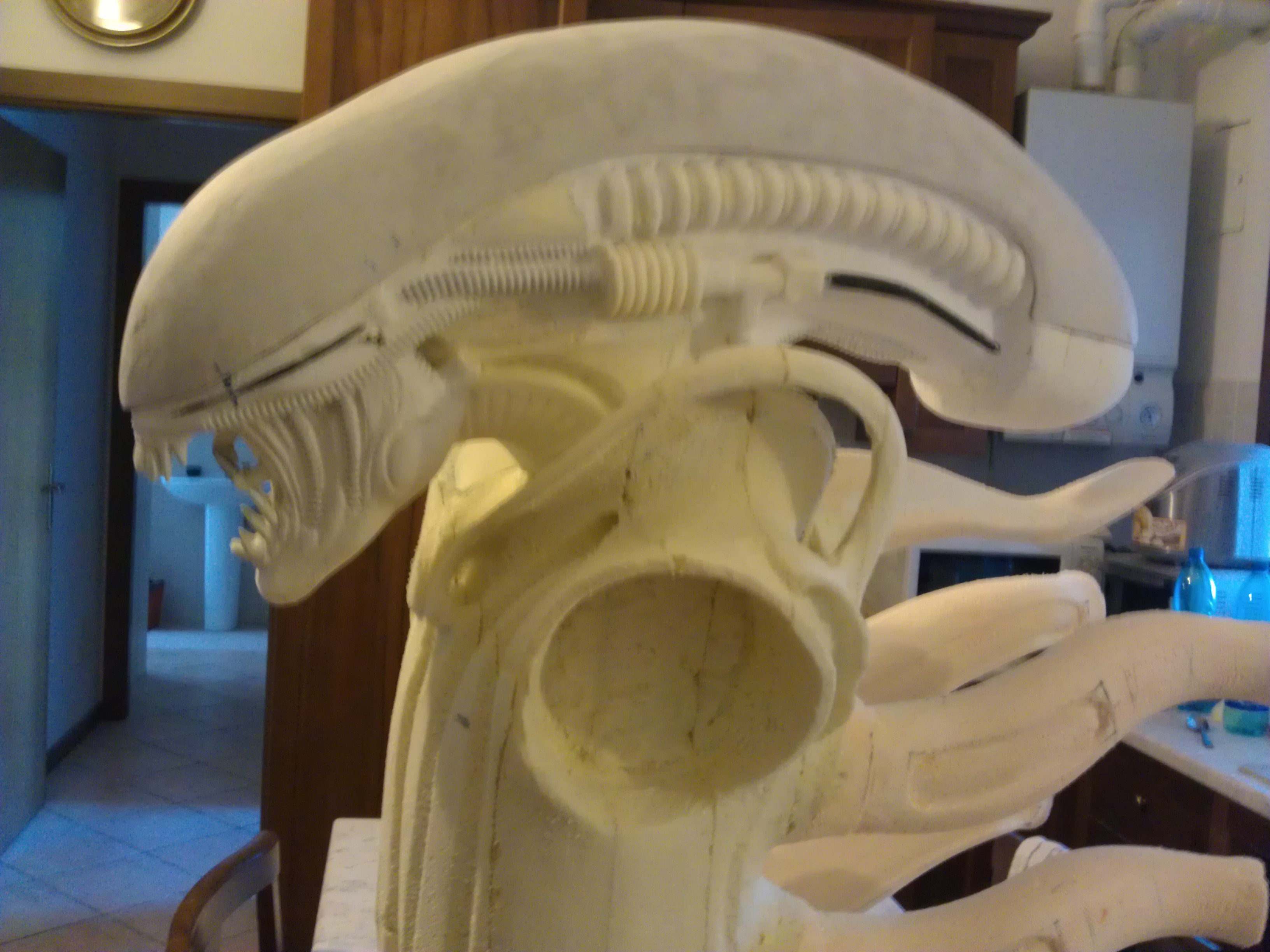

This is my first work with these mixed materials :
extruded polystyrene , which is great for getting volume and structure but not for the details ;
polyurethane , which is great for the details but it is not structural ;
DAS modeling clay , a little modeling , but economic and sufficient for certain types of details ;
canary seed as a filler or plaster to smooth the surface ;
screws used as a core to strengthen protruding parts, plastic pipes and rubber , iron and aluminum profiles .
In this site you can see impressive works and I do not have much to teach, but to learn.
I started this sculpture on 21/06/2013 and I think I finish it in about twenty days.
For the moment I am attaching this image that a transition in a couple of weeks ago.

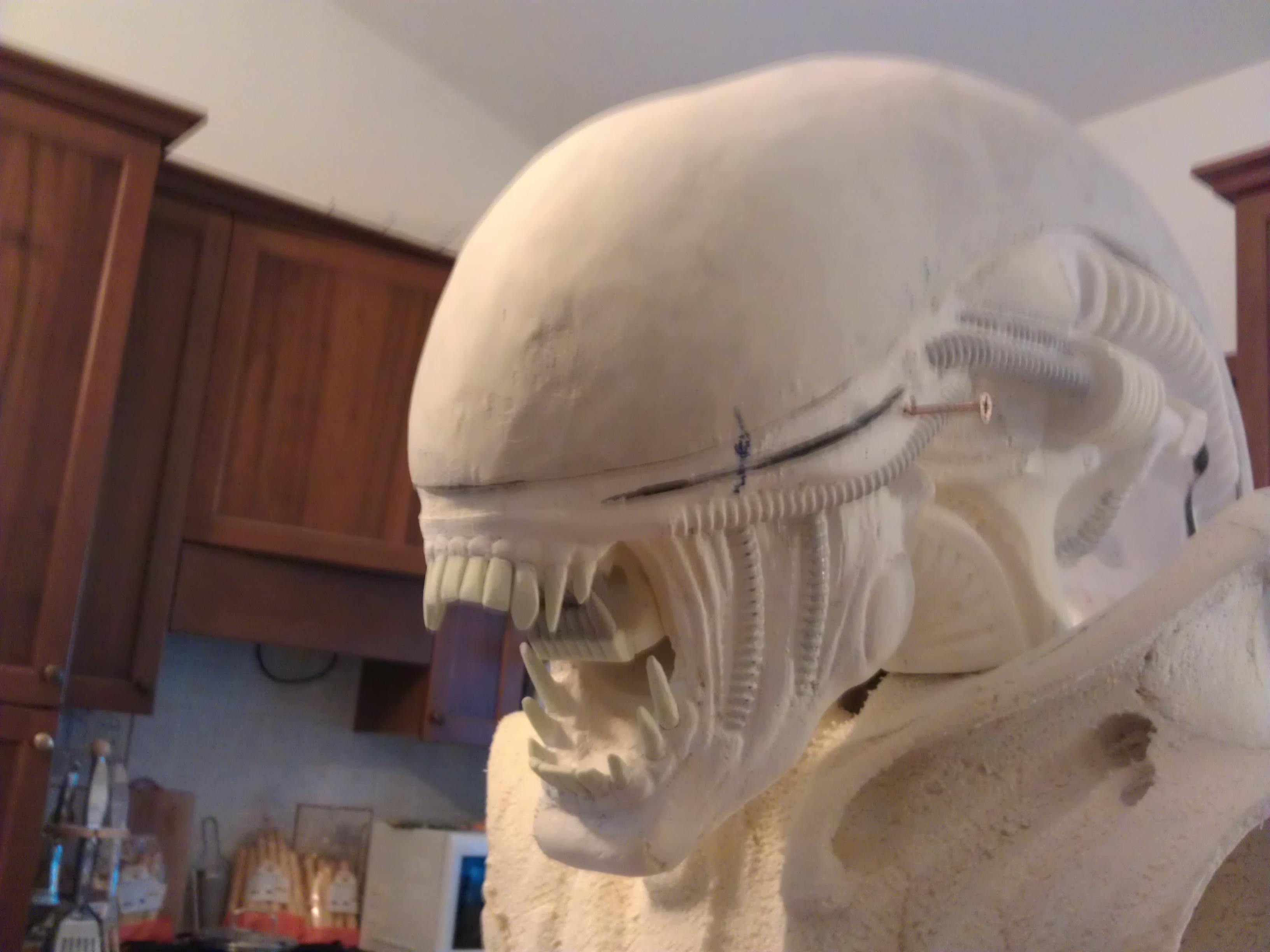

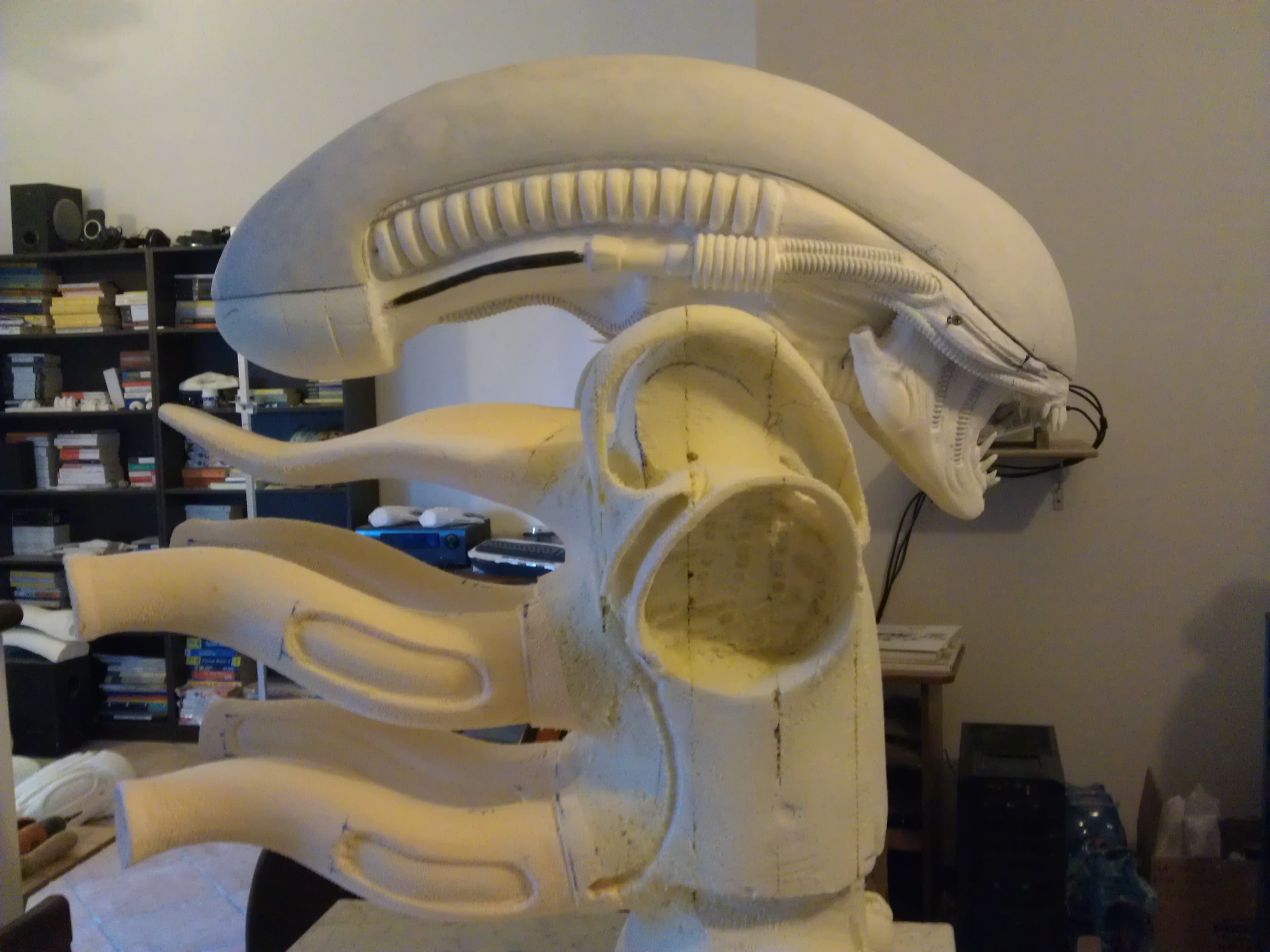

Inside the limbs are inserted joints, because initially I thought to create a more attractive, as seen in the comics, but then I realized that all the pictures that I found about it, did not reflect the personality of the first Giger Alien. Alien walking slowly and seemingly calm in his inspection of the environment, as seen in this video:
Only in the encounter with someone, he raised his arms to hold their head and screwing with retractable jaws. He also had hypnotic movements, as seen in this video:
where his hands move to hold the attention of the victim, while acting with the stinger on its tail. Too bad that the director has cut many scenes, in my opinion, very characteristic of the alien.

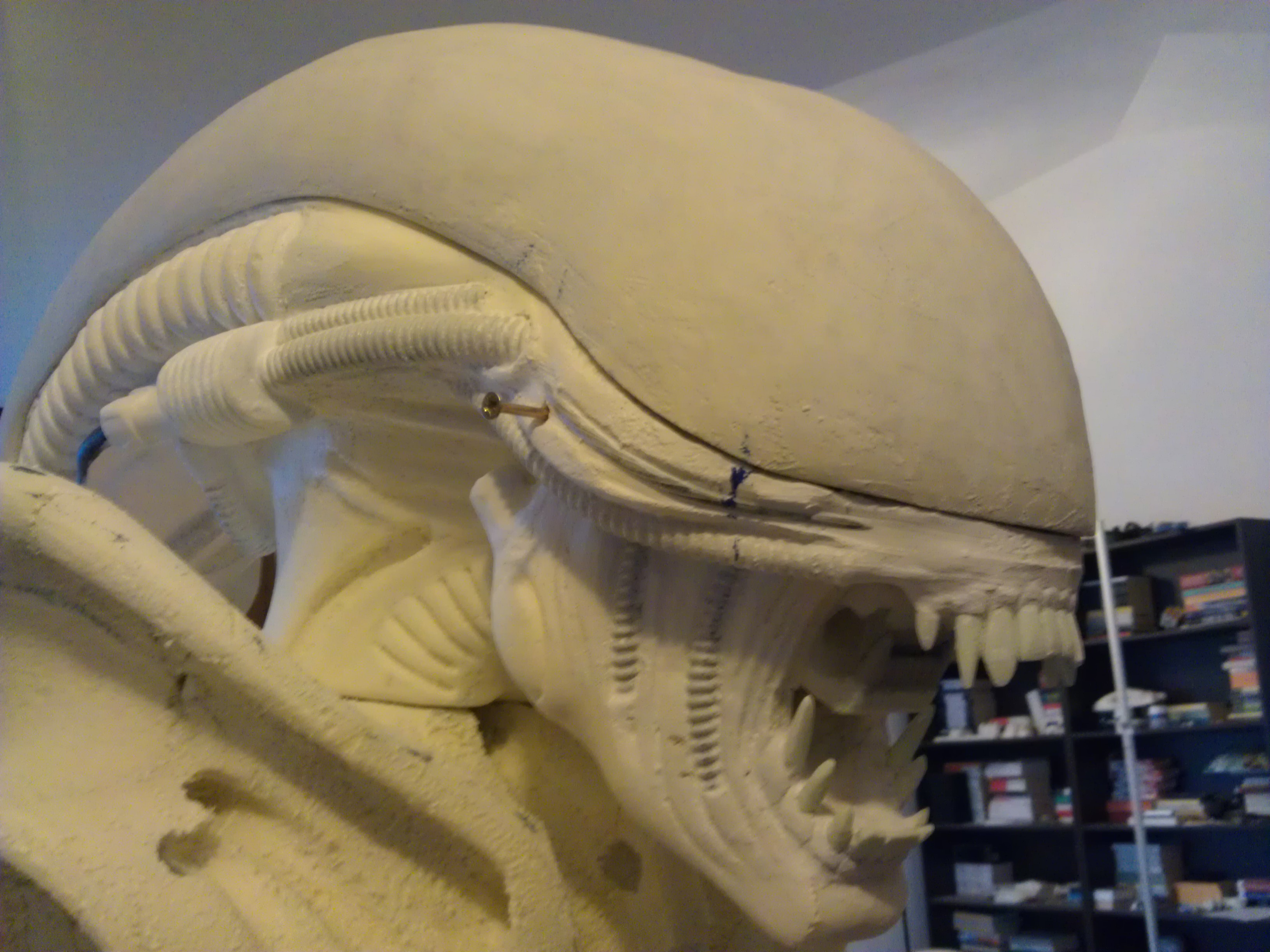

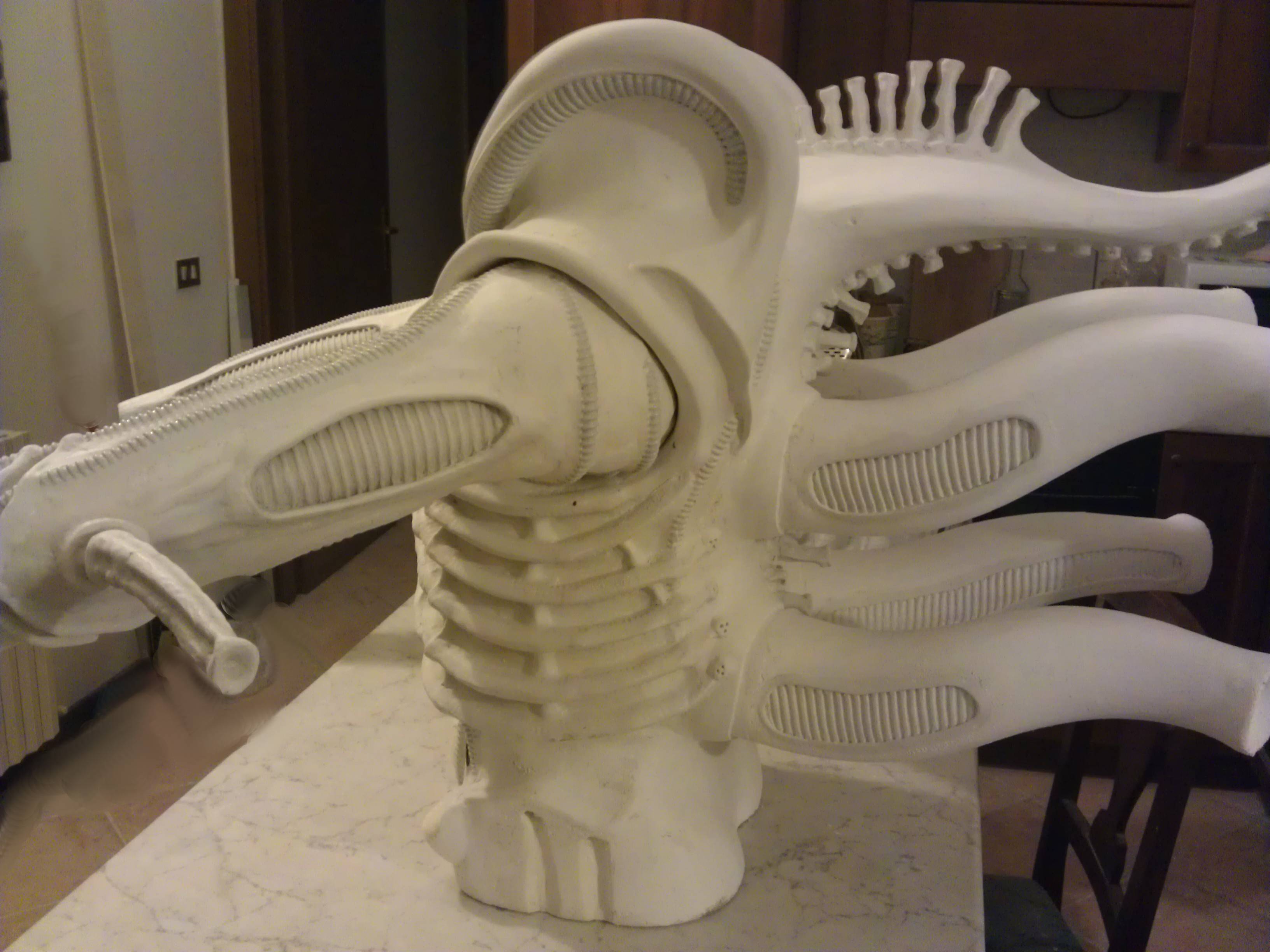

I added the pipes and corrugated surfaces to arms, glued tubes and connected with modeling clay. I used a little 'bigger pipes than the original, because I like the most. Furthermore, for the same reason, I added a corrugated surface outside of the forearm, which in the original is not there. To realize the corrugated surfaces I used a corrugated pipe like a rolling pin on dough modeling, inserting it into a rod of wood.
As soon as the modeling clay will be dried, I will be able to get a sanding surface more smooth, although I prefer to leave it a bit 'rough because I think it is more realistic.
soon with new images. :D

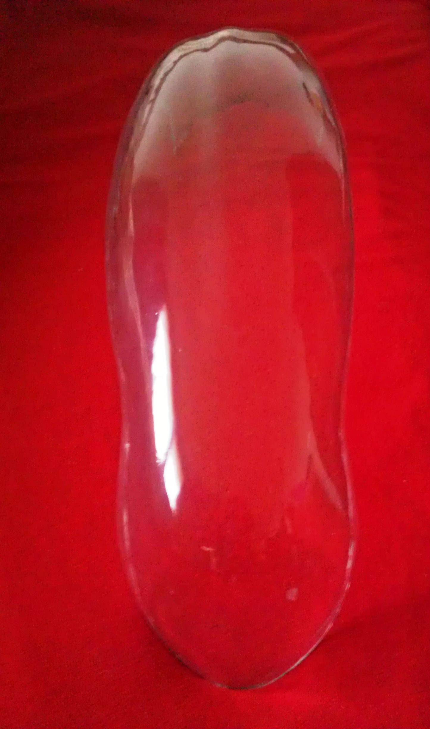

Re: My life-size sculpture of Giger Alien Version
Hello to all,

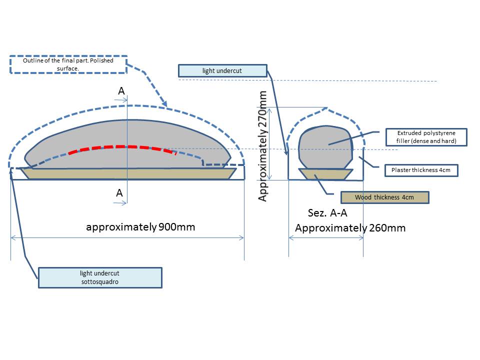

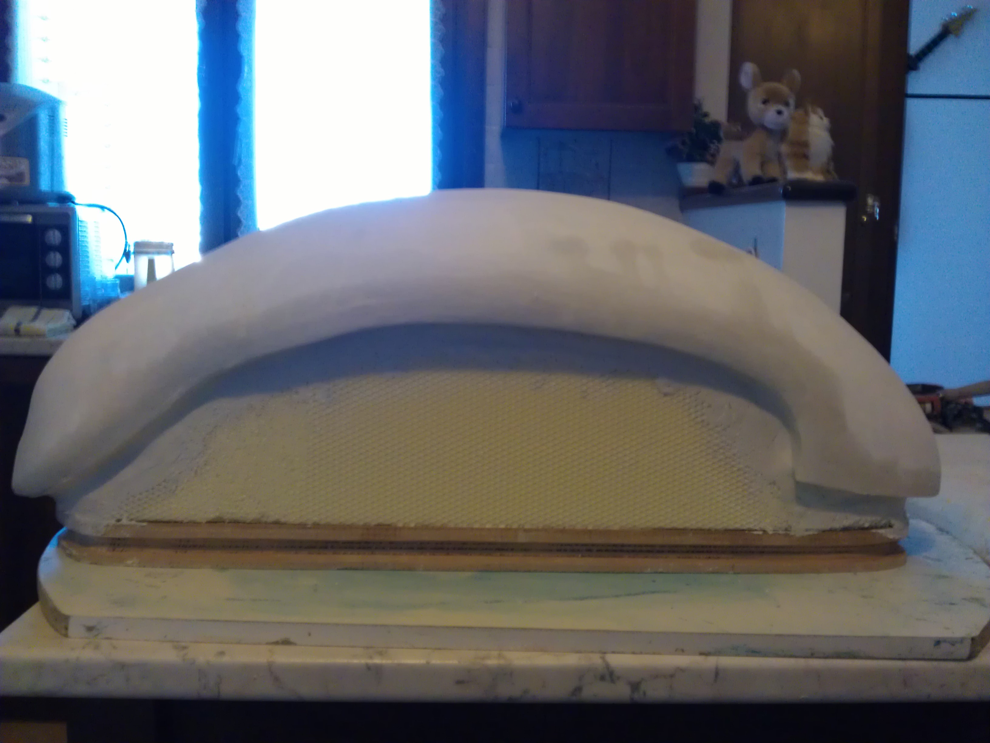

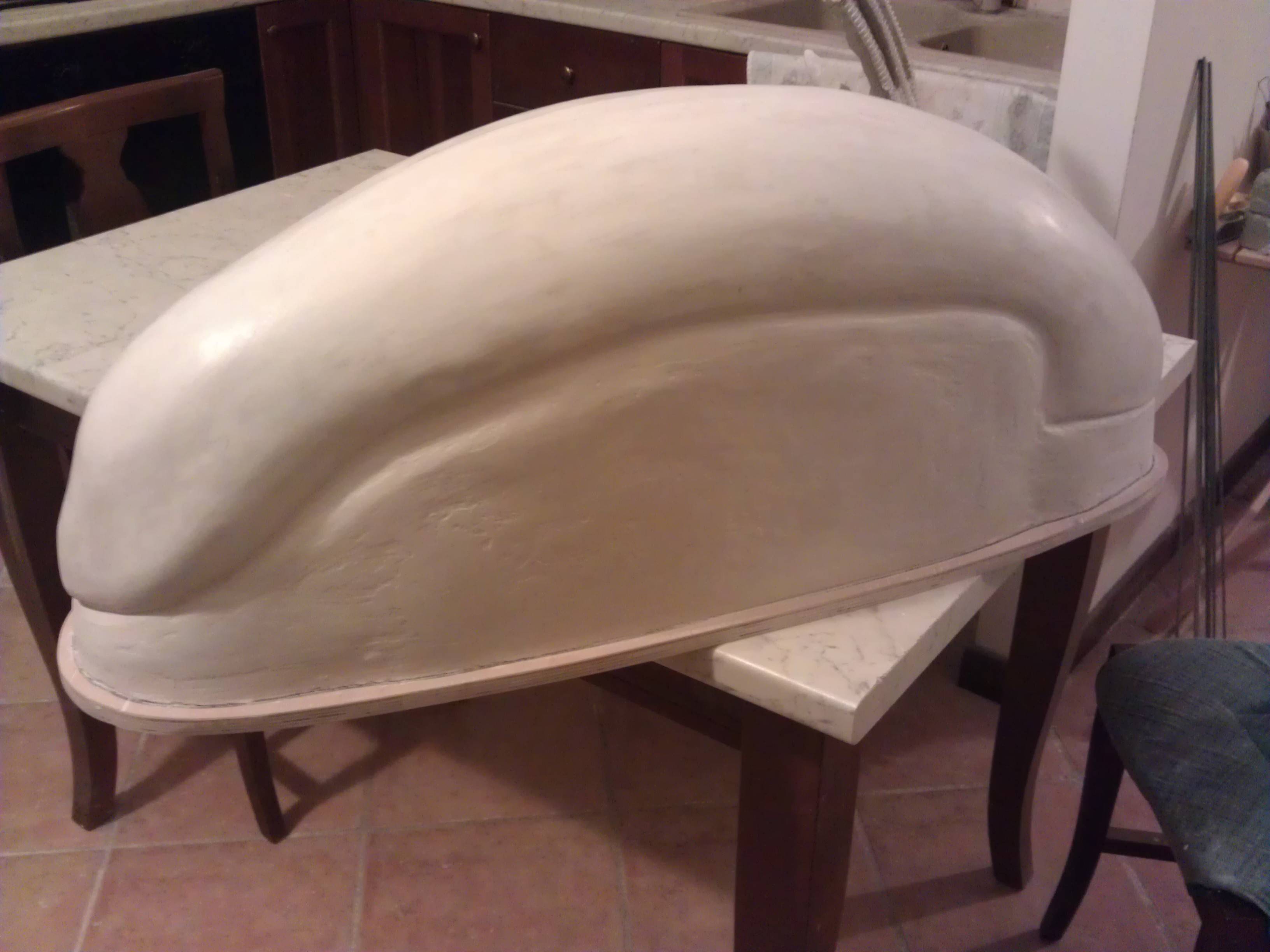

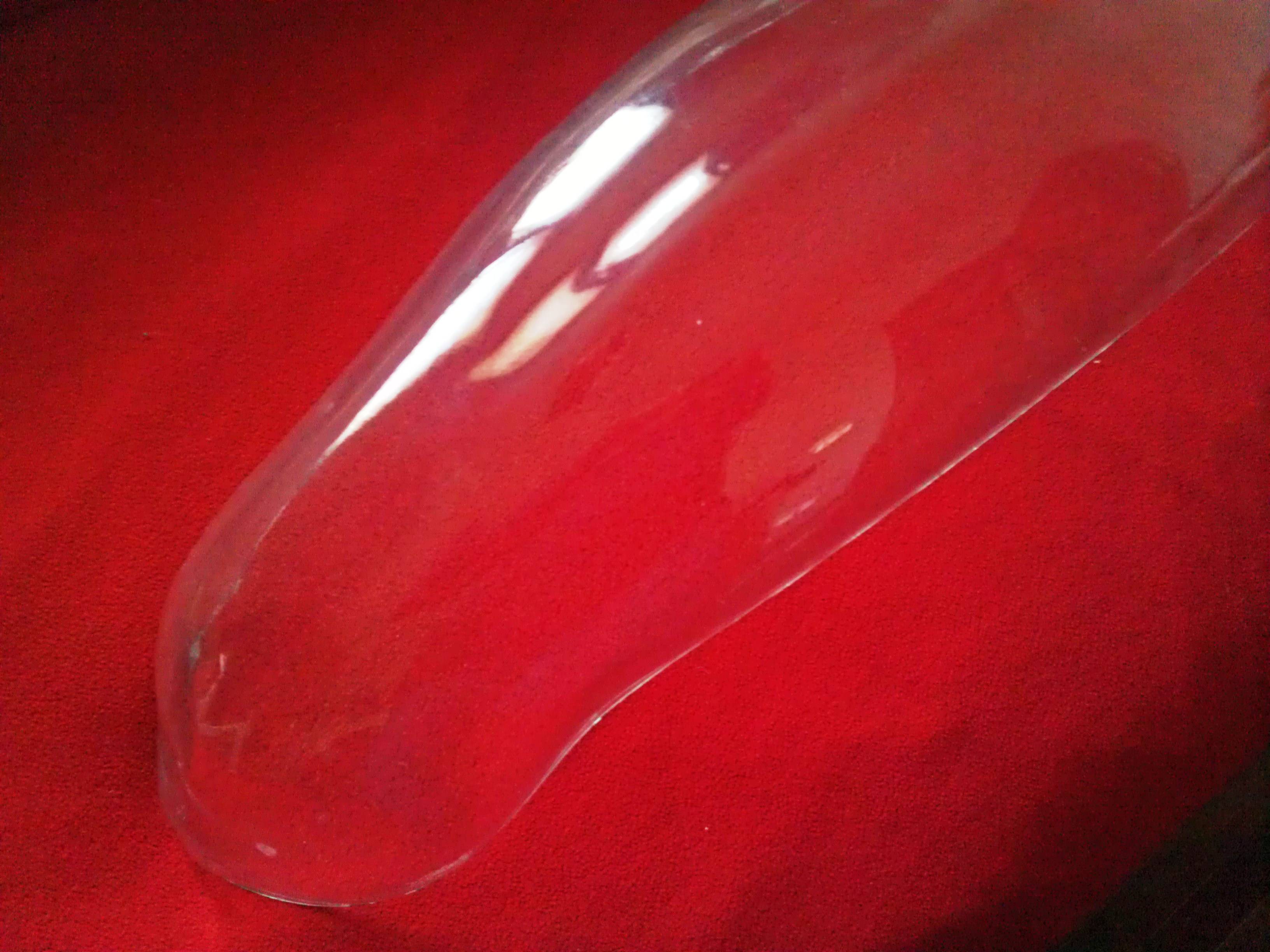

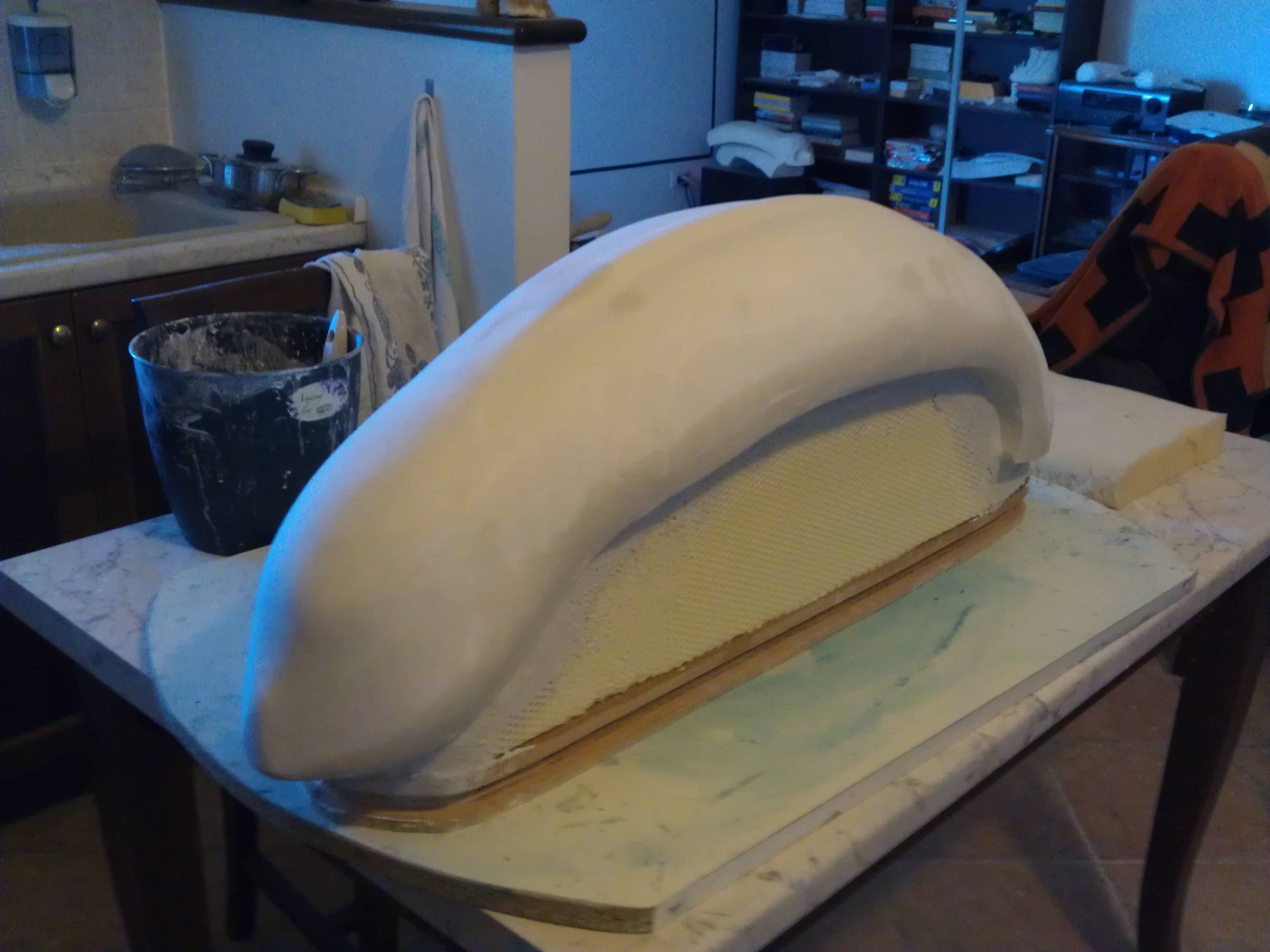

This is the plaster mold to make thermoformed transparent dome placed on the head. Its internal volume is polystyrene with a wooden base to allow mounting with screws to the thermoforming machine. The quality of the transparency is caused by the material and smoothing of the mold. To obtain a good surface I gave the last layer with a synthetic gypsum very hard, while the inner part is of canary seed, which is more moldable but too tender for thermoforming. Unfortunately, the first printed it did not go very well because the outer layer was too thin and cracked during forming. I had to do it again. I recommend having a hard layer not less than 7-8 mm. The thickness of the departure of the polycarbonate sheet not less than 5mm.

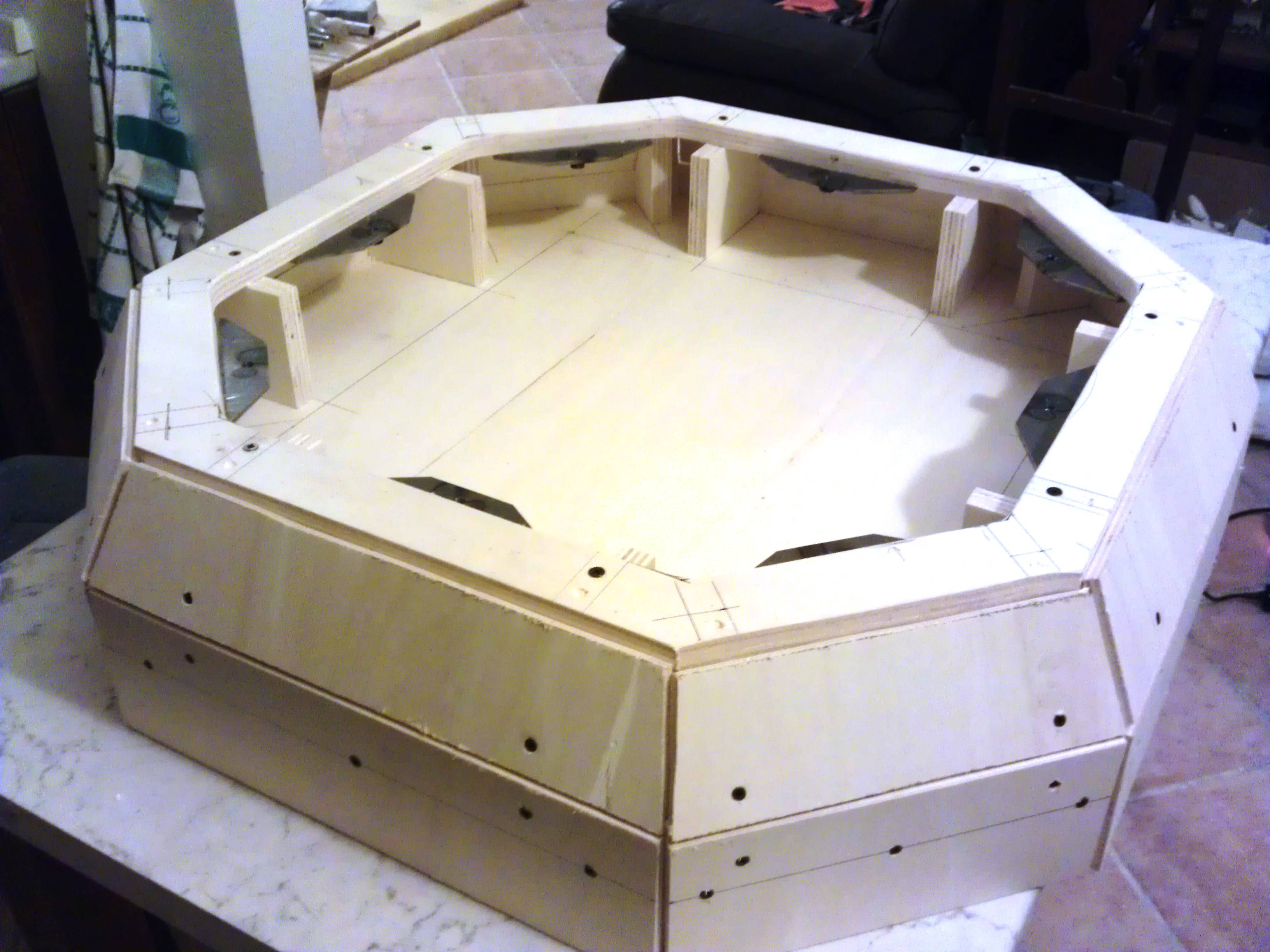

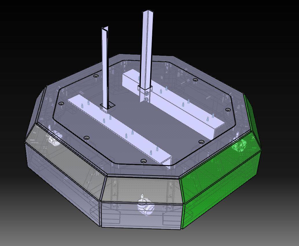

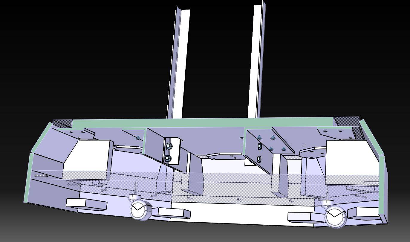

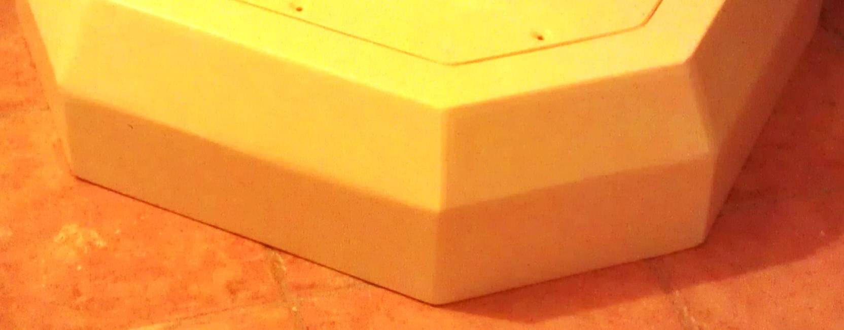

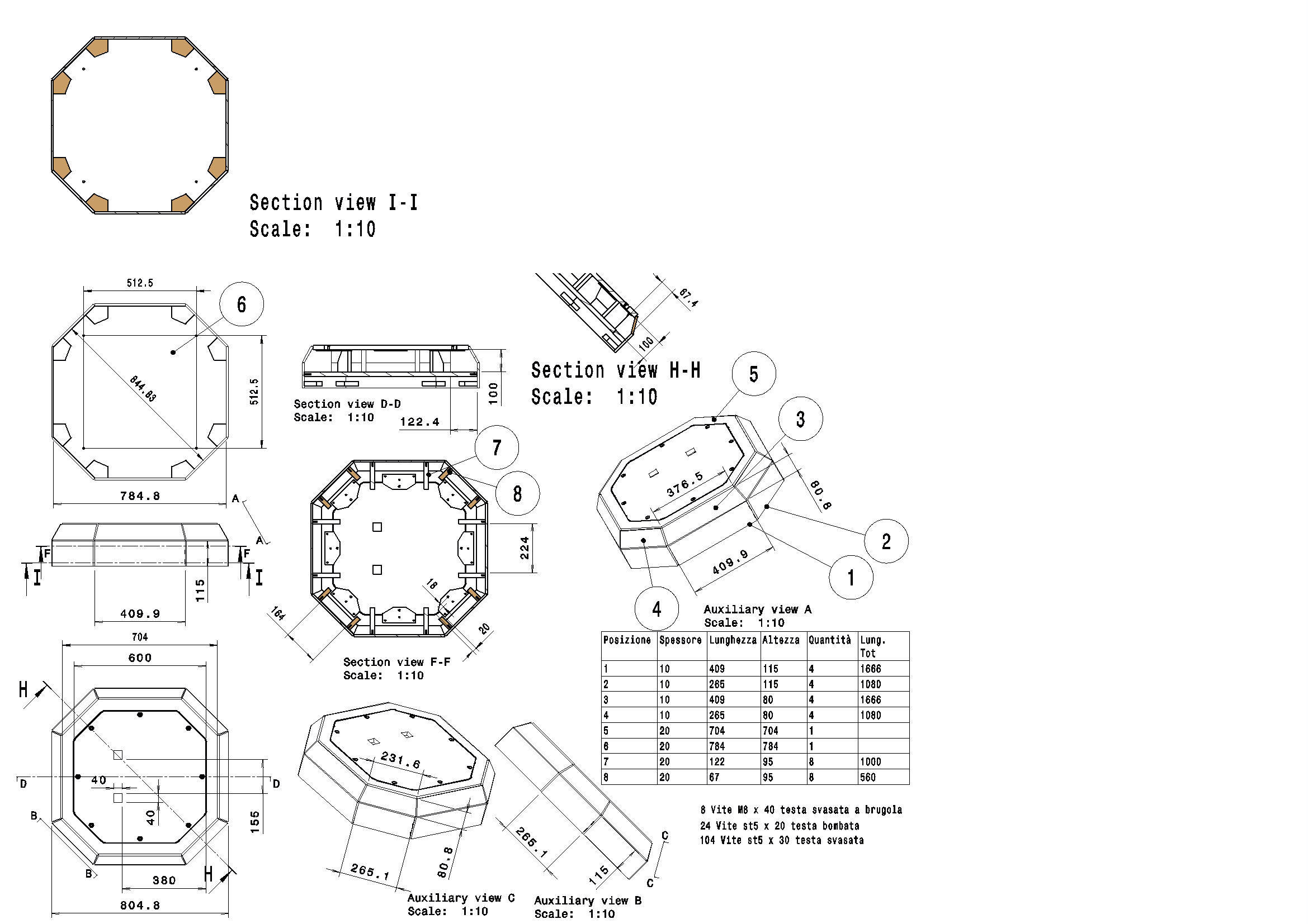

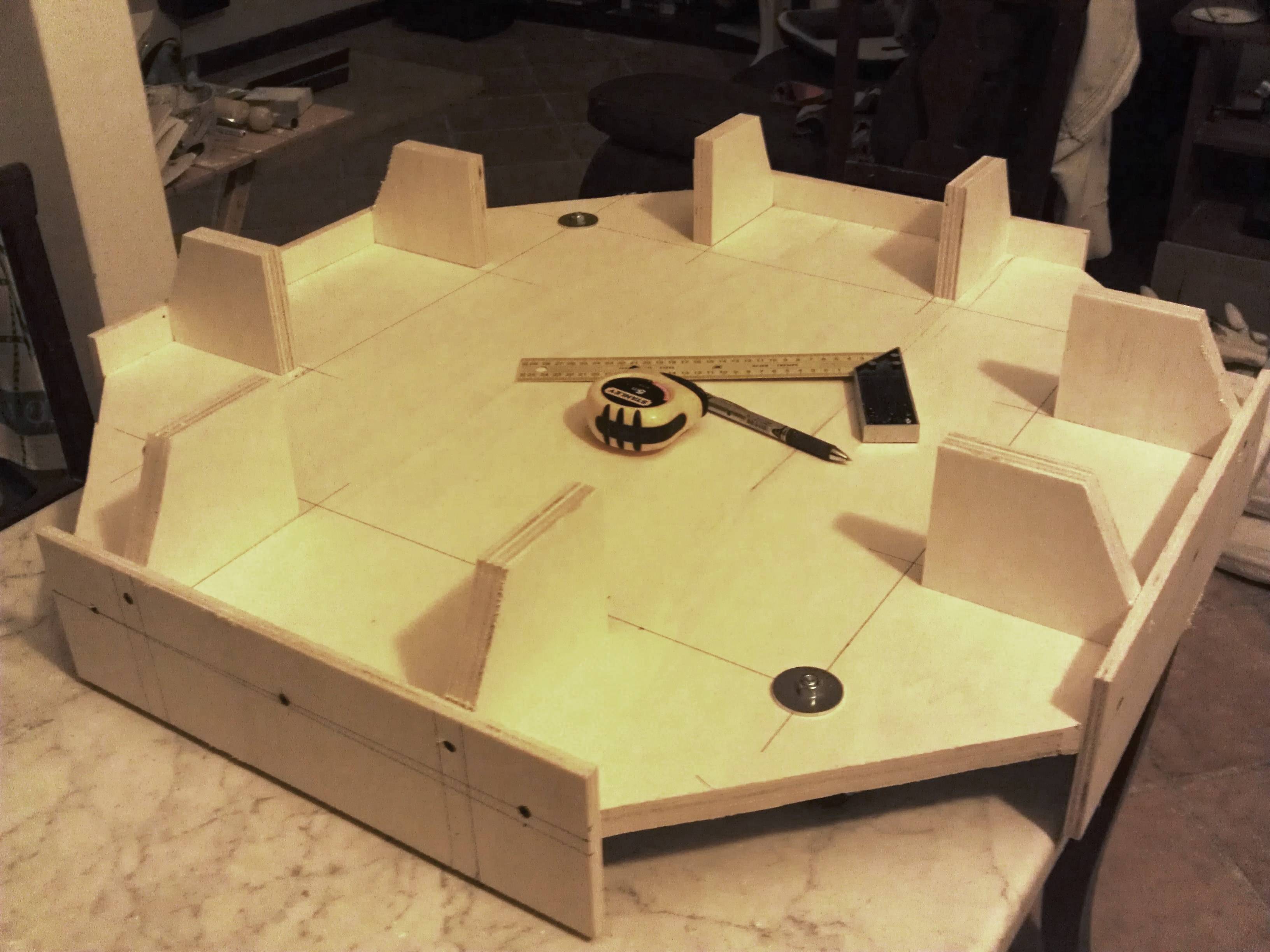

Hello to all,

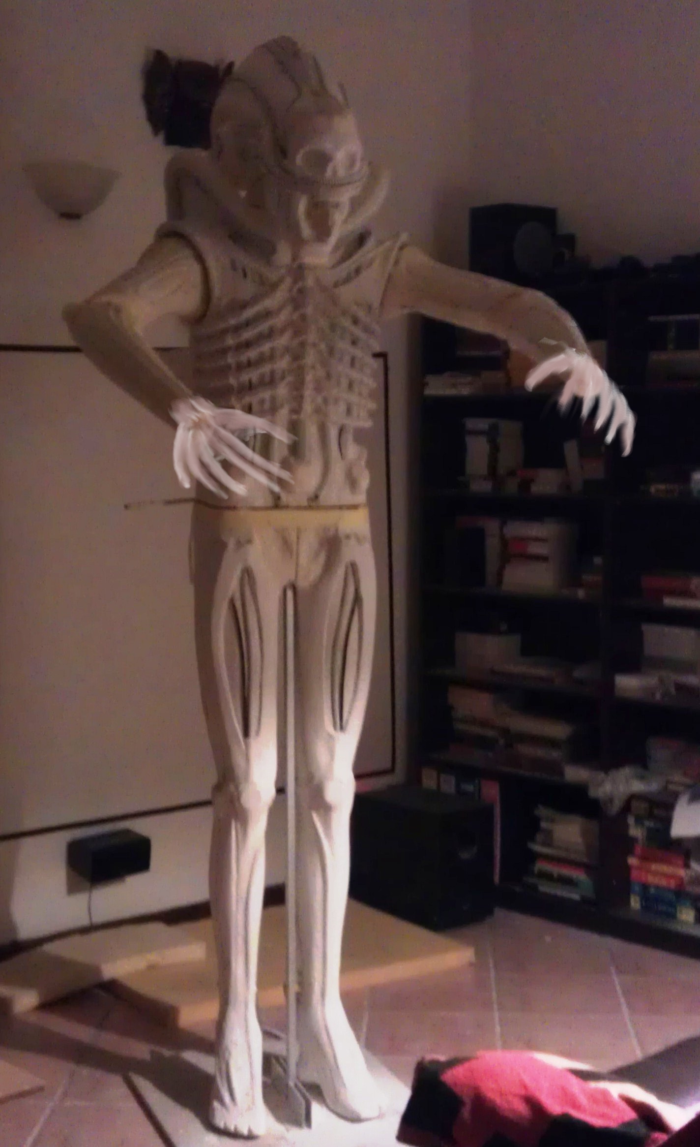

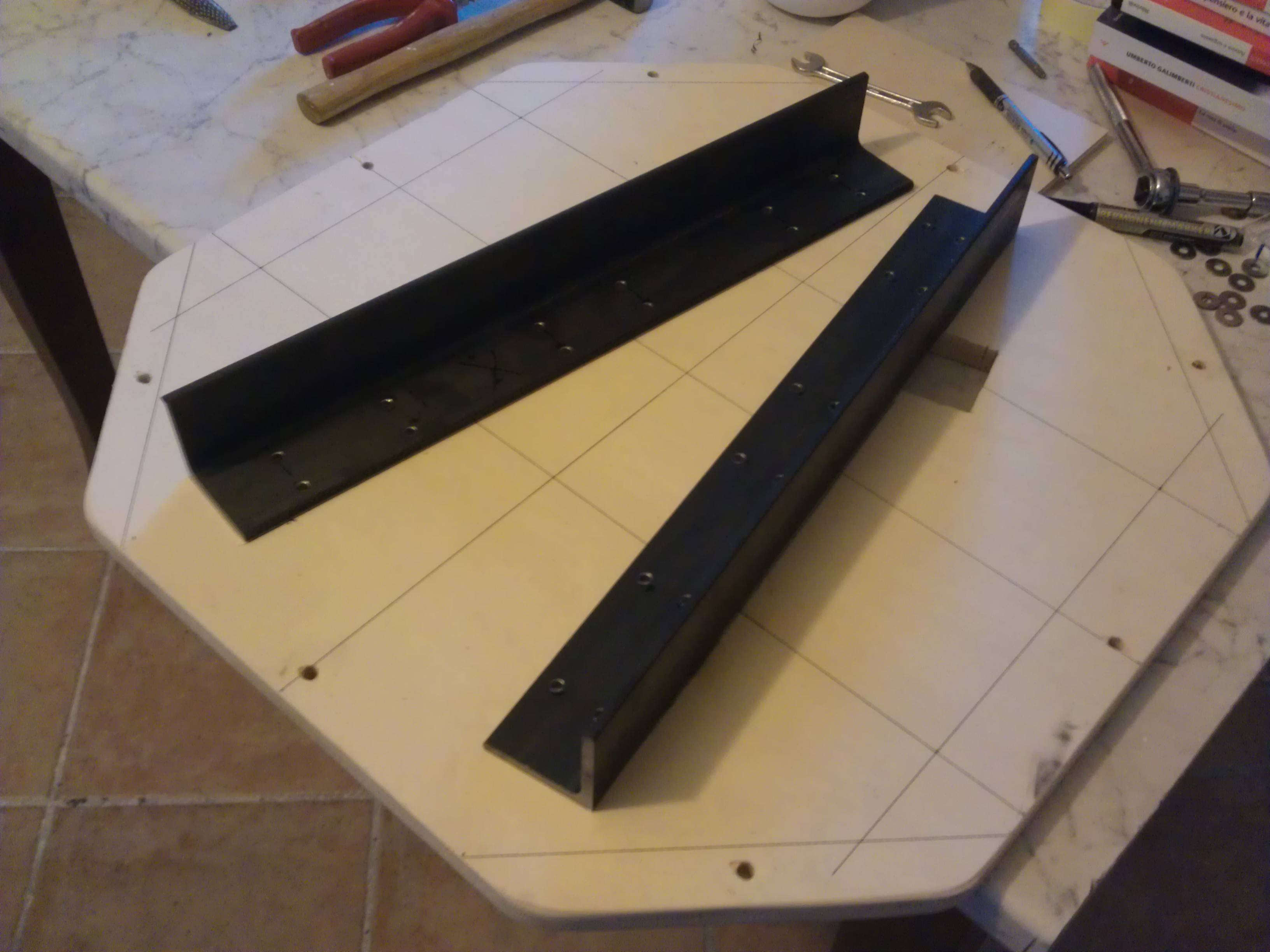

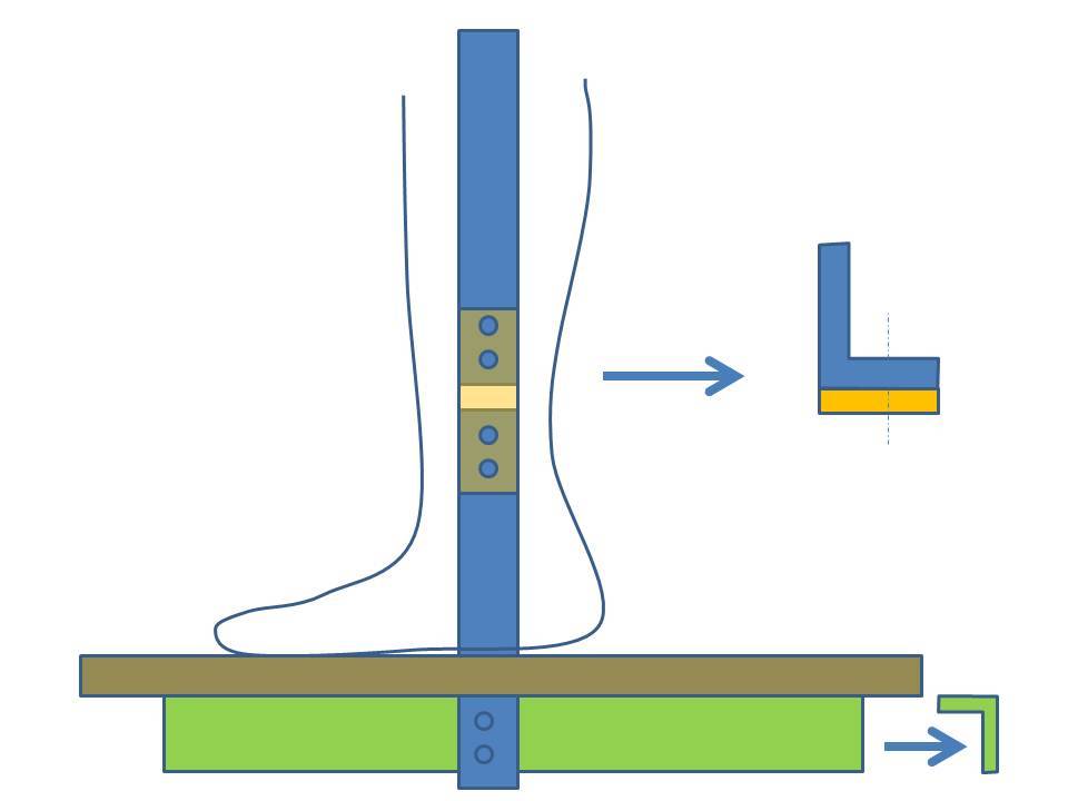

This is to design the wood pedestal with wheels. The statue contains an armature in the legs, made ​​of angle iron sections. by means of plates, these are combined with other angle iron which is fixed on the base of the pedestal. The twin holes prevent rotation of the parties.
This is the finished, plastered and painted.
To the next.;)
More information on creating a transparent dome.
the area devoted to the dome, I put the filling of polystyrene on the alien head and put the plaster until it reaches the edges of the head, trying to quickly model the plaster with a spatula. Days later, when the plaster has dried, I worked with the rasp to shape, mostly in the front of the face. Not to work on the head threatening to ruin it, I removed the plaster and I placed on another support that completed the entire mold and I finished coated with plaster.
