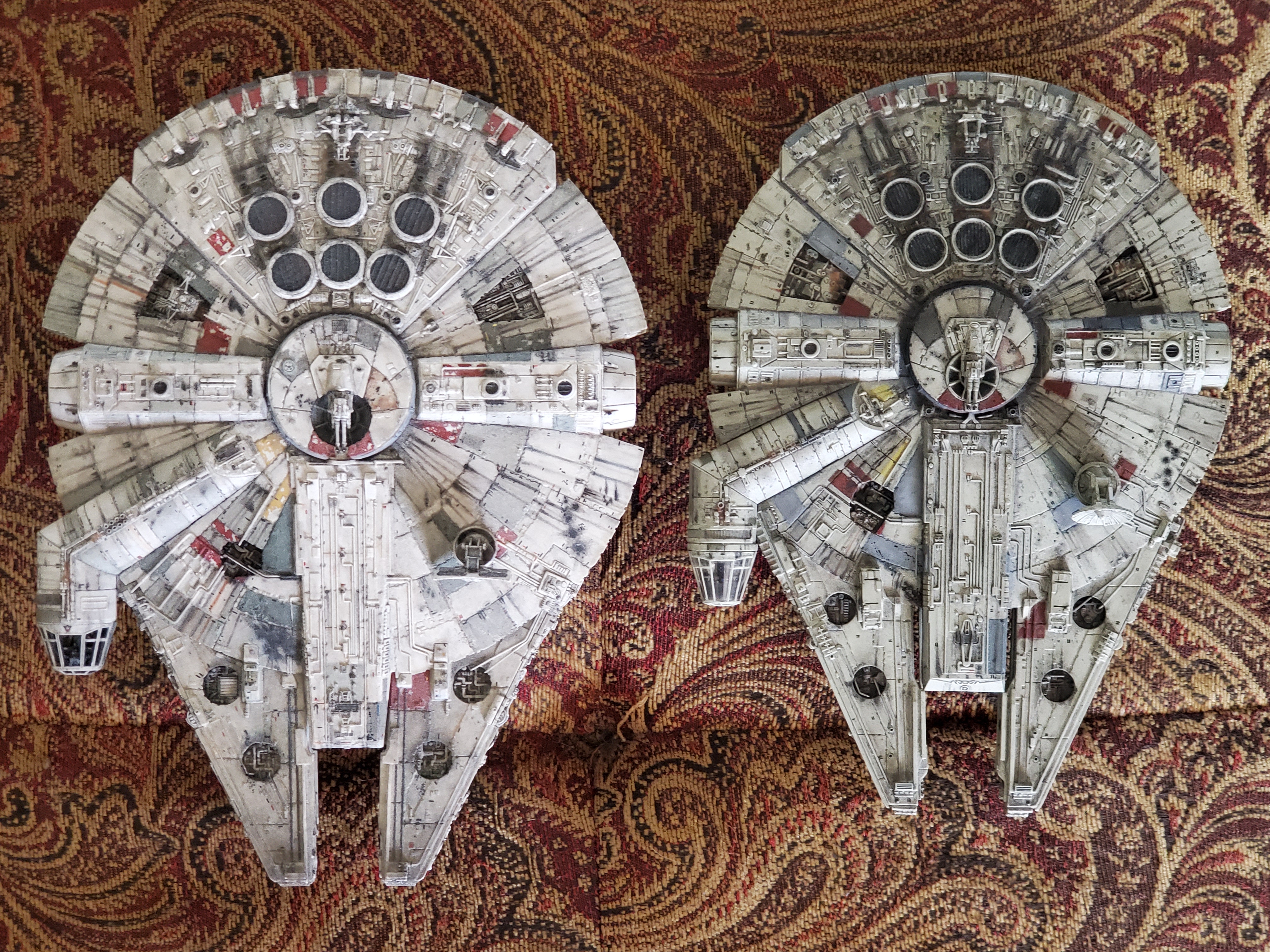

Here's a comparison of the Bandai Falcon and the FM Falcon side-by-side.
If I were to choose, I would definitely prefer the Bandai 1:144 Falcon, hands down. It is more intricately detailed, well-engineered, and accurate to the 5 footer, if you want your model to look like the 5 footer. If you're planning to build a model that looks like the 32" model, I would recommend the FM 1:144 Falcon, because it is accurate to the 32" model. I decided to buy both because I wanted to make models of both the 5 footer and the 32 inch model as well.

That is pretty much the same relative size difference between the Bandai PG 1/72 and Fine Molds 1/72

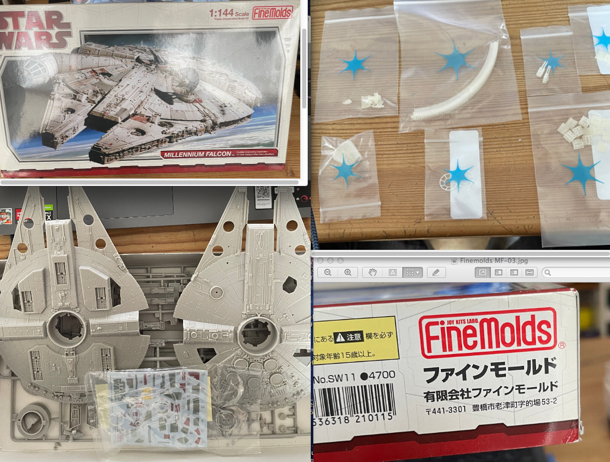

So ... I found a bargain on ebay ... from Germany a Finemolds 1/144 Millennium Falcon with additional 3D shapeways cockpit and more parts ... not very cheap but still less than the one in the model-shop.
Pictures from seller on ebay.
So thanks JV1138 for posting your thread and persuading me to buy another modelkit, which will find it's way on the rest of the stash of modelkits ... waiting to be completed. Then again this might be a good model to start my painting skills on, before I tackle my Hasbro Hero 28"Millennium Falcon.
