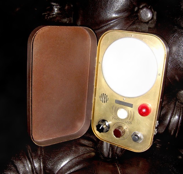

Now with the knurled sockets on the side:
Natural light:
With flash:
I really like how that turned out Deck. What did you use to age your faceplate? It looks really nice. ^_^
Re: Warehouse 13 Prop Research - The Farnsworth
Thanks! Combination of things -- Ammonia fumes, vinegar, sea salt, and detail enhancer combined with artificial dust and grime around the edges of the screen, the bulb, the numbered recess, that sort of thing.
