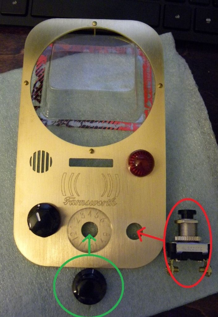

Is there a good file for the faceplate somewhere? I've found an .ai file in this thread, but it wouldn't open in my photoshop.
So where did I go wrong? My knob for the "brown knob" looks off - other than color. is there a specific knob for this, because my closest find isn't measuring up (circled in green.)
Also my push button threaded shaft is too wide for the awesome farnsworth plate from a recent run (circled in red.) Anyone know of better?
Sulla, based on the photo, I can't tell if you're using the correct middle knob or not... Do you have a side profile shot of it? Either way, you'll have to shave off the skirt on the knob to match the original.
Sulla it looks like the wrong pushbutton but you could use it of course by making the hole bigger. The right switch can be hard to find but the correct part number is listed in this message thread..
