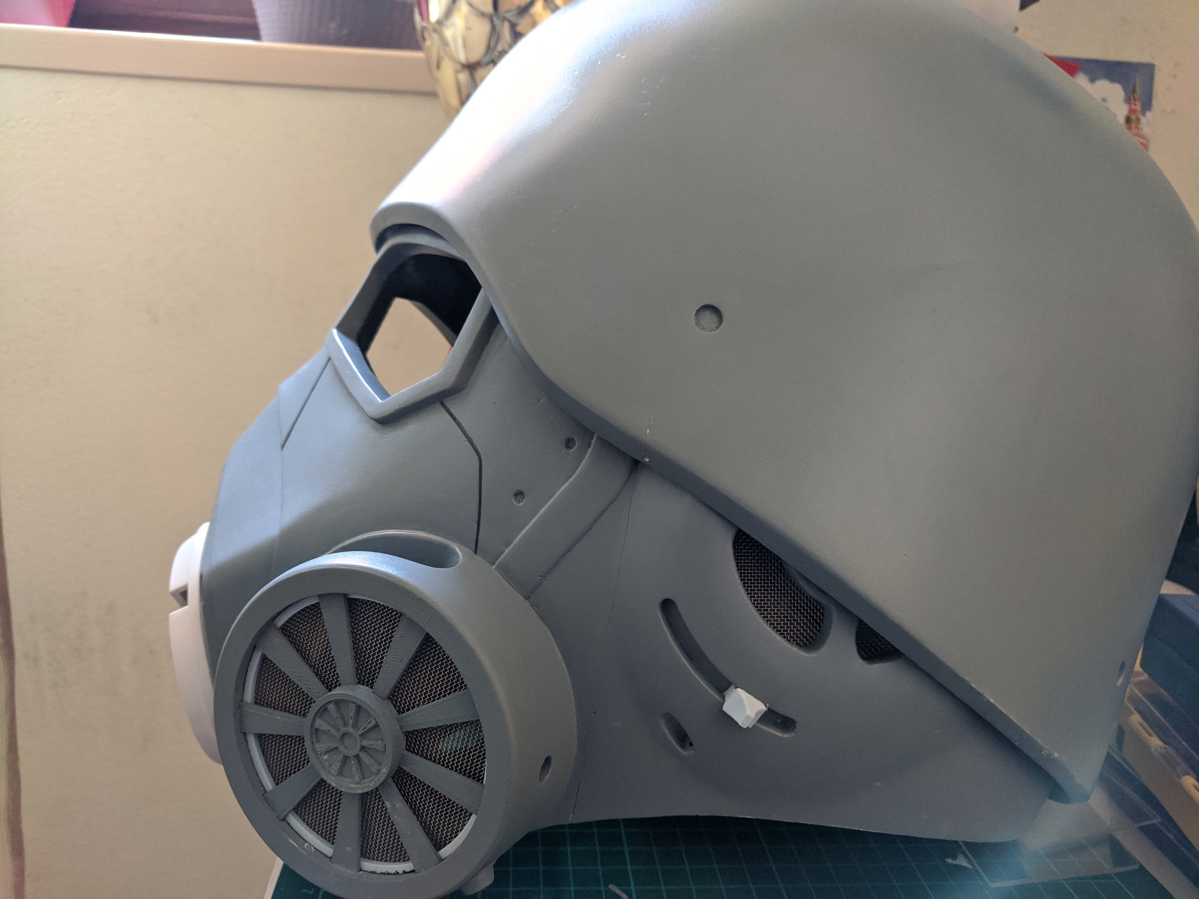

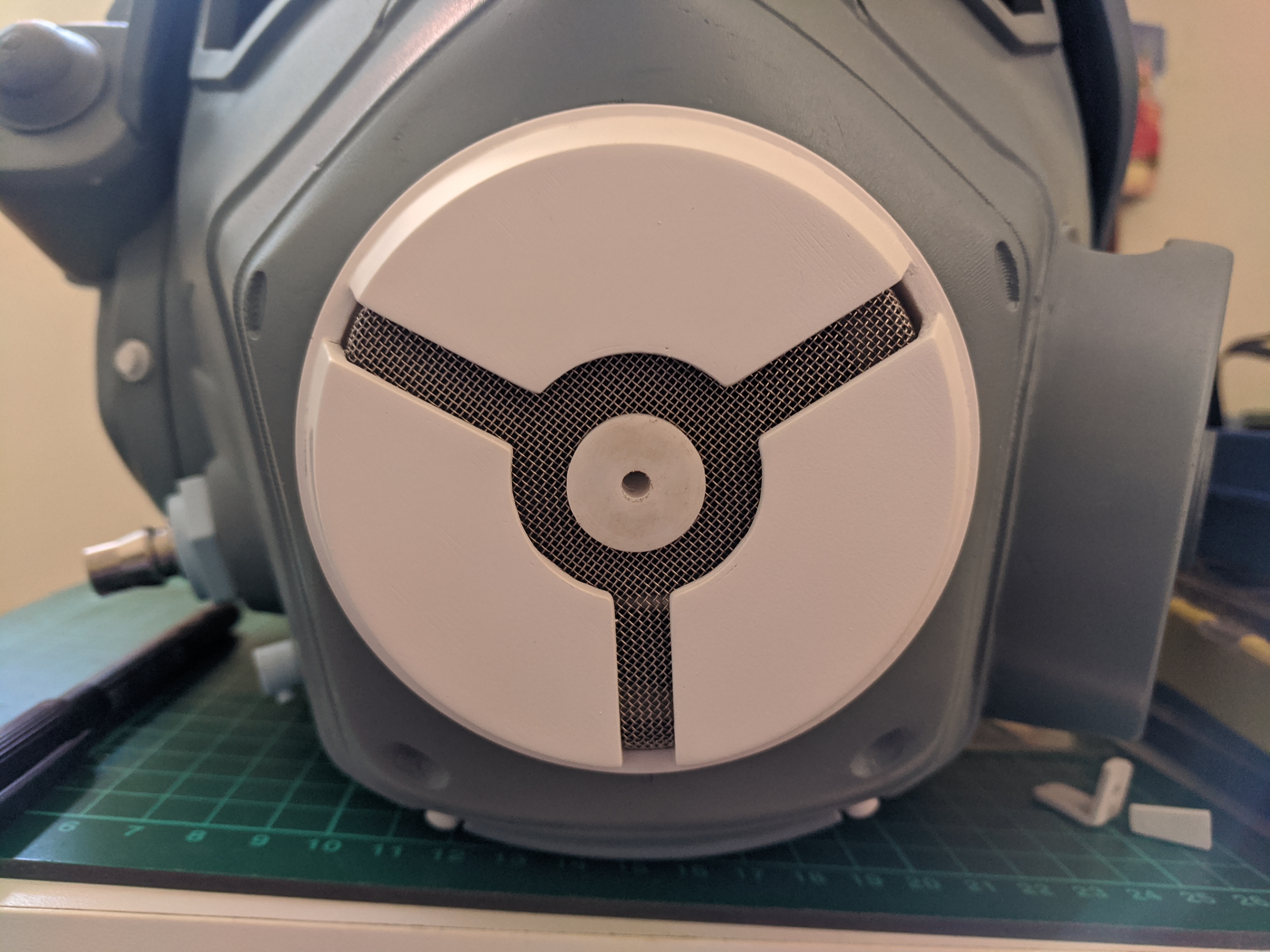

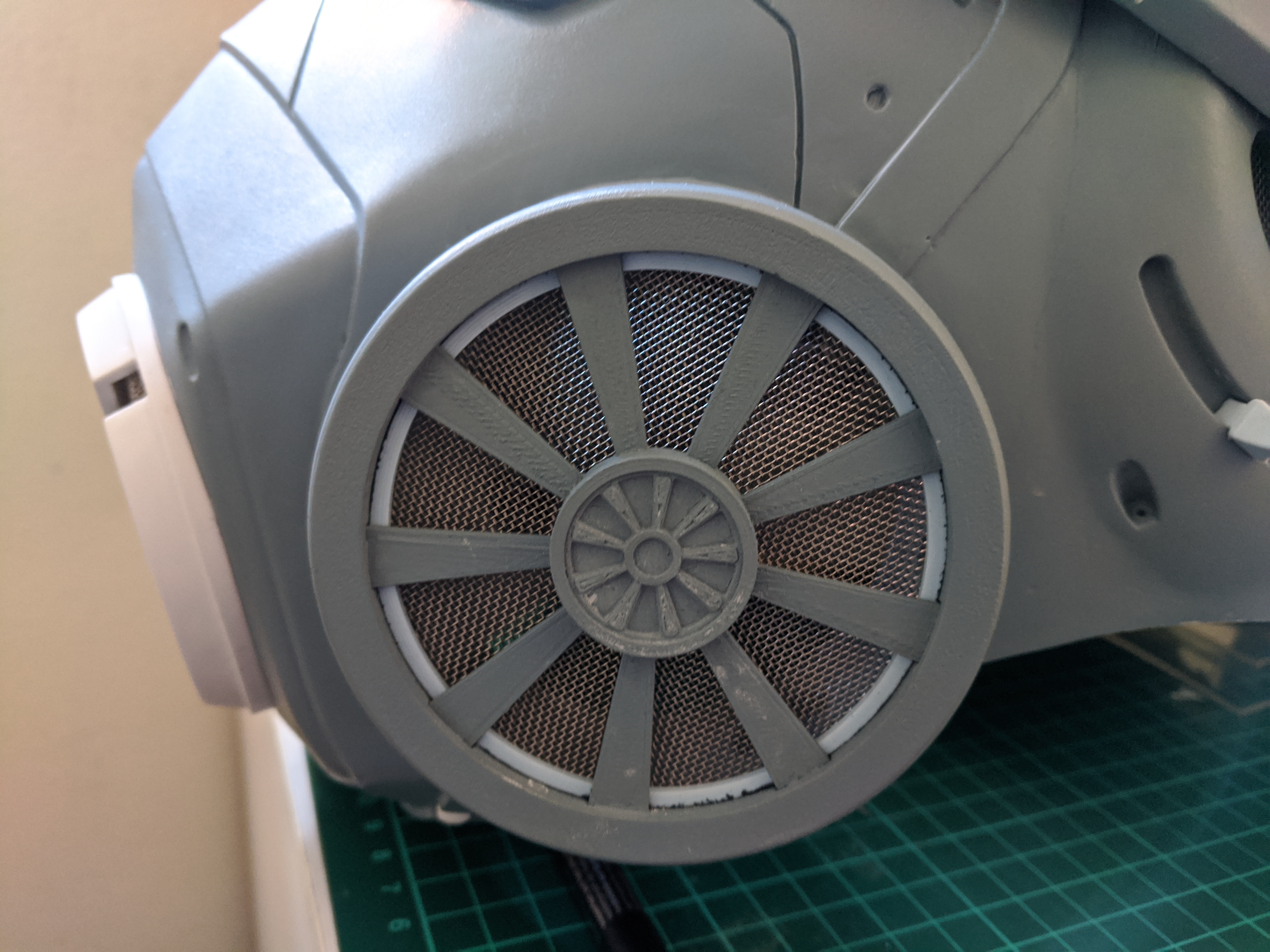

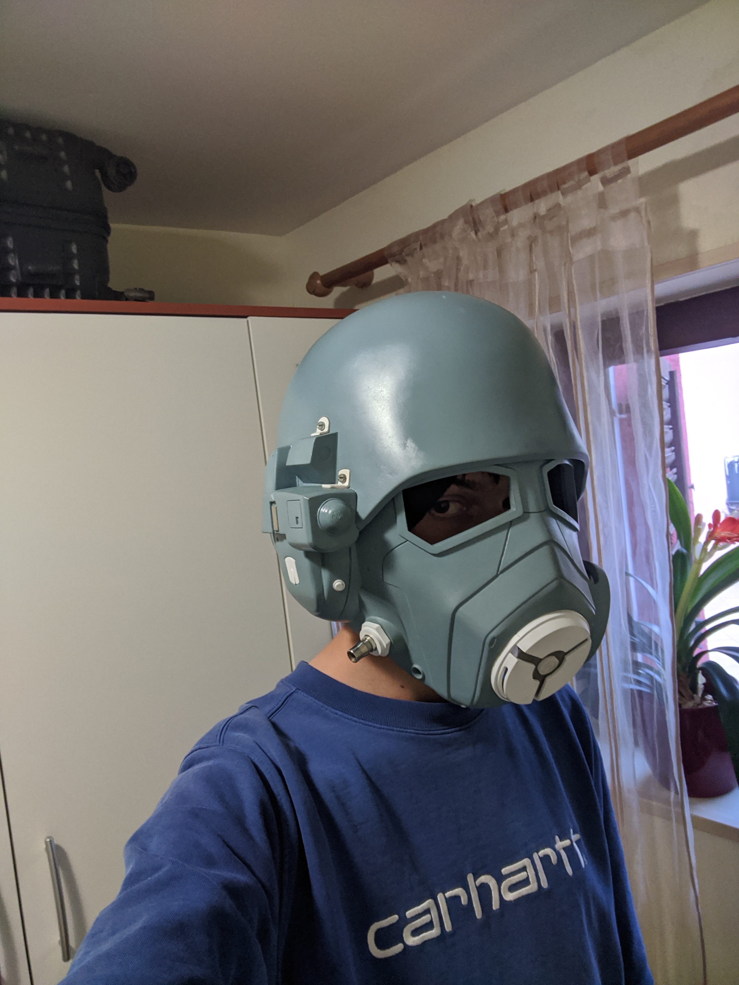

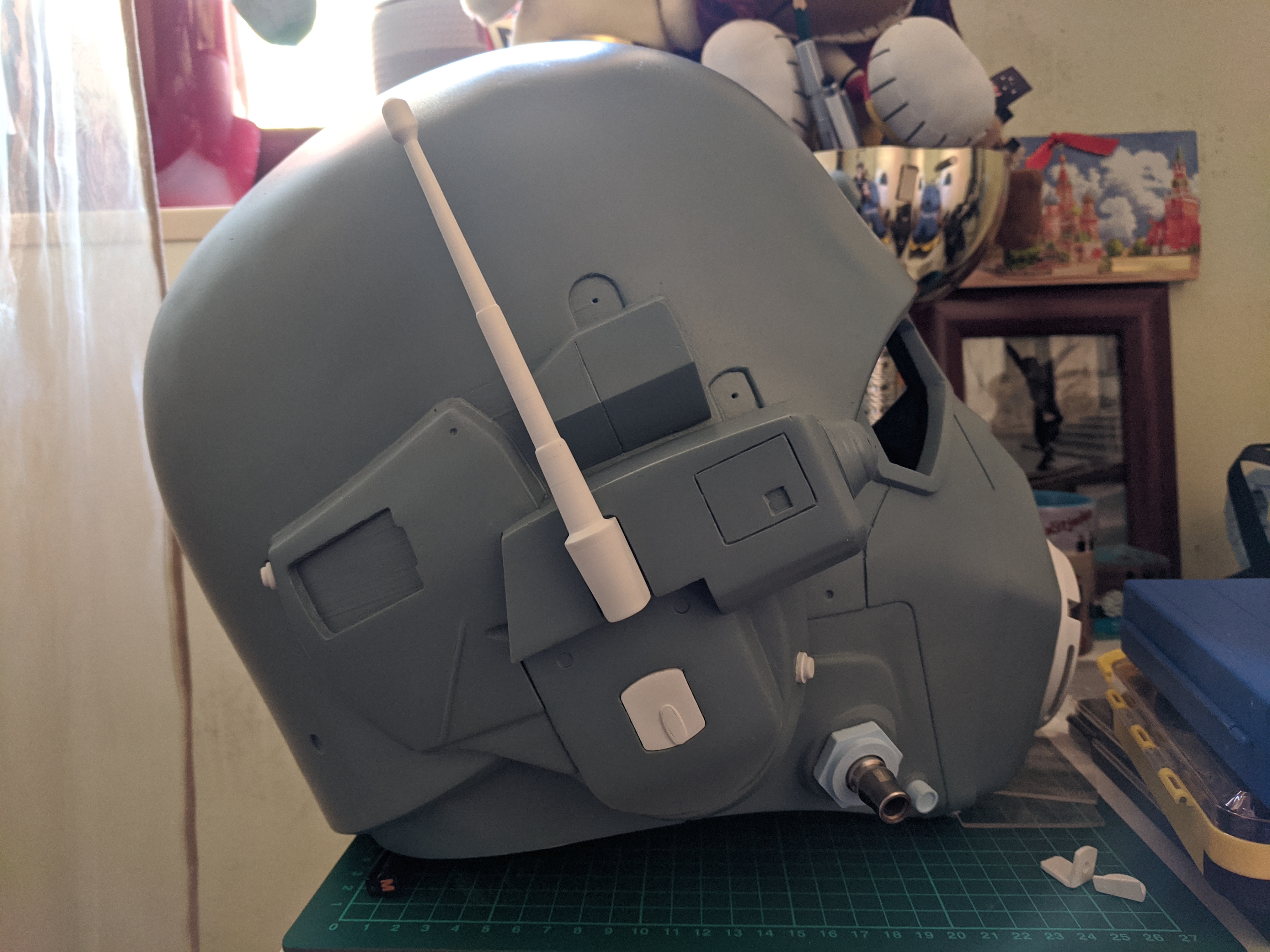

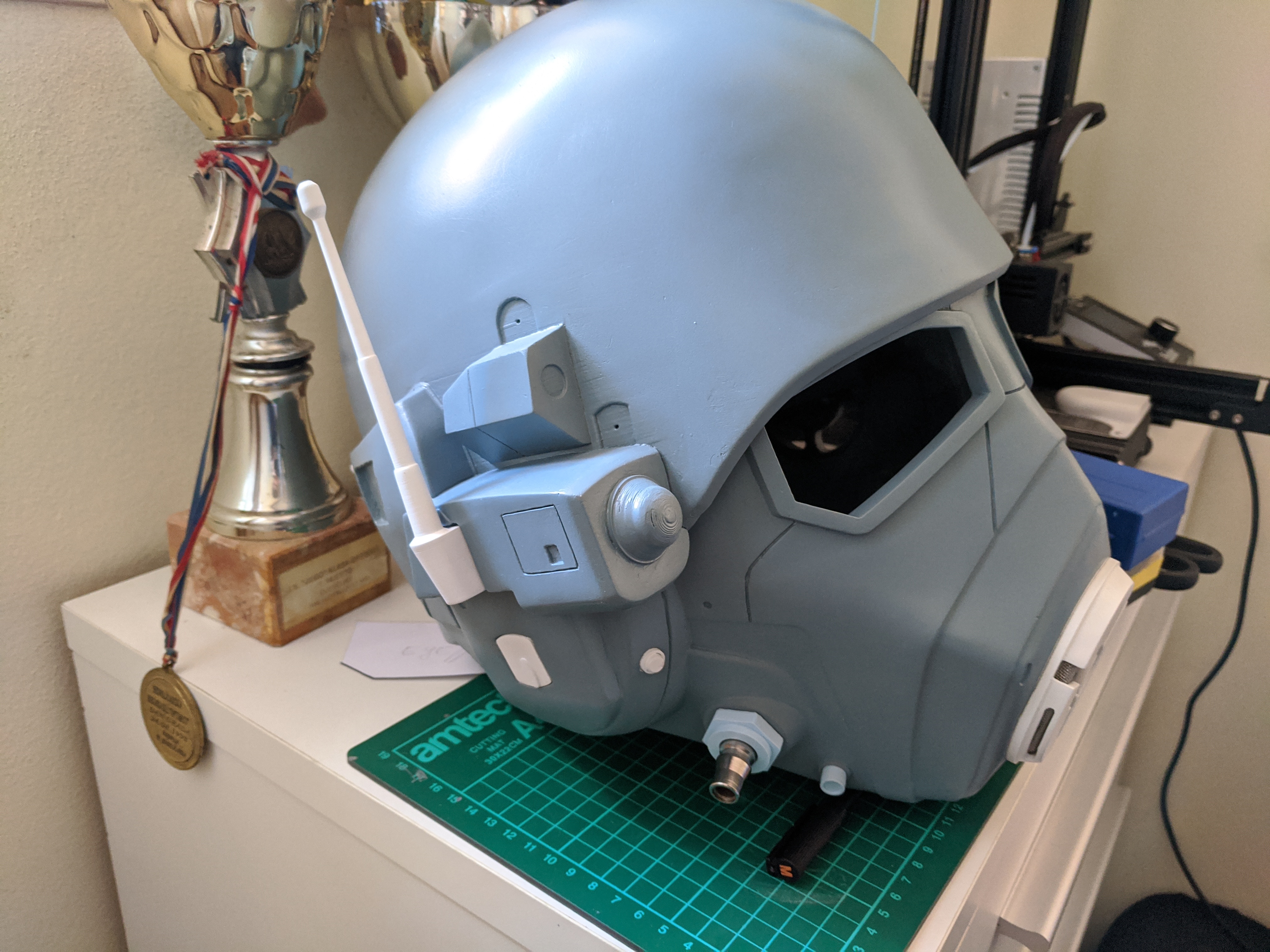

Alrogut, here are some fresh photos. I added some few pieces which gives it alot of detail. Front filter and the left one didn't look right with printed pieces, so i decoded to scrap that and just add steel mesh, looks much better imo.

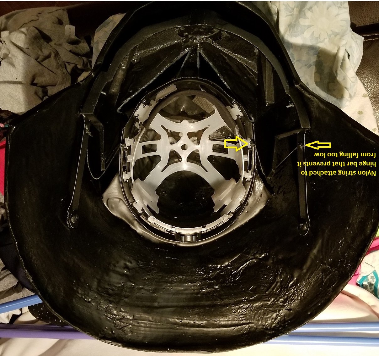

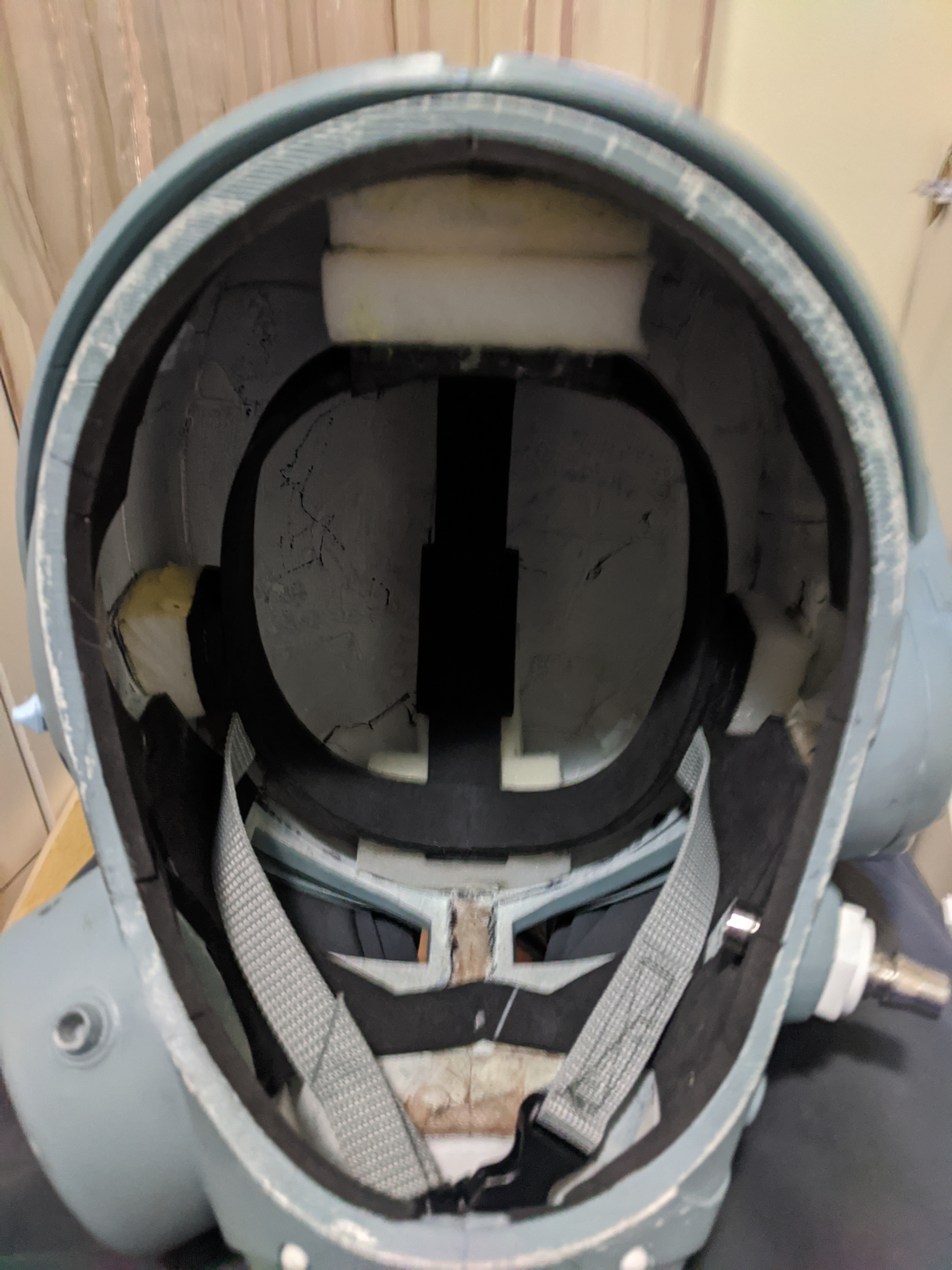

Alright, im kinda stuck on two things and need someones advice on it. First, any recommendation on covering the inside of the helmet with something, i've tried EVA but it's awful for it... Second one is strapping system for attaching it to my head, i'm bumping my head on a wall with this one and can't figure out how to do the strapping. Any advice is appreciated, thanks in advance.
What are you wanting the inside to do? Be durable, comfortable?

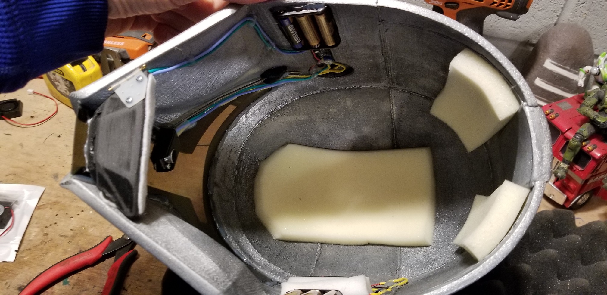

If there's only a little bit of room left inside it, you can line it with some sections of soft foam padding (I'm sorry, I can't remember the specific foam I'm thinking of, but a really light foam). If there's a lot left you could possibly create a frame out of EVA foam and then line it with the lighter foam.
Well i want it to cover all the fiber glass and bits of everything, there is alot of room inside of it also so it yeah it needs to fit my head without moving while wearing it.

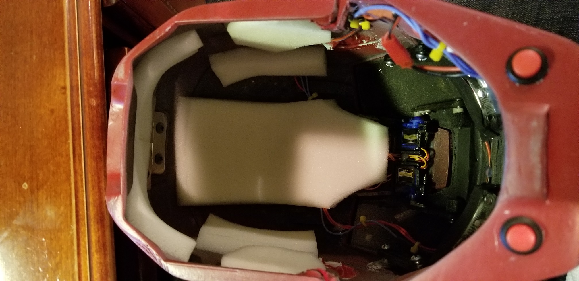

Easiest thing to use is foam like this (Amazon.com: Foam Padding 1/2 Inch (sold by Continuous yard ): Arts, Crafts & Sewing) I used this for both Iron Man and Mandalorian

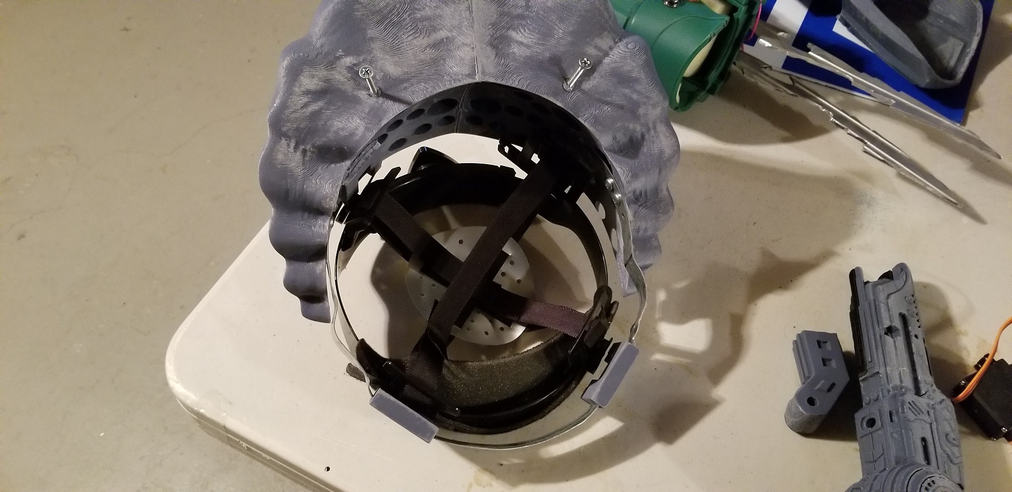

Another option I have used in the past with success is the inside strapping of a hard hat (https://www.amazon.com/MSA-Plastic-Nylon-Fas-Trac-Replacement/dp/B00OGR4OUK/ref=sr_1_1?keywords=MSA+Plastic/Nylon+Fas-Trac+III&qid=1584969656&sr=8-1).
I used this in my predator mask and Dark Helmet.
If you have fiberglass cloth/matted the inside. I would suggest doing a RONDO over it. (fiberglass mixed with bondo autobody filler. this creates a layer of strength and also covers all the nastiness of the cloth/matt. Then take a dremel and sand down the sharp pointy bits.
But what MoeSizzlac said is good for fitting as well. I used airsoft padding and upholstery foam for fitting.
So i kinda figured it out at came up with this, doesn't wiggle on the head and it's comfy to wear, since im not gona jump or do some extreme stuff with it i'd say its strong enough.

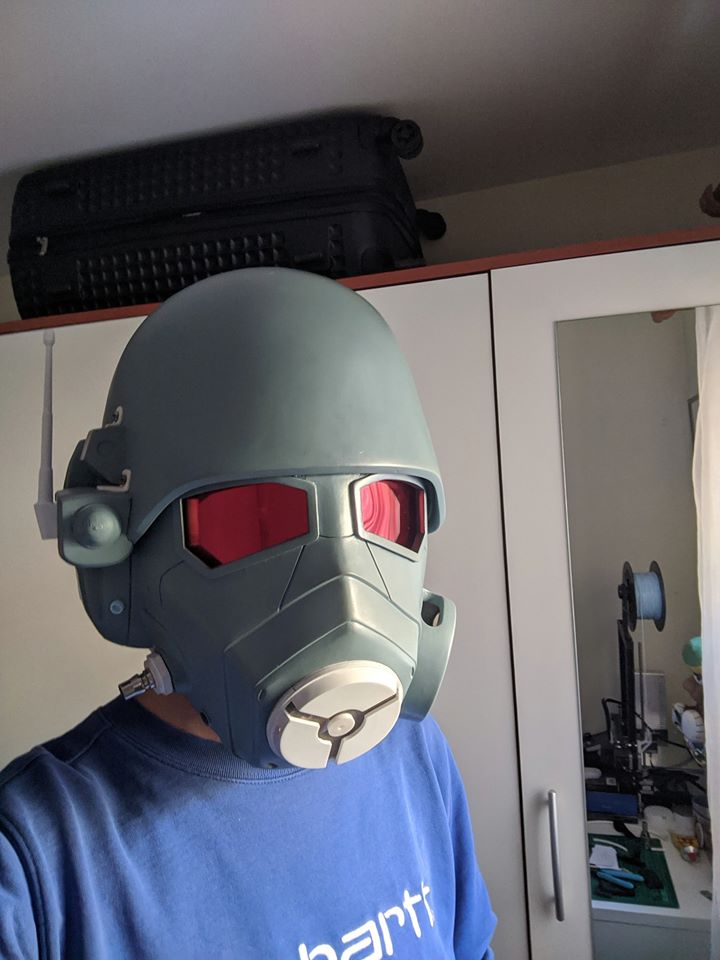

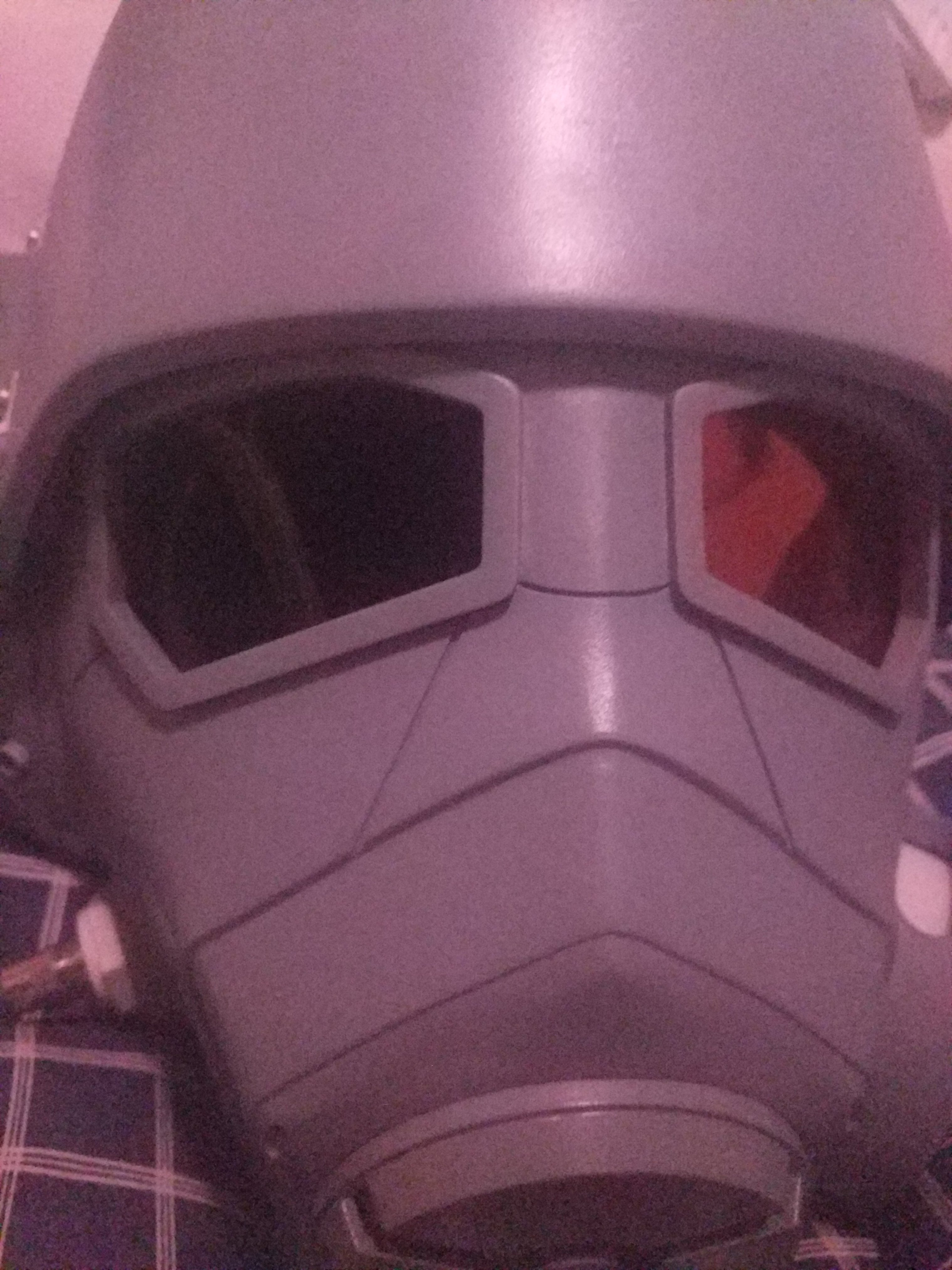

I tried taking a pictures as best as i could, basically looking from the inside you get this redish color, but it's perfectly clear
Edit: i can't find the link anymore, however if you just type one way mirror film you'll get a ton of results, but you might also try Amazon.
Actually it's just regular plexiglass bent with a heat gun and the red is a one way mirror film found on ebay

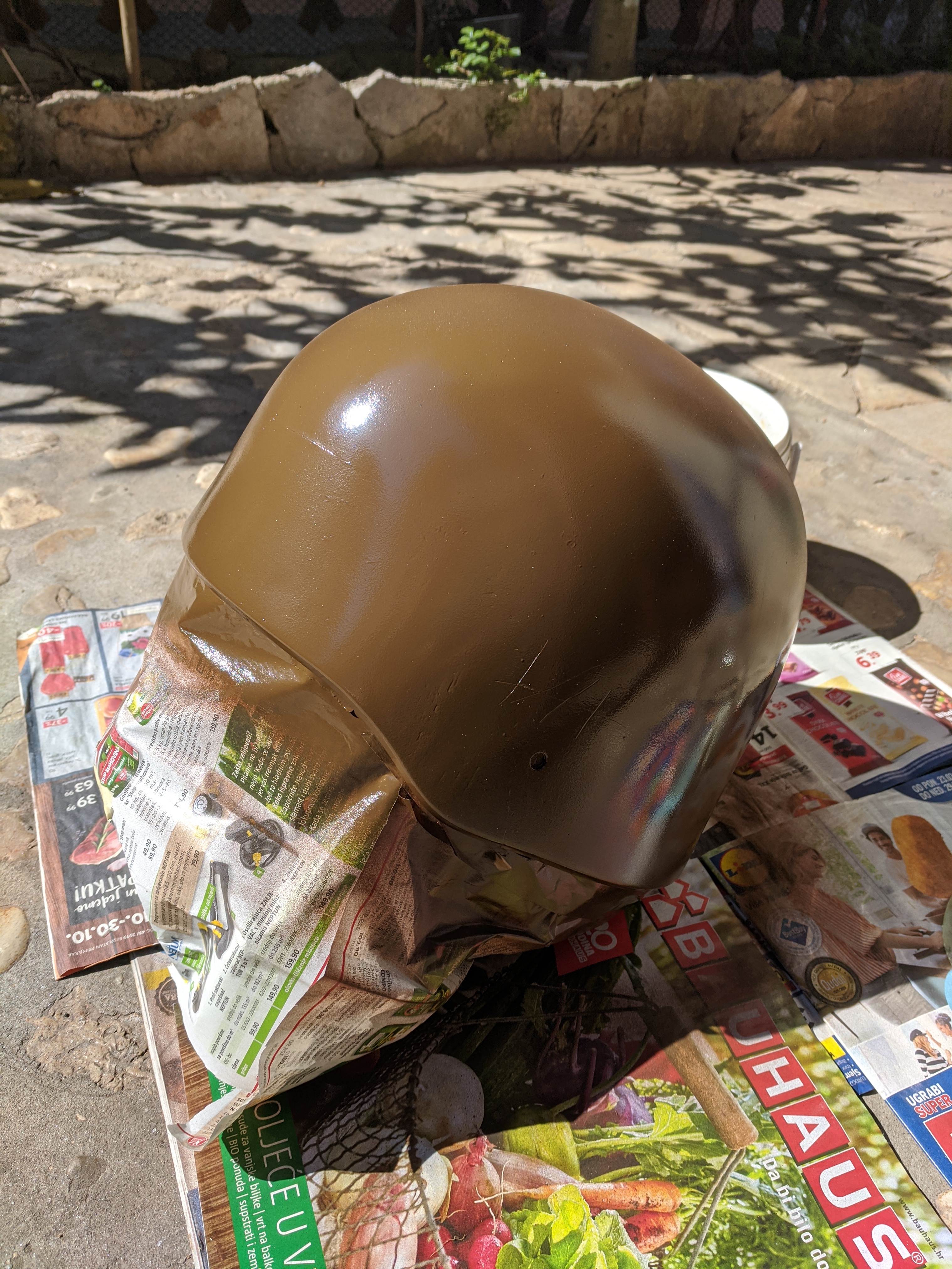

I started with some painting finally, I decide to go with a desert type brown color instead of a regular one i saw on most builds, so i guess this will look more like the desert ranger variant available in -game with NCR stencils on it. :)
