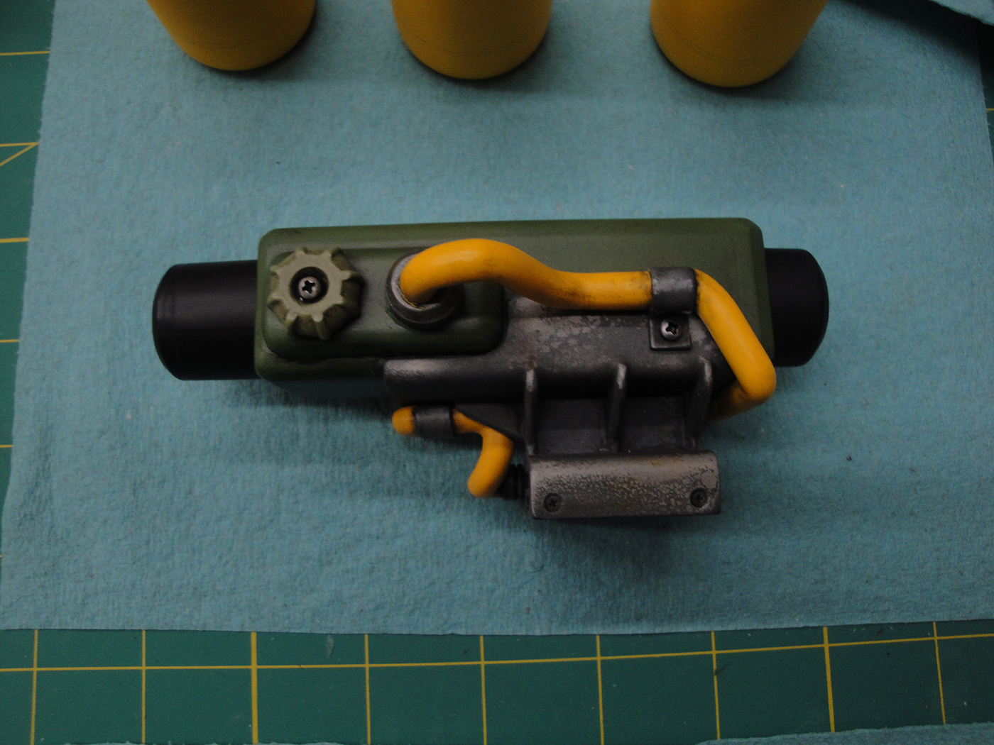

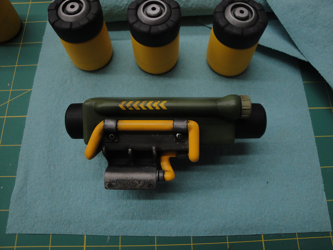

SCOPE L SIDE.jpgSCOPE PAINT R SIDE.jpgThe Scope fabrication completed still more work to do on the paint finish .
Nice!
BTW while playing the game it got me wondering is the yellow piping on these laser weapons supposed to be wiring or hard line?
I had Great success with my vinyl cutter in making the Positive and Negative stencils. Using Hair Spray and a fine
brush I was able to put the chips and scratches on before I Air Brushed the Stencils .

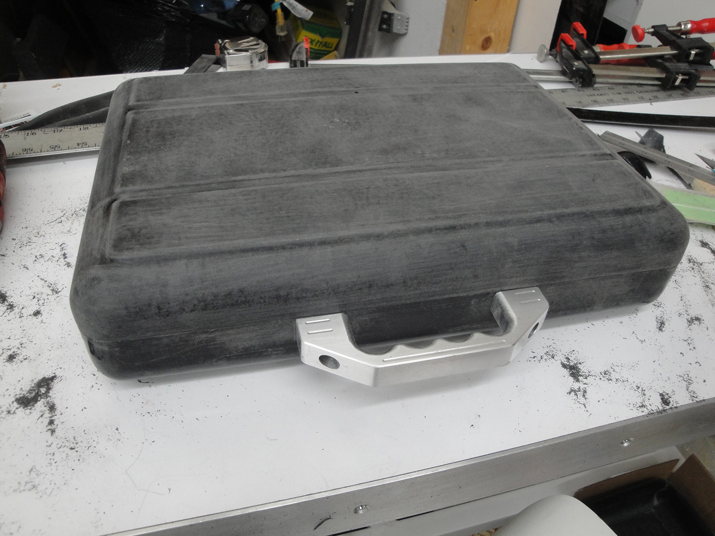

MDF to make the Vacuum Bucks for the case.
Routered Bucks.

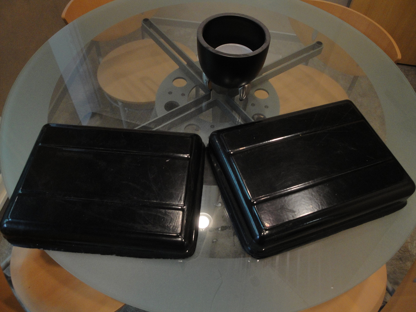

ABS Vacuumed case skins .

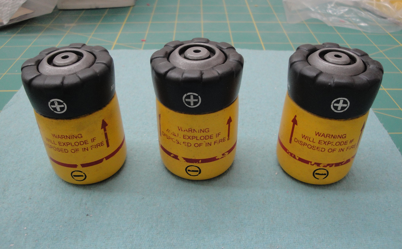

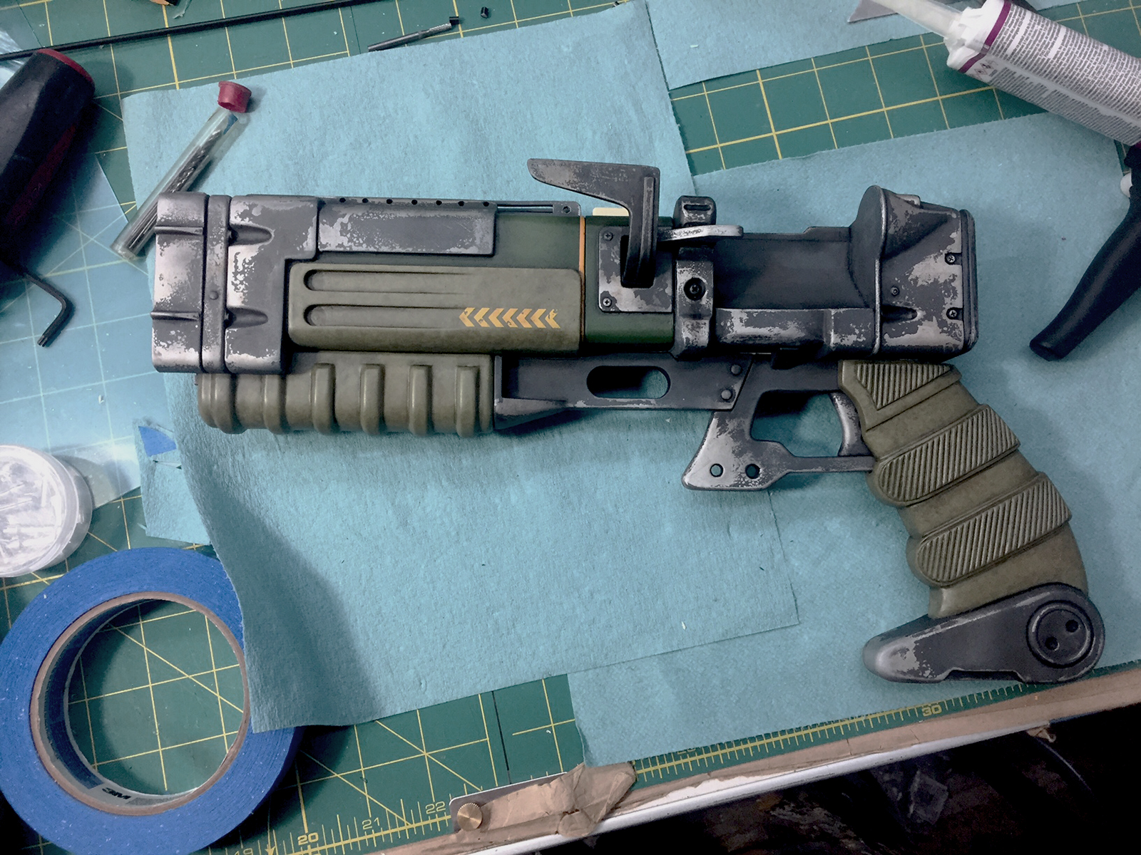

What type of dry transfers did you use, specific font? That looks good! My next project is a laser rifle so that could help!
It was a Kit called " Decal FX PRO " $85 Amazon . You need a Laser Printer and a Laminator . Its tedious work but the results are Fantastic .
Aw crap, no laser printer. The font will help though. I have a decal kit for inkjet printers that I never used. They are water transfer though. The lettering on the laser rifle is probably the only thing concerning me that I haven't figured out how to do yet
Sorry for the Delay , At Comicon the last 4 days
I used MYRIAD PRO for the warning sign and focus decal. MICROSOFT SANS SERIF for the Fusion Cel cap lettering . You may have to ply with the thickness and Kerning a bit.
