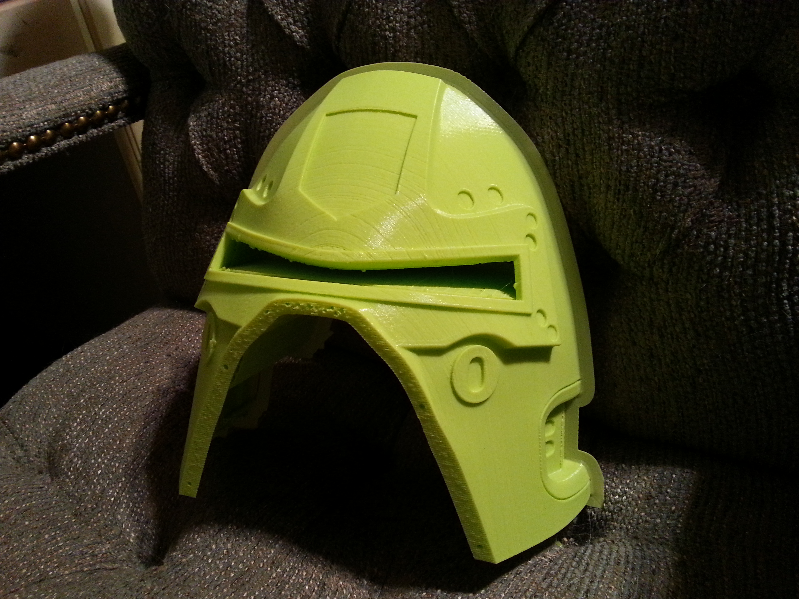

Sorry for the lack of updates. Been taking a bit of a break, but it's time to get back to business. Here's the start of the new T-51b helmet print. The original helmet was cut into five sections, basically because of software limitations. This go around we'll be doing it in three sections, exactly like I printed the T-45d helmet. Less seams to fix should help speed up the mastering process, if only a little. Anyhow, more to come soon.

For the helmet shells, I'm printing on my Lulzbot Taz 3. It has about a 12"x12" build platform, which allows me to print very big sections of the helmet at a time. The recent print shown took a whopping 84 hours to print, and during the entire print stayed completely adhered to the print bed.
The other parts that were already printed and molded (that are not in the recent print picture) were printed on a Replicator 2. Those parts have been mastered and ready for some time, so they'll be waiting for when the helmet shell casts are being pulled.
From this point on, however, all the little parts for all the rest of the helmets will be printed on my newest printer, a Form 2 SLA printer. This will ensure that the sharpest details are captured, which will be very handy when we get around to the T-60 helmet.

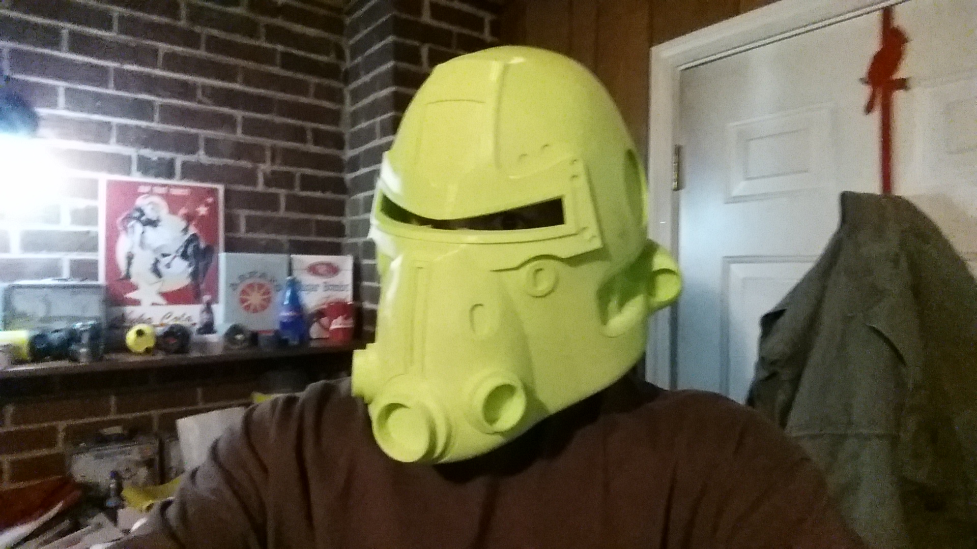

Alrighty, time to get this project back to moving forward! Yesterday I finished re printing the FO3 T-51b helmet shell. Today I began welding the sections together. I printed the helmet shell in just three rather large pieces, as opposed to the five pieces I had cut the original helmet in. I also made a couple modifications to the model itself, widening both the hole you stick your head through as well as widening the hose outlets. Now my head actually fits in!!!
More to come on this bad boy very soon. Stay tuned.

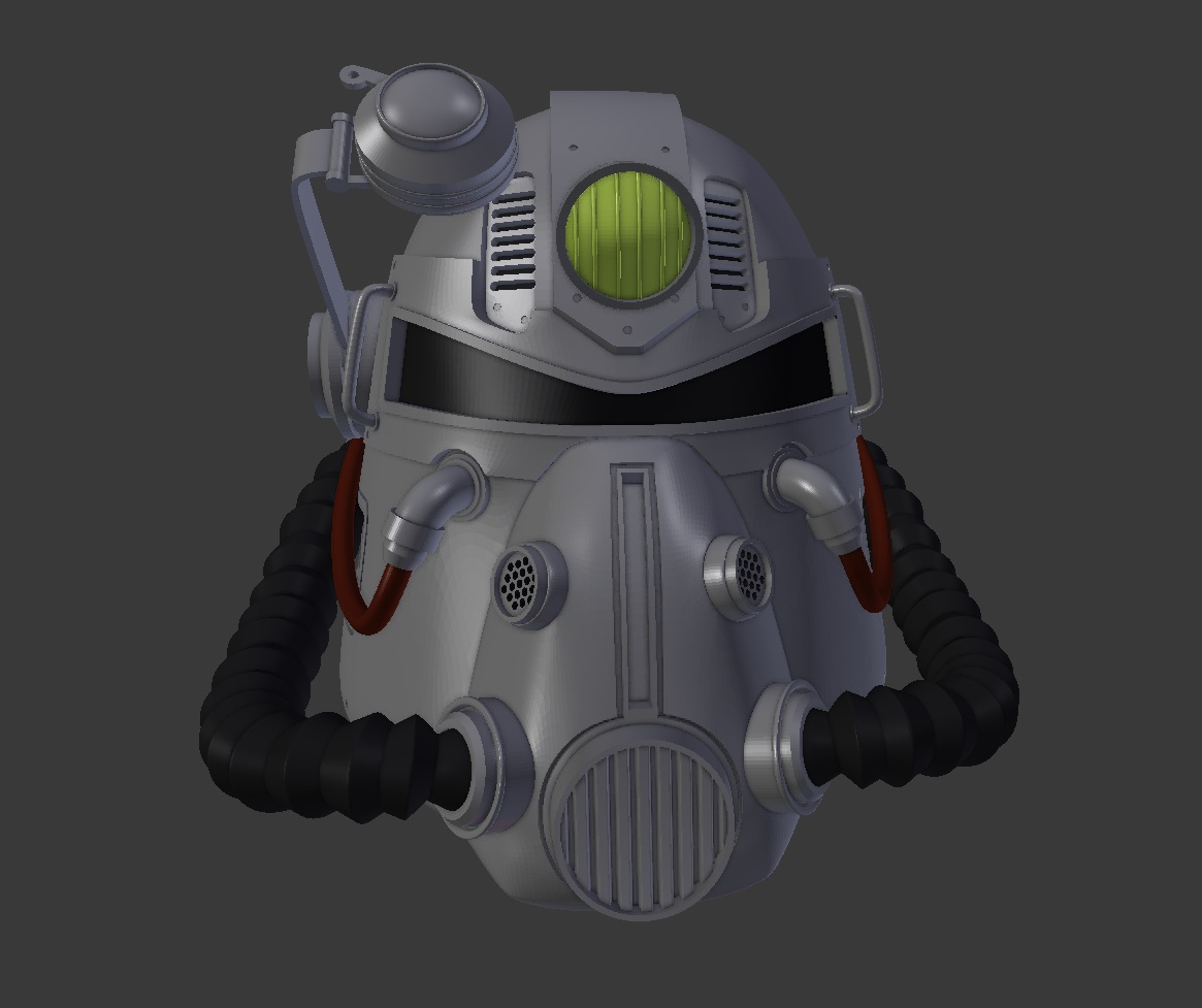

Aside from that, I just the other day finished modeling the new FO4 T-51 helmet. This beauty is all ready for printing! This helmet will be set up just like the other T-51b helmet, as the headlamp will be able to be made functional and the optics bracket will be able to rotate up and down.
I plan to begin printing this immediately, and will be attempting to print the main helmet shell in just two halves. More to come soon on this as well.
