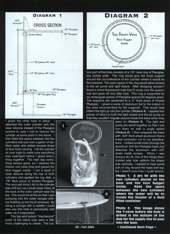

I was sent another article I'll have to post it. It had the brilliant idea of adding a smaller tube inside the first. In between the two the liquid was added. It had the benefit of using less water and also that the facehugger , although looking submerged was in fact bone dry thus saving the paint work and eliminating the mouldy yuck factor!!!

As for the tube within a tube, I suppose you can do that, but I don't think it will have the same effect. With the tube filled with water, it distorts the view of whats inside.
