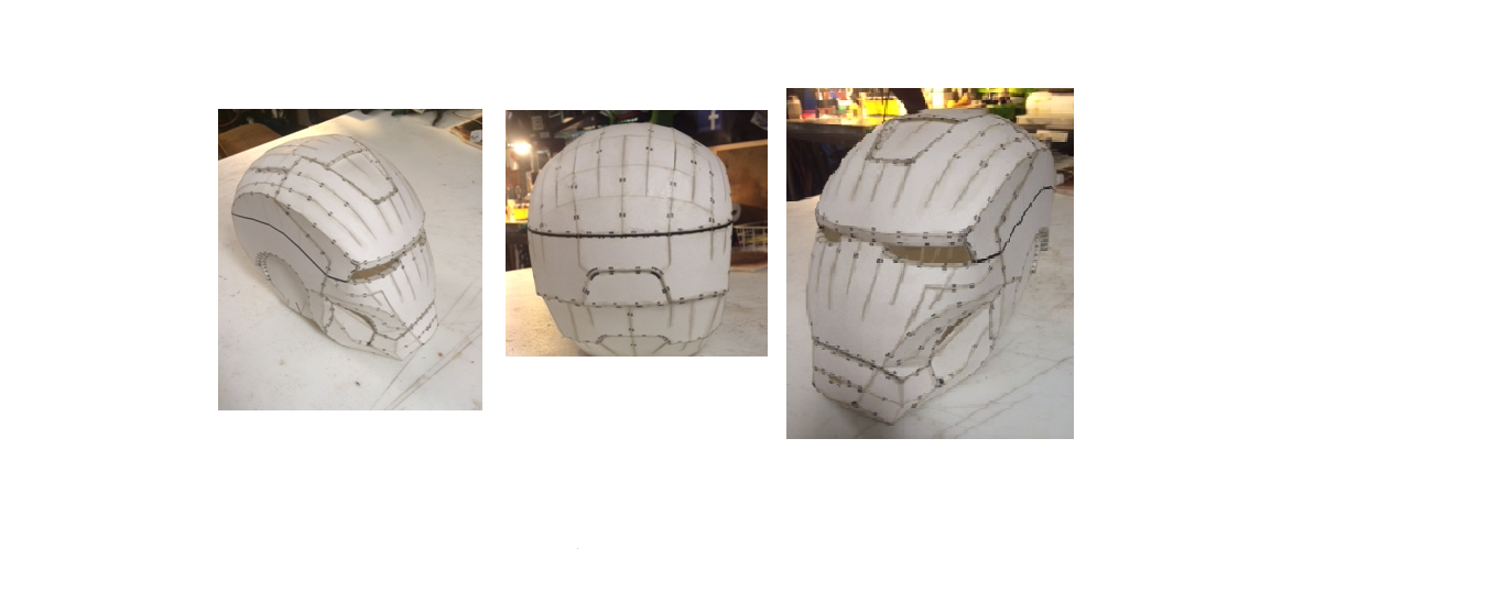

sorry for the delay!! its been hectic around here lately with my business and was out of town until last night. but i have posted my pep helmet to show that i have been making progress on my build. as i stated in an earlier quote, i will be building my steel helmet around my pep model to keep the right shape as i am building it. this was my first ever attempt and pepakura, so naturally i took it upon myself to do it in a way that i thought was best. instead of cardstock which i hear is the popular material to use, i used watercolor paper which i believe is considerably thicker than cardstock.
i cut all my pieces out with scissors and an exacto knife and scribed all the fold lines with the tip of the xacto blade. i then used turbo tacky glue to glue all parts together, which dries farely quickly but allows enough time to position the parts.
once i had the helmet all together (with the eye pieces and support pieces) i then applied super glue to all the seems and edges of the helmet which allowed me to make any fine adjustments needed to keep the shape as perfect as possible. with the heavyier paper i used and applying the super glue, the glue will seep into the paper, making it extremely rigid but still porus for the application of resin.
as i said before, i did this pep build using my own ways of doing so. i am in no way an experienced pep builder but i do feel that my way of doing this made it go extremely fast and was very easy to do. the key to it is the heavier paper (i had to give each piece a littke push into my printer as they printed because of the thickness) and the use of super glue. i have not yet resined it, but i am confident that i will have no problem with warping; even after the removal of the cheek,eyes,and supplied support pieces that i used for the anitial assembly.
if anyone has any question about my methed, feel free to ask for any details that i might have left out. more pictures are to come, just bare with me. thank you

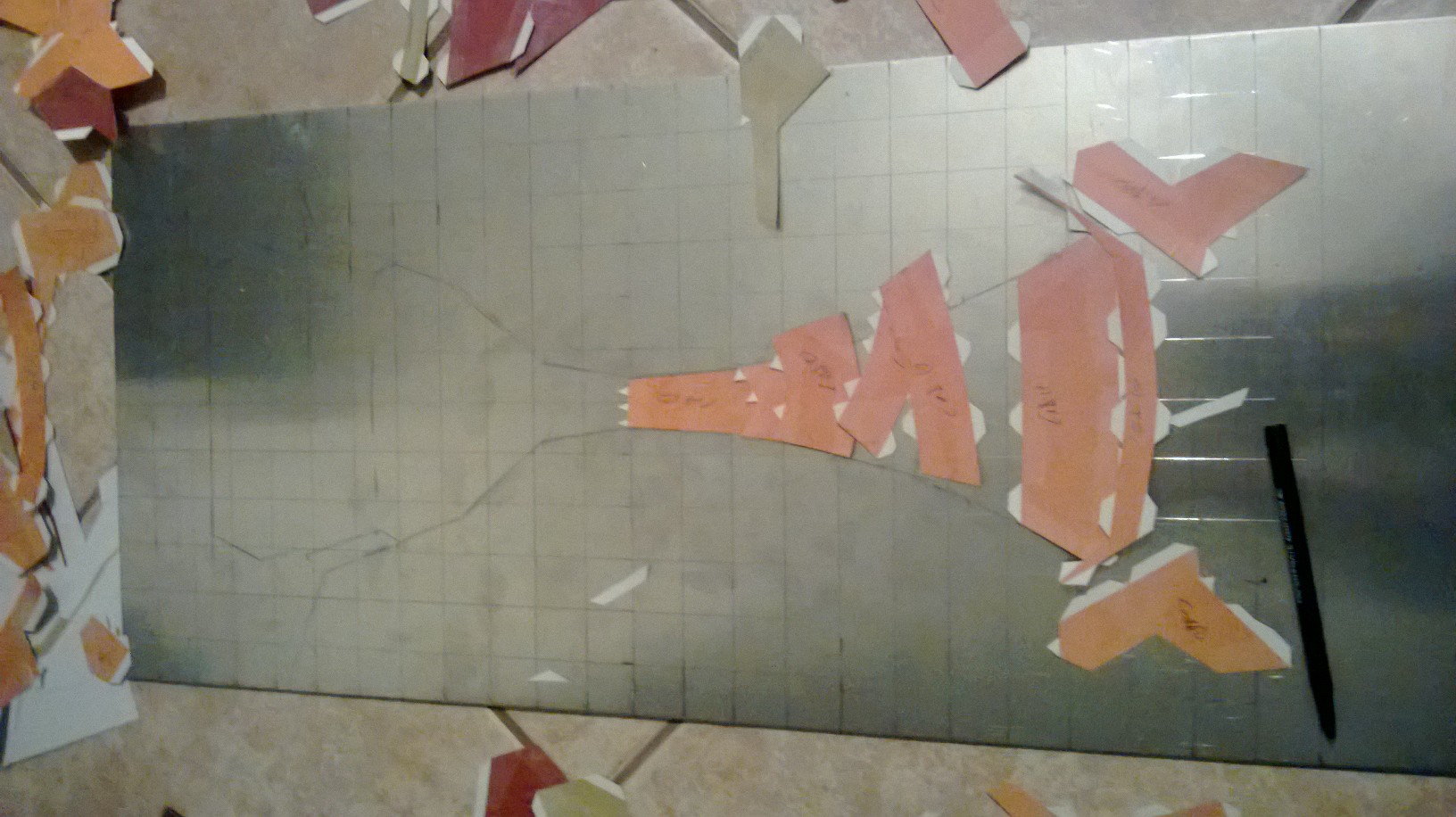

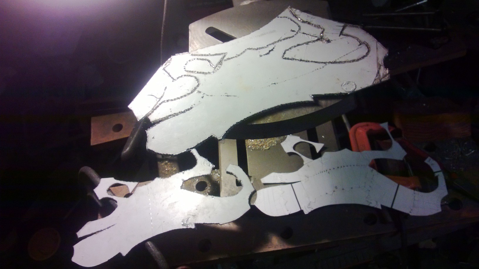

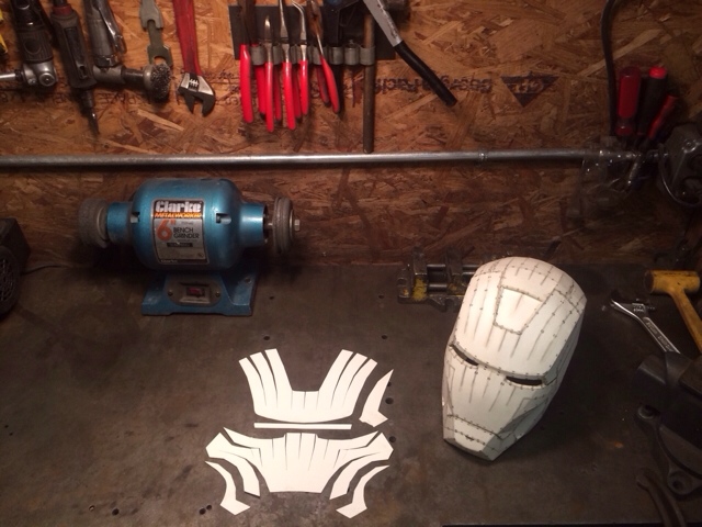

Ok folks, finally I'll be working on some stuff tonight in my shop. I picked up some sheet metal today and will be making some parts with some templates I have cut out. As for now, I am going to make the face portion of the helmet to see how the pepakura templates work as far as using steel instead of paperI'll be taking numerous pictures of the process and should have some decent progress to show by tomorrow. Stay tuned.
Ok, this is what people want to see... Well, a step in the right direction anyway. I am waiting with interested to see the metal pieces come together.
People here love to see progress shots, and descriptions/tips on what you are doing at each stage. Especially as working with metal is less common here.
Good luck with the build.

Yessir! I am looking forward to showing everyone my progress as I get more in depth with the build. I know I am being doubted by a good amount of people; which they have every right to. I'm going as fast as I possibly can lol. But thank you for the support and keeping an eye on my project. I just figured out this tap talk app for my phone, so posting pics will be a lot easier now. Anyway, Thanks again and feel free to let me know what you think of my progress!
