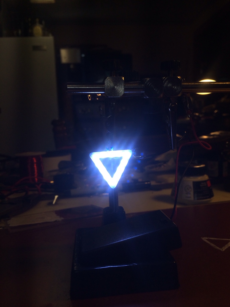

Got my creatING juices flowing tonight..... Maybe a vibranium core for an arc reactor is possible ;)
If this idea I've got works, you all might want to stay tuned for this next feat that I just might have figured out!
FINALLY...
Ladies and gentlemen,

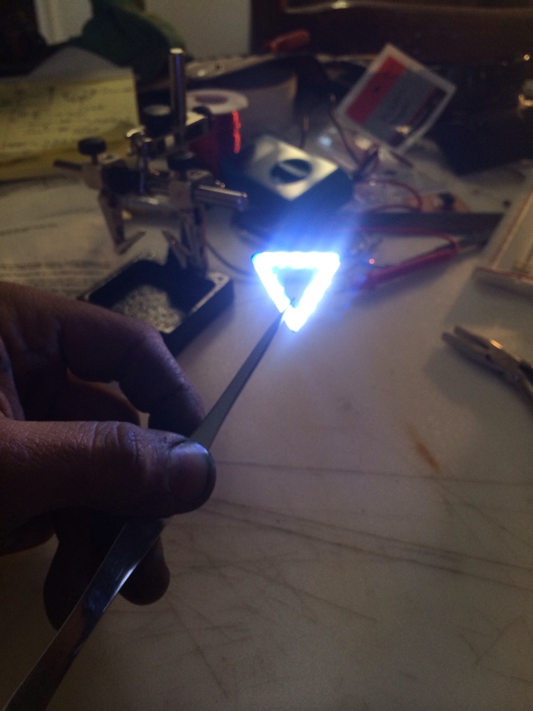

I give you my vibranium arc reactor core.
As you can see, there are no power wires running to it.
....now only if I could power something with it.. Lol
ImageUploadedByTapatalk1392752427.860748.jpgImageUploadedByTapatalk1392752437.785595.jpg
Impressive! Not sure i have the skill set to achieve this but , Will you share how you did it?
Sent from my DROID RAZR HD using Tapatalk
For once I am rather stumped. In the left photo, I can see wires connecting to it. But in the other one, there isn't any, so my only conclusion is that the tweezers are acting as conductor for the power, and that you might of have separated them and put an insulator between it. Can't really see the end of the tweezers, so I don't have sufficient data to make any more guesses and the photos are kinda poorly lit (Probably wanted to show off the brightness of the piece).
judging by the lens flares and single direction of the light, its probably a bunch of tiny coin batteries hidden behind the triangle and you have about 5 SMD 5050 LEDs on each side on the triangle? :)

Looks like wireless power to me. Sometimes called Induction. I'm guessing that's what that black box is in the first picture, the induction coil.
...am I close?
