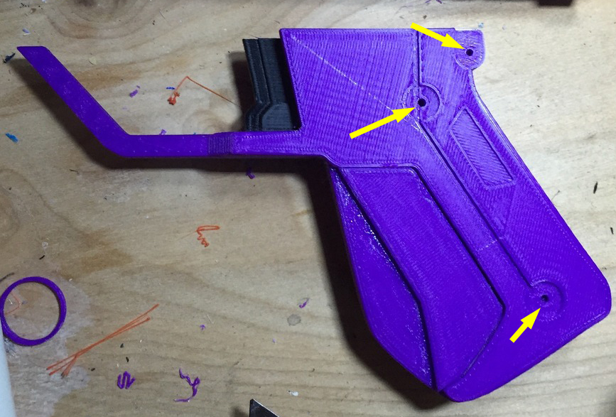

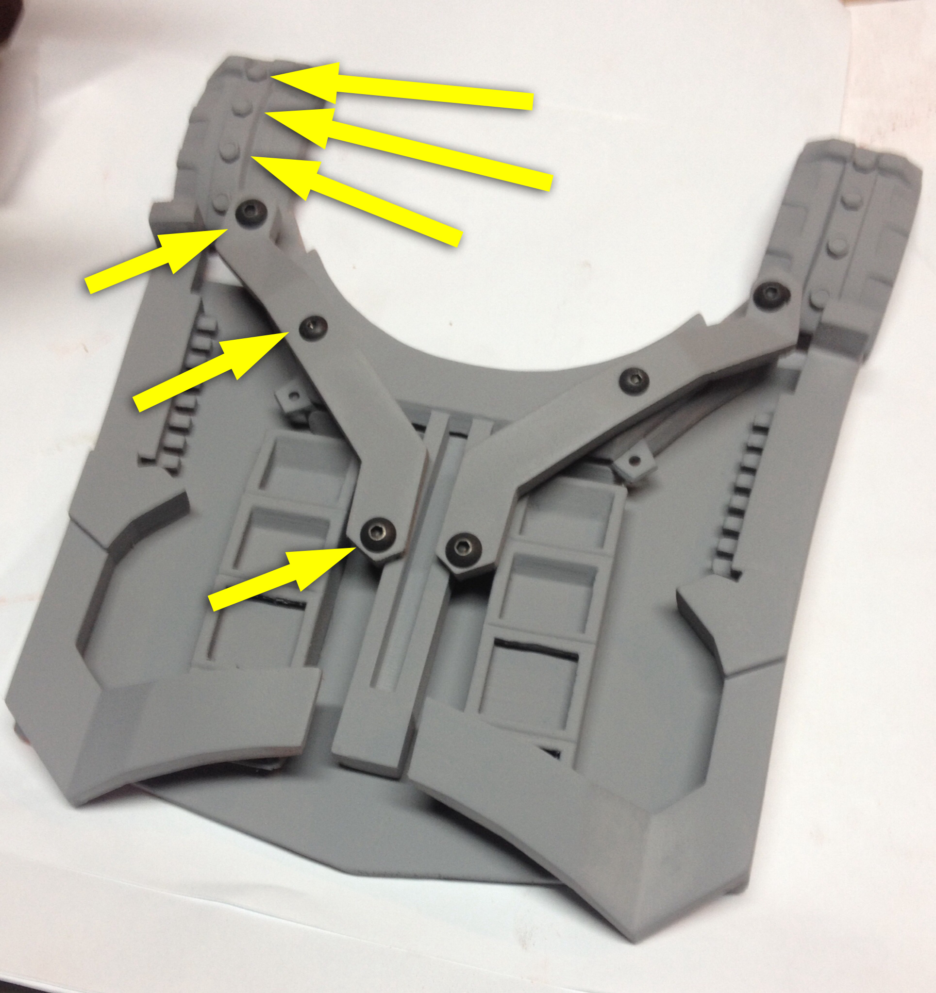

Some one asked about the holes all over the model instead of just simply printing the hardware.
These areas will get actual hardware inserted into them.
Below is an example of my mk3 chest detail with the hardware added. It makes finishing a lot easier and looks really clean.

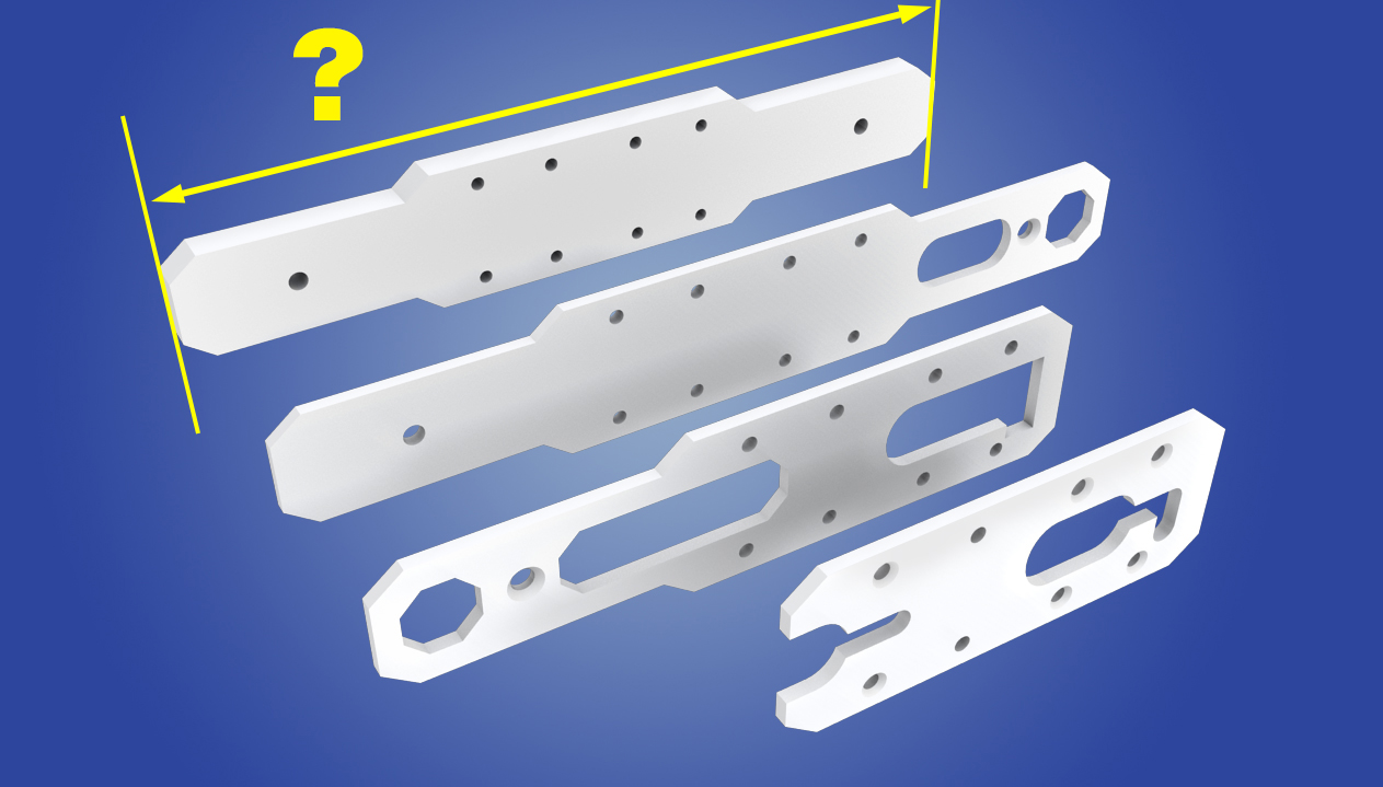

I have a question for any of the guys who have seen, or have the new TFA armor... can I get a measurement for the holster bracket?
This would be a huge help!
Thanks!!
