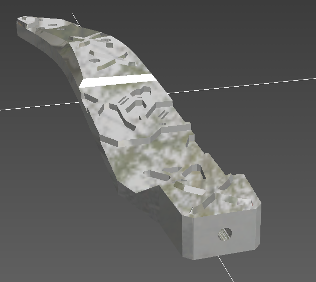

Looks like most of the parts are a 5-axis job, first few shops said they can't do it and referred to others (also I assume the quote would have been a few grand per part). Had a lot of trouble finishing the upper-arm piece in AC due to bends, plus I got other parts on horizon where I require the "Engrave" feature of Inventor, so I'm finally switching to Inventor. This project is not really doable on AutoCAD. Because of the switch I need to convert the piece back to 2-D (some changes I made to 3D version I didn't back-propagate), and ended up re-designing for closer screen appearance. That will take another iteration or two before it goes to 3D again, but whatever.

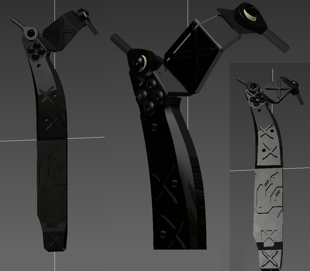

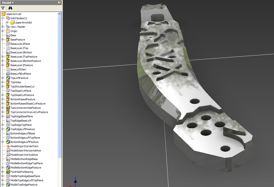

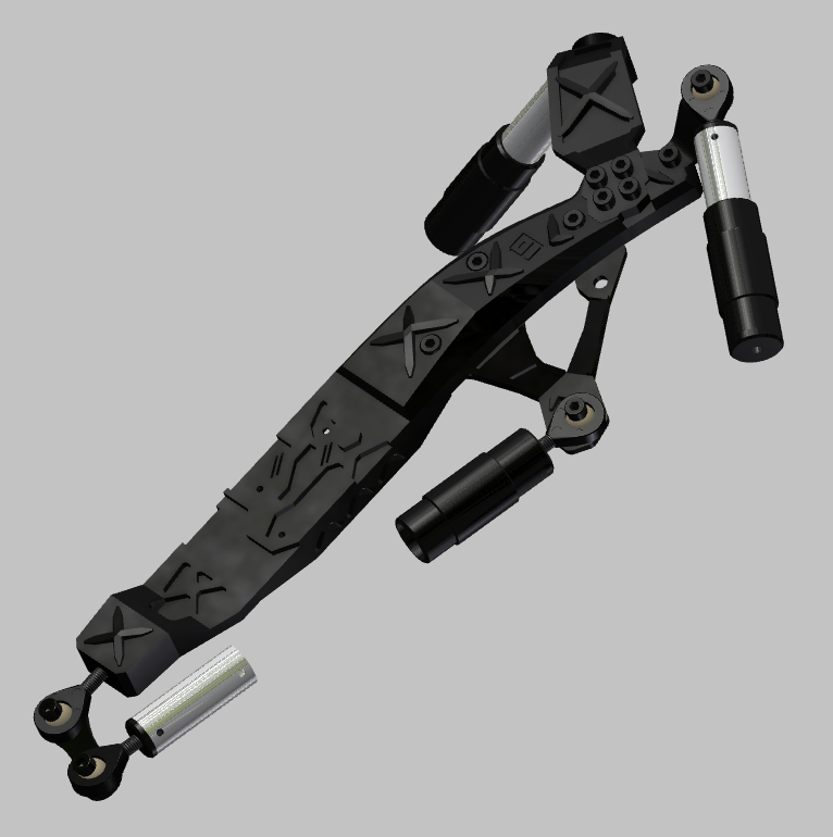

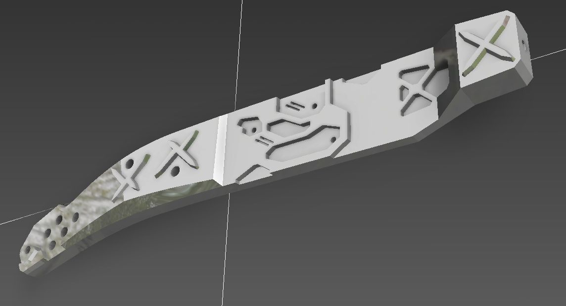

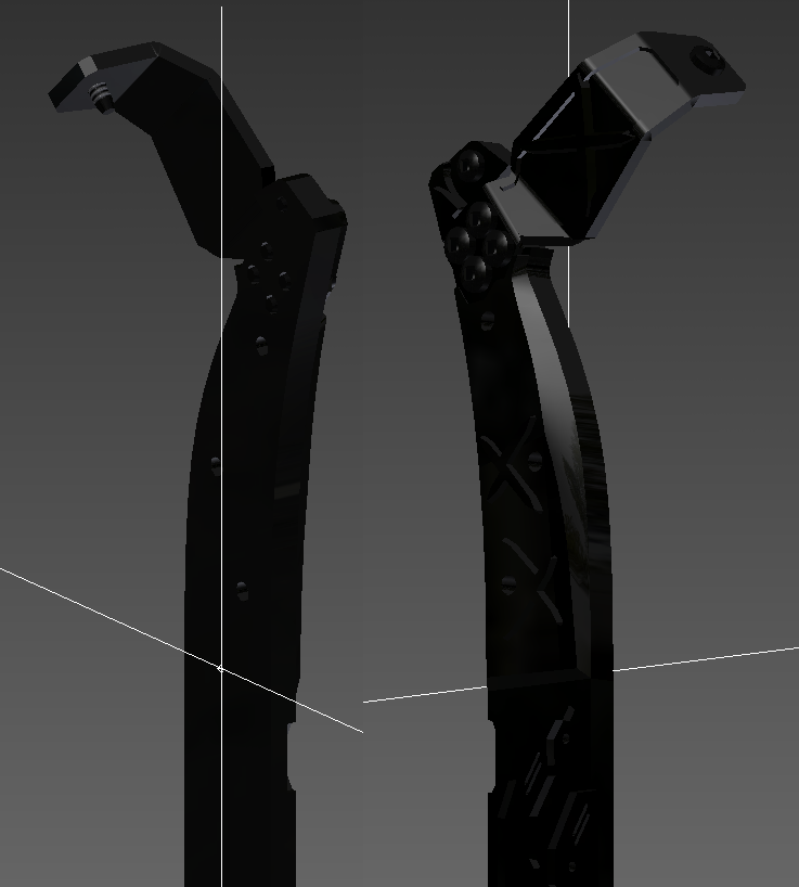

First iteration of the same part after switching to Inventor. I messed up in some places so it will have to be redone, but probably only once (since Inventor actually has a 3D operation history much like 3ds max's Modifier stack). This is pretty tight, it actually gives you the weight (just over 1lb for Aluminum for this one), center of mass, and even the Moments of Intertia matrix, which you could use to calculate angular velocity generated by a force applied off-center on the object. That's pretty much all you need for a sophisticated physics simulation.

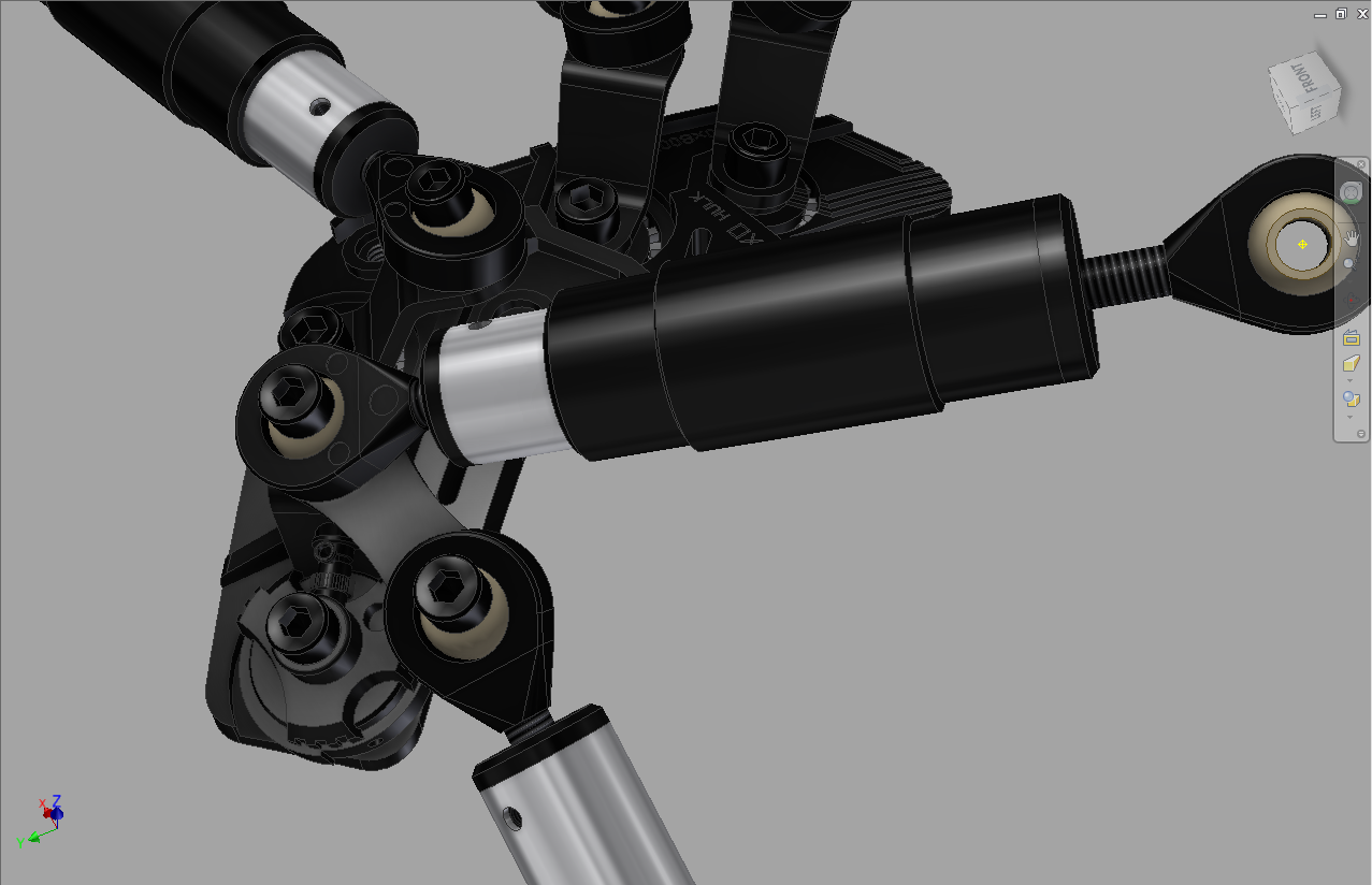

The M5 bolts through the upperarm to the front 'L' shaped piece should be cap heads. Also that part off the back where you have a KARM fastener should be a metal connector.
Oh, ok, people here call those "Socket heads". The "head" seemed a little too tall so I tried round heads instead. I will check to see if it looks better with sockets. On the top hole, you are right, there is a connector piece. I've been looking at this part for so long I started forgetting how it fits into the big picture.

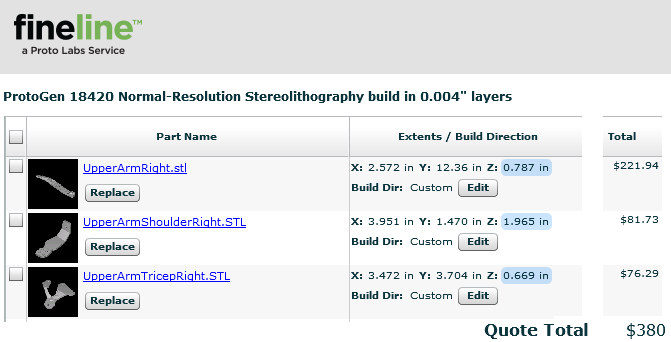

For comparison, additive is around 50% of the price.
After contemplating this issue, I decided to research additive methods a bit more, and get some samples. I have 7-8 other projects like this one planned, I decided that spending two years on each one is a bit unreasonable as a significant portion of my life will pass :)

I officially decided to go additive, trying to decide between RapidMade and Fineline at the moment. RapidMade is more price competitive and they have a material that's easy to paint, plus they are on my way to work whereas Fineline is in another state.

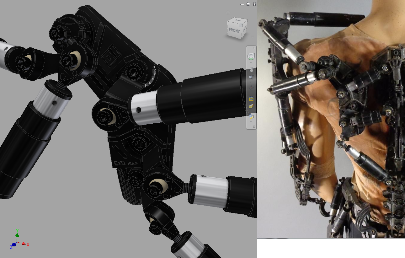

Shoulder assembly completed with the modeling of a shoulder motor/connector that looks like a little cyberpunk crack pipe.

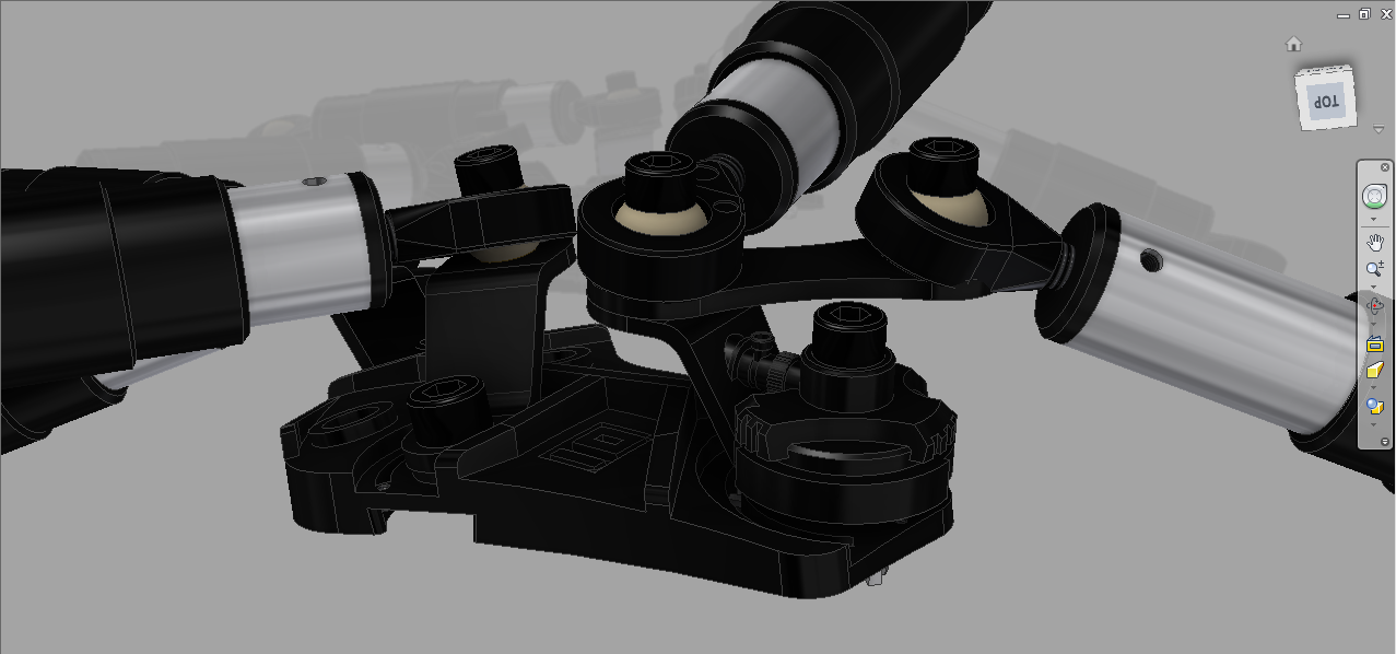

Some progress on leg assembly (added connector from knee to yet-to-be-modeled shin guard/shock plate):

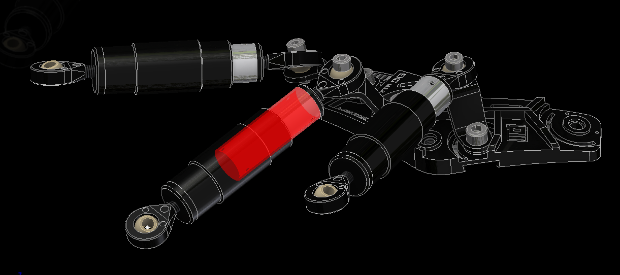

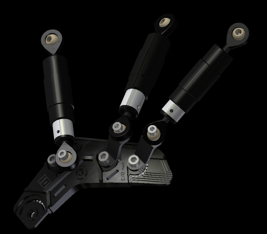

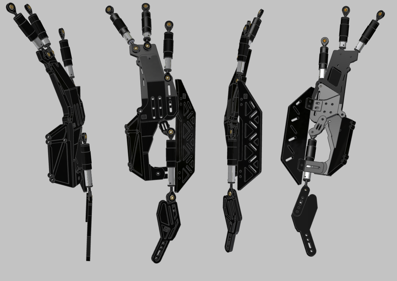

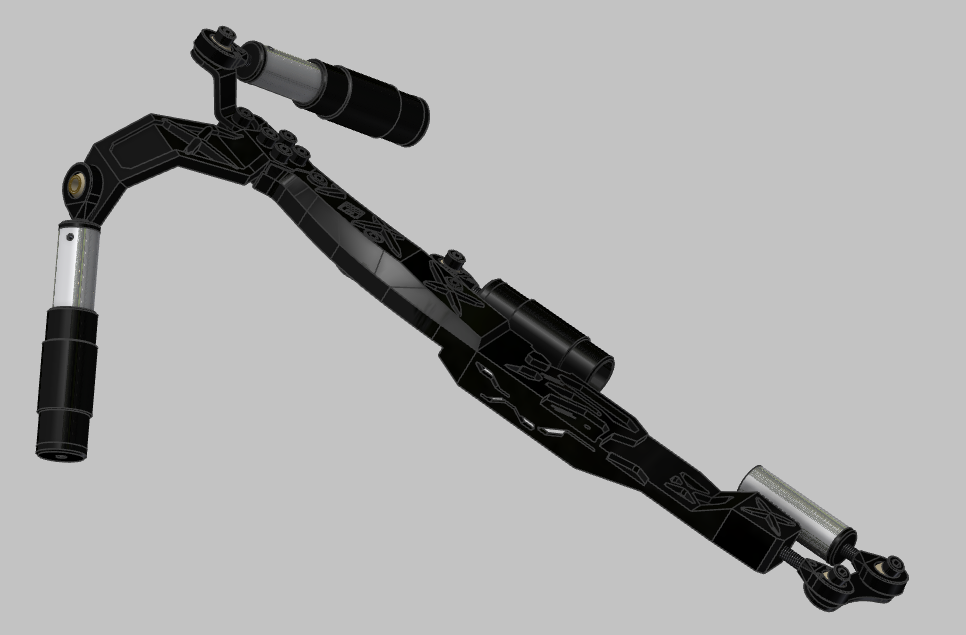

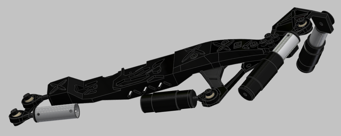

Arm assembly with two new connectors reused from shoulder/back and mock pistons of wrong size added (so far all pistons are one size, just to preview):
I decided I'm going to light the whole thing up to give it cyberpunk feel, so those circuit-looking holes on the front of the upper arm are there to look like glowing circuits. Same with shoulder blades posted previously, some geometry which was sunk in the movie instead of being cut all the way through, I cut through to create lighted interest.

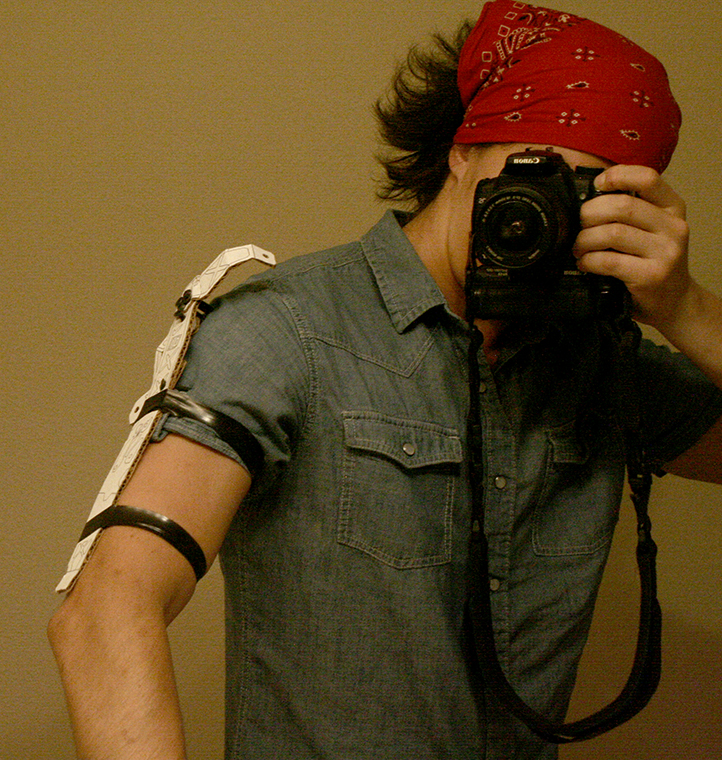

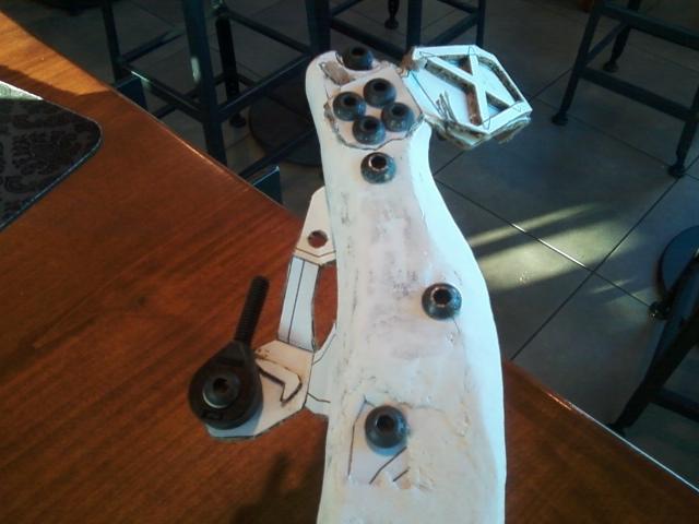

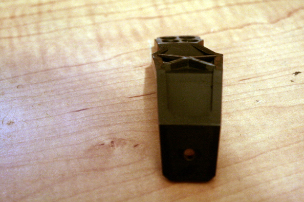

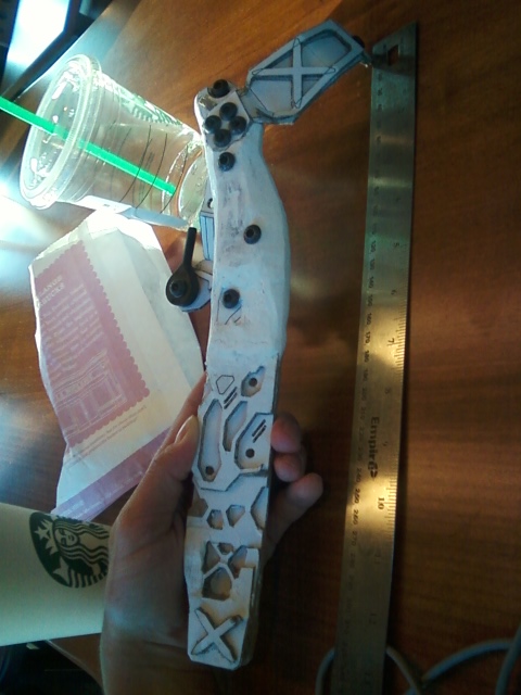

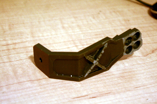

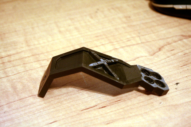

Got upper arm shoulder printed at Fineline. Not bad resolution, but surface quality is pretty average. Planning to sand/prime/oil paint if possible, still in research.
Getting more this week from RapidMade, different material.
