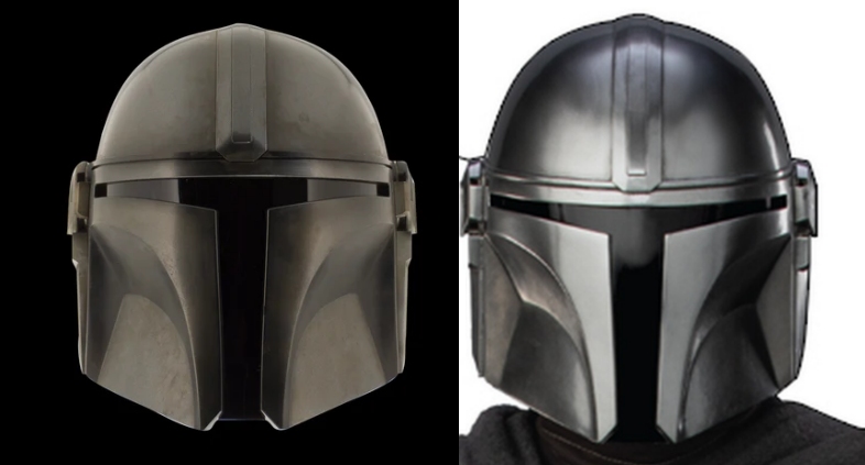

I was lucky enough to buy an EFX PCR helmet for a very acceptable price with the intention of repainting it completely to make an as accurate as possible Din Djarin costume as I can possibly sew for my other half.
I've noticed the ears on the PCR are quite fat and not nearly as slim as the series shows them to be. I've seen several posts on here and on various build groups that people have removed and replaced the ears for more accuracy, but no clues as to what's used to replace them with.
Any 3d files, links, hints or suggestions what to replace the ears with?

That's a great suggestion, I'll see if their ears fit the helmet as they're both much slimmer.

I had to replace the vent and ears on an EFX cast. It was a long time back but if I remember correctly, Great Ape’s vent is actually very close to the right size already. You can load it in a slicer like Chitubox and just scale it to the measurements from the EFX vent.
The ears are a little harder, but doable. I think I had to reduce the width a bit, but I don’t remember if it needed anything else. Chamanleon’s ears might be closer

Thank you for the advice! We're going to see if we can make these fit on the helmet as the general sculpt is quite nice and the size is perfect as well :)

If you're interested I'm currently designing the ears for this helmet with LOTS of reference material from the screen used prop. After seeing literally every decent iteration of this helmet I feel none are truly accurate. Will post my progress here and on a new thread soon.
Oh wow that would be a really cool update and upgrade for the helmet! Of course I'm interested!
