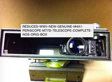

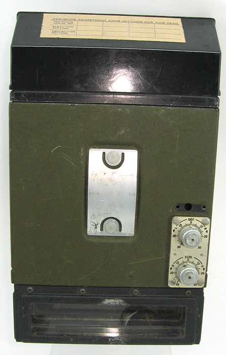

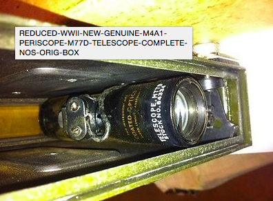

I haven't been able to find info on this within the RPF so I thought I'd open the topic. M38A2, M77C, M77F, M40A2 are just some of the scopes that - among other places - happen to be mounted within Periscopes (M4A1) of all places. I have yet to see if this includes M19, M40 and M32 scopes..

I found these interesting quotes from members on an RC model Tank builder/collectors forum.
http://www.rcuniverse.com/forum/rc-tanks-369/11461454-real-sherman-tank-gunners-scope.html
"The Scope M39A2 mounts inside a M8A1 periscope."
"M-4A1 was the gunner's periscope with adjustable reticle on the right side"
"Nice thing about M-41-26/46 there wasn't much diff in the gunners telescopes and they could be swapped out if they took a round and they were secondary sights anyway.."

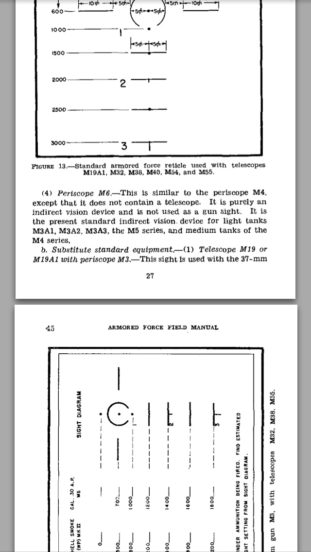

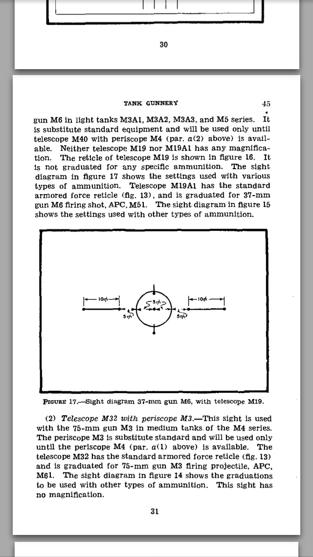

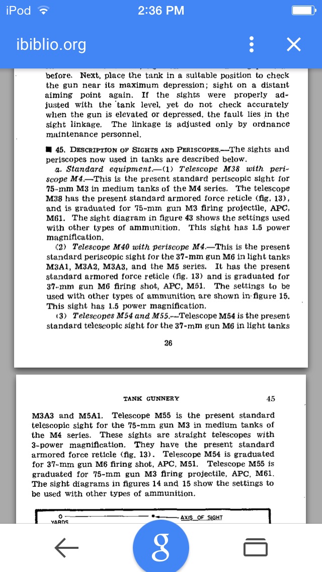

It looks like the M19 was mounted inside an M3 periscope. (Looking for one and can't find it!) The M40 was also mounted in a specific periscope, see screencaps
