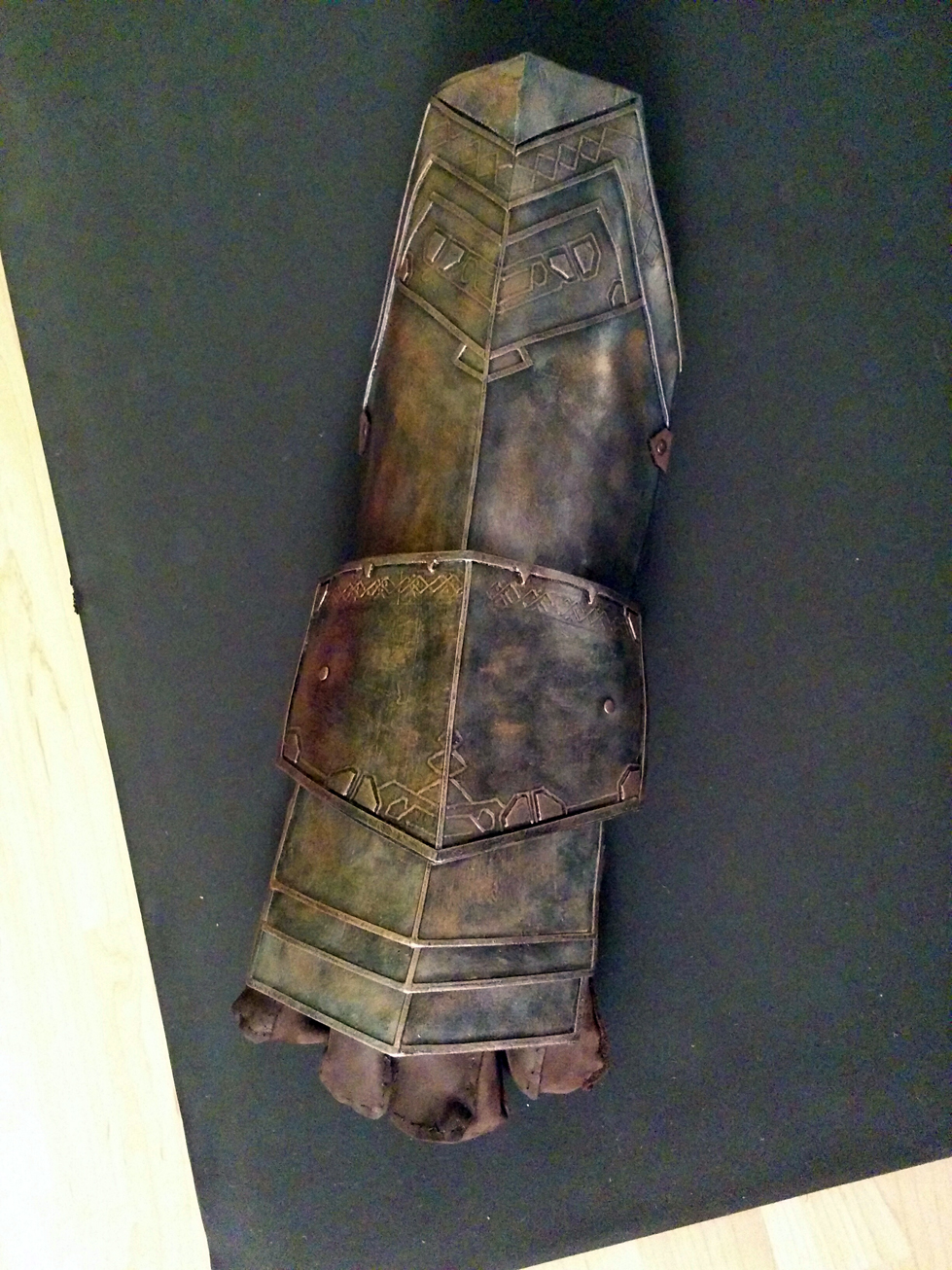

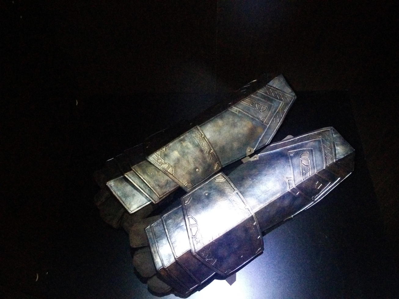

Right gauntlet ready for orc bashing, handguard(s) still WIP.
Now I need to find out how far we are with Star Trek replicators technology so I can make the left one out of thin air in seconds.

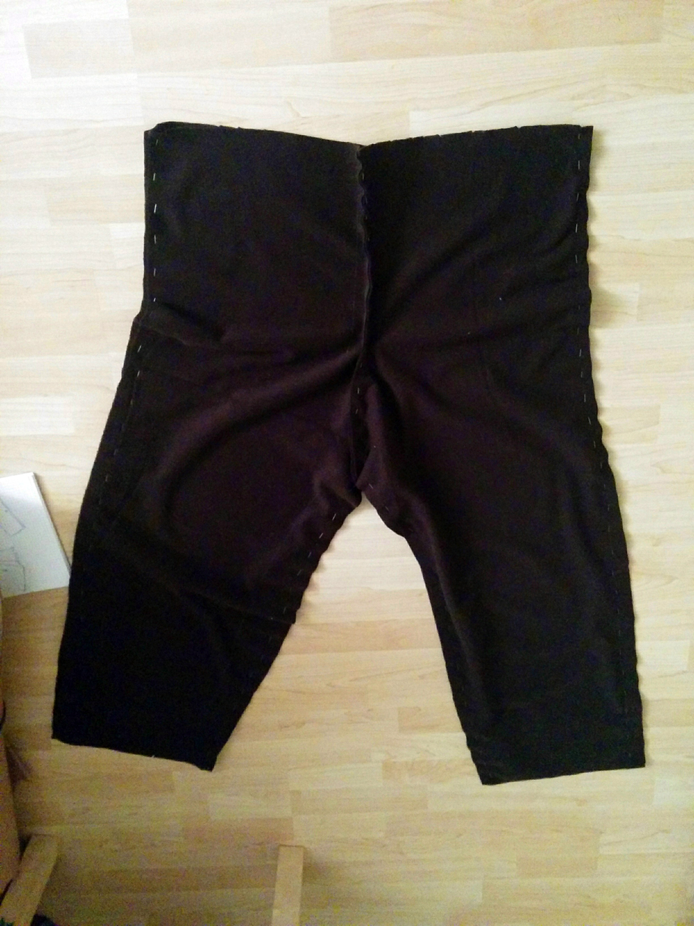

Dwarf pants !

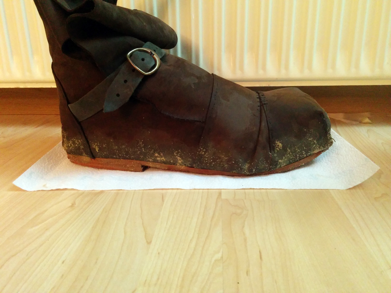

Boots shaped and weathered

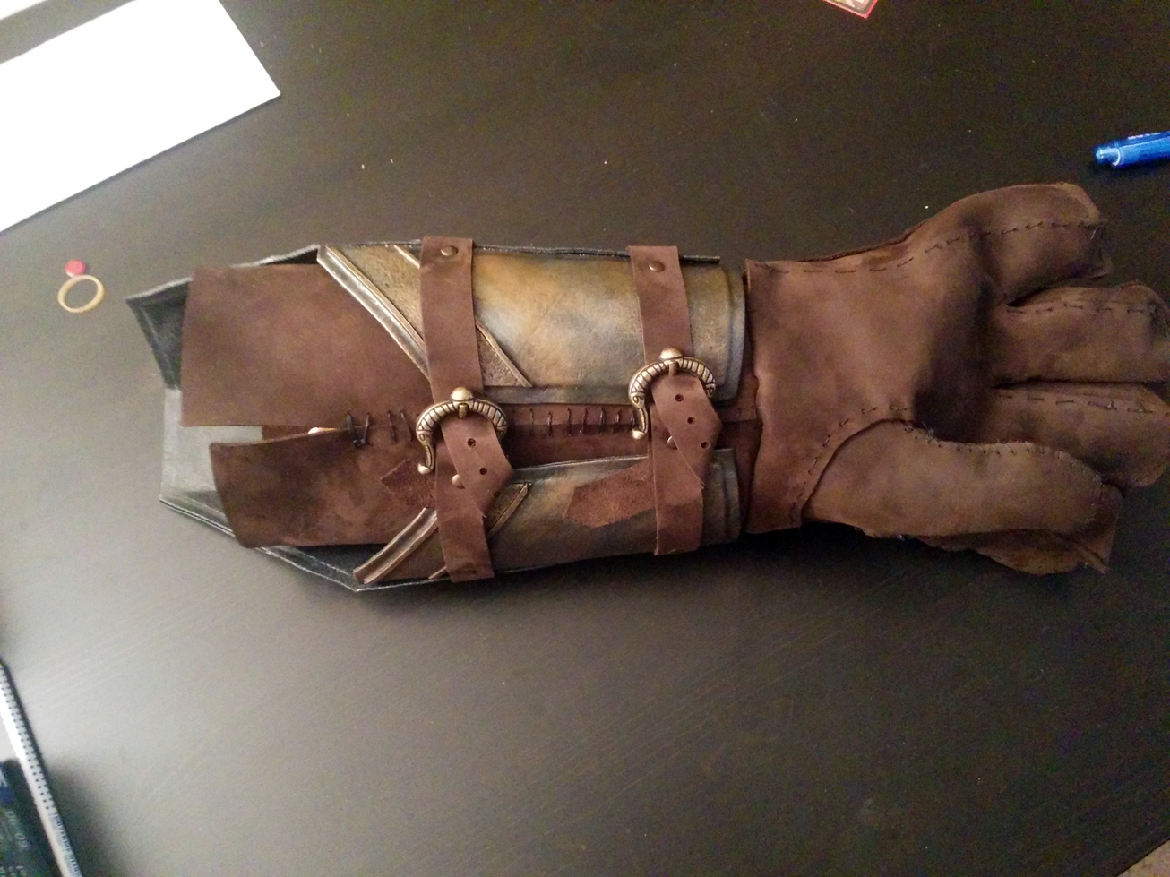

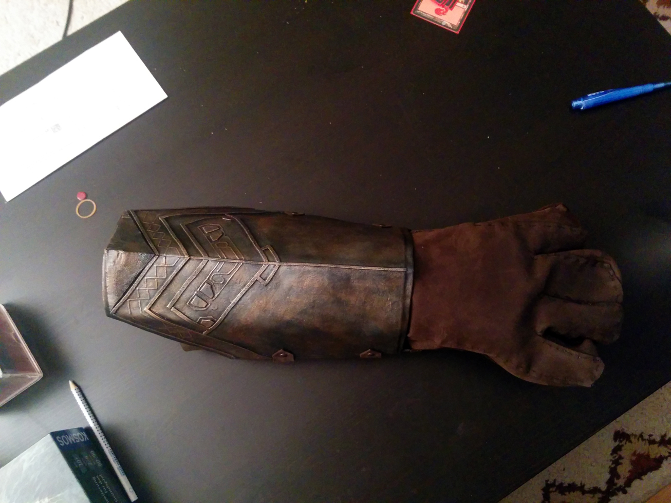

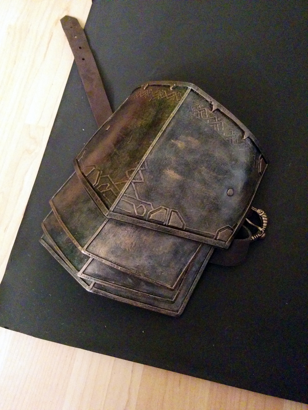

Here's a pic of both finished gloves with gauntlets and handguards:
Next piece to do is the armor front plate. I'm still in the process of shaping it and getting the proportions right

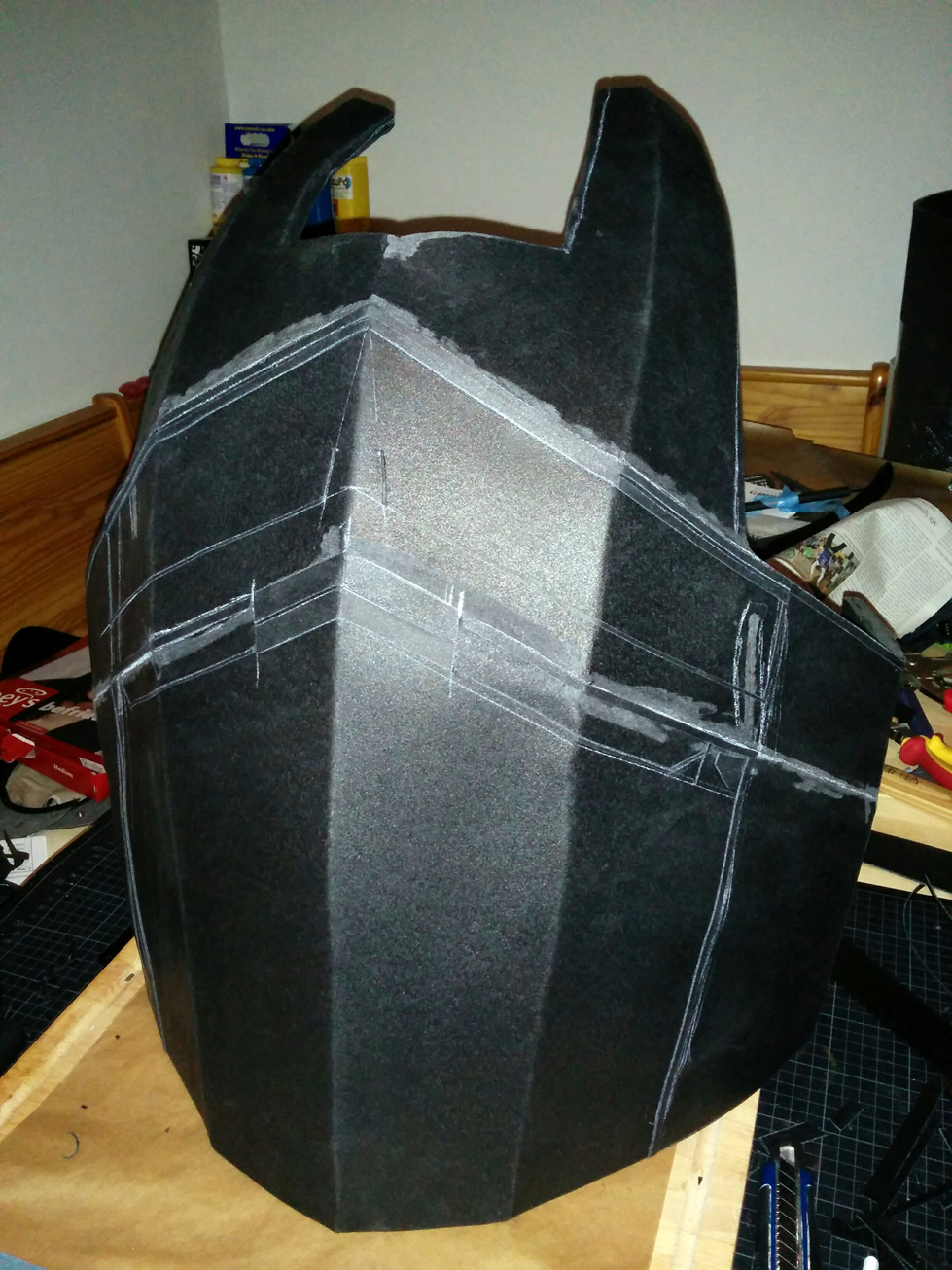

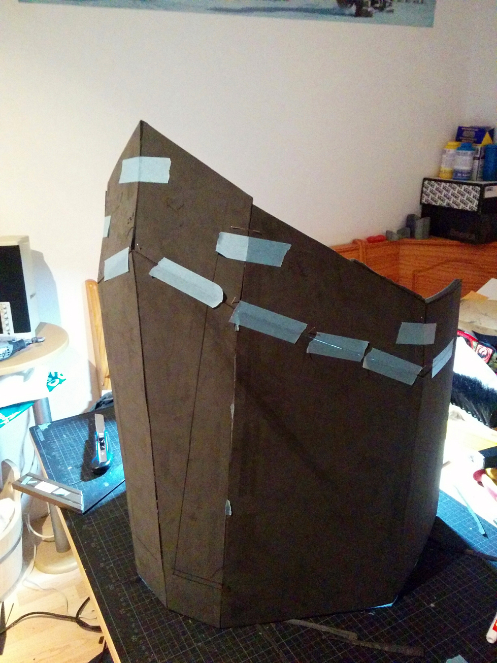

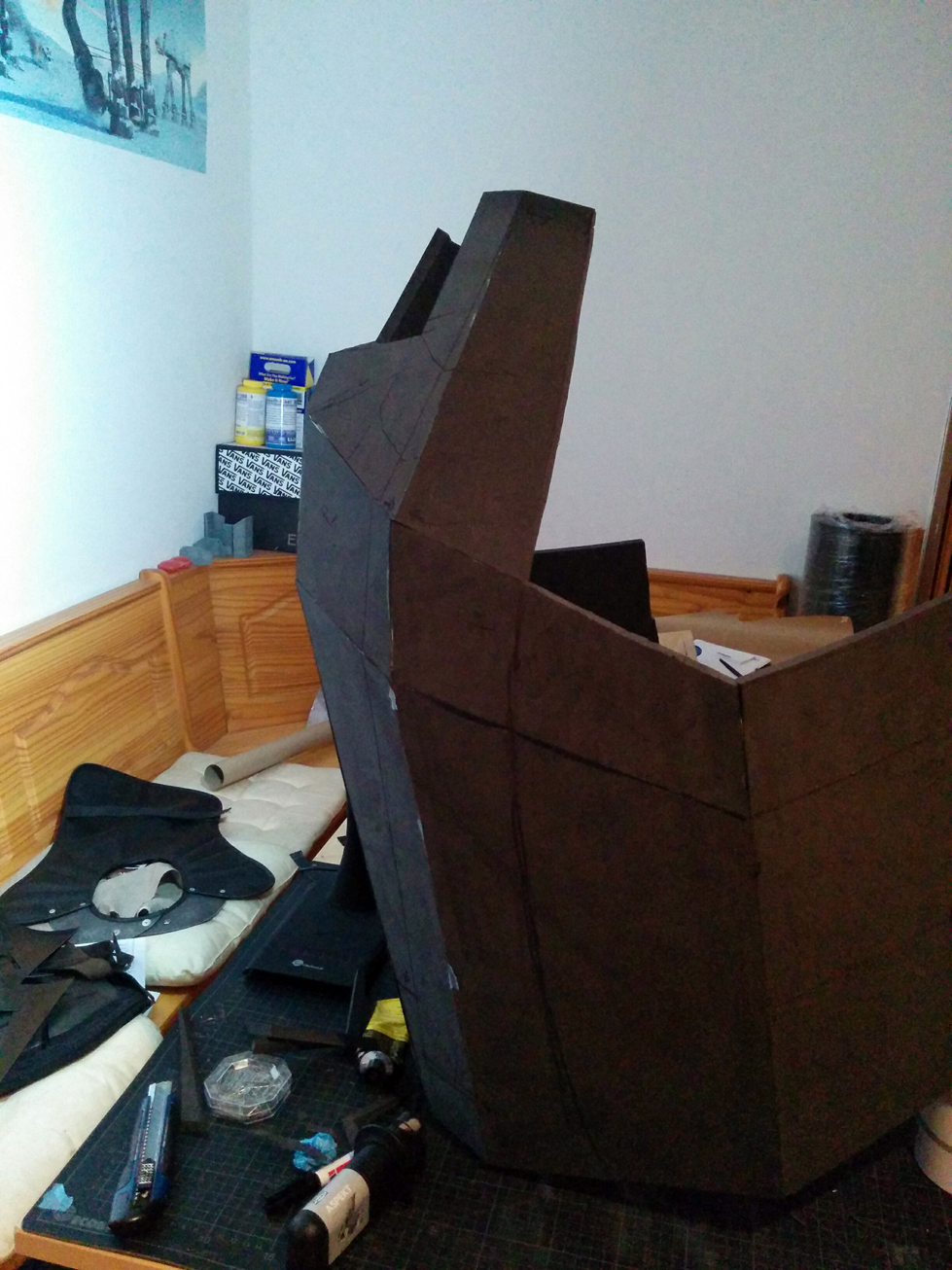

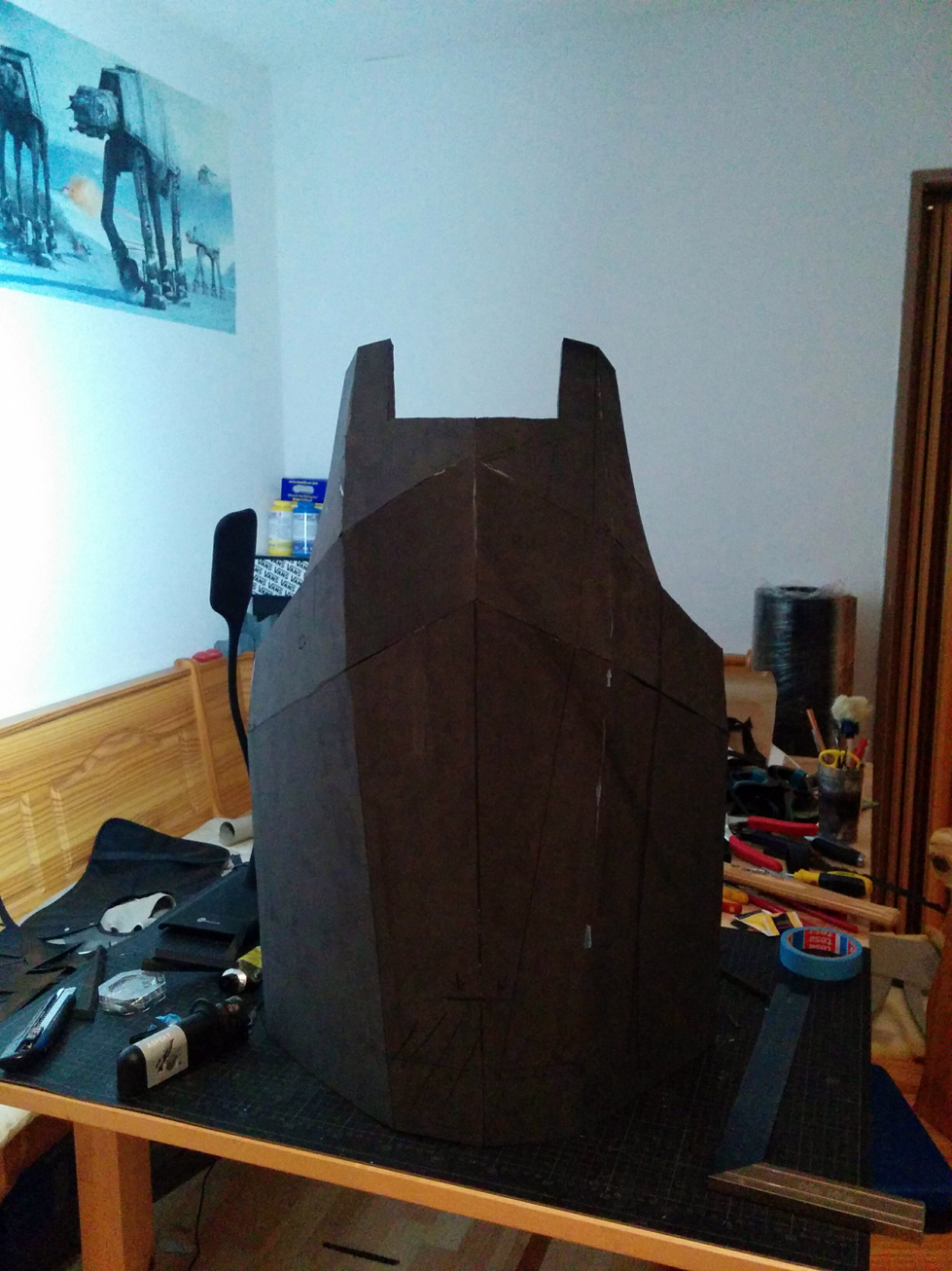

Done shaping the front piece. Still needs some trimming but I want to wait until the back plate is ready before I make any final cuts.
The whole thing is way to long, after trimming the bottom rim, it should have an angle like this

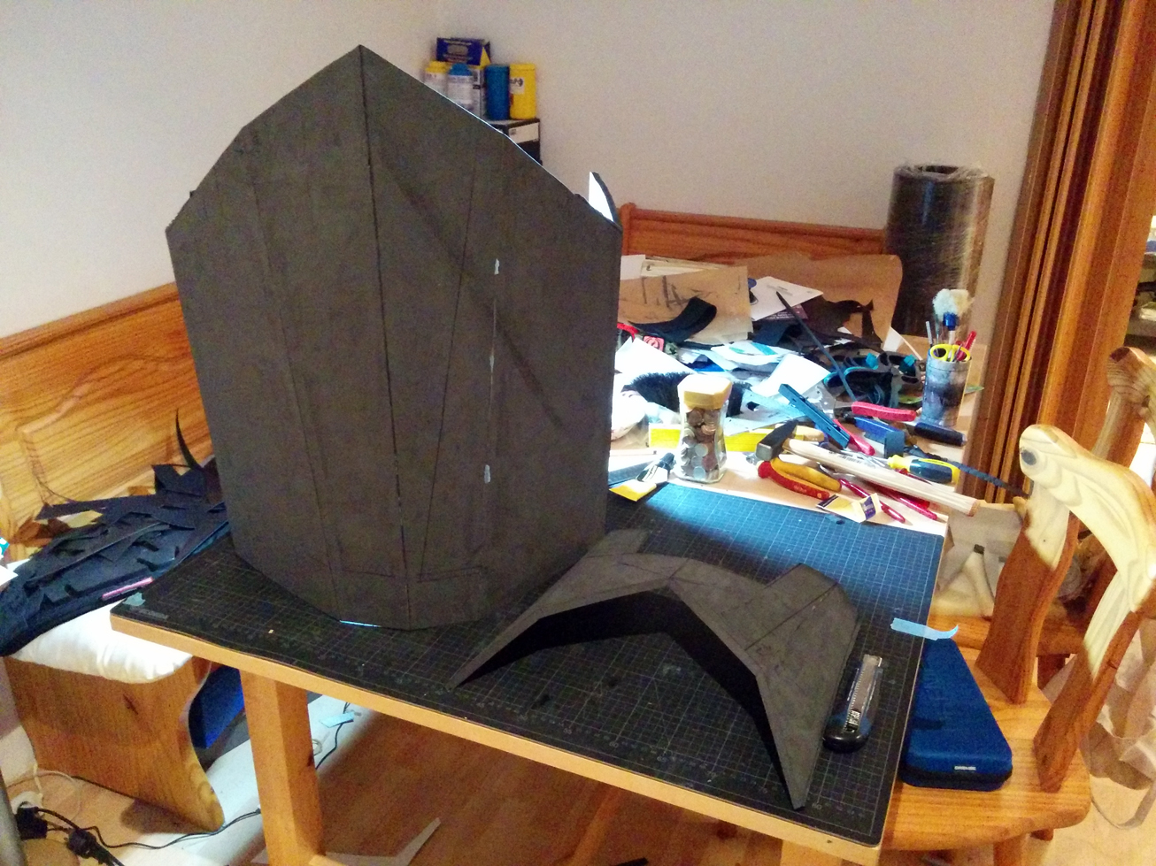

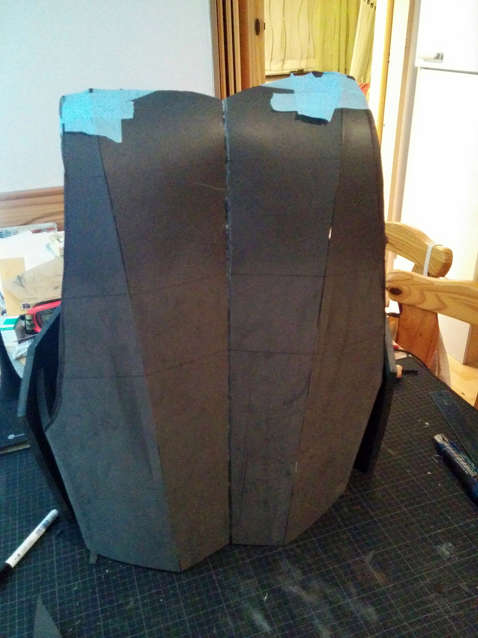

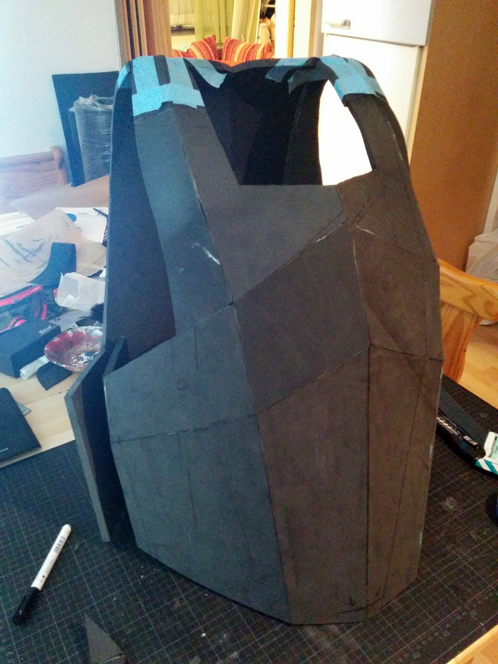

A little update, though you don't see much thanks to the light-swallowing blackness of the worbla.

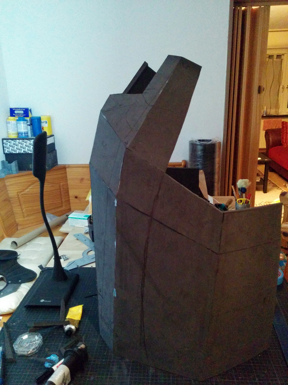

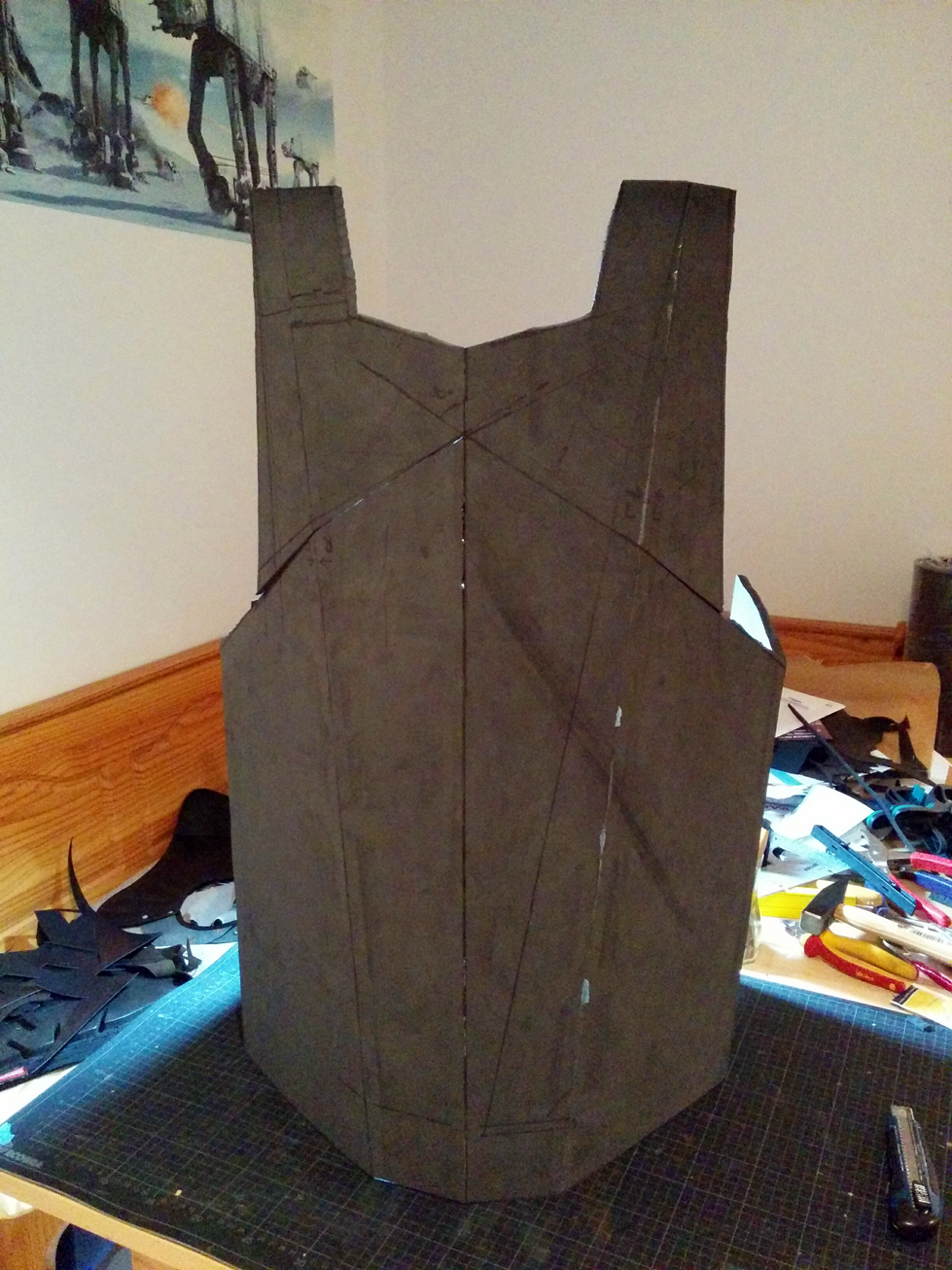

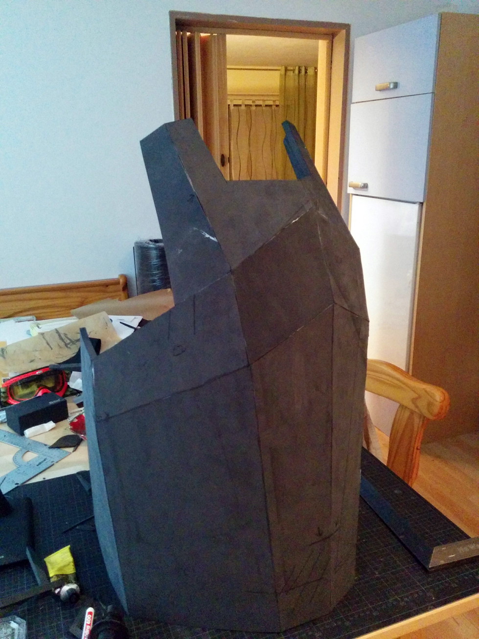

Here's the finished armor foam core:

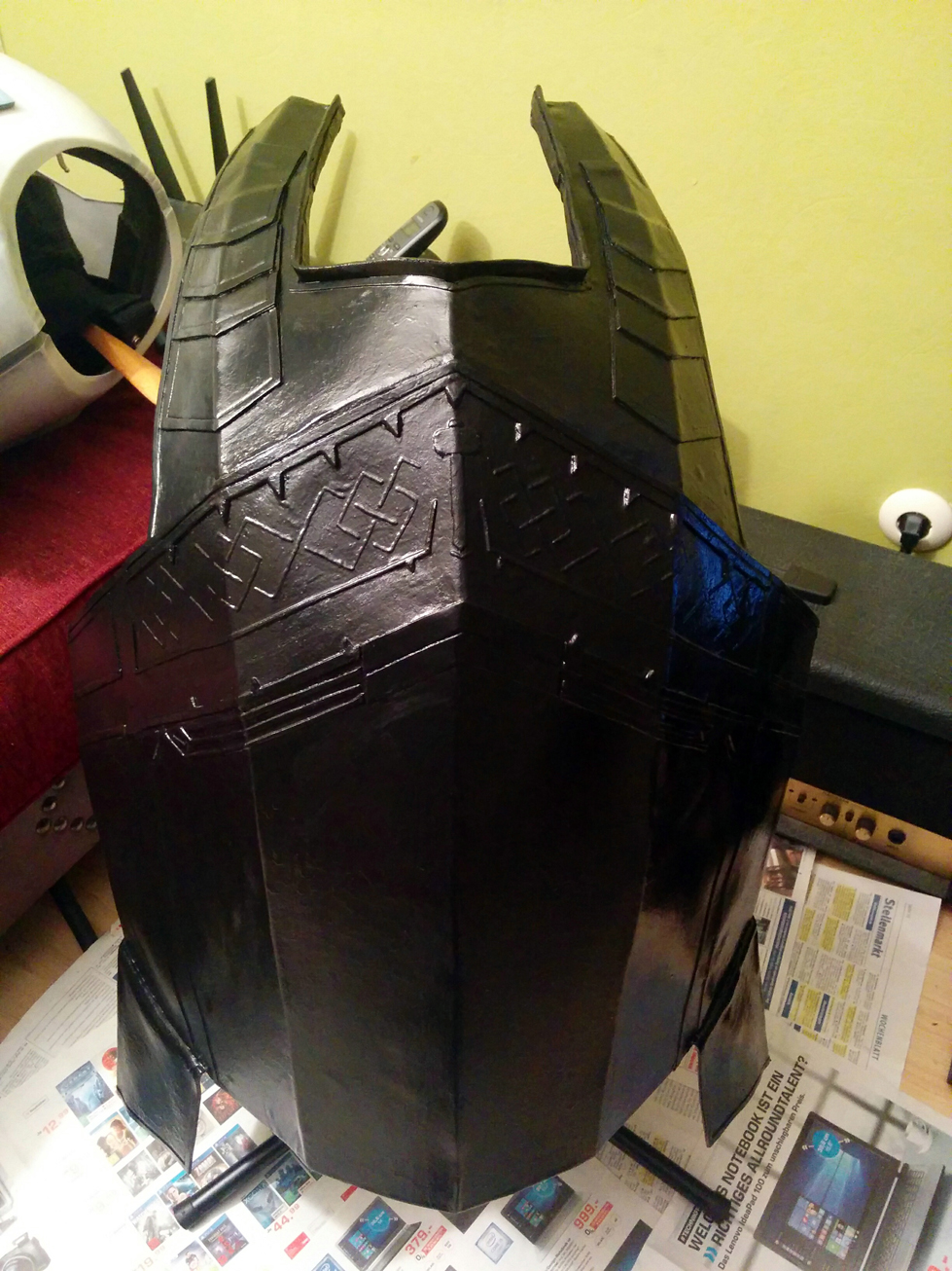

And here's the front armor with the ornaments I did today after I coated the whole thing in worbla and sanded down all the seams.
You don't see much though due to the black worbla and the sanded areas reflect more light than the ornament edges so it all looks kinda messy.
While I love black worbla I gotta say it's a pain in the butt once you've reached a certain size with your worbla pieces. The pieces on the torso became almost uncontrolable, warped in every direction but the one I wanted it to go and once you have one area under control and you want to move to the next area, the worbla there is already too cool to work with. Made me angry. Any hints on working with larger worbla pieces ? Are there any tricks you need to know ?

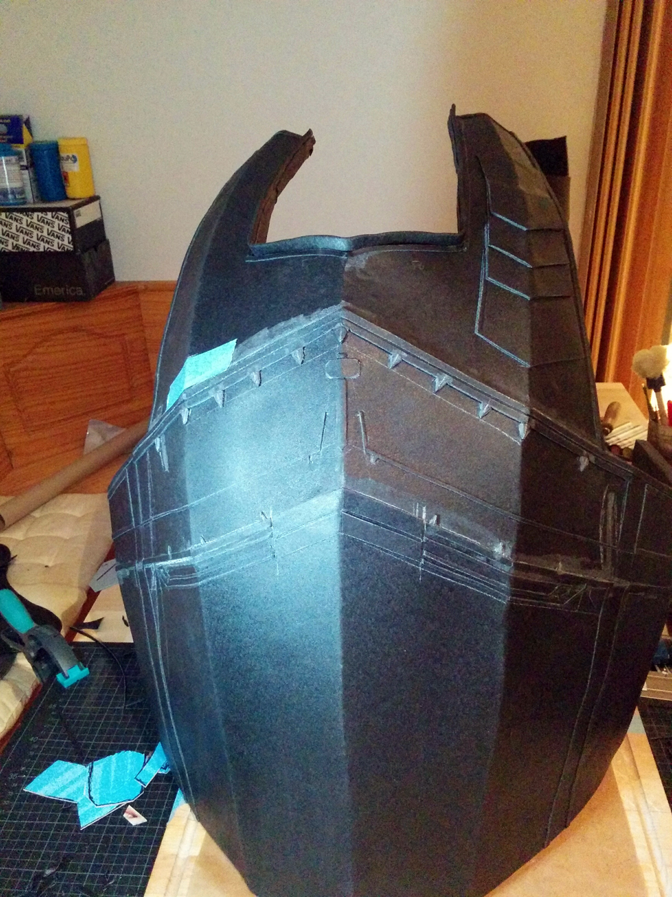

Spent the last two evenings working on the chest details and I'm almost done. Of course my dremel slipped on the center tooth that's right above the hammer so I had to redo that one and it still needs sanding :unsure

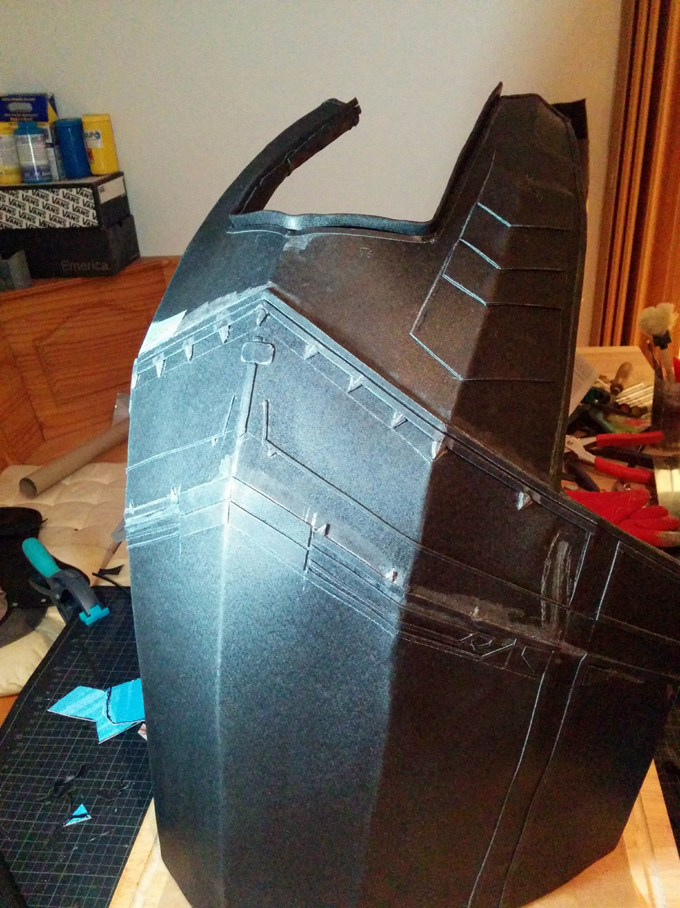

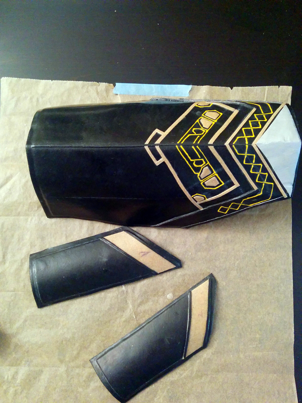

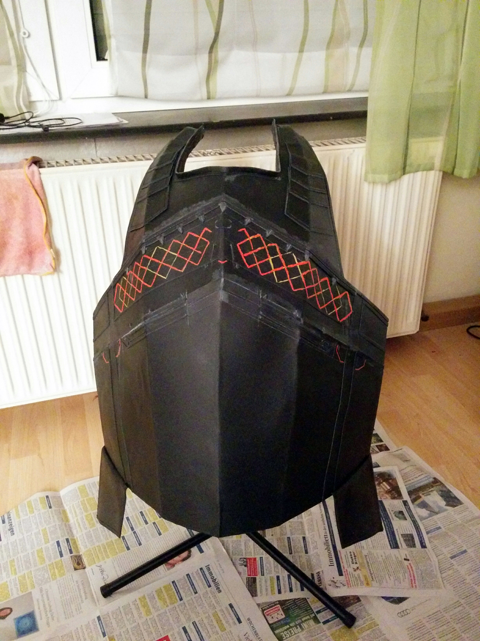

All details done. Hammer, the ruined center tooth, the shoulder scales and the hip armor plates or whatever those things are.
I'm going to apply some wood glue to the areas where I had to sand the worbla with my dremel to smooth them out a bit before I apply a coat on the whole piece.
The colored lines are just some acrylic paint to shine through the first layer of wood glue so the 3D pen lines become sharper later on.

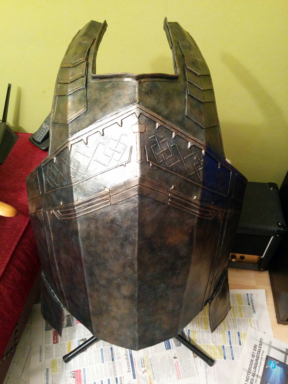

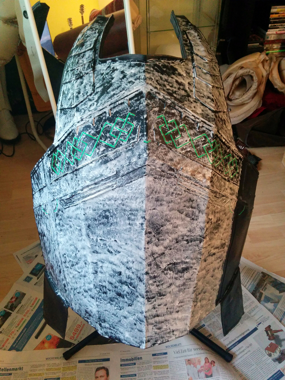

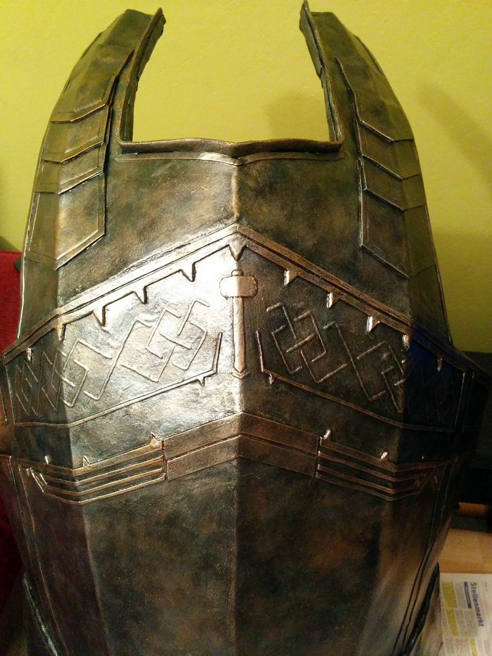

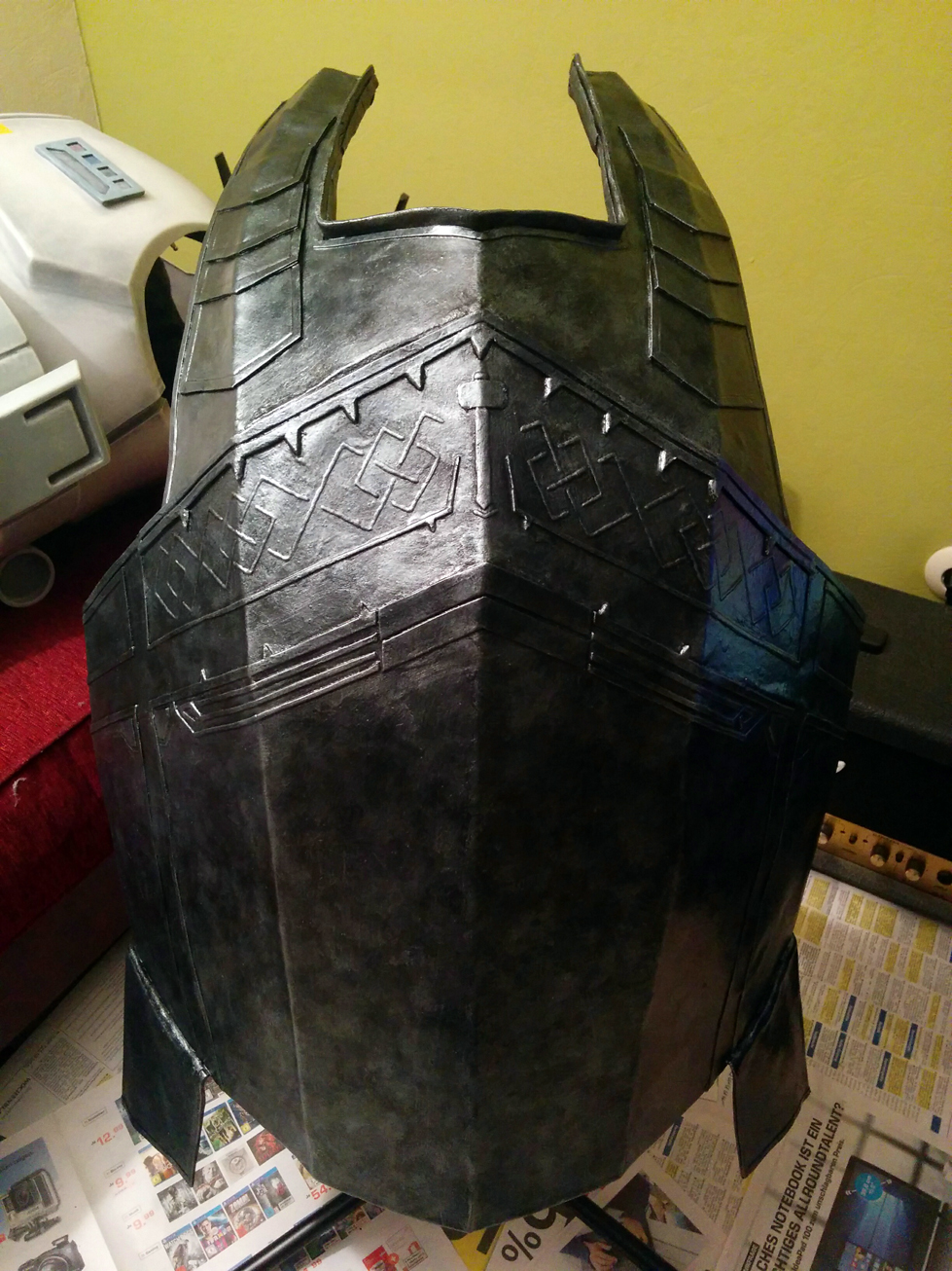

Chest plate is done. I tried to track each stage of the painting process.
Here's the second layer of wood glue, hammered on the armor piece. That's what causes this pattern:
Black foundation on dried wood glue:
Drybrushed layer of silver:
Drybrushed layer of bronze
Next up: Backplate

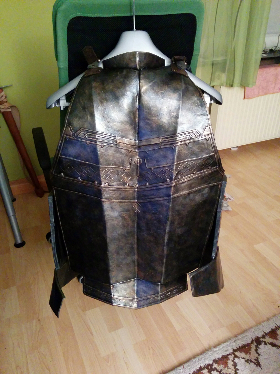

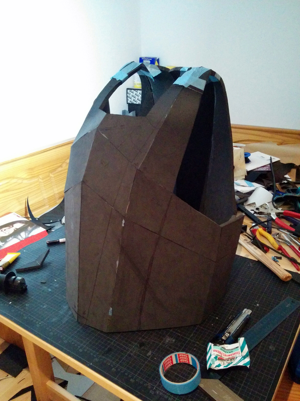

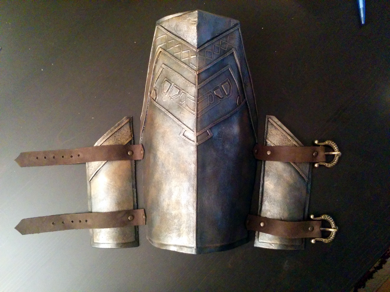

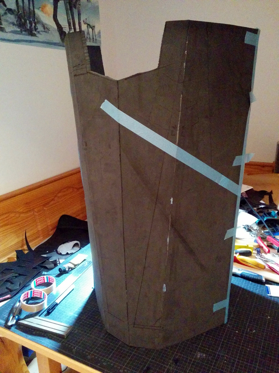

Been busy doing real world stuff lately but here's the finished backplate. The front and back are strapped together at the shoulders and I'm going to do the side strapping next.
Unfortunatly, the whole thing is far from finished. Still gotta do the cod and hip armor scales before I can move on to the shoulders
