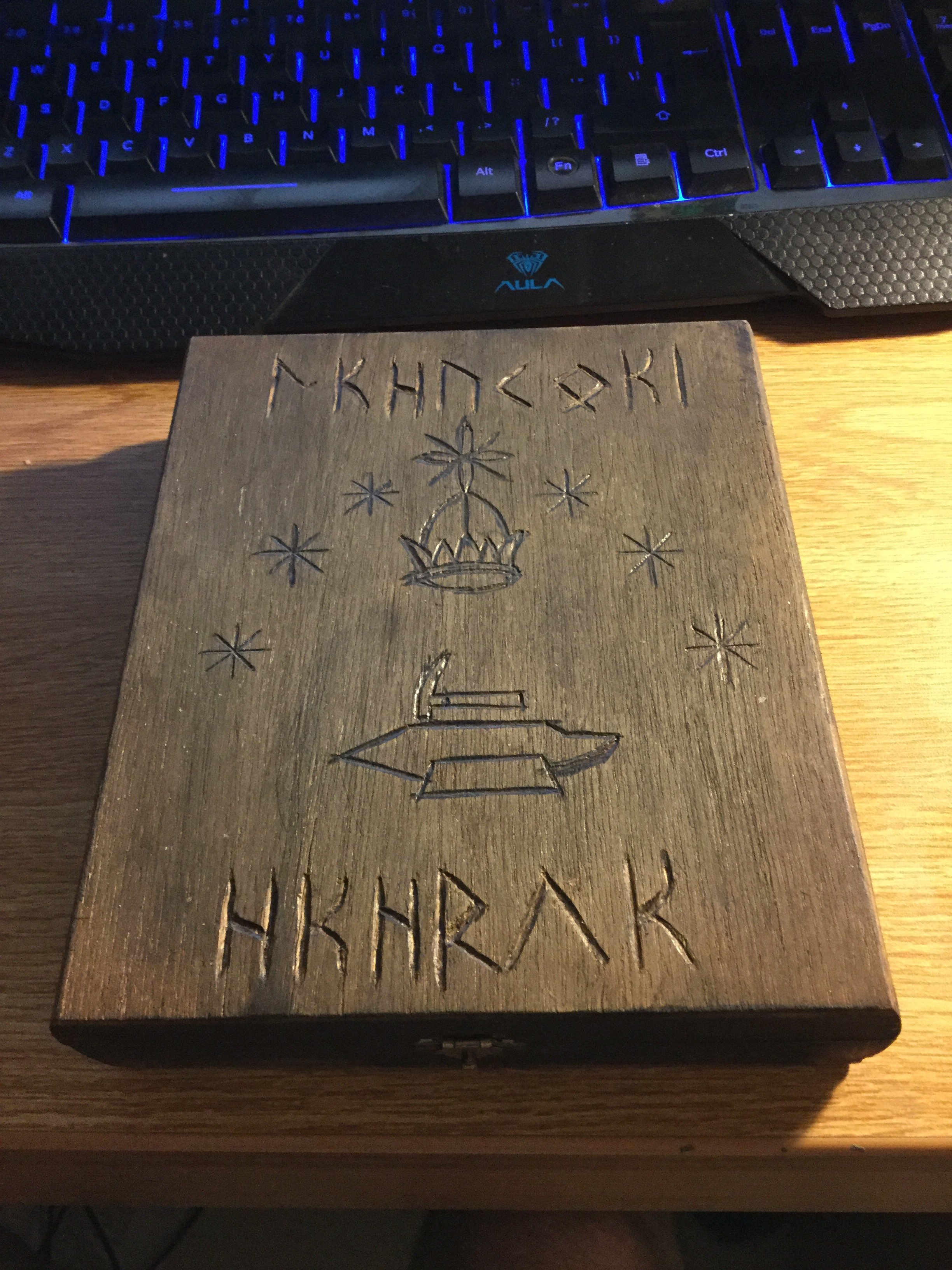

The cirth runes on the front read (from top to bottom) "TREASURY EREBOR" - I had originally planned to write the phrase out in Dwarvish using the resources from The Dwarrow Scholar, but the text wouldn't have fit as nicely. The crest of Durin takes up the middle of the box, and I did my best to copy it from the Doors of Moria. This wood-burning was done using a soldering iron - in the future, I hope I can get actual wood-burning tools to make this process much easier.

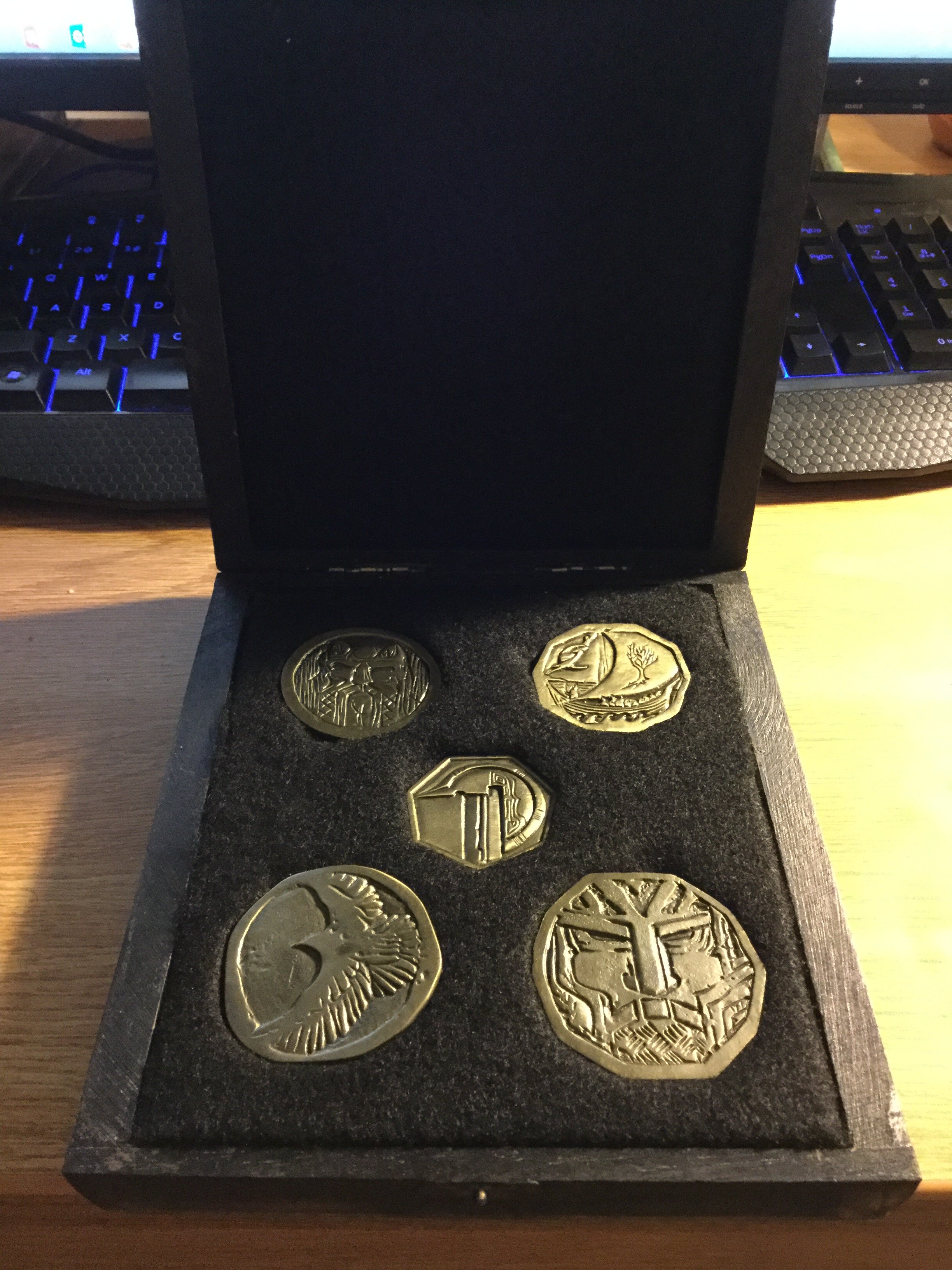

The interior of the box was trickier than I had anticipated. The original plan was to use a dense foam and then hollow out spaces for the coins to rest in, but that didn't pan out. Instead, I layered pieces of foamcore to fill up the empty space in the box so the coins would rest about flush with the edge of the box. This particular box needed two layers of foamcore: the first was a plain sheet, and the second piece had holes cut for the coins. Before sliding the top sheet into place, I covered it in black felt to make it presentable. The same process was used for the empty space in the top half of the box.
I stained the box using a mixture of white vinegar and steel wool that was left to oxidize for about two weeks. I brushed on somewhere around 3 or 4 coats to get this color. Then I attempted to weather it using a watered-down black paint in the corners and crevases. It really helped to make the runes and crest pop out.
This box feels much better than the flimsy thing the coins were shipped with. It can also handle traveling fairly well, as long as I don't pack it under heavy stuff.
