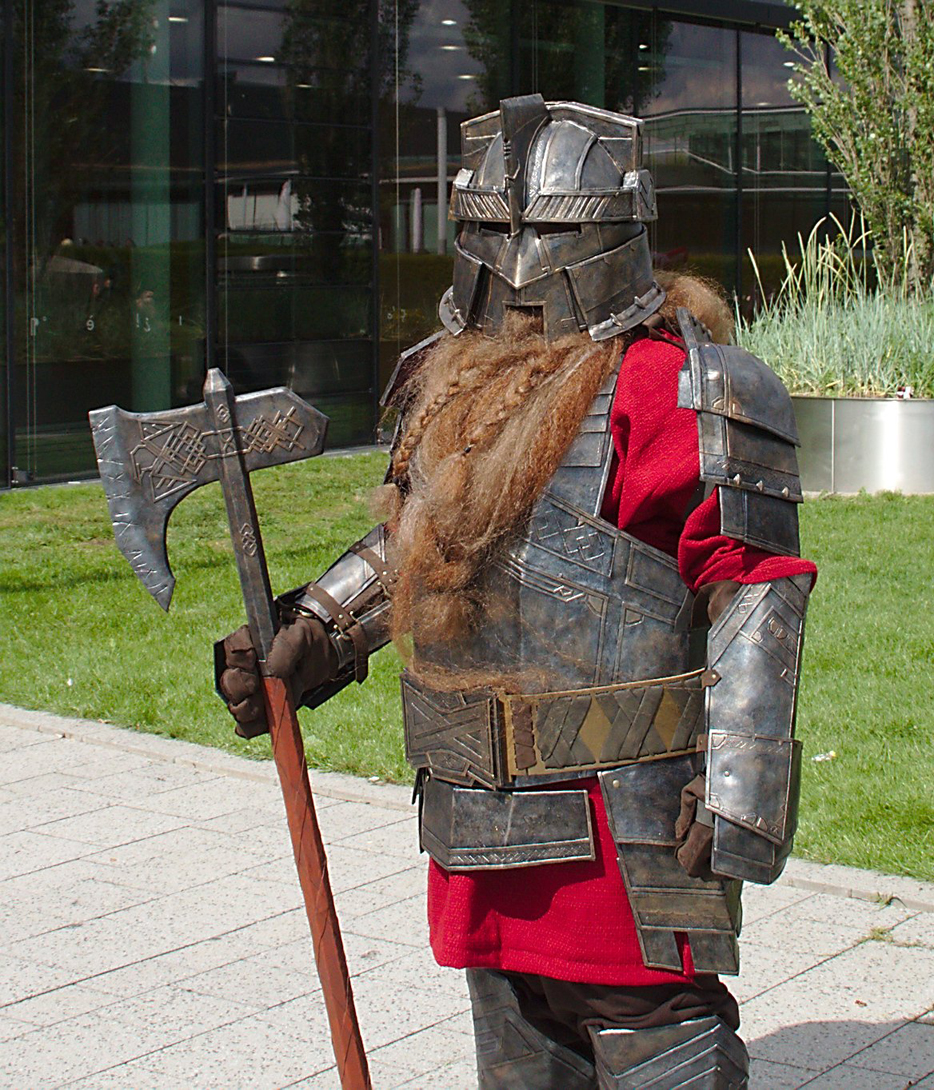

    Khazad Dum has do be taken back from those rotten orcs. The halls of Durin are ours. Baruk Khazad ! Khazad ai menu !
    There already are a some pretty impressive builds of Moria Battle armor but I want to resemble the physique of an actual dwarf. I'm gonna build a fat suit similar to the ones used in the "Hobbit" movies and measure the entire armor around that suit.

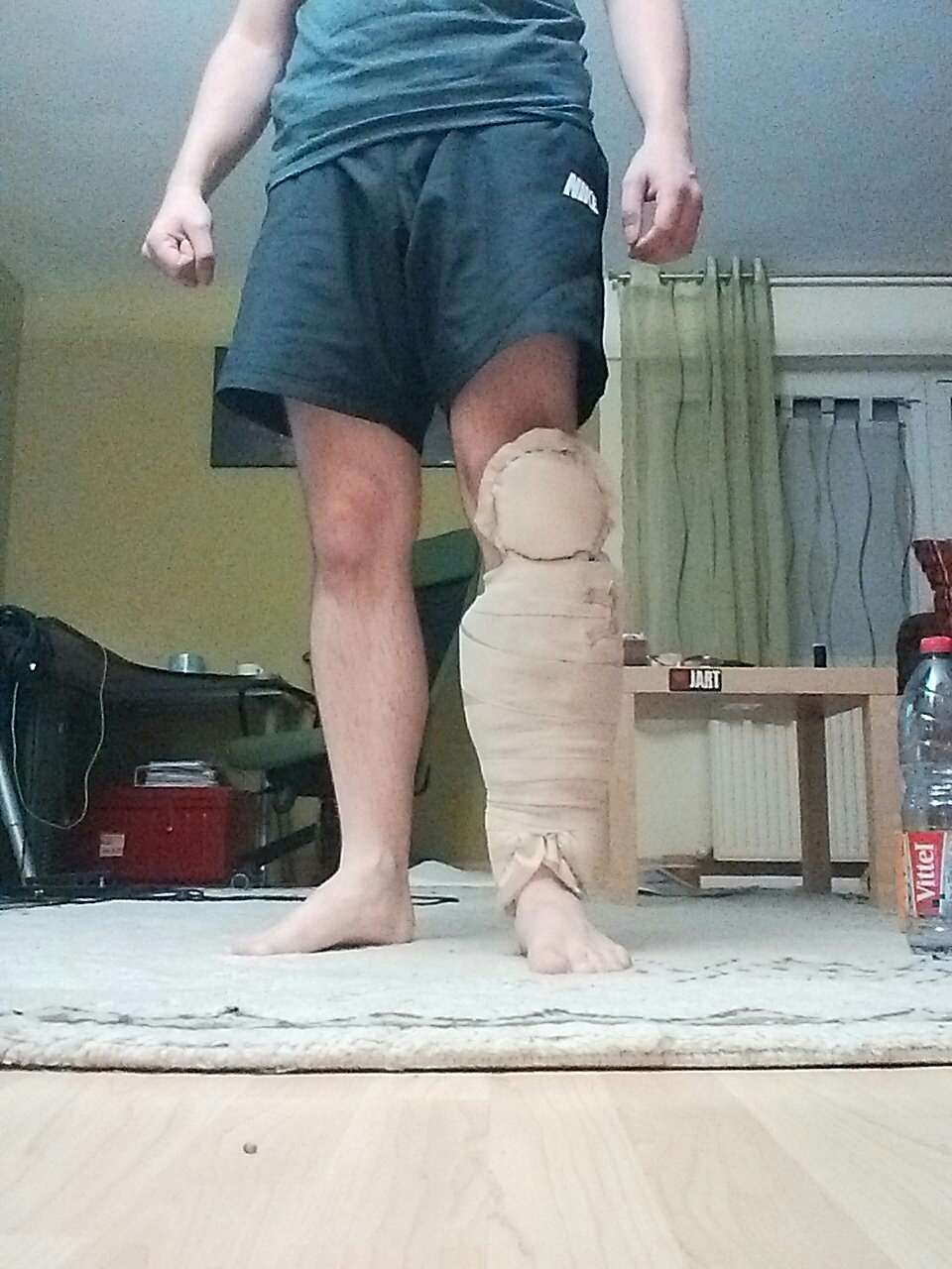

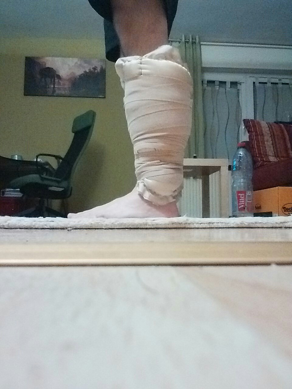

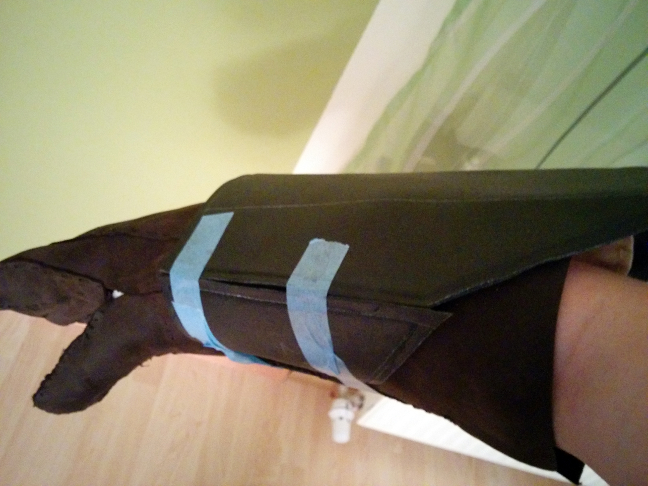

    Started with the calves:

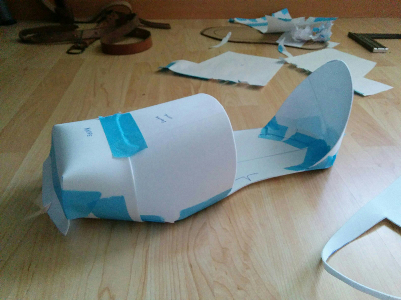

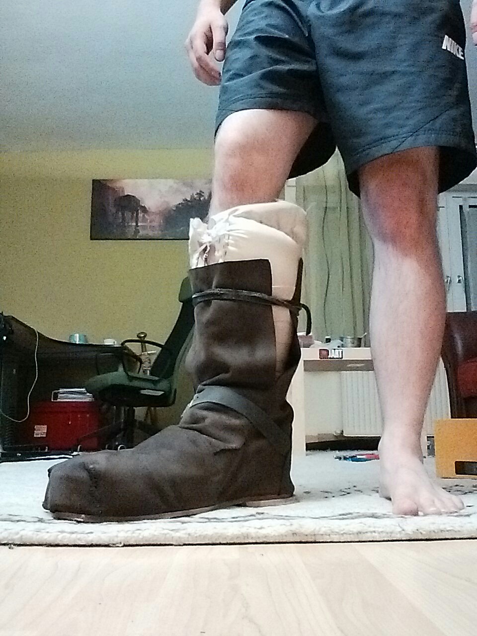

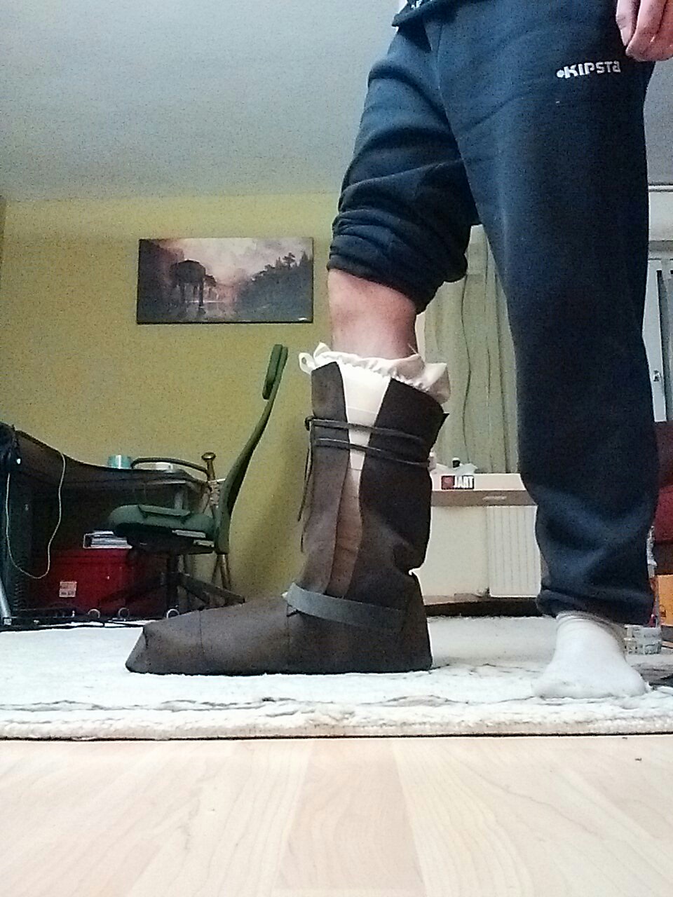

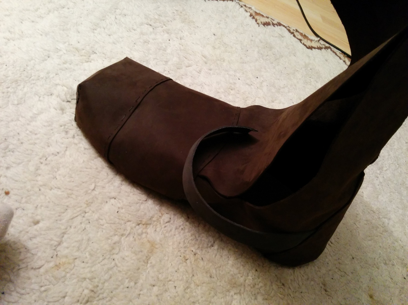

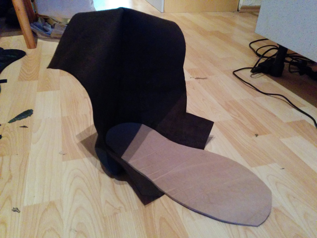

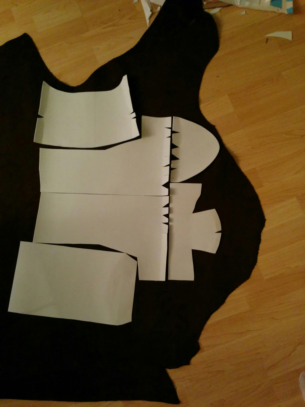

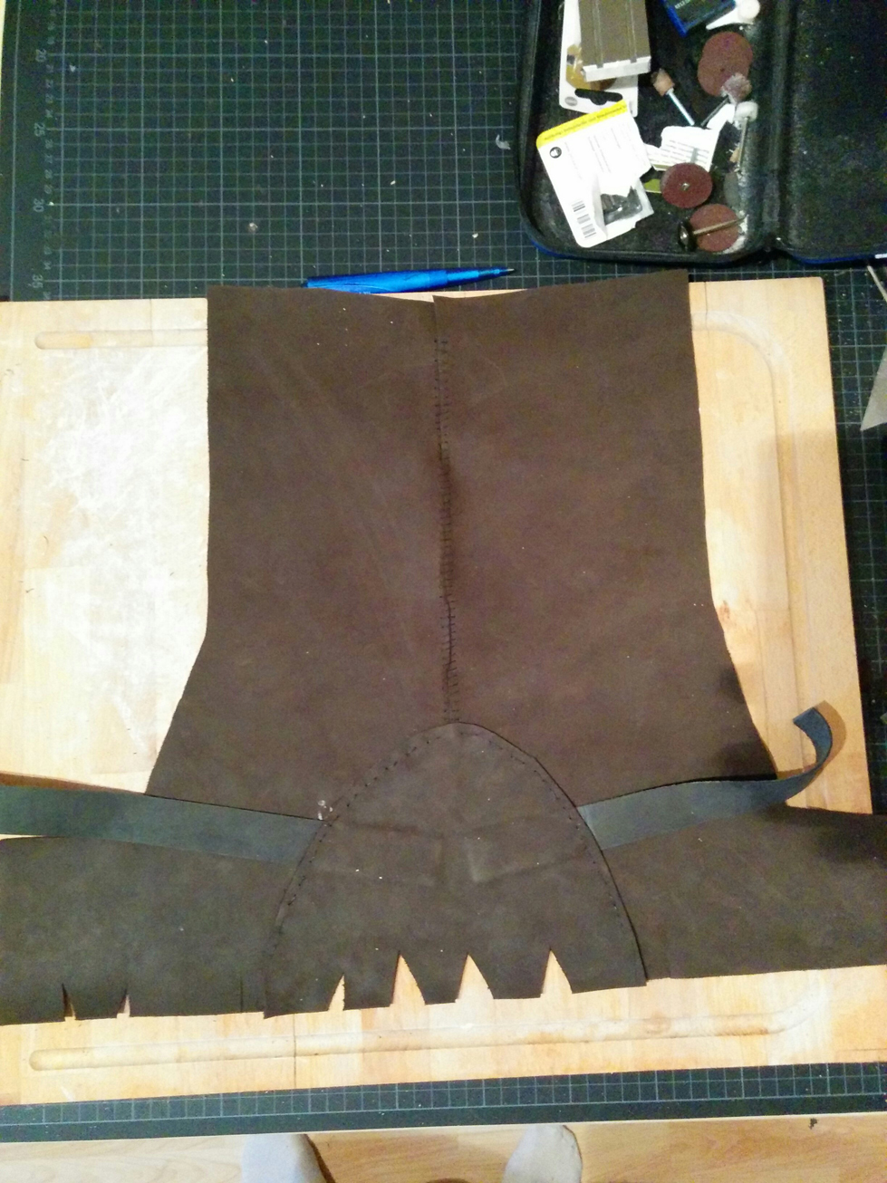

    Another detail are the dwarves' boots. Quite large boots according to BTS pics, way to large to buy them, so I have to make them myself.
    Here's what I got so far. I'm not done with stiching, the sole is missing and the whole boot needs proper padding inside.
    Scale test with fatsuit calf
    A lot of work ahead but winter is coming. I have plenty of time for this

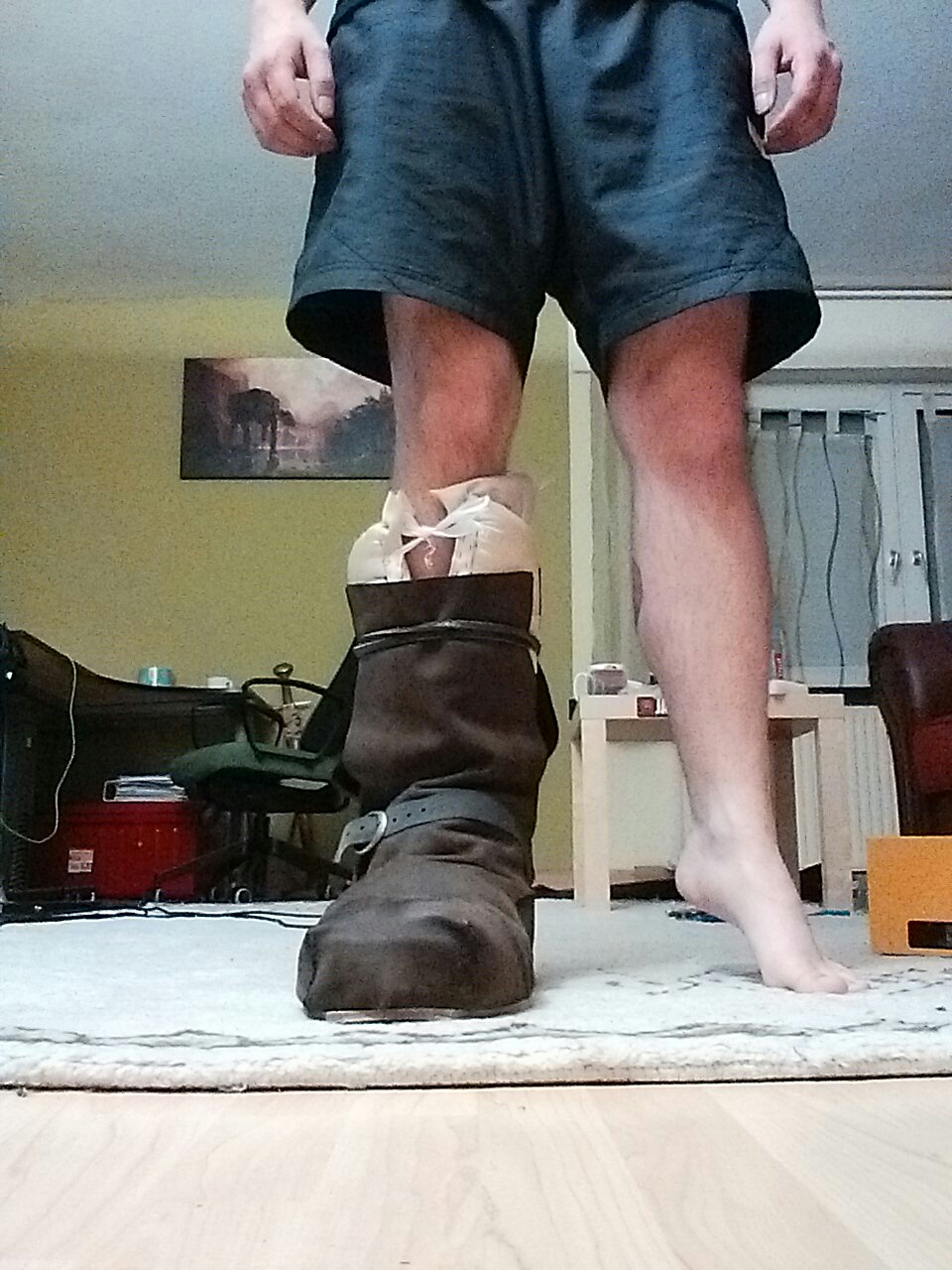

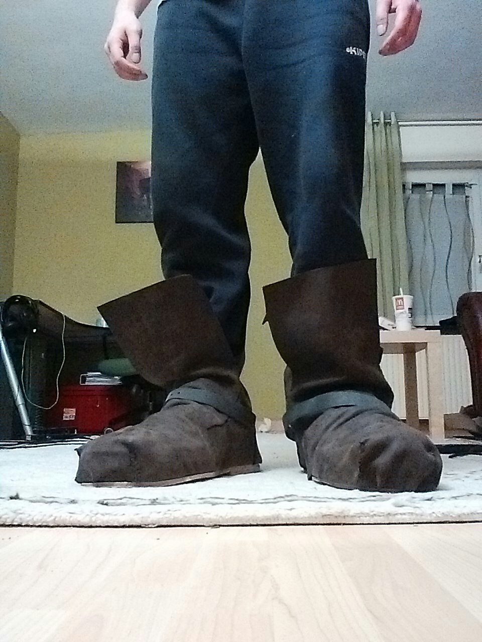

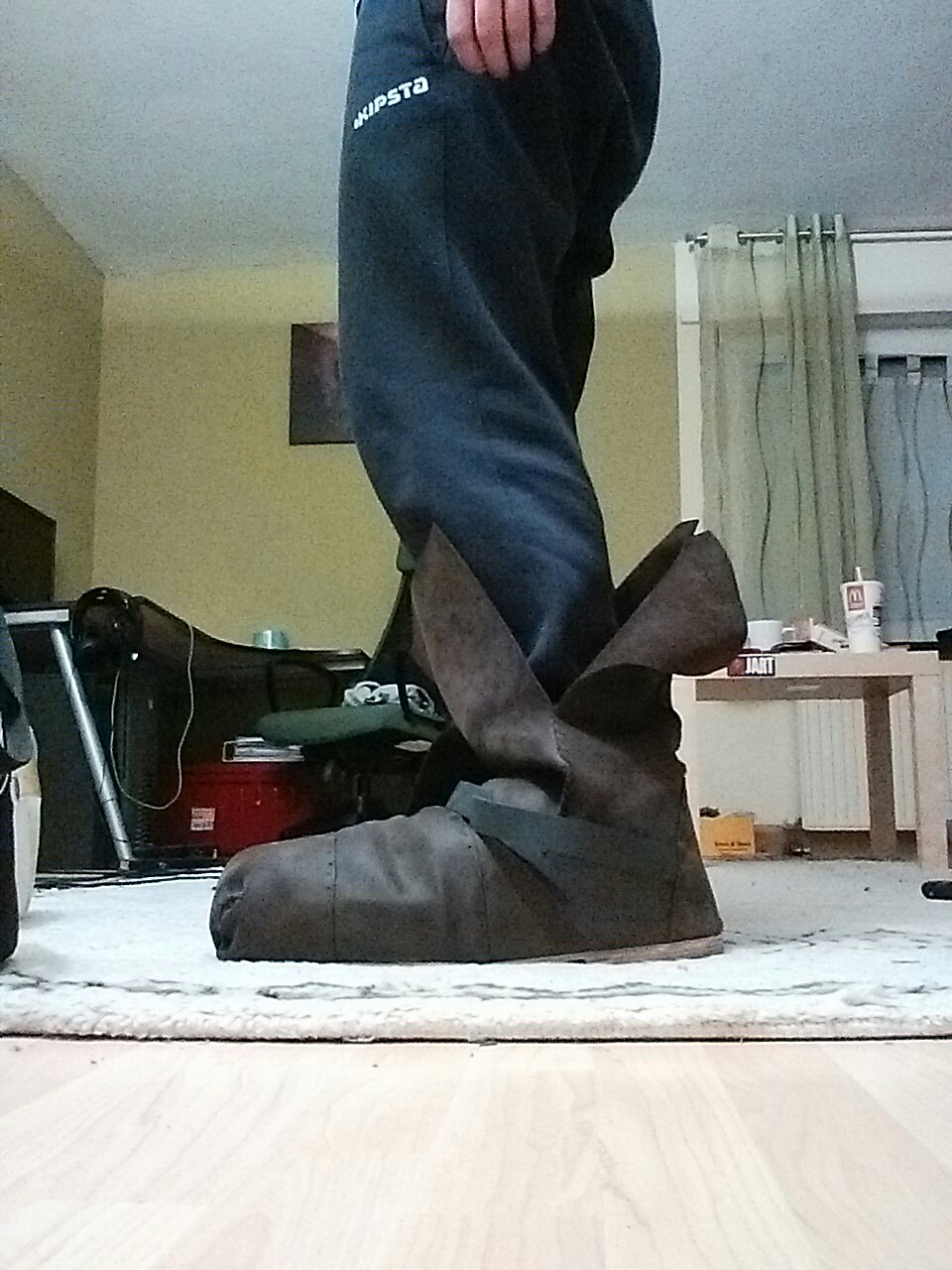

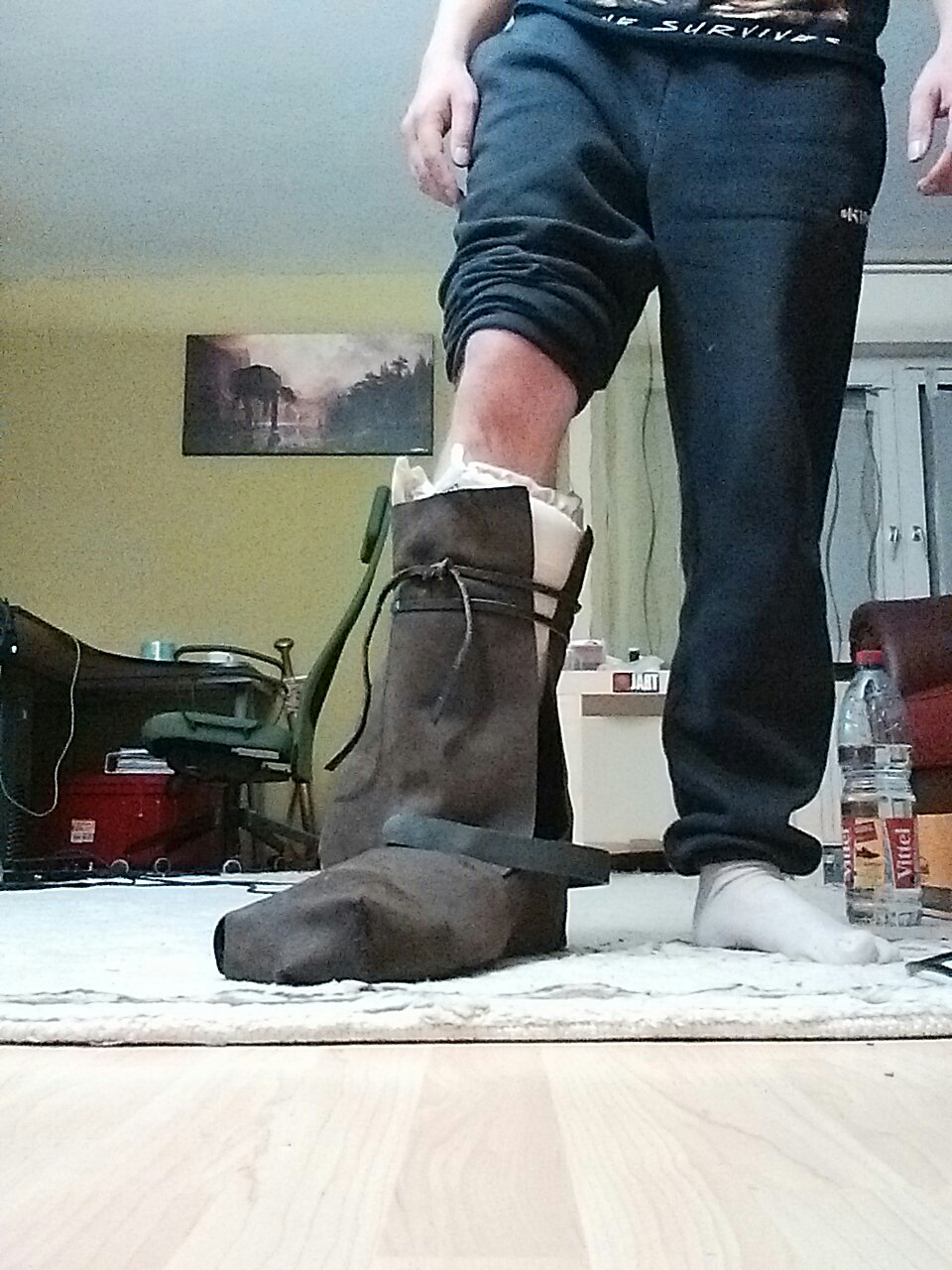

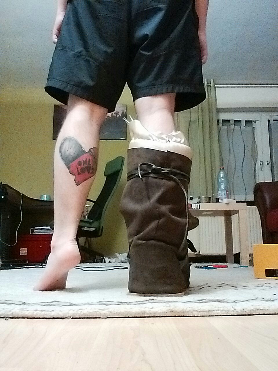

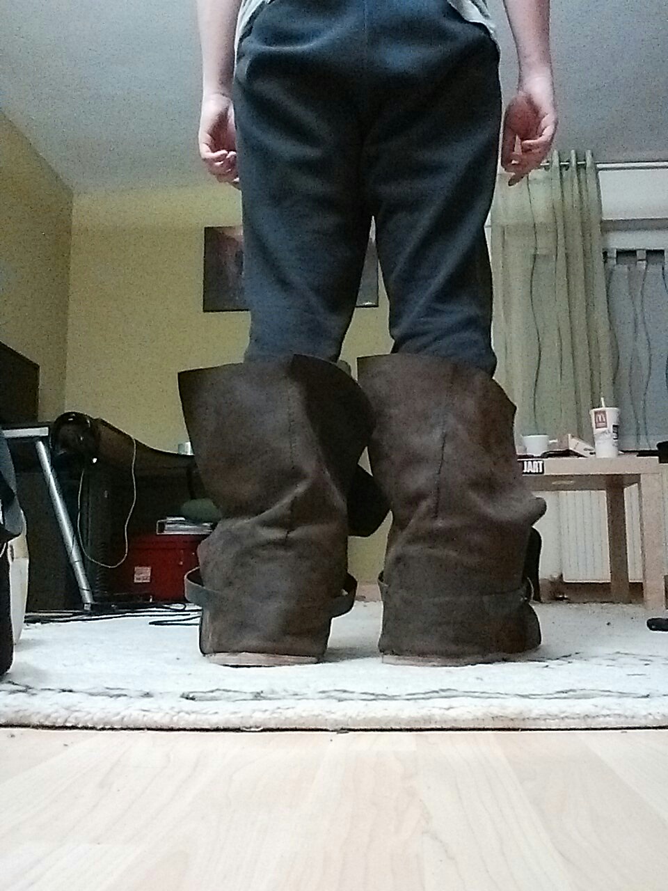

    Done sewing the right boot. Sole and heel added. Still waiting for nails to additionally affix the sole to the boot and give it a little more friction. Heel will be trimmed once the nails are done.
    Padding added but needs some more adjustments so the boot doesn't look too long compared to where the leg starts.
    The side gaps will be held in place by the shin armor eventually, for now I took this leather cord to keep everything in place.

    Almost done with the boots, but I need to work on the padding. Walking feels okay but I could do better. Here's the result without the fatsuit parts:

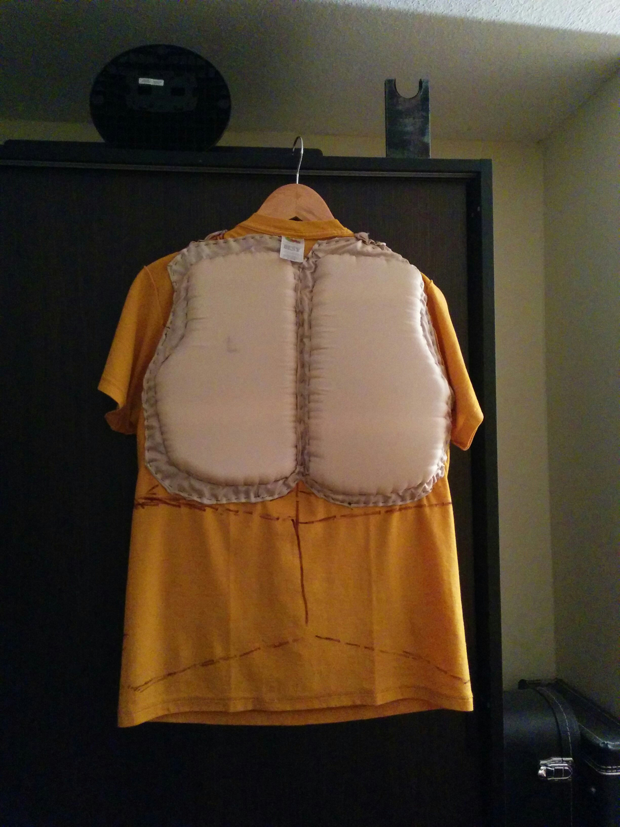

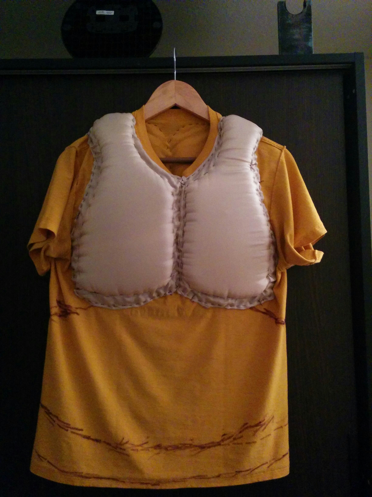

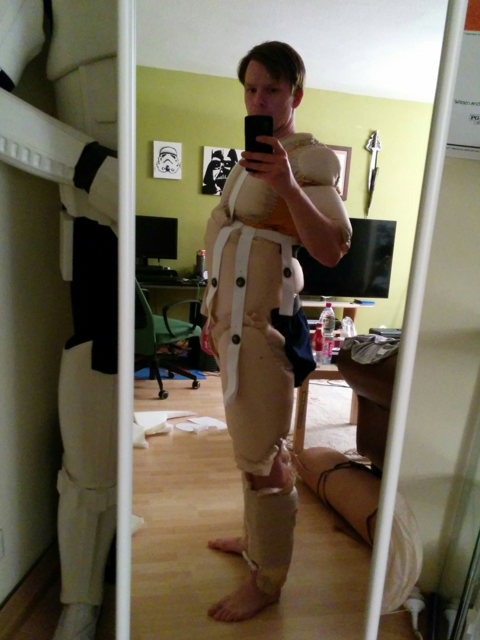

    Also started working on the chest part of the fatsuit

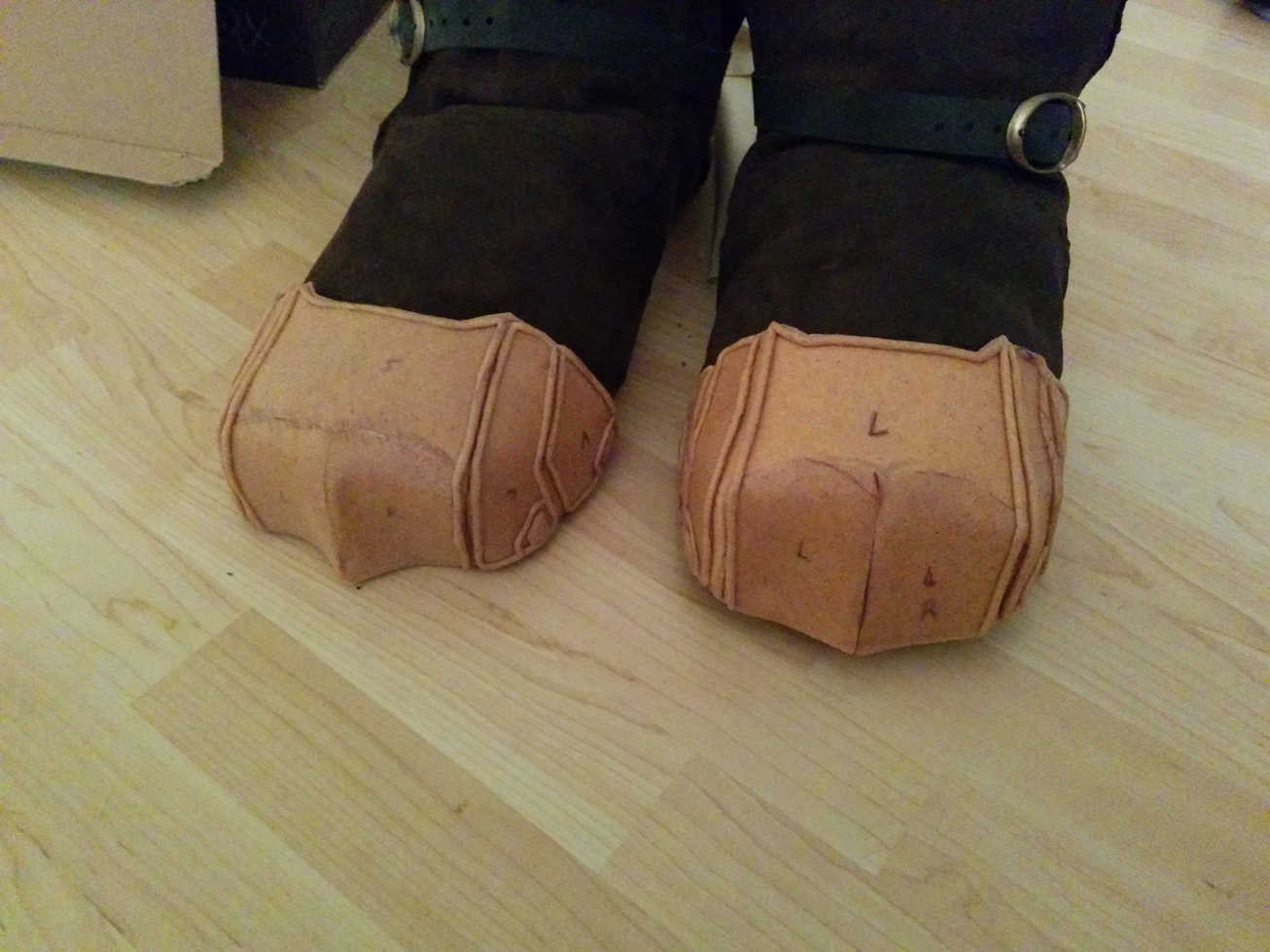

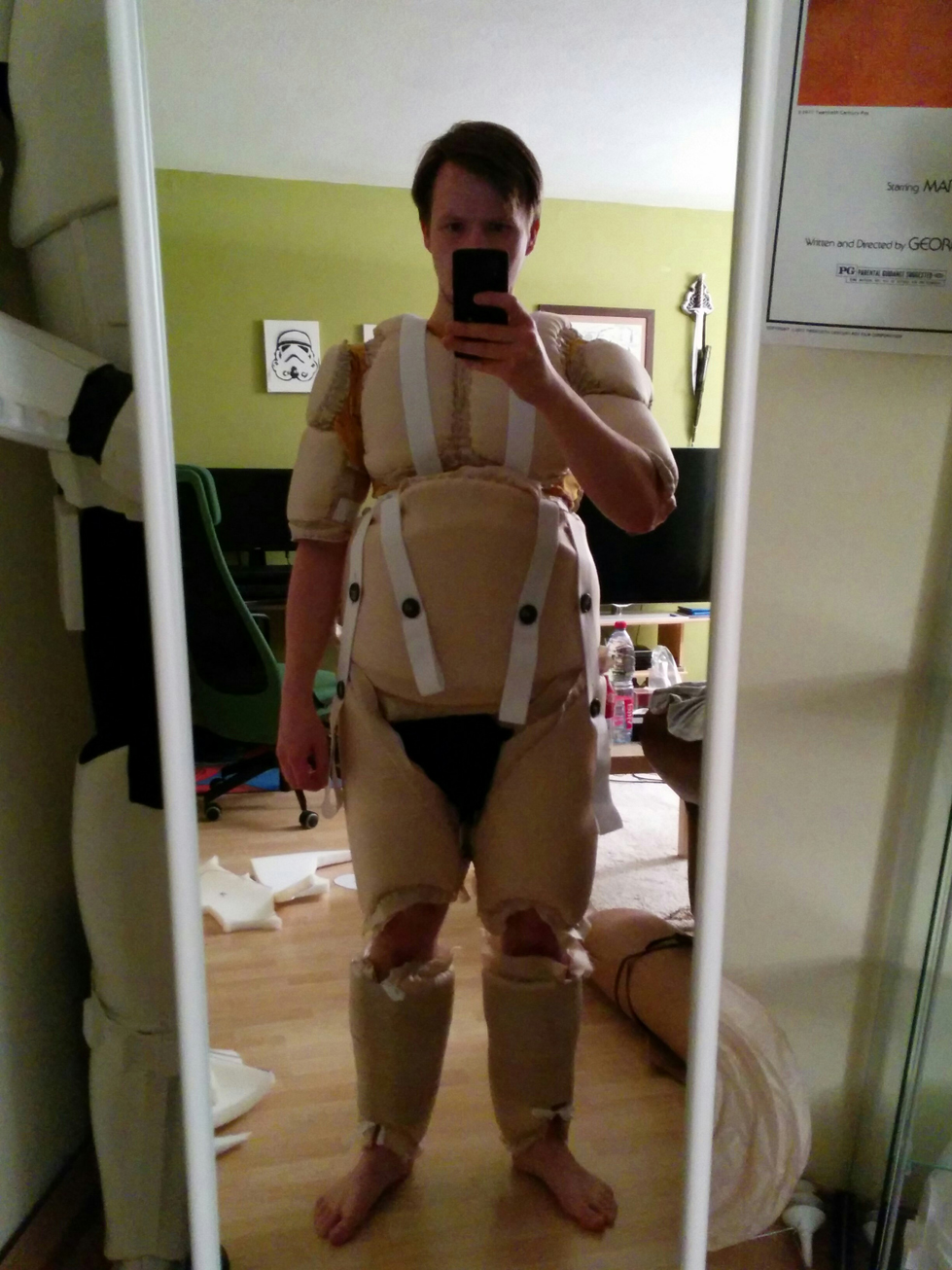

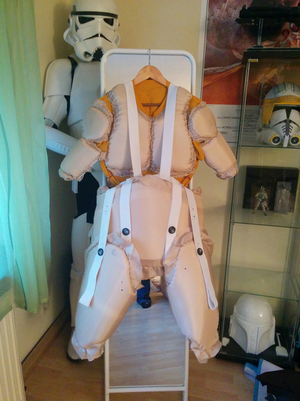

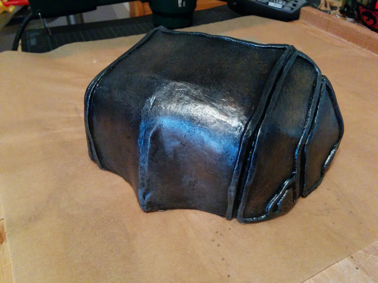

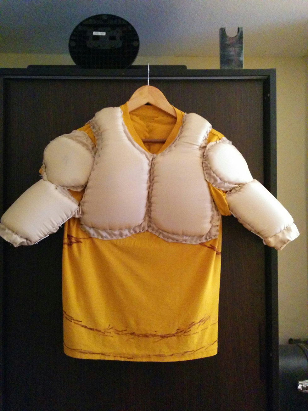

    Fatsuit is almost done, here's the torso and upper arms
    Calves, thighs and belly are done as well, but I ran out of white elastics and without the harness holding everything together I can't take a good pic of the whole thing.

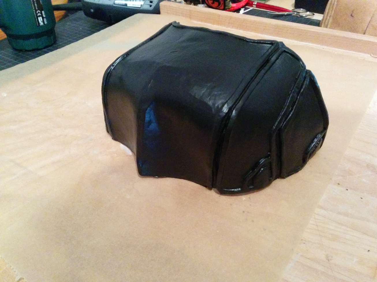

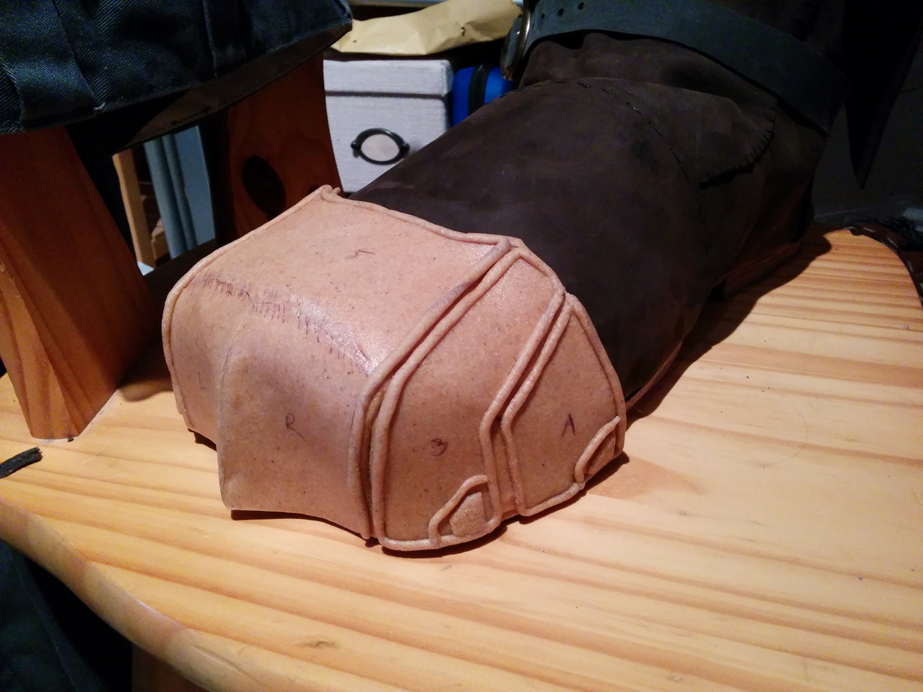

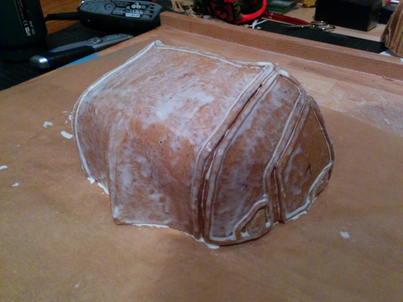

    Also worked on the first armor part, the boot caps
    I'm not really satisfied with the ornaments and still have to flatten them down with the dremel tomorrow so they don't look so round. Still don't think that's a good method for the rest of the armor.
    Any ideas on how to get sharper ornaments ?
  9. Guri
    Guri Sr Member
    Trophy Points:
    2,206
    Re: Dwarven Warrior of Moria - The Hobbit
    Is that worbla? What tools are you using? When I was using terraflex (similar stuff) I would heat it and then use plastic sculpture tools to get the details. Takes a long time going over it may times - and sometimes I used a glue gun tip to heat it up too.
    I think if I wanted it sharper I would use some sort of metal too press against it, like a knife or a spackling putty knife - something that would remain cool when it was pretty hot so that the plastic wouldn't stick to it as I was forming it.
    I haven't done this, so test it - just saying that's what I would try if I wanted a sharper edge. :)
    If that's not warbla, then nvm :D
    Zalkegeroth likes this.
  10. Karol
    Karol New Member
    Trophy Points:
    17
    What's the fat suit filled with? Poly or cotton batting?
  11. FrontaLittle
    FrontaLittle Active Member
    Trophy Points:
    262
    Yep, that's worbla. Will try using some metal tools, also thought about using 2mm ABS for the details.
    Thanks for the help, Guri.
    Karol: the filling is poly foam. I might add some granulate or sand to the belly to give it some weight though. The fatsuits they've used in the movies along with the harness look as if the pieces were quite heavy

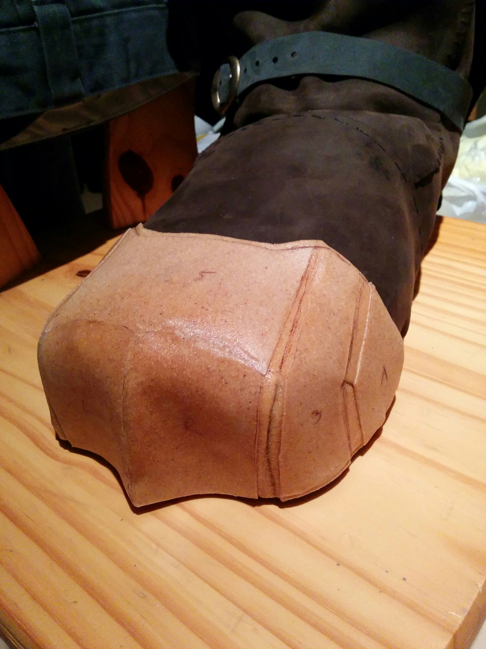

    Fatsuit is at 95%. Still need to do the forearms and close the outer seams but I'll have a friend of mine help me with her sewing machine instead of doing that by hand as well.

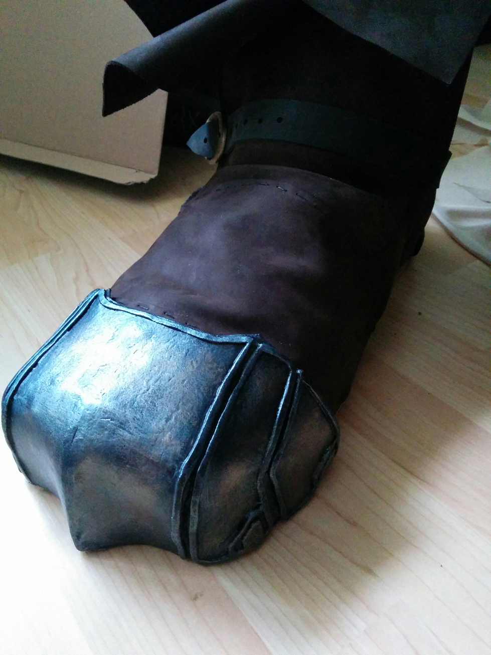

    I finished the first boot cap to check if I could achieve something close to the dwarven steel look. Decided to go with 3 layers of wood glue, black primer (duh) a major layer of drybrushed silver and a minor layer of drybrushed bronze.

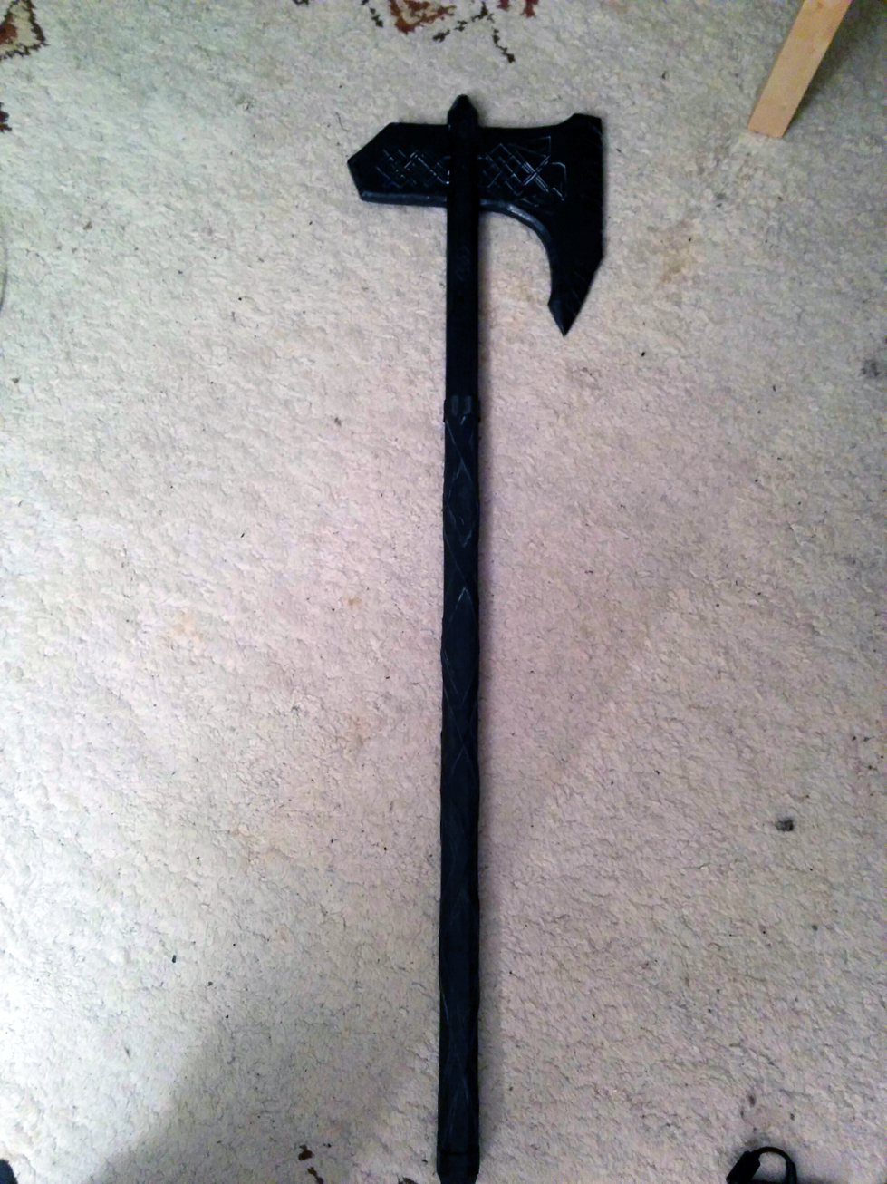

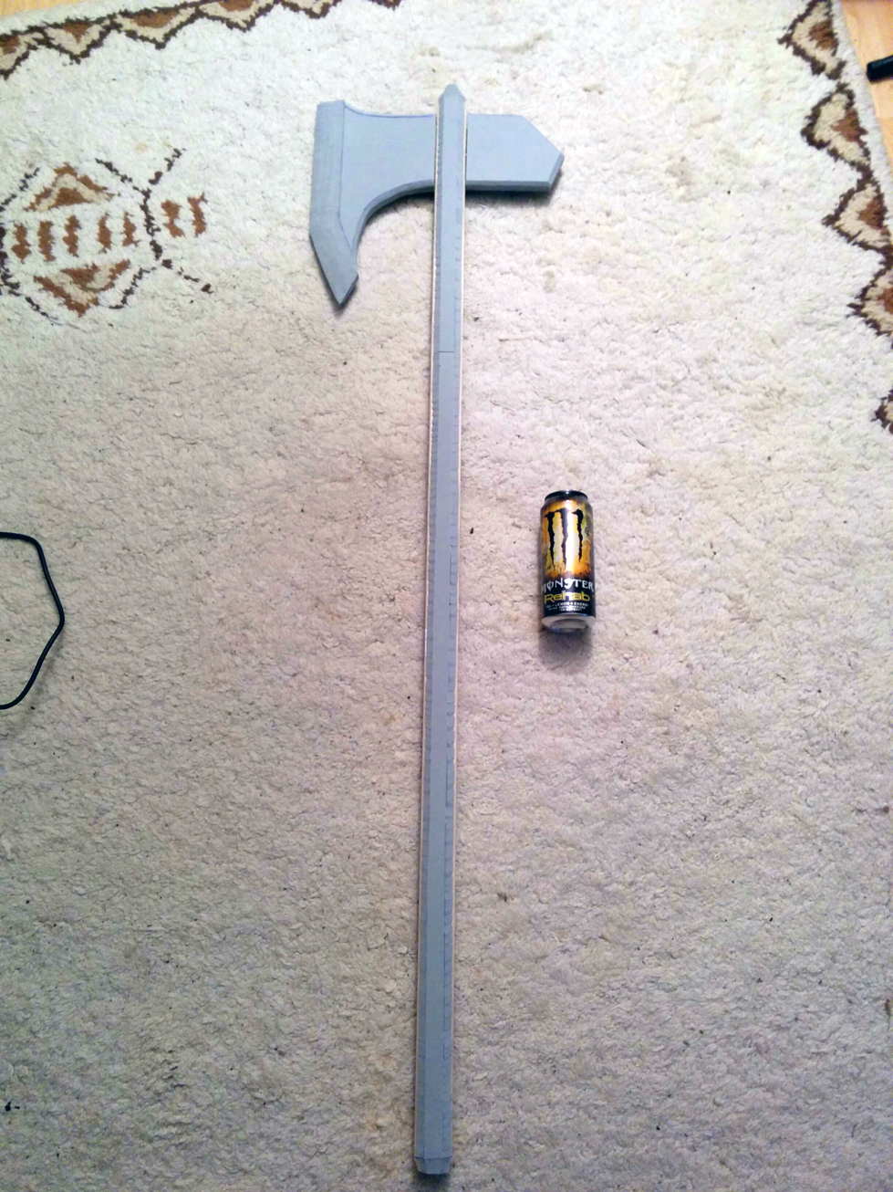

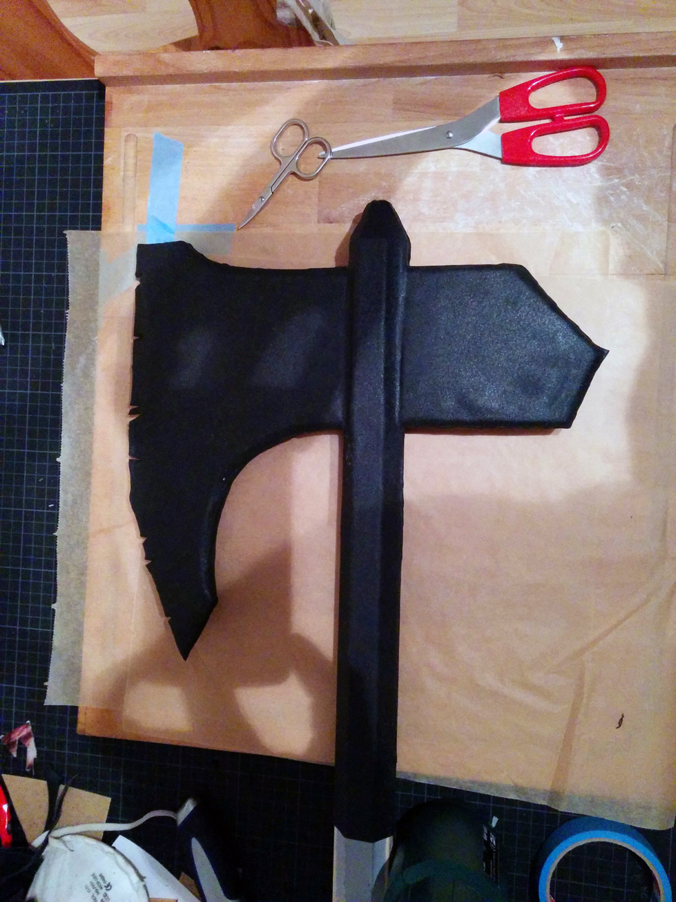

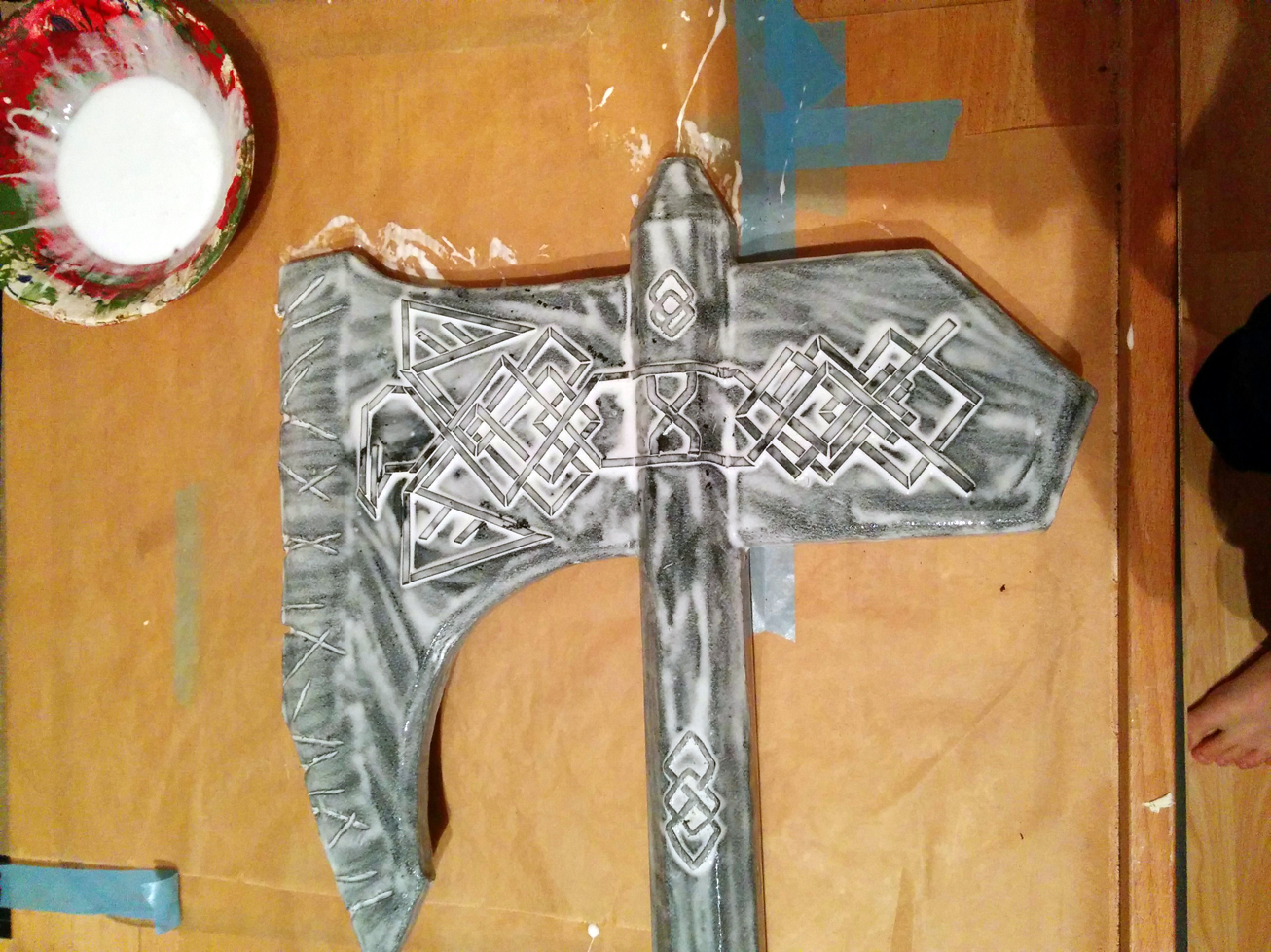

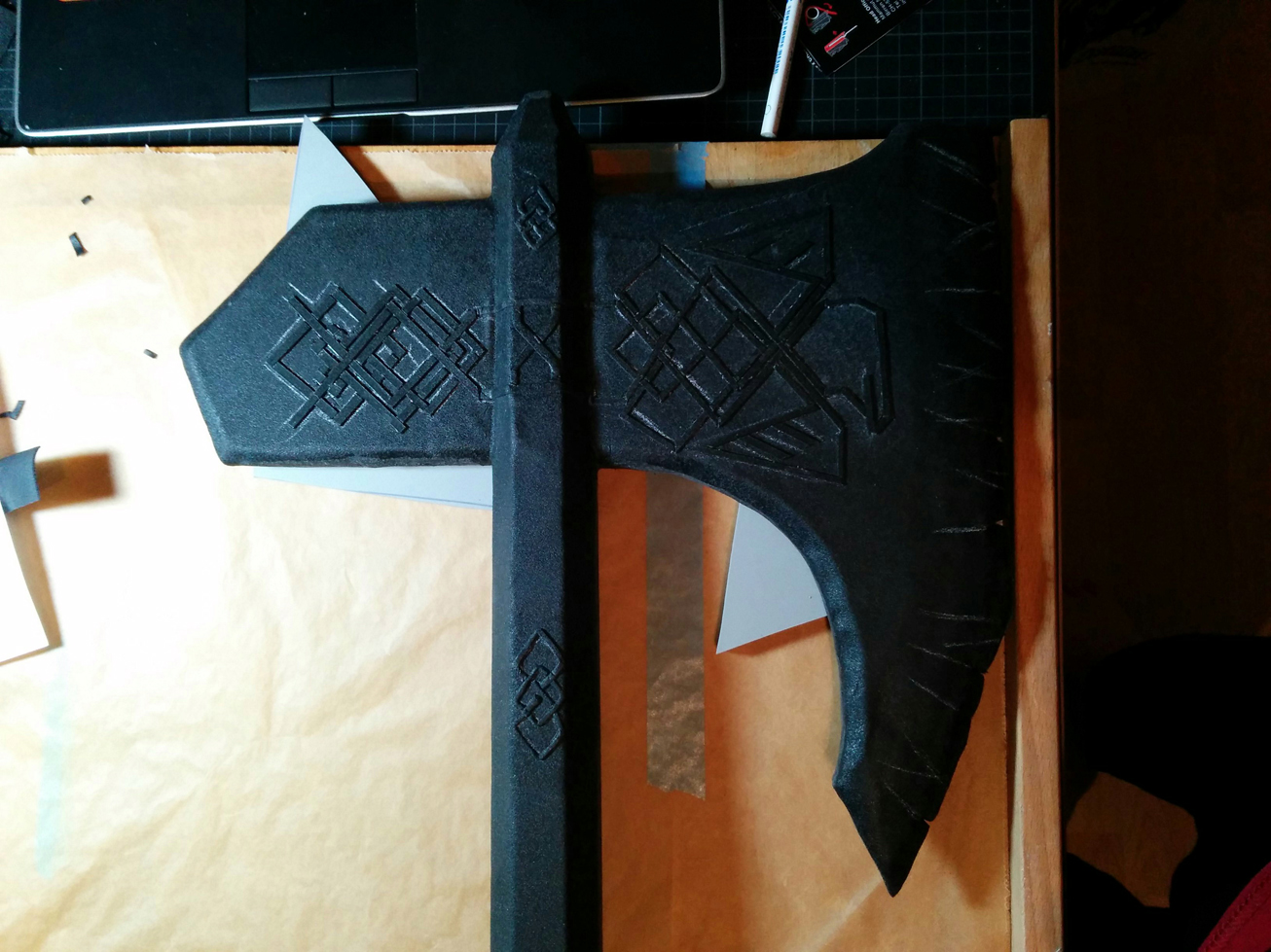

    Back from vacation in wonderful Colorado and down for some anti-orc tools. Picked an axe design from Weta's arsenal but converted it to a two handed version.
    Started coating the axe (wood core, EVA foam body) with the new black magic worbla.

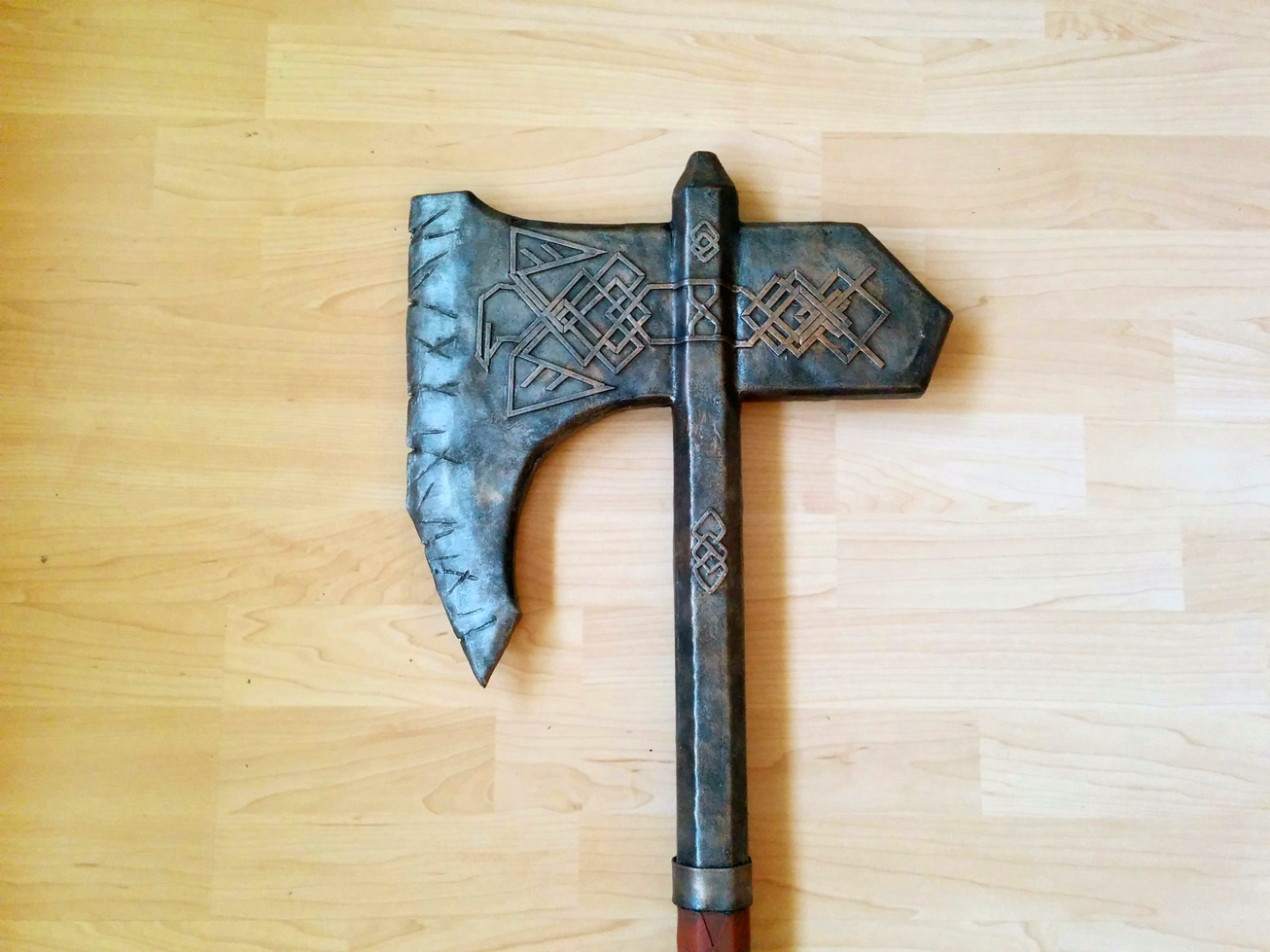

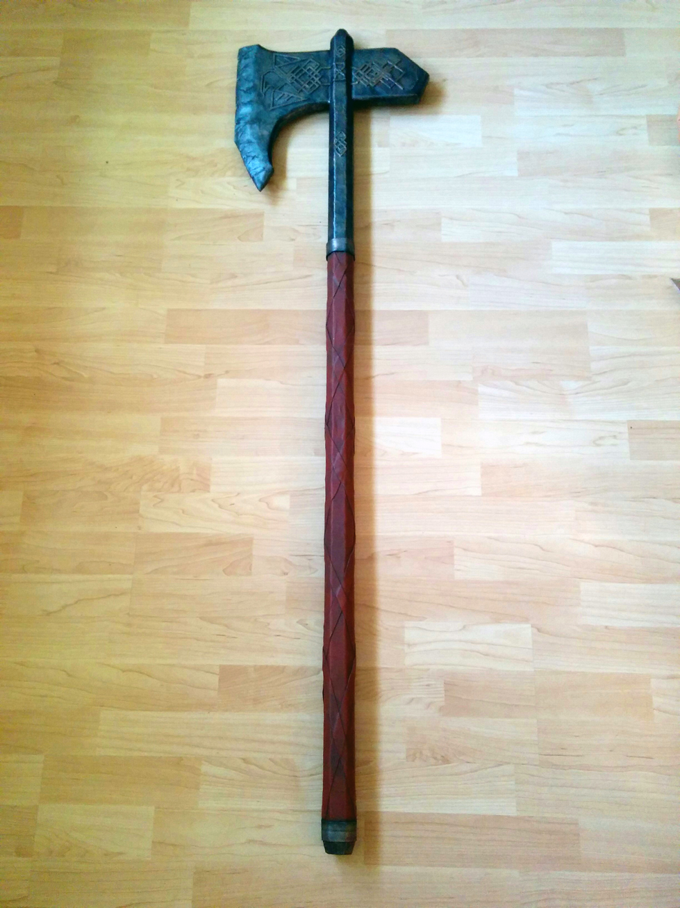

    Axe is finally done, what's a dwarf without his axe anyways ?:
    Zwilliamo, WireFox and Zalkegeroth like this.
  15. Zalkegeroth
    Zalkegeroth New Member
    Trophy Points:
    17
    Love how the axe turned out!

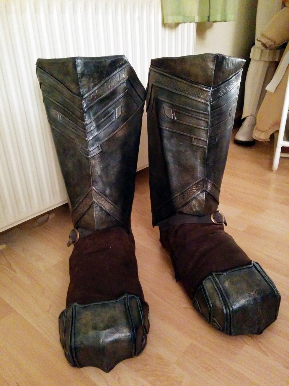

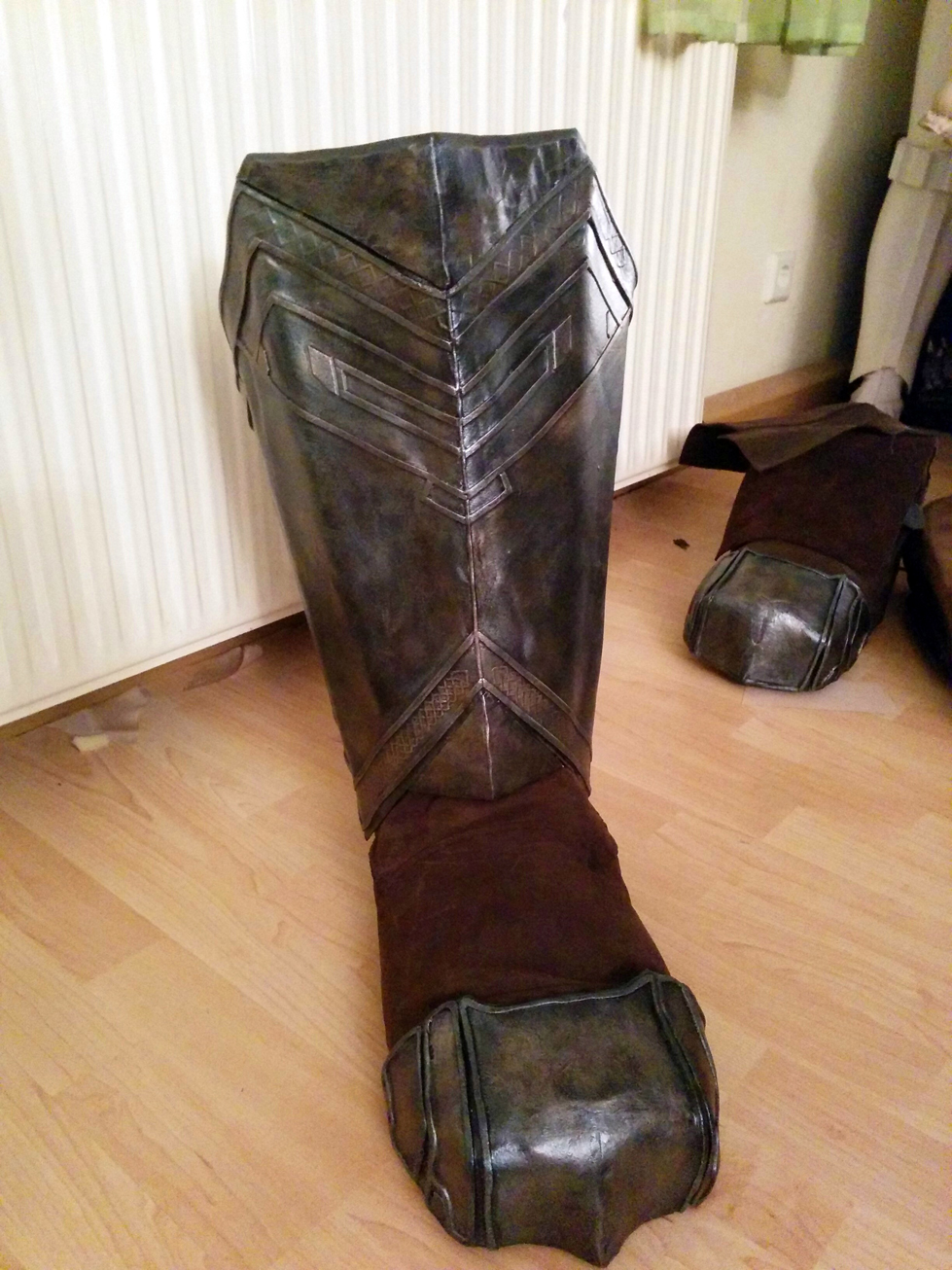

    Done with the first shin armor but forgot to take any progess pics, sorry.
    Here's one with the usual wood glue and primer layers
    And the finished shin armor attached to the boot
    Big thanks to Eloquiell who shared his knowledge on how to do the ornaments

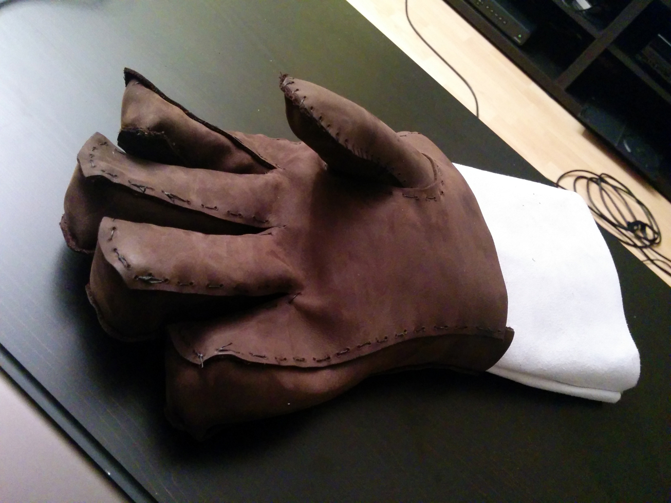

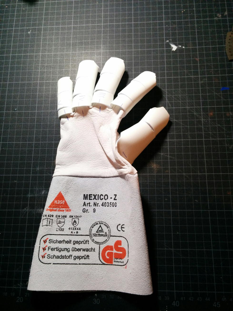

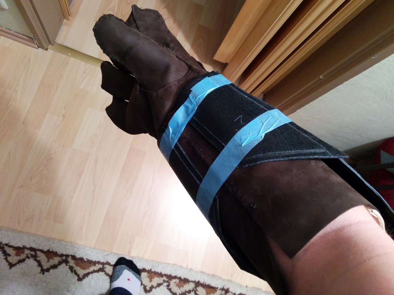

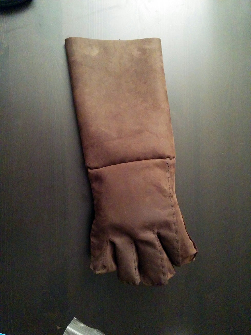

    Update after the holidays:
    Boots are almost done except some bending and weathering of the leather.

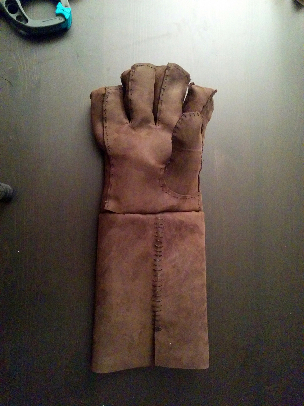

    And the first glove and gauntlet base:
    gloves_01.jpg gloves_02.jpg gloves_03.jpg gloves_04.jpg gloves_05.jpg gloves_06.jpg
    I should start working on the left gauntlet, but sewing leather is not my favourite past time activity :angry

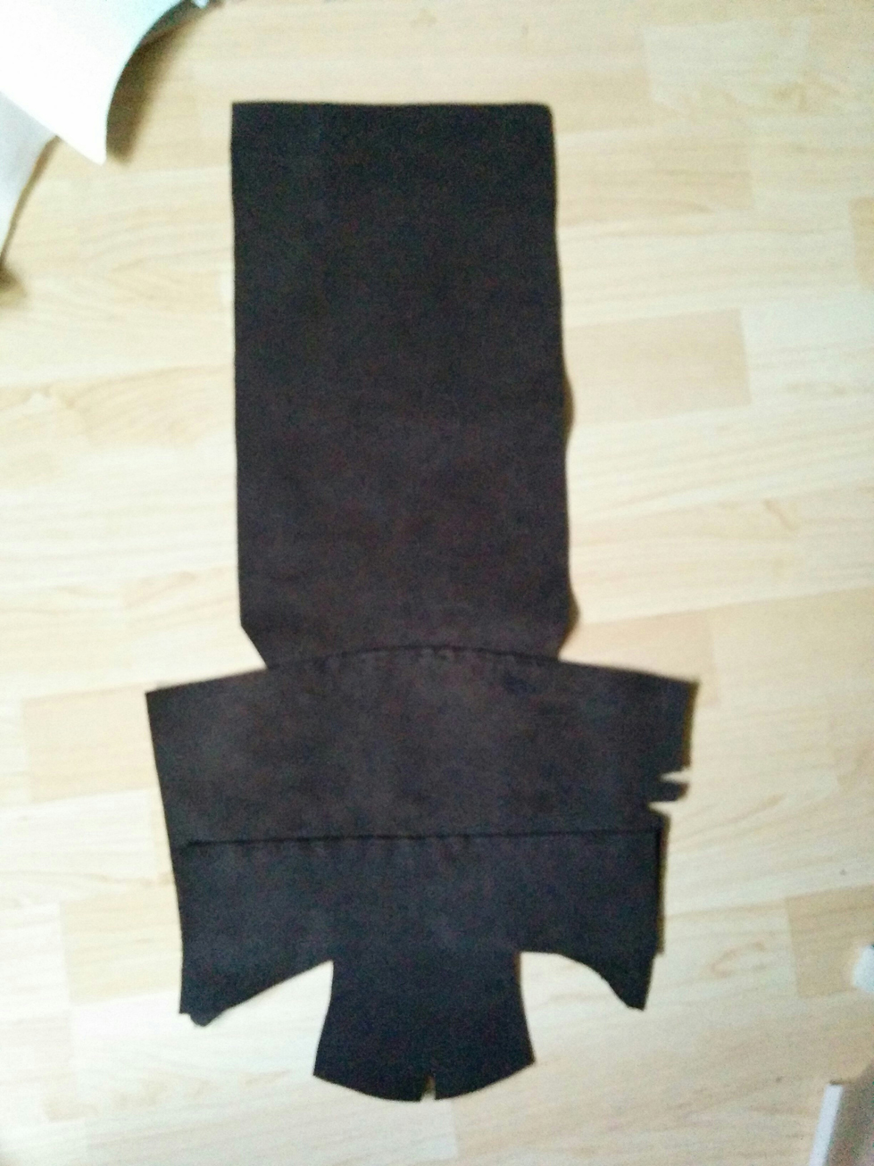

    Thanks. Though I'm getting worried this is the wrong adjective for "dwarf". All the actors and crew of the Hobbit say "dwarvish", but then there's those gaming terrain makers, "The Dwarven Forge". Anyways, some updates:
    Dwarf pants !
    Boots shaped and weathered

    The painting is top notch. I'd love some more details on that process.
  31. FrontaLittle
    Trophy Points:
    262
    It's really no black magic and fairly simple. The base is black worbla and two coats of wood glue. Black worbla has a smoother surface than the old, brown worbla so two coats usually give you a smooth finish.
    The wood glue is watered down a little and the second layer of glue is applied by hitting your brush on the armor piece to achieve the look of forged metal. You won't see that effect until you start painting it, though. Credits for this idea go to Eloquiell and his build thread here
    Next I apply a coat of black foundation, currently I'm using Reeve's Acrylic Paint in "Mars Black" but I've also used Abadon Black from Citadel (Games Workshop) and black primer spray paint from my local hardware store.
    Next I dry-brush the silver on. You want the silver to cover most of the ridges and grooves, black should only remain in the very deep ridges here and there. The forged metal look I mentioned earlier should be visible now.
    Last step is dry-brushing bronze on the armor piece but try to stay away from any ridges, grooves, etc. The bronze should accompany the silver, not dominate it.
    I hope that description helps. I can't really explain the details or the exact paint distribution, it's more drawing by the eye and some practice I got from painting Warhammer miniatures.

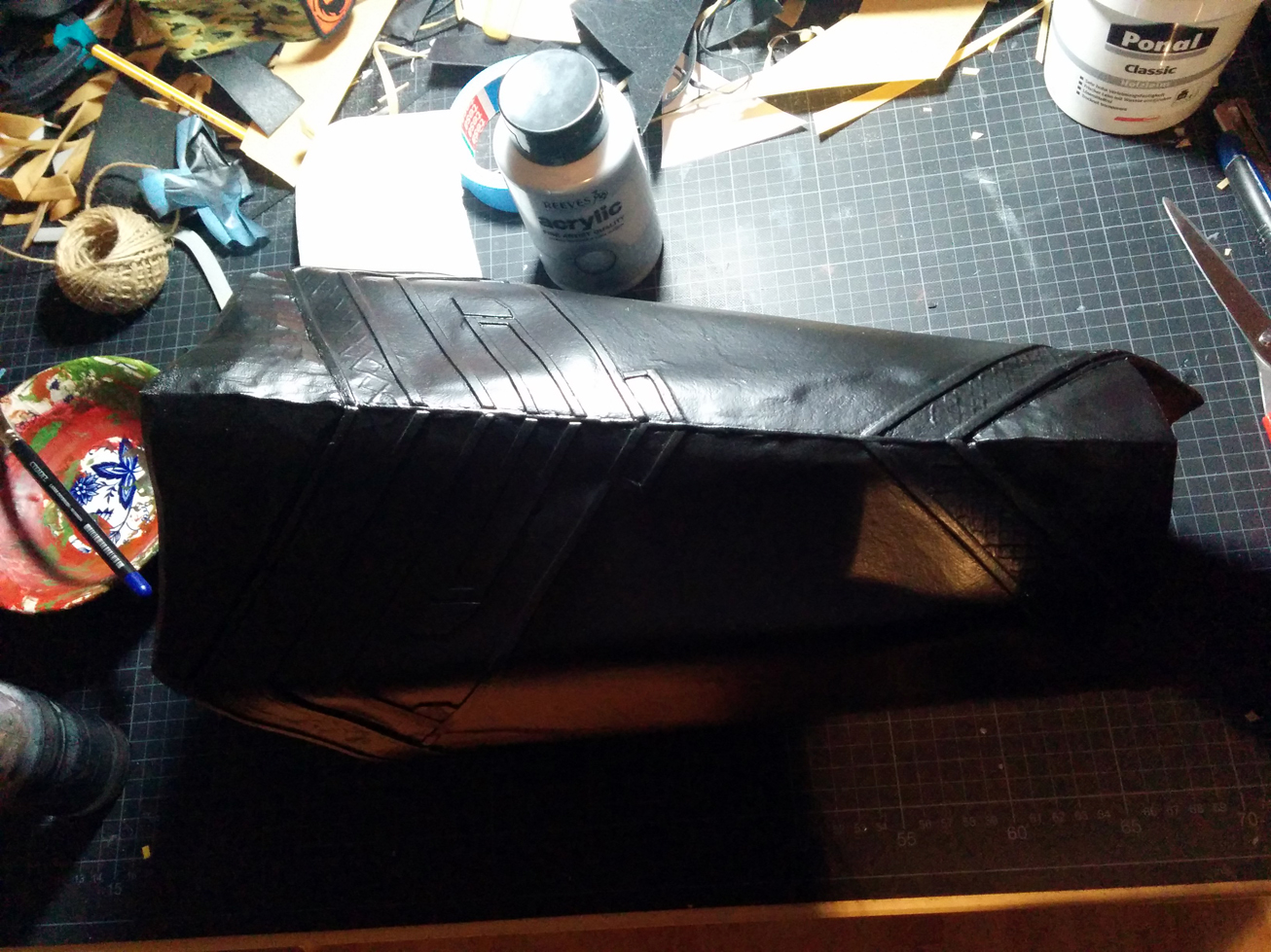

    A little update, though you don't see much thanks to the light-swallowing blackness of the worbla.
    Here's the finished armor foam core:
    And here's the front armor with the ornaments I did today after I coated the whole thing in worbla and sanded down all the seams.
    You don't see much though due to the black worbla and the sanded areas reflect more light than the ornament edges so it all looks kinda messy.
    While I love black worbla I gotta say it's a pain in the butt once you've reached a certain size with your worbla pieces. The pieces on the torso became almost uncontrolable, warped in every direction but the one I wanted it to go and once you have one area under control and you want to move to the next area, the worbla there is already too cool to work with. Made me angry. Any hints on working with larger worbla pieces ? Are there any tricks you need to know ?

    All details done. Hammer, the ruined center tooth, the shoulder scales and the hip armor plates or whatever those things are.
    I'm going to apply some wood glue to the areas where I had to sand the worbla with my dremel to smooth them out a bit before I apply a coat on the whole piece.
    The colored lines are just some acrylic paint to shine through the first layer of wood glue so the 3D pen lines become sharper later on.
    On a side note: Changed the title of the threat because it sounded as if this was a warrior from Moria rather than a warrior at Moria.

    Chest plate is done. I tried to track each stage of the painting process.
    Here's the second layer of wood glue, hammered on the armor piece. That's what causes this pattern:
    Black foundation on dried wood glue:
    Drybrushed layer of silver:
    Drybrushed layer of bronze
    Next up: Backplate

    How exactly does one "hammer" wood glue???? The effect is absolutely amazing..
  44. FrontaLittle
    Trophy Points:
    262
    Re: Dwarven Warrior of Erebor - The Hobbit
    I have to admit this might be the wrong term. I adapted it from guitar playing where you "hammer on" a string with your finger. You do the same with the brush when applying the wood glue. Instead of the usual sweep motion to distribute the glue, you dab the glue with your brush but quite hard. It's like beating up your armor piece with a brush.
    HighlanderFX likes this.
  45. TheWulff
    TheWulff New Member
    Trophy Points:
    3
    Ah...so like a really rough stippling?
  46. HighlanderFX
    HighlanderFX Well-Known Member RPF PREMIUM MEMBER
    Trophy Points:
    735
    Ok that makes a lot more sense, i was taking the hammering part too literally lol.
