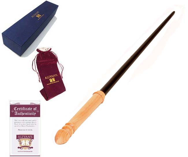

I'm looking to make some relatively professional looking, but rather inexpensive wands for some friends. I don't have access to a lathe so I thought I might be able to wrestle something up with a dremel and wooden dowel. Has anyone attempted this approach ?
My first 3 wands were made using a pocket knife and stick and I wand to do something with more of a "spun" look to it... and with less of my blood on it.
I also need any kind of advice on what kind of Dremel to get - inexpensive, but effective it key here.
This is the style of wand I'm looking to do more or less:

Well maybe if you could stabilize the dremmel and have it held down by something. Then you could run the dowel down it and apply more pressure as you reach the end. It seems worth a try. It would be hard to keep it entirely straight though. I'm hoping someone has a better answer then me, I would like to know this too for future reference.
for something like that, you might want to go the route of a lathe.

It's takes quite a bit of time to get one to look "spun" without actually spinning it.
I used some carving tools to get the basic shape of a custom one a few years ago, and then sanded the heck out of it to get it to look semi decent. Probably 3-5 hours of work and the sucker still isn't straight. It was fun to make by hand though.

you might have better luck with a sander than a dremel for the wand shape. the handle end will be easier with the dremel or a set of files, but the long taper will be a pain in the butt.
