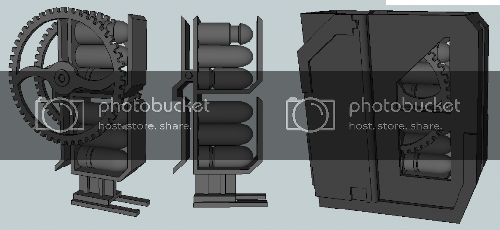

In the meantime here's a pic of another part I decided to get printed too. It's modelled off ref pics of the ammo changing mechanism they built a prototype of but never got round to using in the movie. Will simply glue into place inside the mag... More pics tomorrow :)

Andy! that ammo mech is a genius touch! good work sir! I planned to have the cog in mine (if it ever got finished) as everybody seemed to ignore it's existence
Nice one :) thanks very much. After seeing the pics of the mechanism it was nice and easy to replicate the ammo and cog, I took some liberties with the frames as the ones in the photos as you've seen were very basic so I tarted them up a bit lol. How is your lawgiver build going? Last I saw you were looking into getting some casts done, is that still on the cards?

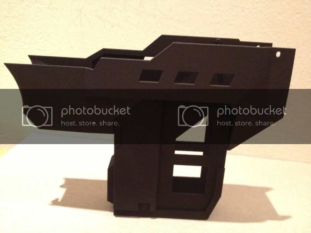

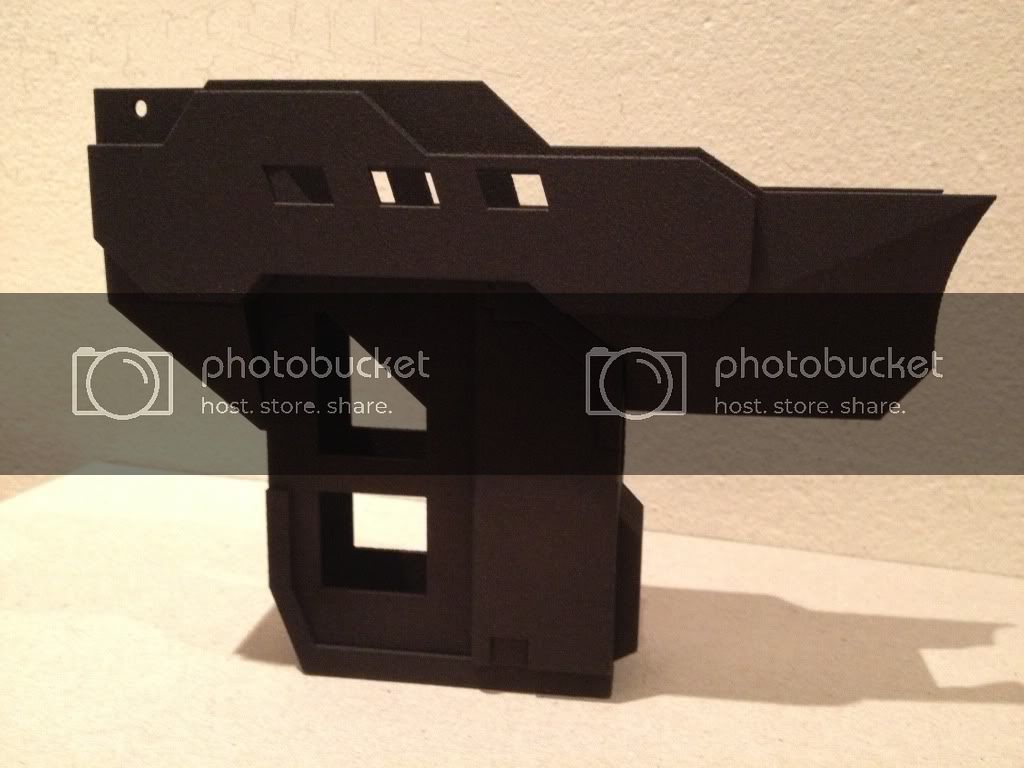

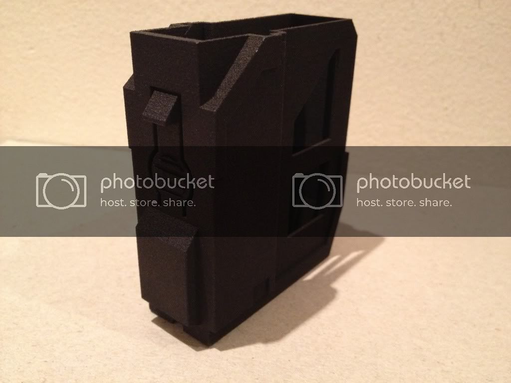

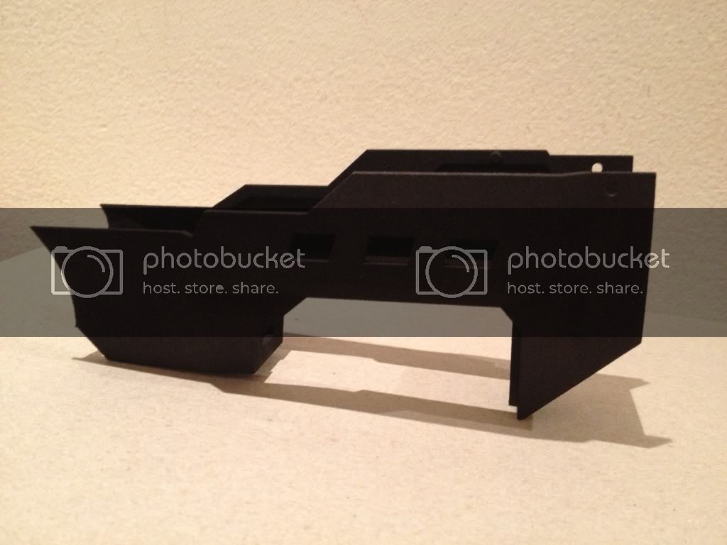

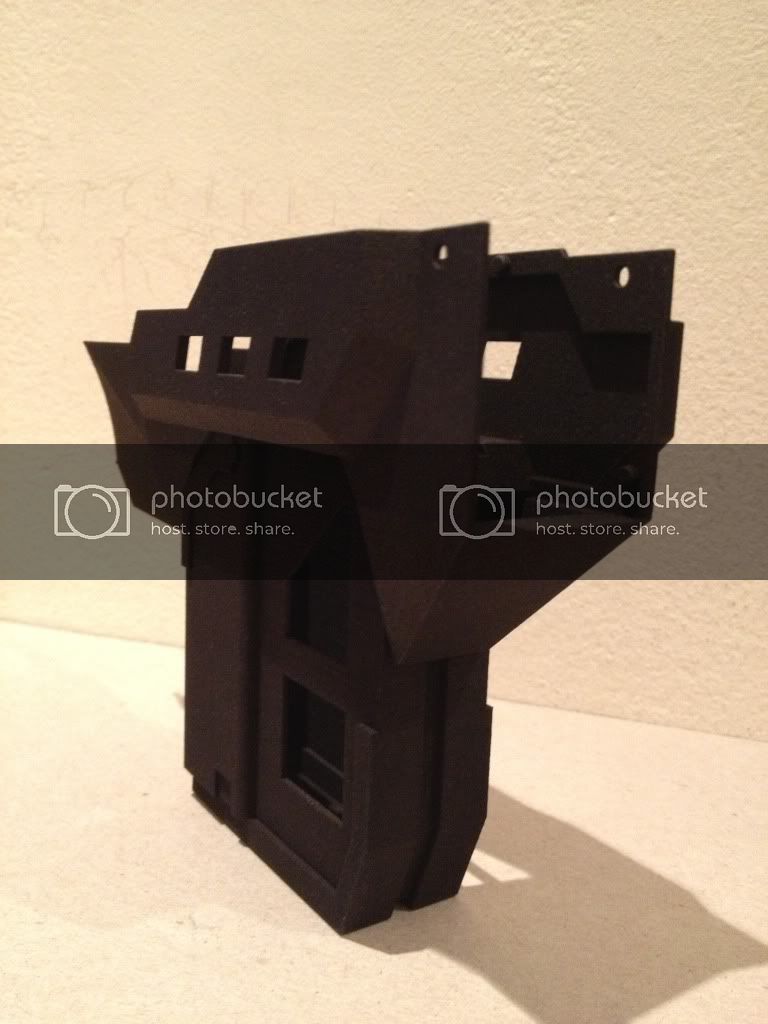

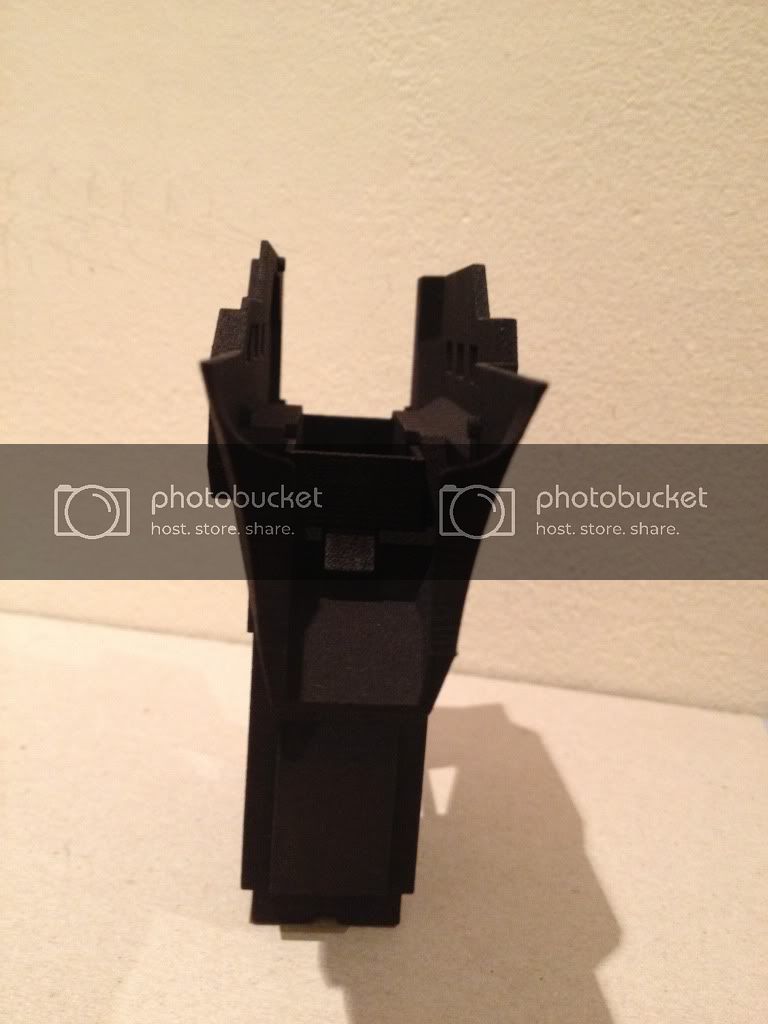

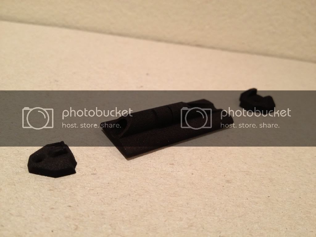

Had a new package today with more prints, Loving them so far. Got a stack of new photos so here we go...
The sights...

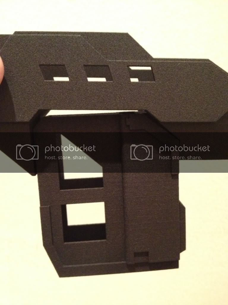

The beefed up mag with the now working clip...
Mag well...
Both together...
And finally the only thing I'm disappointed with, although the clip works perfectly I need to tweak the front of the mag/mag well so it locks in solidly. Thinking up a solution to that one right now...
The sights...
[url]http://i1182.photobucket.com/albums/x441/andycooper82/5C2E515F-D871-4A58-90EB-8F711D492DDA-2786-000005C8FA1DA3D8_zps257bf824.jpg[/URL]
Mag well...
[url]http://i1182.photobucket.com/albums/x441/andycooper82/531DF29A-B484-463C-B3BE-AB05A90C7F3F-2786-000005C9010B3877_zpsd647f643.jpg[/URL]
[url]http://i1182.photobucket.com/albums/x441/andycooper82/5F748799-39F3-4E2B-8B58-CE8FD4CECF2A-2786-000005C9065C5AAD_zps3519b55f.jpg[/URL]

Don't know if this would work, or help in your situation, but my Joe/Morgan 13 Lawgiver I modified with two rare earth magnets opposing each other. One in the mag, the other in the frame. Works great. It won't drop away like a real mag but easily releases with a tug.
My master copy is assembled the exact same way.
