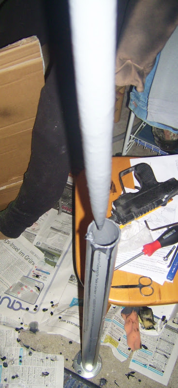

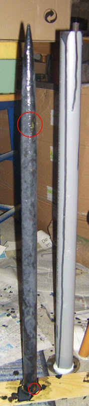

I did mine as follow:
Take a round wood and edge it to the shape of a dread.
Take a pipe a bit longer and a bit wider so it will fit the round wood.
Shift your black latex into the pipe... I wood say 1/4 and thrust your stick into the pipe with latex. The latex should come up till it reaches the top of the pipe. Now get your stick coated with vaseline, so you can remove the dread later easily.

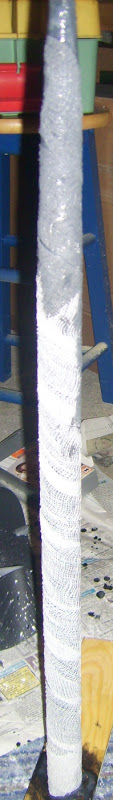

Dipp your stick into the pipe as long as you have 3 or 4 sheets of latex. Now, to get some support for the dread, roll some gauze bandage around your latex stick.
After that latex again. 2 times should work.

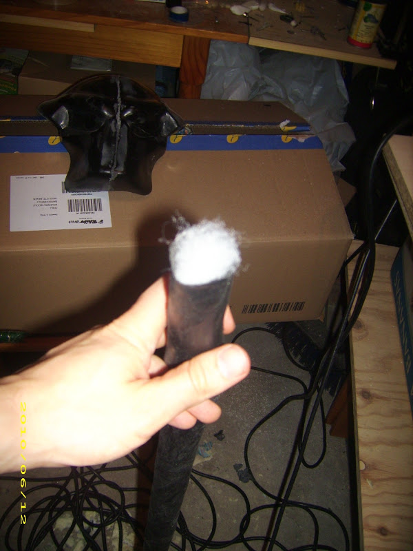

As it is dry, remove it from the stick and fill it with synthetic wool. Don't use normal wool!
