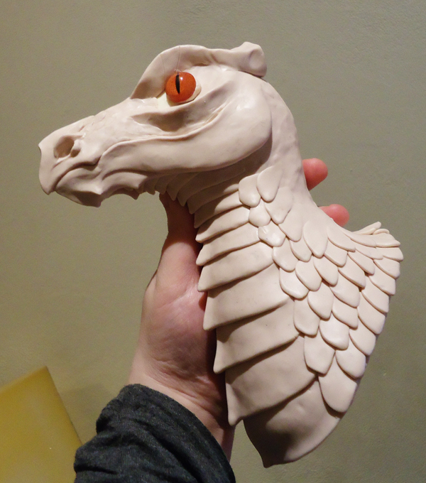

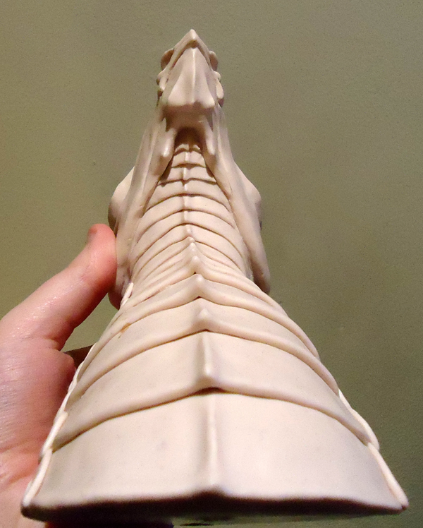

Haha! I hate how you can work on something like this for hours and hours and it looks like you've done nothing at all! Finished off the belly/chin scutes, refined the jaw shape and fixed some symmetry flubs. Still trying to figure out how I want to bulk out the head and add cheek spines or webbing, and have to sculpt the horns. Everything else is just playing. This is fun but painstaking!

The eyelid is just for my own reference, got to take the eye off before the thing bakes. Makes it look so much less derpy though!
Now more scales scales scales scales etc.

Naww, this one's the pretty one! I have plans to make the other one a toothy, heavy jawed brute of a thing though, so that one can have the craggy bits. This one's clean :)
