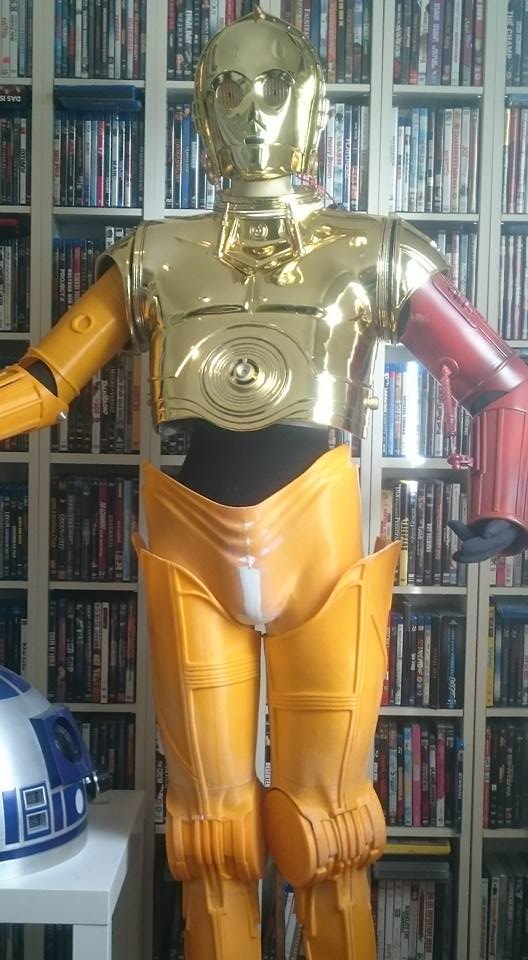

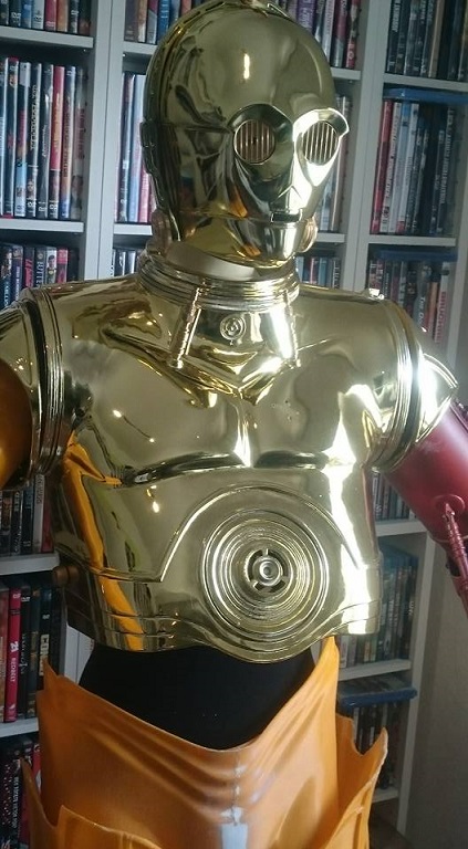

I'm bumping this thread because its fantastic, and also because I'm 3d printing a threepio and will prob need to come back to it alot.
And also because its old, 10 years old :)
Thats great fraaank :)
I'm assuming you already had the gold bits? Are these the files from thingiverse?
Thats great @fraaank :)
yes arms, legs and shorts from thingiverse..but have chest ect from thingiverse too, but on pic are fibreglas stuff from a friend..i think helmet is better when take a fibreglas head. but rest is good to use..
