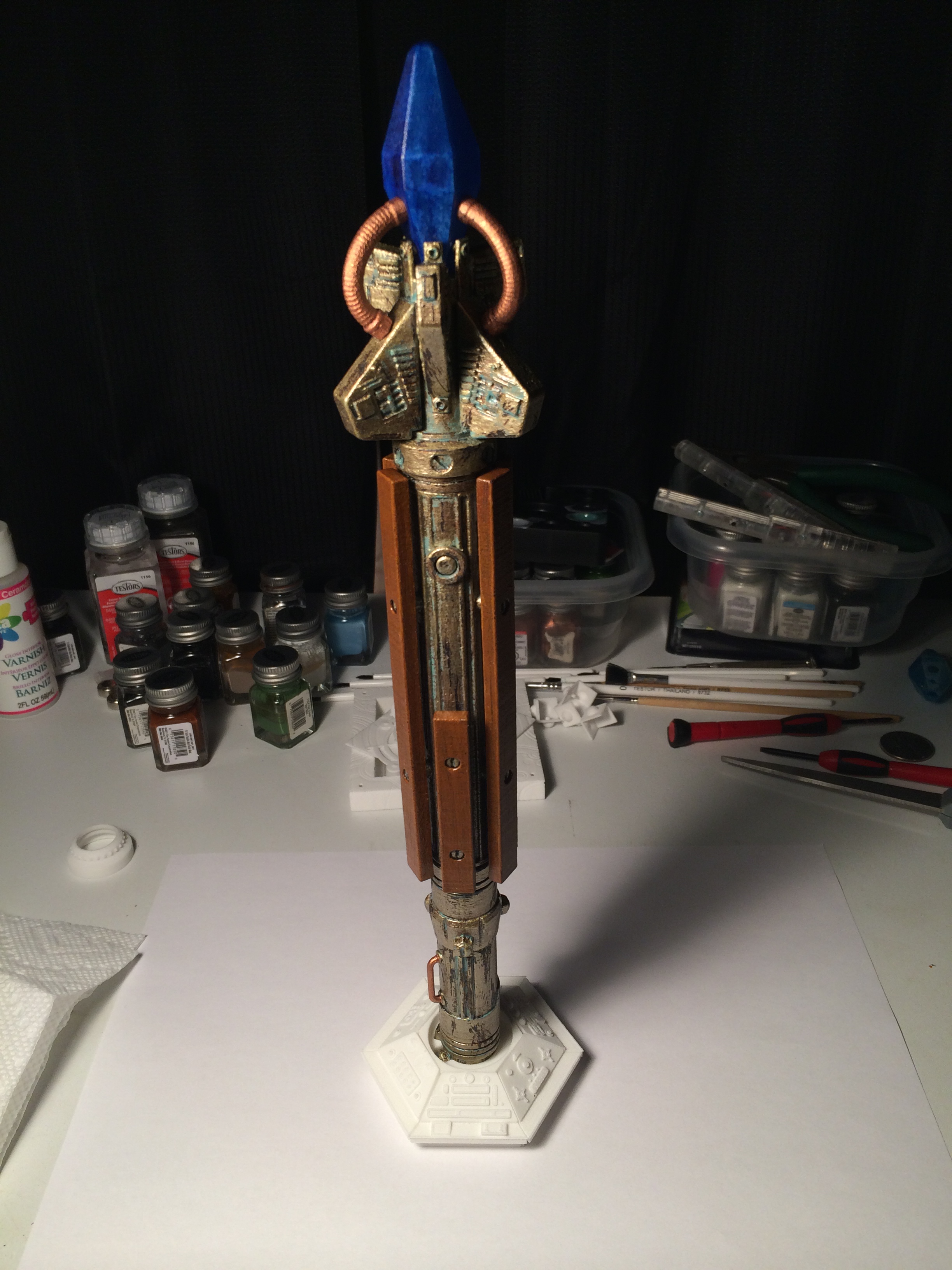

FYI to those who want to go 100% accurate - get good at applying gold leaf and gold foil to tiny corners. That's what gives the sonic the battered look at various conventions, bits of leaf falling off. Since mine is going to be handled a LOT with the console at shows, I ended up putting an aluminum structure and pins between all of the pieces, adhered it all together with silicone, and simulated the gold leaf look with about eight coats of transparent acrylic paint over a rub-n-buff type gold, over a Krylon aluminum spray which gives a metal cast look. Depending on how well it survives Gallifrey One next week with the current paint job I may do a little bit of spot cover on gold leaf.

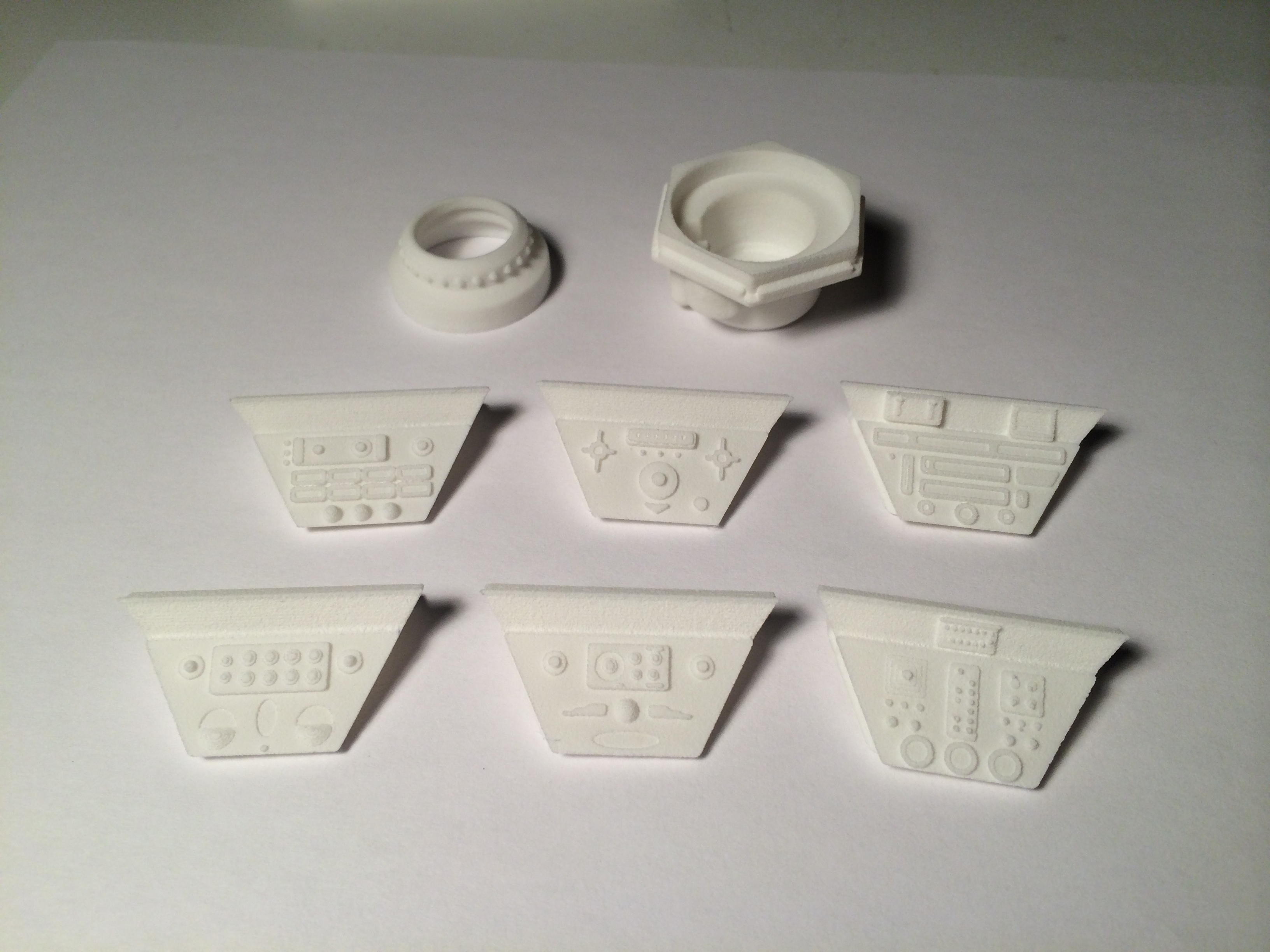

I've already cleaned the parts, I'm just waiting for them to dry. I'll post photos of the raw prints later on and attempt to finish the 8th Doctor stand tonight, but I'll probably also do some work on the Moment stand while I wait for coats to dry. My plan is to mix up some extra resin I have to fill the stand from the bottom once it's painted and assembled to add some weight to it, but I'll see how well it holds the sonic without it as well.

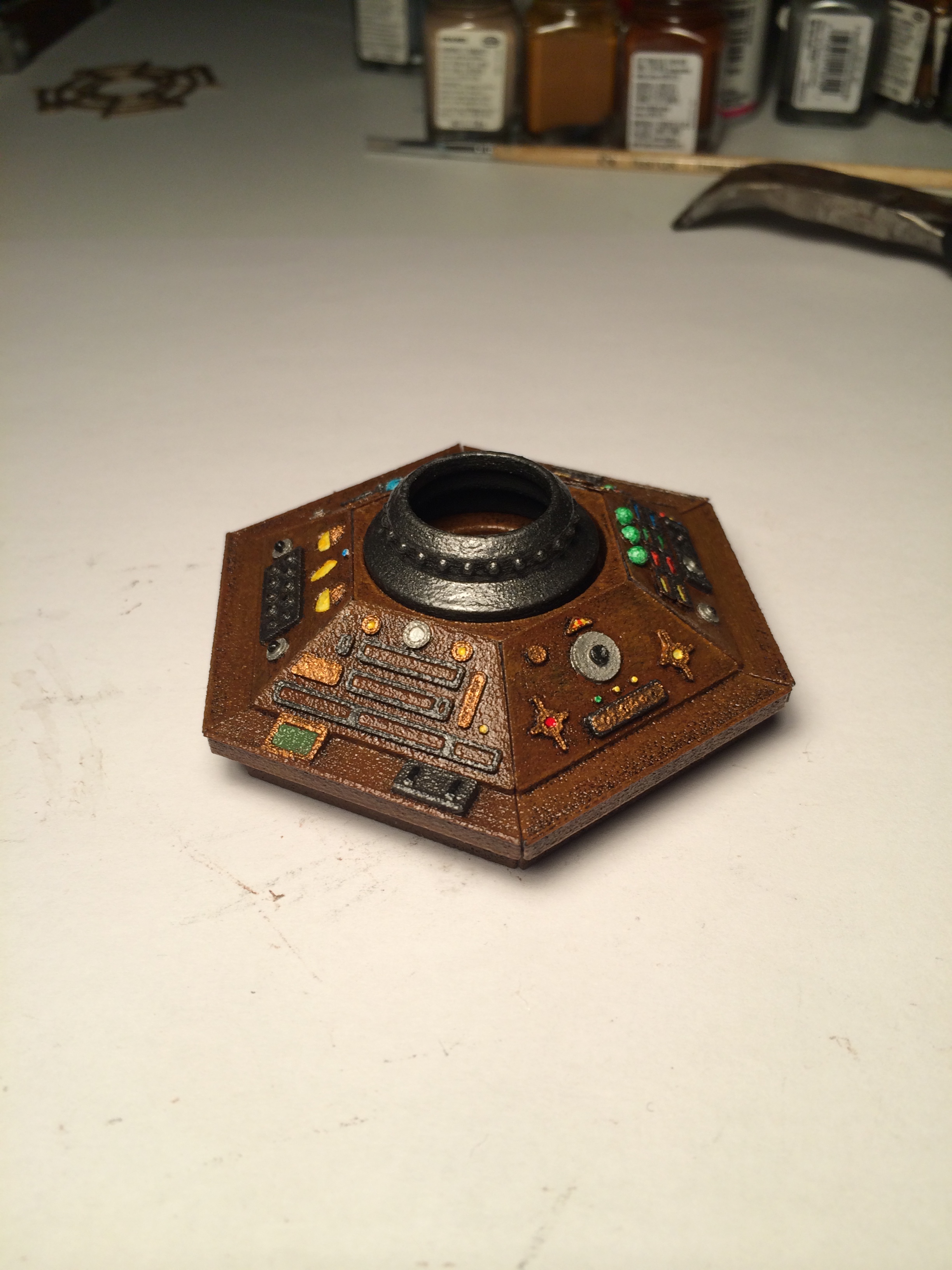

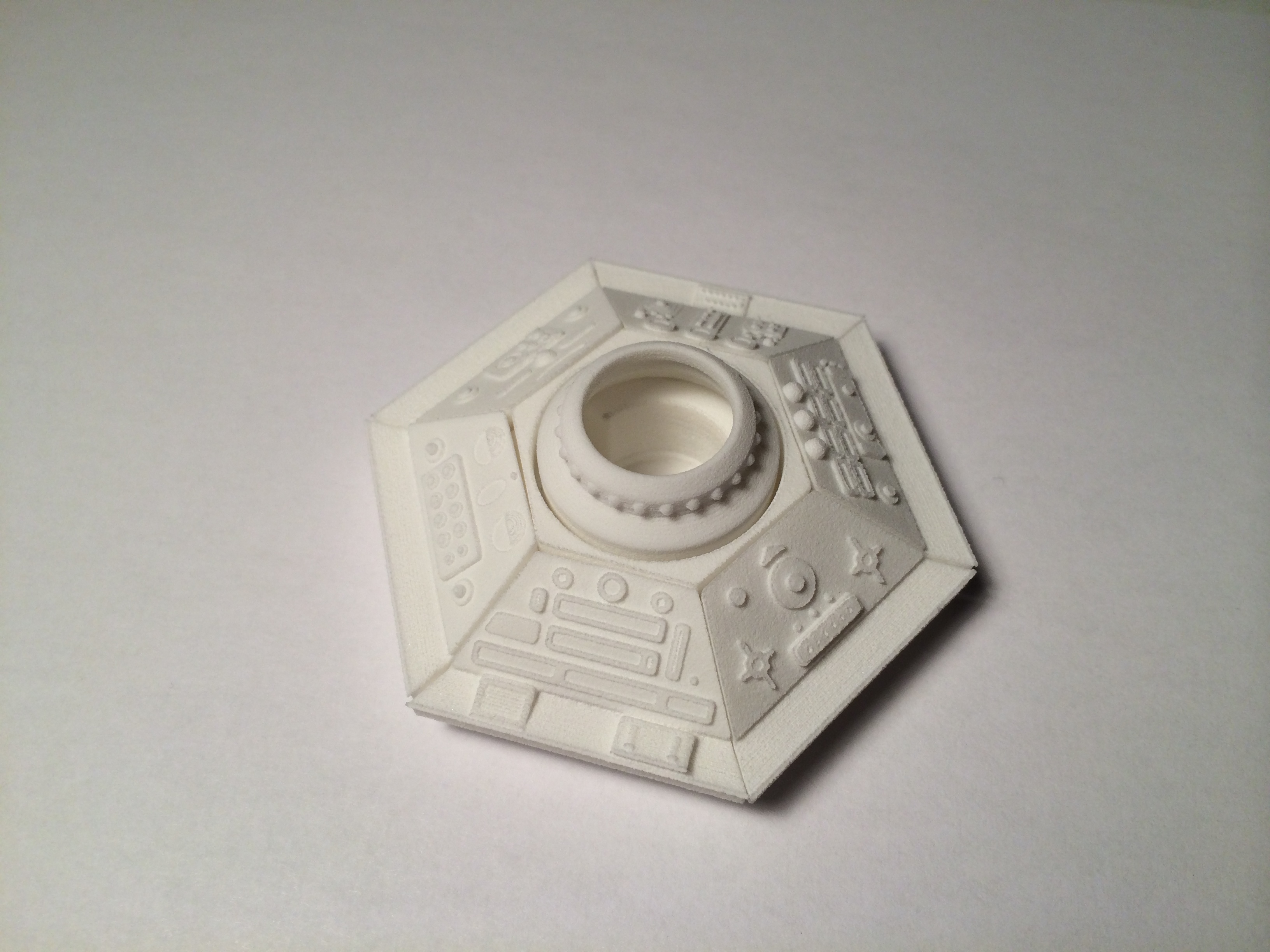

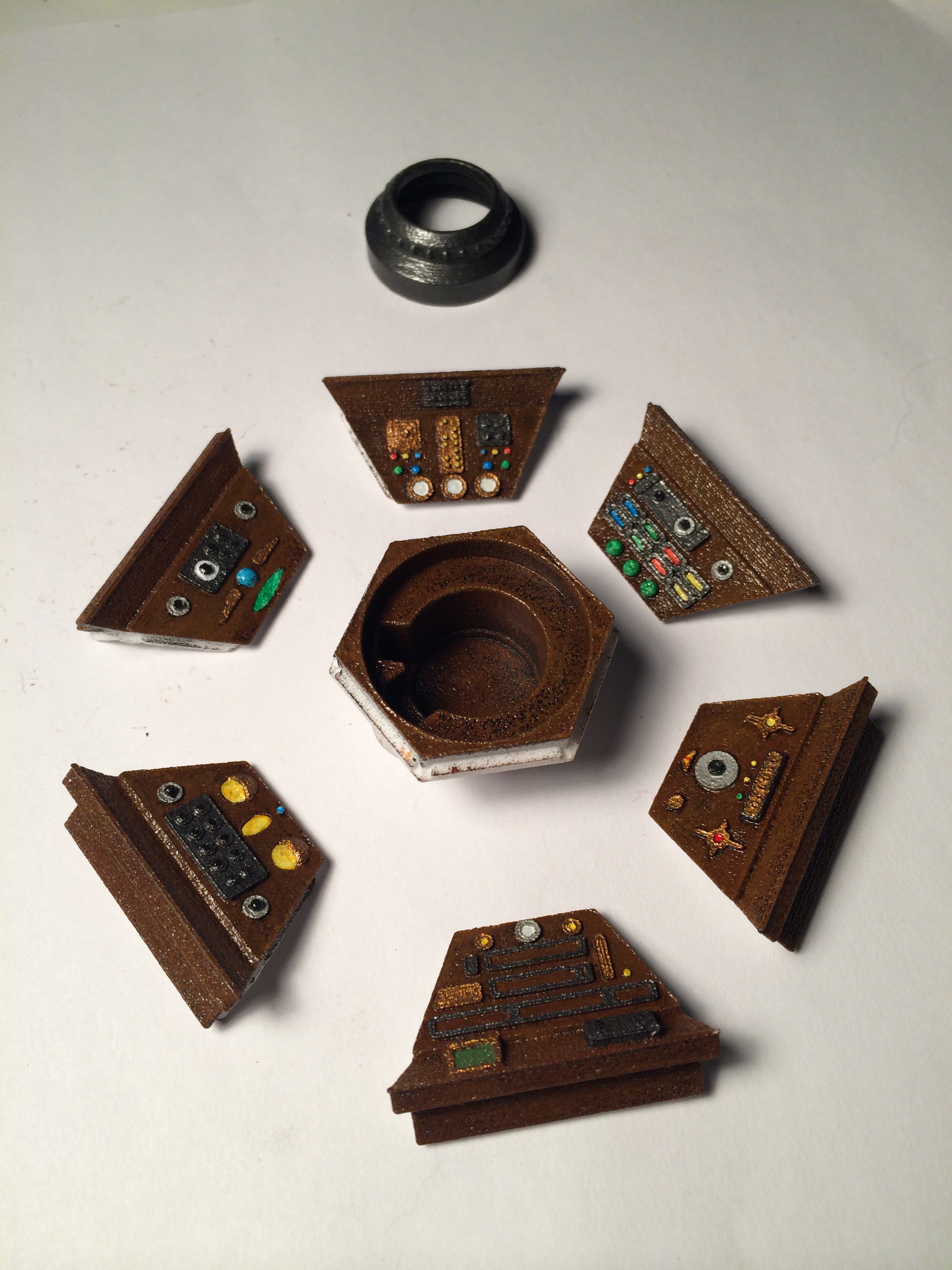

Alright, here's the stand! First in pieces, then 'assembled' and finally with the sonic in place. I'm going to paint it up tonight and hopefully have something to show tomorrow.
Aaaaaand it's done. It's currently sitting upside down with some resin curing inside of it - apparently there was something wrong with the part A mix and it's acting funky. No matter, I'm not casting anything with it, just using it as filler, so once it hardens it'll be just as well.
Here it is first in pieces, and again fully assembled. I attached the first three panels using the center section as support, then attached the center section followed by the other panels.

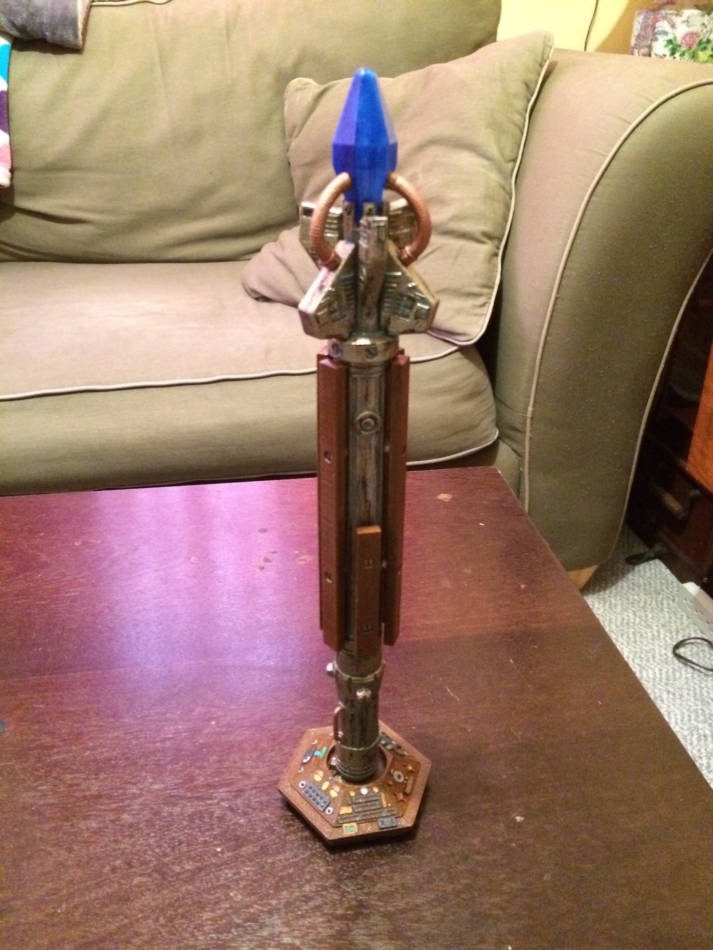

For the lights, I first painted them with flat white, then added a coat of Tamiya clear paint. Once the resin cures, I'll post another picture of the sonic in the stand but with the post-paint test, it's a perfect fit!
Here's the display stand with sonic in place!

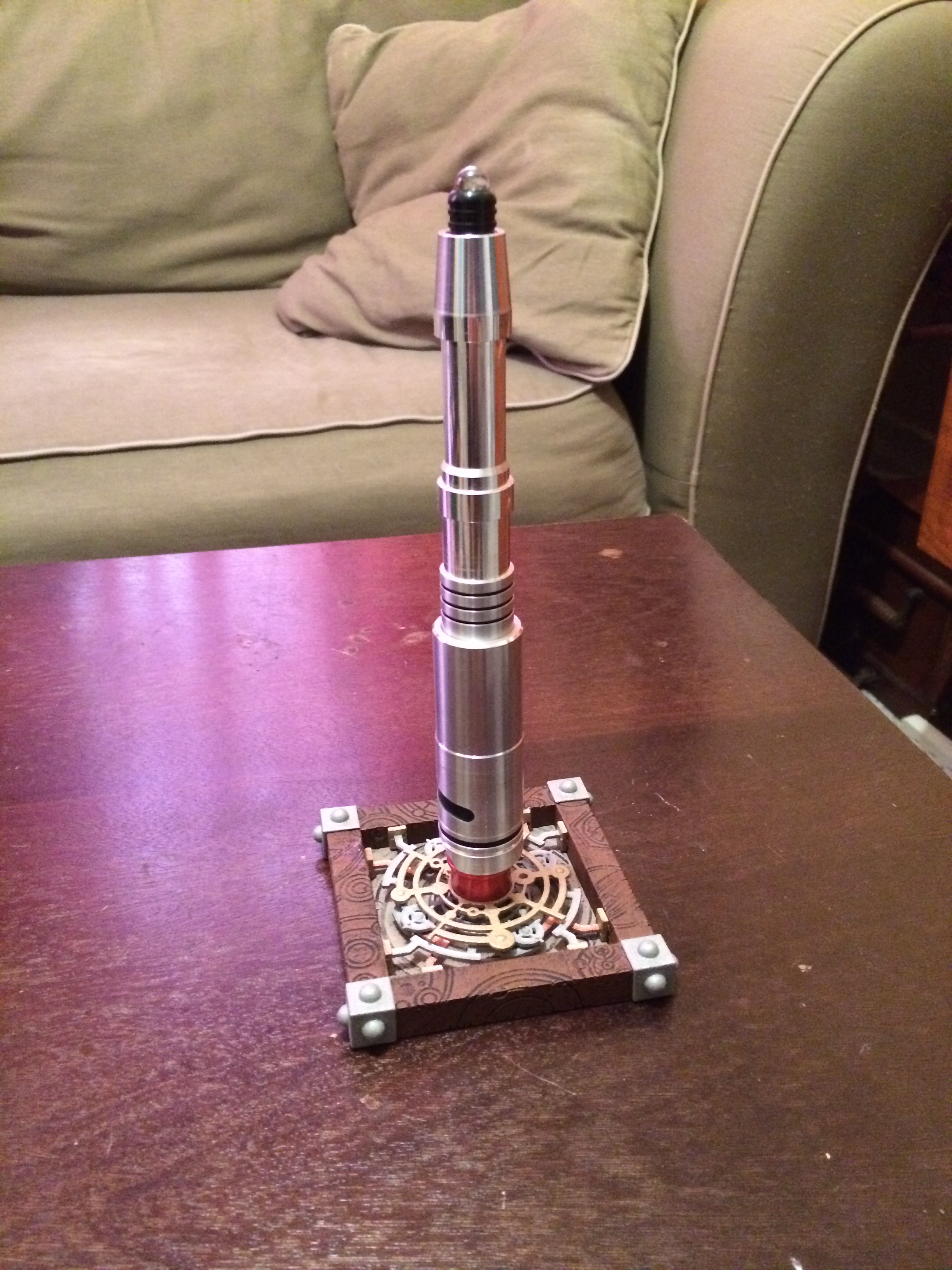

Also, if anyone here is interested in adding a display stand for their War Doctor's sonic (Russrep or CO toy version), it is available now for $40 and it won't add to the shipping costs. Here's that stand with the sonic in place.
