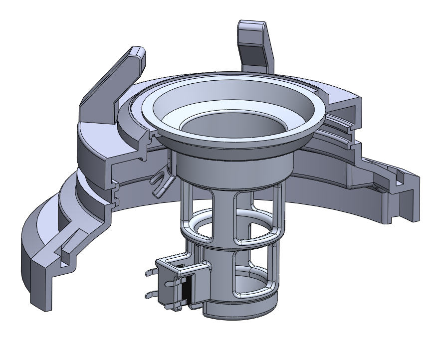

Here's a better look at the housing for the push switch (with model of the switch in place to show how it fits). I cut out material around the inside of the portion that holds the sonic and made the fitting for the push switch so it holds it perfectly in place with a lip on the bottom so there's no chance of falling out. I section cut all of the other parts for visibility but those clips for the LED's go all the way around - six of them all together. Now I just need to figure out where the battery pack should go - I'm thinking in the angled protrusion on the side would be a good place.
And I'm still unsure about whether or not there is a mirror of that angled protrusion on the other side since we can't see it in the show. My gut says no but I'm going to leave it in the model until we (hopefully) have a better look at the console in the Christmas episode.

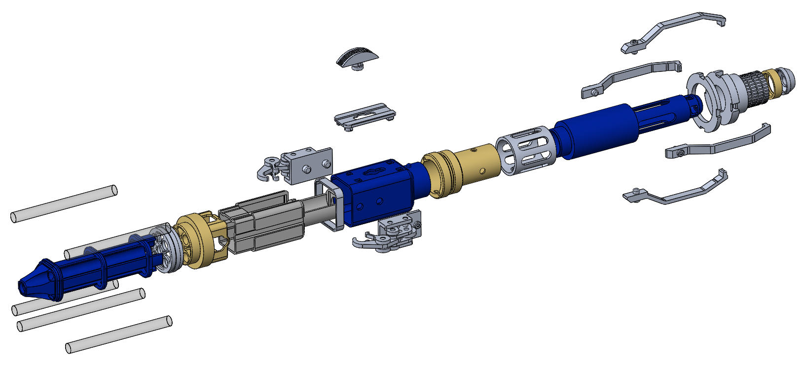

I did a slight redesign on the lower "cage" portion of the sonic. I decided instead of the full cage being a solid part to split it up into it's separate parts. I did this for a number of reasons:
- More accurate to the actual prop.
- All pieces can be printed in the best orientation for better quality.
- It actually brought the cost down by a few cents to do it this way.
Here's the exploded view to show all the separate parts - now 21 pieces total instead of 16 (including the inner housing for the electronics).
Aside from the necessary changes to the inner housing, I think it's pretty damn close to the final design at this point.

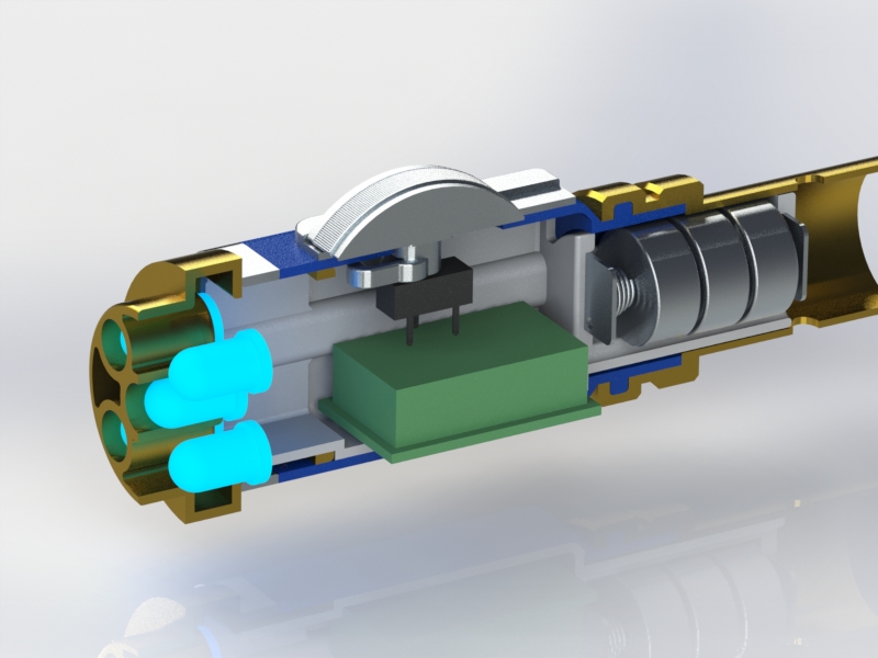

As the configuration of the electronics components comes together, I've been making alterations to the model to accommodate them. Here's a render of the inner housing where the electronics will go and the approximate location of them. None of this design is set in stone yet but the finished design will look much like this.
The five LED's (glowing blue) will slide into place towards the front end while the switch (black) to activate them will be located just under the external slider feature, which is designed to be installed after all of the electronics are in place. The board (green) is loosely represented by two solid blocks - the lower of which representing the board itself and the top of which represents the general bounding box of all of the components on top of the board. You can also see the way that the batteries fit into the rear of the housing.
The goal is to have all of this be able to be installed pre-assembled so those (like myself) with limited or no knowledge of electronics will be able to implement the electronics into their model.
