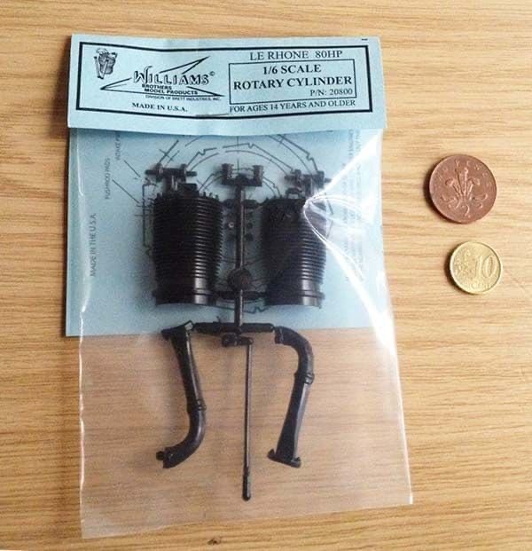

I found a company called William brothers (uk based) that sell radial motor cylinder kits that look like they might work, only issue is they come in different scales. The one being pictured being the largest. The 2p coin for reference is 25.9mm or 1.02inch and they look about the same.
anyone know how that compares to a G12 Mauser?
or of a decent grill available in the uk, that I won’t meet to take out a 2nd mortgage to get shipped?

My personal opinion is I would be more concerned about the prop you are building on and start the sizing from there. The g12 is an air soft correct? Those have a different sized fronts than that of an actual Mauser or a replica like a denix. So the grille would have to be "enlarged" like it is on the SOLO:ASWS or TFA blasters. The pictures I shared are of the air soft grills that are seen in both those films which where built on Air Soft pistols. Actual Reade Cylinders won't work correctly as they are not big enough to fit the front of those air softs for example. So just be careful with what you buy as it may not fit?
