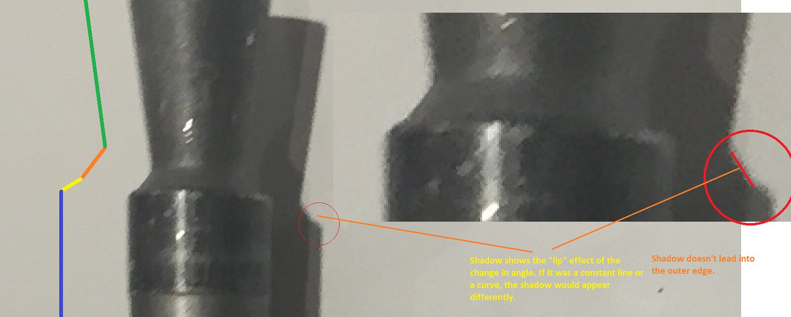

Get ready to have your minds blown by a blurry picture that has been through MS paint.
This is an awful pic to work from, but I remember what I saw strongly (seen it twice now) and if you know what to look for, it is in this image. There is some perspective here but I don't believe it effects the detail much.
Inbetween the yellow and orange line, going around the whole flash hider (like a spun item) there is a feint tool impression also.
The yellow section was pretty close to about 1.5mm - 2.5mm. Hard to tell by eye though.

I SEE IT - your colored profile on the left and the pic on the left did it for me. Wow, I could have lathed a nicer transition and I don't have a lathe lol
This is all pretty cool but I don't know if I would implement this change because it doesn't seem to be a consistent detail.
I personally don't know how I would replicate this detail.
Ha! Yeah, quite a few of us thought that was the case!
BobaDebt, what detail are you referring to? The angles of the transition of the flash hider?
That particular detail may need to be cut manually, but I don't see any reason it should be difficult, once the proper look is achieved...

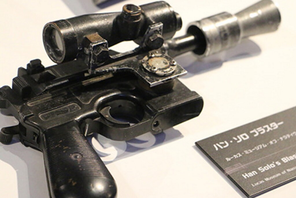

I have some questions about thoren discs. What does the real part look like? What are the replicas based on? I have seen some replica discs that look too thin. I also didn't notice an indentation in the one I saw on the exhibition blaster. I was looking hard at the grey goop in the middle (smaller than the indentation diameter I see on pics online) but don't remember there being an indentation. Maybe it has been filled in completely by the grey/orange stain substance or maybe I missed it completely.
I'm not so familiar with the part,
Have a look at the best pic out of this exhibition, the thickness too.
Looking at BobaDebt's thorens disc replica, it does look a tiny bit too thin, when comparing it to this photo.
Also, I've just noticed that the front hole for the scope on the bracket is drilled in the wrong spot on BobaDebt's bracket. Needs to be a bit closer to the Mauser, so the scope angles slightly inward. That's an easy fix, though.

Also, the forward bolt head on the scope looks the same size as the rear, on this particular blaster...

Yeah, the front bolt wasn't fully screwed in. It was slightly bent looking too, almost like it was jammed in the wrong thread hole. The different bolt head sizes were for Luke's bespin blaster IIRC. You could clearly see it in a pic.
I think some thorens pics I've seen show the real ones as being a bit thinner than what is seen here. The disc here also sits tight to the bracket, I didn't think a real thoren's disc could do that. Basically is there any chance at all it might not be a thoren's disc?
https://c3.staticflickr.com/9/8759/28434118786_ffa59fd590_b.jpg
If you're talking about the flash hider, I totally agree!
One thing that may make the Thorens disc appear thicker, is the raised middle section would be making contact with the scope bracket, I feel like I'm seeing a shadow there, in between the disc and the bracket, in the photo of the real prop.
