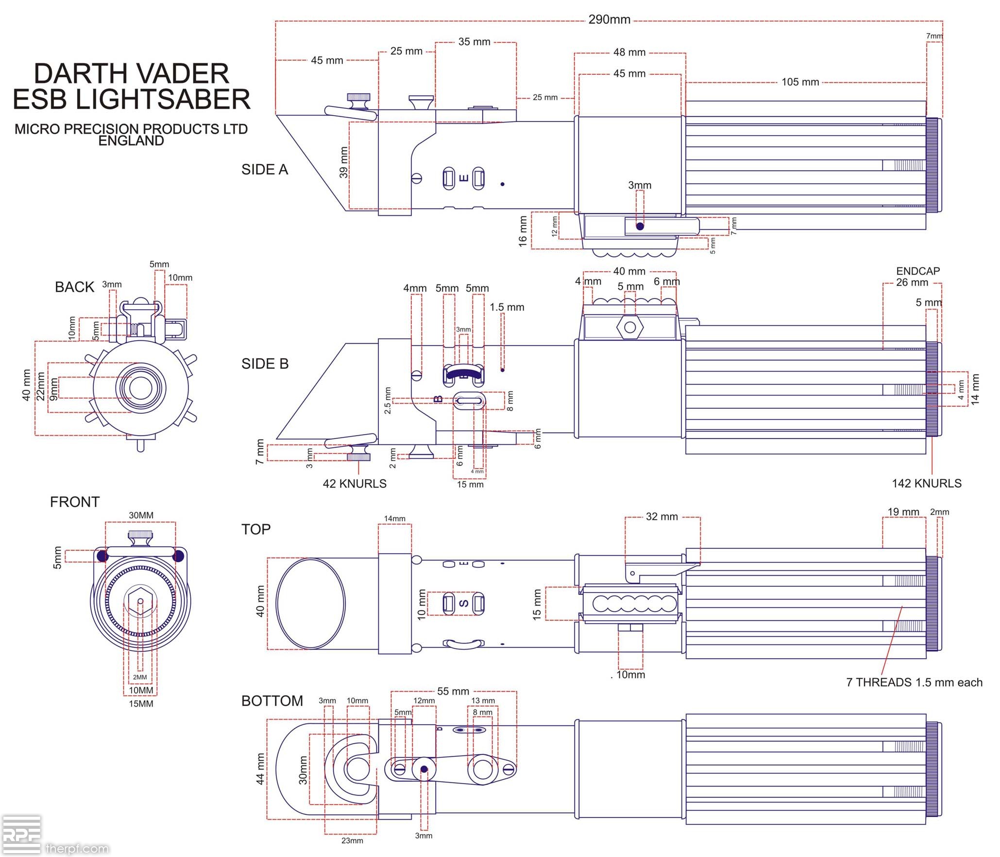

What is the proper diameter of the mpp flash? Seems theres so much information about it...trying to build my own DIY light saber on the cheap!
40 mm. screw cap end, 39 mm. emitter end of tube.
These may help as well.
Top one by DARTH SABER is ESB
Bottom by roygilsing is ANH
Blueprints – WannaWanga
Yes, and the inner diameter is different on Roman replicas, American Heiland flashes and probably MPPs
If you don’t make the flash socket from scratch you’ll want to make sure you check the ID of your tube and the OD of the socket.
