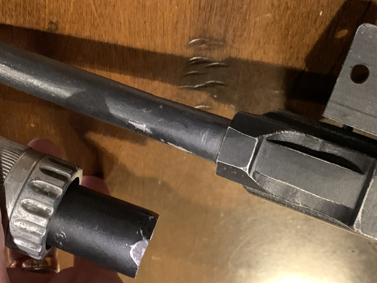

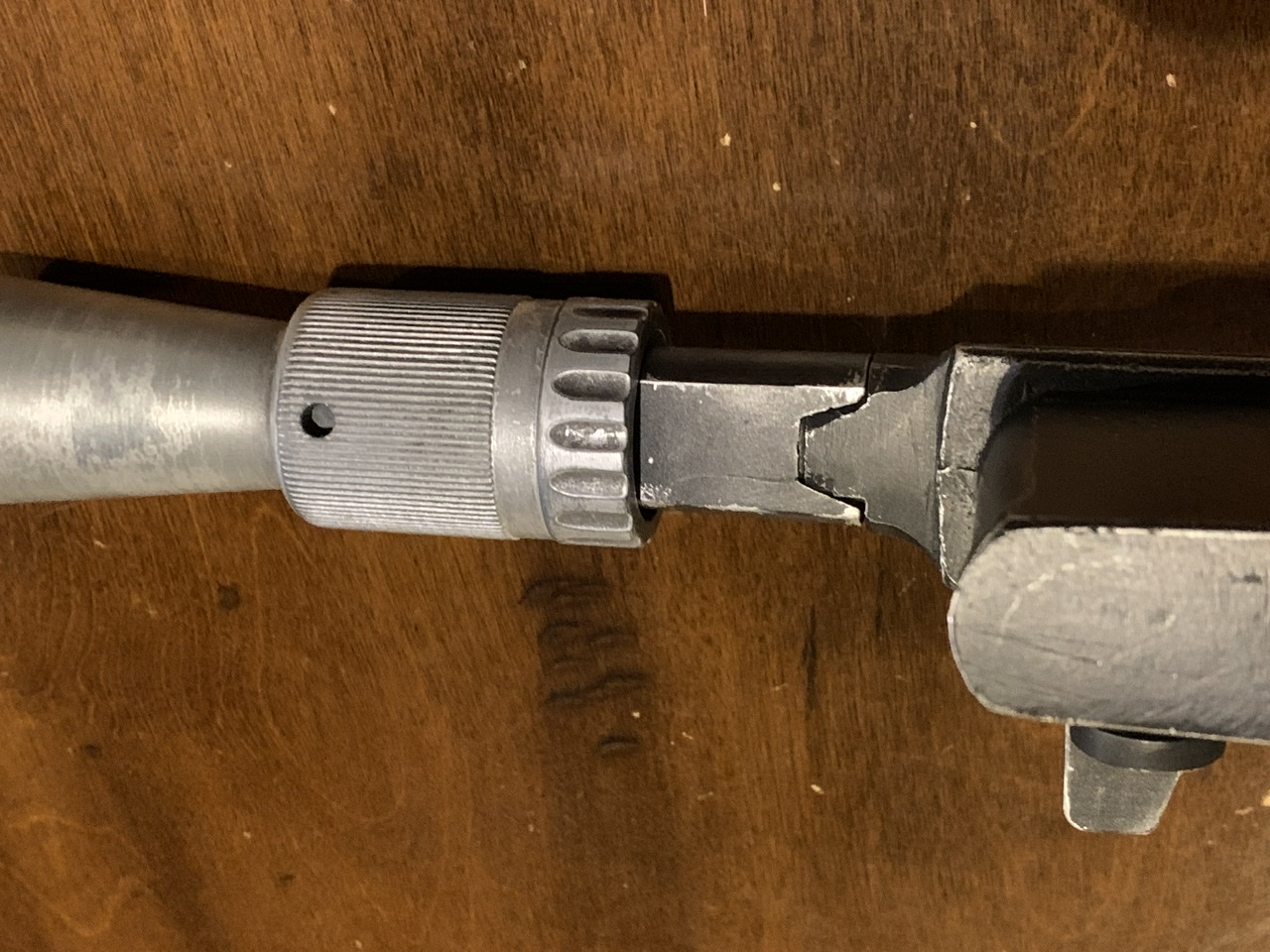

I sawed off the barrel, drilled and tapped for the Todd's bull barrel, but it was not straight, and I had NO idea how to get the threads to align so the rotation is correct. I ended up gluing it on with JB Weld. Came out nicely though!
Agreed and it is. Worst case you just lop off the barrel, drill the hole oversized, glue that puppy in! The sleeve isn’t accurate anyway, and you still have to chew up the barrel. I printed a sleeve for a Lytle Mauser I’m converting, this is easily as challenging and destructive! :) And doesn’t look quite right, but made sense here, I wouldn’t glue a resin barrel onto a metal frame.
I asked my machinist friend about how to align the threads when I built my Denix, he didn’t really have a good answer haha! I still want to know how to do it right!
Keep us posted on your build, and good luck!

Thanks Pedro.
Think I'll order an aluminium block, plenty cheap on E-bay, & then it's a matter of tapping the thread, but marking where I start to ensure I get the desired result when barrel screwed in.
Going to be quite frustrating to get it as perfect as possible.
