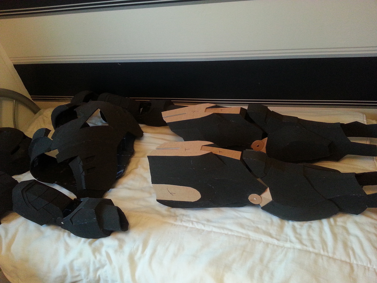

My first time posting on the Rpf. I have been building an Iron man suit for the past 6 or 7 months now on and off and have so far made most of it and am soon going to be resin coating it.
I used a 5mm thick LD45 plastazote foam which I bought in rolls and were quite cheap. This was easy to cut and didn't really need heating into shape. Also, in some places I used some corrugated cardboard where pieces were meant to be flat to provided extra rigidity, such as the thighs(as shown in the image)
Now that I am moving on to the resin coating I was looking for a cheap resin that will work. Can anyone help with this?
that looks real nice man keep up the good work bro!
Its Good my friend !
