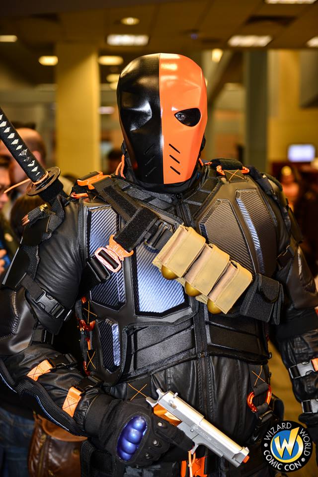

Wanted to share some pictures from the 2014 Ohio Wizard World con. Finished up my Season 2 Deathstroke costume using all of the great information posted on this thread. There are still a few non screen accurate details I would like to work on, but overall if went well for my first costume build I think. Got a chance to meet Manu Bennett - who was fantastic!!!! He is such a great guy, went out of his way to be friendly to my family. Hope you enjoy the pictures
View attachment 444388View attachment 444389View attachment 444390View attachment 444391View attachment 444387
The more I have stared at every detail as I worked at this, the more I can appreciate the work you did on your costume. I think you absolutely nailed it Deathstroke3! The undersuit and 6 buckles on the chest armor really takes it to the next level. Well done sir!
Are you using a shoulder harness for the sword sheath?
And/or is there a way to attach or build the harness in to the body armor?
The katana is attached to the bandolier that has the grenades on it. Building it into the body armor would not be accurate to the show.
