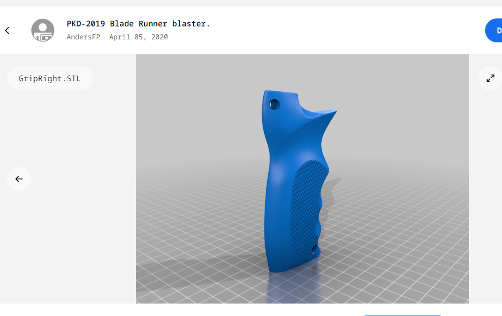

Anywho, I have a nice 12k resin printer and I need to print the amber grips for the blaster. I have clear Sirayatech resin but I guess Ill have to dye it amber. Has anyone ever done this and can point me in the right direction?
the Anders Blade runner blaster has some nice grips... for example...

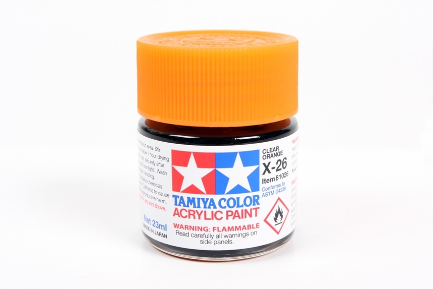

First time I used standard Anycubic Clear resin which I dyed with a few drops of Tamiya X-26 Clear Orange acrylic paint.
Unfortunately, clear resins can be quite prone to yellowing from UV light, and Anycubic is particularly bad and can verge towards a brownish "burnt" look. I found that the brownish-yellowing combined with the orange clear paint, gave the grips a dull, more brownish appearance.
I swapped over to Nova3D High Transparency resin which is specialised for ultra clarity and resistance to yellowing. Combined with the Tamiya Clear Orange, it was night and day compared to regular resins.

Thanks Starganderfish. I didnt know you could add tamiya paints to the resin. The Siraya Tech clear resin is supposedly very good and doest yellow over time. How do your grips look IRL? Is the color prettyh much like they look in the pictures?
No worries. You can add almost any colour to resin - it's such small quantities it doesn't really affect the printing, Liquid food colour, pen ink, highlighter ink, powdered pigment (though they're really hard to get well dispersed and tend to settle out over the course of a print). Just be aware that opaque paint will make even clear resins opaque, so try and use translucent colours for clears. Also, colouring clear resin is a lot easier than colouring coloured/opaque resins because the pigment in the resin itself really dilutes and washes out the colours.
They pretty much look like that in real life - a nice clean clear amber. Hit them with a UV protective gloss clear coat after curing and you'll get a really nice glossy clear finish.

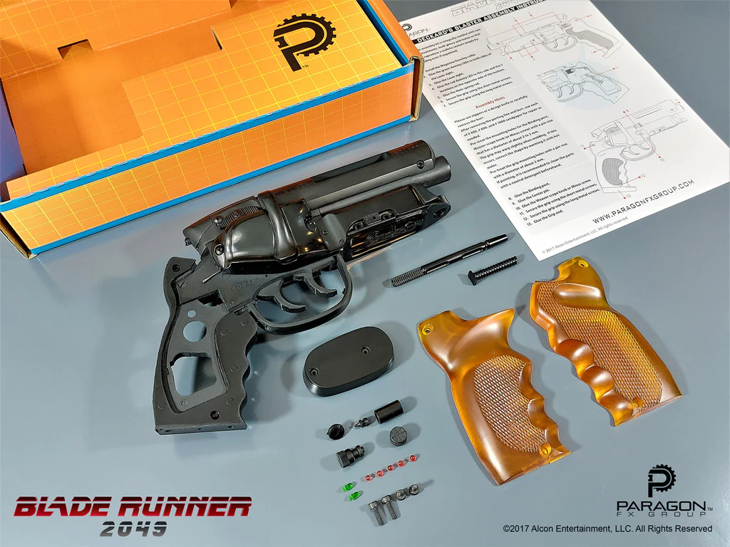

Is it just me or does the color of the original grips look more like whiskey than amber? Whenever I look at those grips I can almost smell the whiskey.
I think it's because the middle layer sandwiched between the two orange grips is metal, rather than orange plastic. This makes the colour quite a bit darker after assembly. You can see it in the pics from Paragon's when theirs is disassembled:
